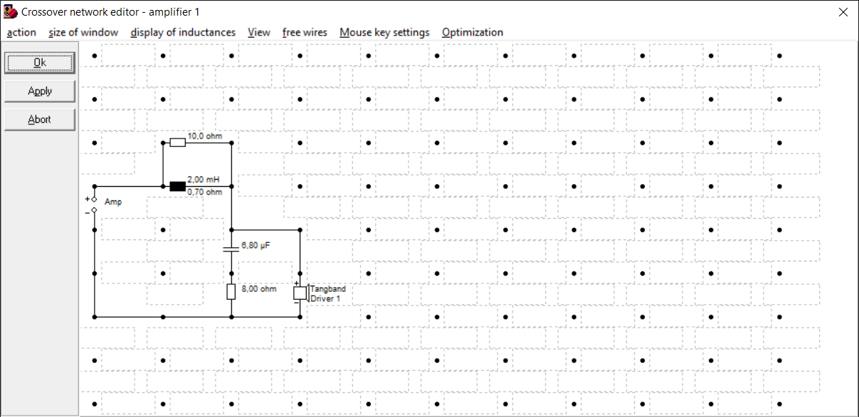

I recently buyed me a pair and temporarily installed them in a 32 liter bassreflex housing to test them. I used some pritex and synthetic damping. The first impression was a fast and direct sounding speaker. But I also found the high regions poor and sometimes even annoying.
Below the results of some measurement
The graph needs some clarification. The upper graphs are measurements of the microphone close to the loudspeaker (1 cm), without filtering
creamy: the normal cone
light blue: the whizzer
purple: basreflex port option 1
orange: basreflex port option 2 (my preferred one)
The graphs below (green and blue) are gated measurements at a distance of 80cm.
green: measurement without filter showing the increasing level of high frequencies
blue: measurement using the 'brine' filter below
This filter equalizes the graph pretty good. Unfortunately I found it doesn't sound well. They sounded dull, without the good stereo image and direct sound I know from good quality fullrange speakers. I tried to tweak the filter by replacing the 2mH with 1,1mH and the 10 ohm with 8 ohm. This lifts up the curve a little and brings back some treble but I am still far away from good sound. Any suggestions how to improve this?
You are missing treble with that blue line?
If it were me, I'd still get it down about 5dB at that rising peak starting at 6.5kHz.
To each his own, but I fear I can't help you there... that blue line would still be too bright for me.
The sound is dull and unrealistic. I agree that the graph is going up at the higher end but most of this is beyond the frequencies most of the music is in. What concerns me is the area between 700hz - 5 khz. The nearfield measurements show very different behaviour of cone and whizzer. The sum of this is a relatively flat graph but I think the differences in phasing in this highly audible area lead to the dull experience.You are missing treble with that blue line?

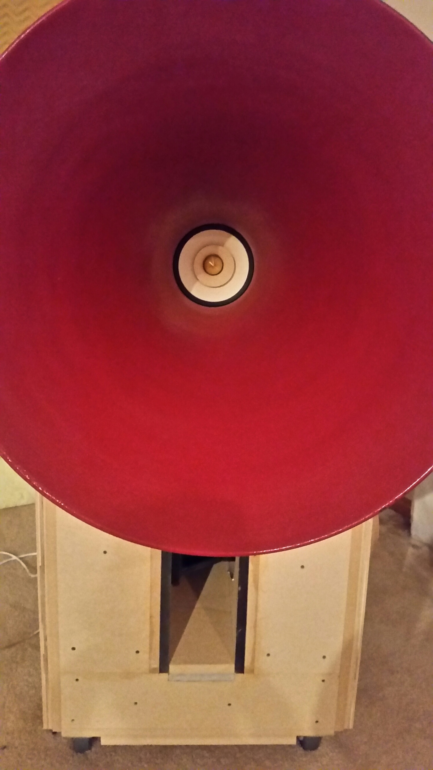

Here's how I enjoy mine:
Very Christmas season! 🙂
I doubt my wife would let me have big red horns in the living room!
