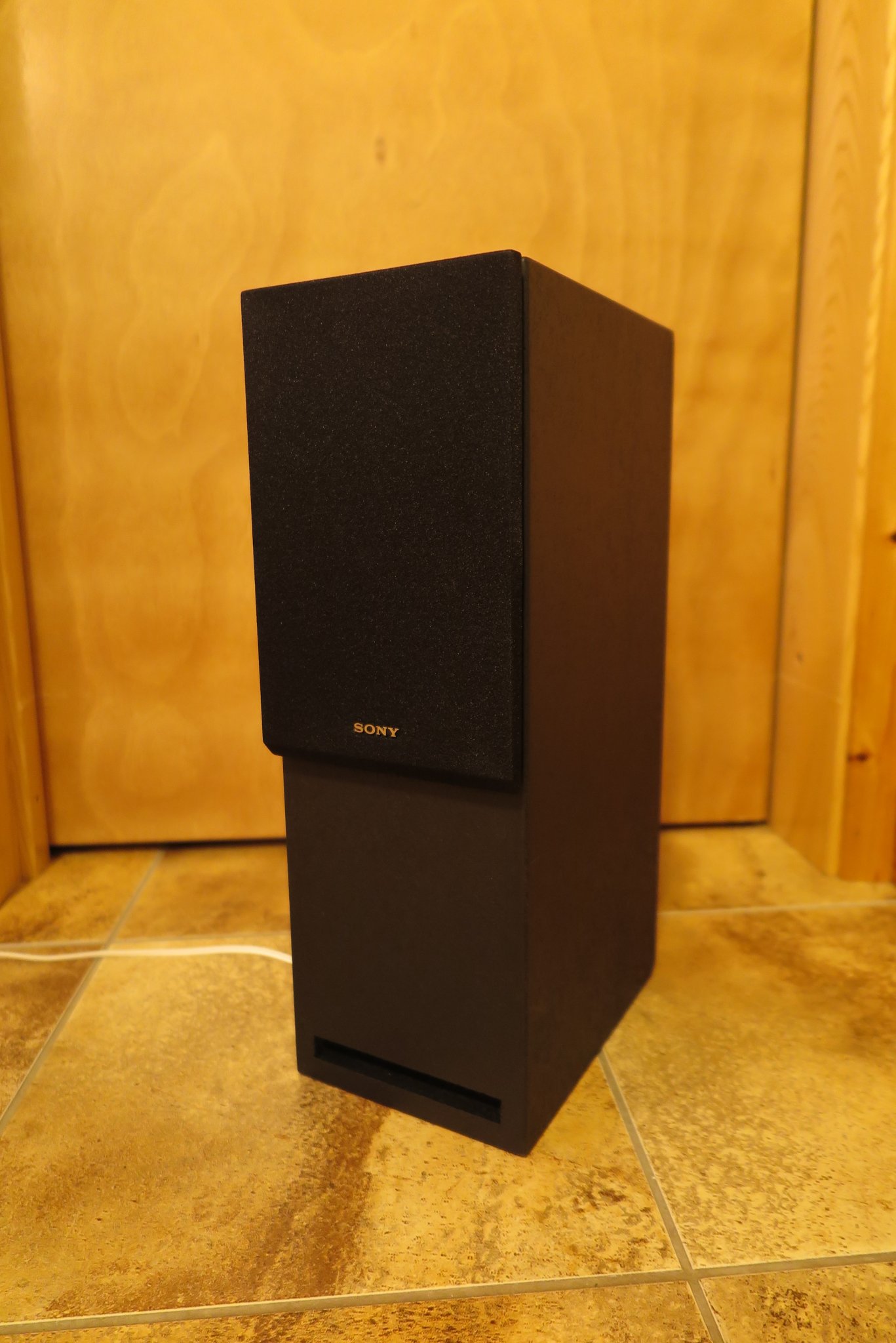

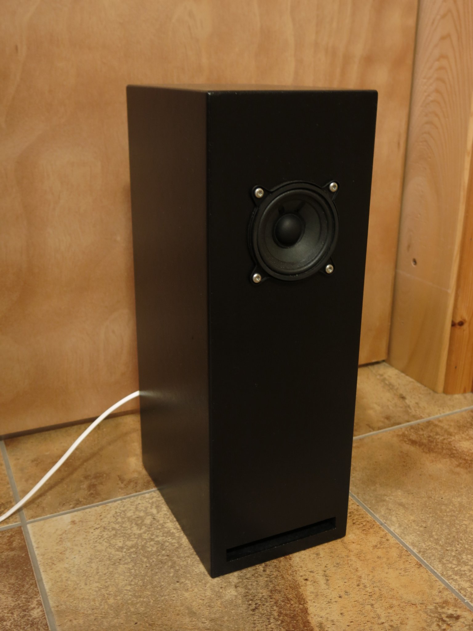

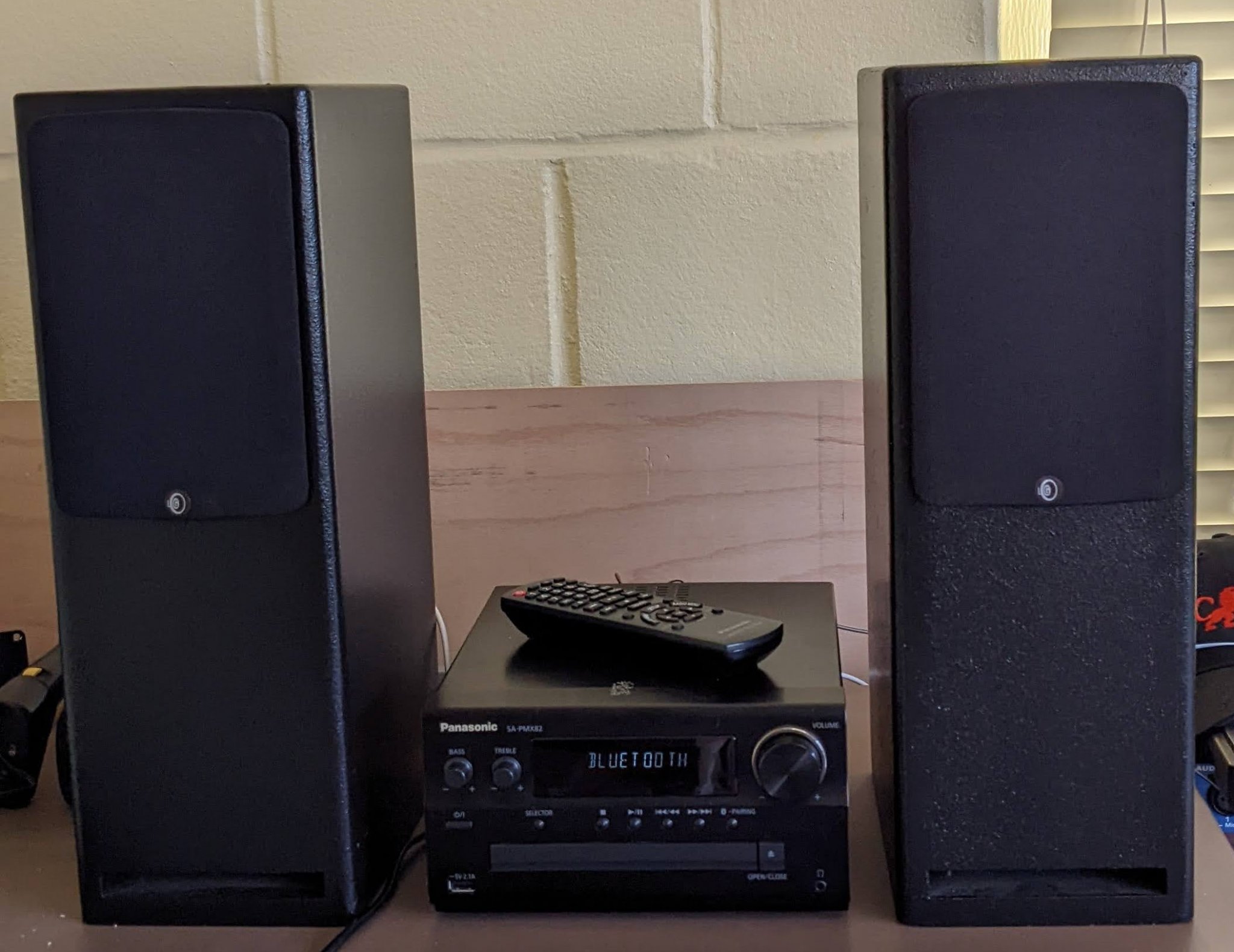

I do think that the front port just looks good. here are some pics...mostly to feed my ego 🙂
I'm planning to build 2-3 sets if I'm as happy as I hope to be with the finished product. I considered the large tabaq as well, but honestly, I hate beaming. I'll give up some overall finesse for better off-axis performance. Speakers that are finicky about placement and/or listening position start to annoy me. That's why the 3" or 4", likely with a BSC, and a more nearfield listening environment are more appealing for the first go around. I'll start with the Peerless and/or Faital's and see how it goes.If you are doing a one off project and want to get better results, spend the money/time for 4in drivers (or 5in, I have heard the Tang Band W5-2143 in a TABAQ, and those speakers are amazing!), BSC, and whatever else your research leads you to...
Thanks for sharing the photos. (Nice Sony grill too!) I agree, the front port looks good.
I think anyone who has heard them will agree that the W5-2143 drivers are somewhat unique in that they don't beam as much as most 5 inchers. I have heard both these and the plastic cone version whose code I can't recall in TABAQs, and just really are amazing speakers. My friend has a pair in his very small living room, sitting on a dresser, and they sound great...I'm planning to build 2-3 sets if I'm as happy as I hope to be with the finished product. I considered the large tabaq as well, but honestly, I hate beaming. I'll give up some overall finesse for better off-axis performance. Speakers that are finicky about placement and/or listening position start to annoy me. That's why the 3" or 4", likely with a BSC, and a more nearfield listening environment are more appealing for the first go around. I'll start with the Peerless and/or Faital's and see how it goes.

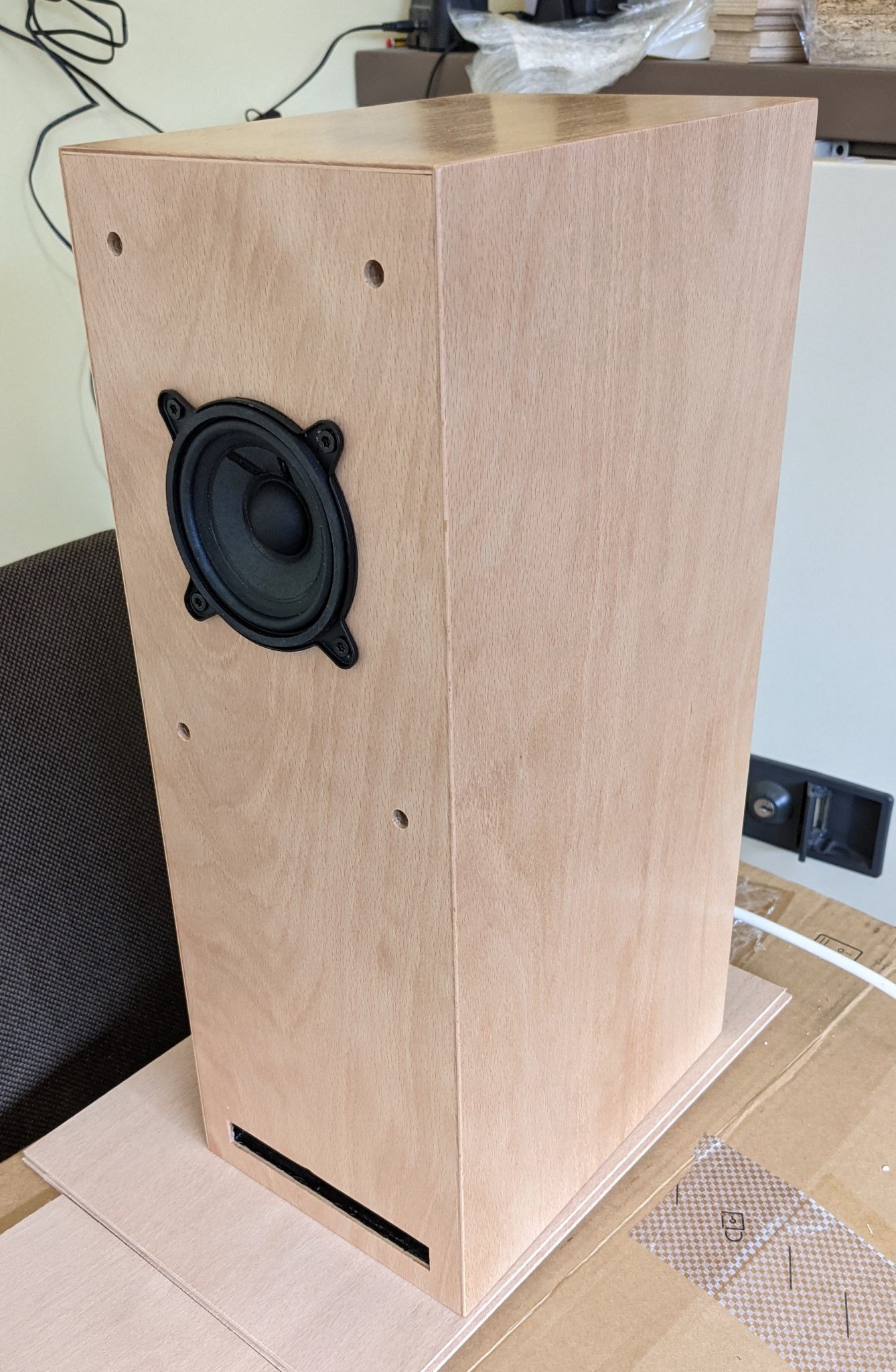

Hi there! It took me a while (10 months!), but finally build the speakers with the FPro 3fe22. The 2020 version for 3" with the modified port and 80 grams of stuffing. I am listening to them right now as I am writing. They sound great, and everything's ok with the amp. Bass is not so deep, but pure and undistorted. The only drawback are the higher frequencies that go rather wild. I put the speakers against the wall, and thought that maybe I could manage it with the treble control, but I think I'll need to build the BSC circuit. Anyway, I wanted to drop by and say thank you. I will upload some pictures of the build later.
The Faitals are known to be somewhat hot in the higher frequencies. They absolutely need a BSC.
Thanks Perceval! Any particular recommendation on the BSC? Online calculators gave me 0.8 mH for the inductor and 6 ohms for the resistor (3fe22 manufacturer values and a 10cm width enclosure). Any other component? I've read Oon recommended adding a condenser for overexcursion protection and somebody else suggested a notch filter. I don't want to put too much electronics on it, but neither too little.
A mic and REW will tell you exactly what you need.
It's the price of DIY.
I haven't done a build with the Faitals, plus I have no idea what sounds good to you.
So, any advice is to be taken as what it is... a wild guess.
Usually, for BSC and the TABAQ, we recommend 1mH and the amount of resistor you think sounds good enough.
Maybe other Faital builders can chime in.

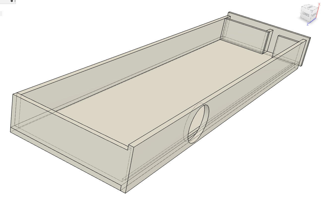

Hello! First of all, thanks to Bjørn and everyone who has contributed to this thread, there's a lot of great ideas and passionate people involved.
I just finished my first TABAQ build, a folded 3FE25. The build was a lot of fun, my first time cutting panels as opposed to assembling a flatpack, but I'm not in love with the results right now. The driver is a bit too bright, still working on the BSC. Settled on 1mh coils and 10hm resistors with the parts I had on hand, going to switch to 1.5mh and try again with a few different resistors.
I also ordered the W3-2141 to build the TABAQ 2020 as well and I'm hoping someone can help me confirm Bjørn's notes on the lower tuning model for this driver. "The line has been extended by 3 inch, the port is 5 inch" means that the chamber will be 85.0cm tall and the port length will be 12.7cm?
Ryan
Ryan
Hi Ryan
The 2020 document is the standard version, and the other document describes some adjustments you could try. Hope this is clear enough from the documents?
Rgerds
Bjørn
Rgerds
Bjørn
