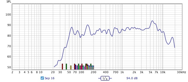

Good Evening to everybody, I had a very bad experience, while testing an amplifier my TB W5-2143 literally "fried" even the smell come up
was the smell of french fries, dammmm I was so sad I really loved that driver on the large Tabaq but still is done it nothing to do, at least I learn
next time to test defective amplifier with cheap speaker, but anyway I am as a lot of you know in Philippines and budget at the moment is limited
so I cannot afford to buy again that driver in US or other place with hight delivery cost so the only possibility is by some China product from the local online market Lazada, problem is the size I could not find some driver to match the hole until I found this driver here the link https://www.lazada.com.ph/products/...mp=1&spm=spm=a2o4l.order_details.item_title.1 , around 70$ per pair, even not so cheap, but anyway arrived mounted and sound is quite ok of course not really matching Tabaq requirement for the time being is ok, I also just measured with Rew and this is the result, I have to try with a notch around 5/6 Khz, ok for now and all the best to everybody.

Oh, I wish you would have told us before you went to buy new drivers.
Was it both drivers that got fried or only one?
You know, TB is a Taiwanese company.... and I'm in Taiwan. That's not very far from the Ph. :)
If you are still interested in getting one or a pair of 2143, give me a shout.

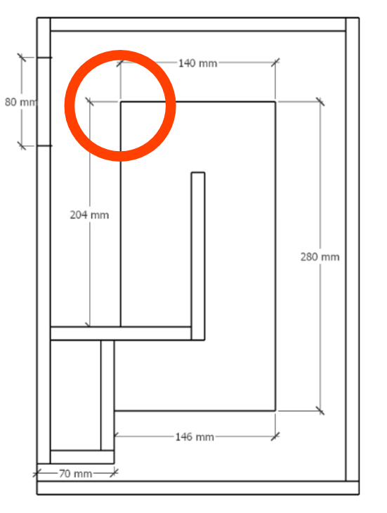

Hi everybody,
I was thinking about maybe building something new. I like the look of speaker designs that are wider than they are deep. It then hit me, could you do a folded tabaq, but with the driver on the side? Would require a different baffle step compensation, but the transmission line should work in the same way. Have it been tested?
To clearify what I mean, below is Entas' design from #2995 (https://www.diyaudio.com/community/threads/tabaq-tl-for-tang-band.88787/page-150) with red ring showing my idea on alternative driver placement.
Thanks for the replay. I'm sketching on a tabaq box with the driver on the wide side.
Need to decide on the driver before I finalize. The Peerless 830987 is called "the star" in a tabaq. But i
I want a circular driver. Is there a fully circular version of this? Otherwise I guess I go for any of the tang band W3s 😊
One thing I failed to find the answer to, even though I guess it has been asked before. Is it OK to change the shape of the port? Keeping length and area, but make it round?

q77, as GM said, the shape of the port matters little, as long as it has the same CSA and length.
Also, I wouldn't pick "any" TB W3 drivers. Some are better than others.
If you like a response reaching higher, the 3" are good.
If you want a bit more oomph down low, the 4" are better suited. Depends on your listening preferences.
