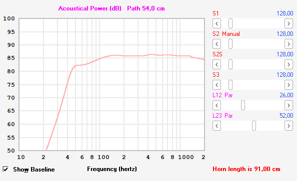

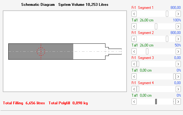

This is HornResp:

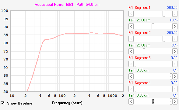

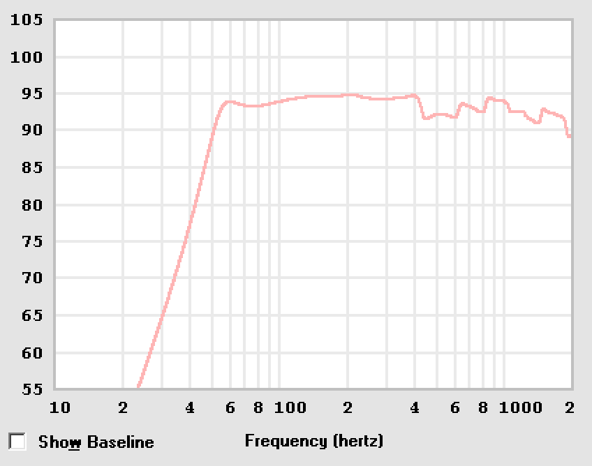

What happens when you adjust the acoustical path (distance driver - port)?
Hi Bjørn.
HornResp seems to differ from MJK's here...
Not sure why... we usually get the same curves, more or less.
This is yours:
This is HornResp:
And HornResp with the port at 5.5cm:
I was referring to the differing results between Mjk simulation and hornresp.
One can specify the distance between driver and port opening, which changes the simulated response. This value is reflected in "path" at the first HR screenshot. I think
one sets this value in "chamber".
I am not meaning driveroffset zd.
Edit: this is especially usefull for specifying the real world geometry of the box, weathers its a straight or a folded line.

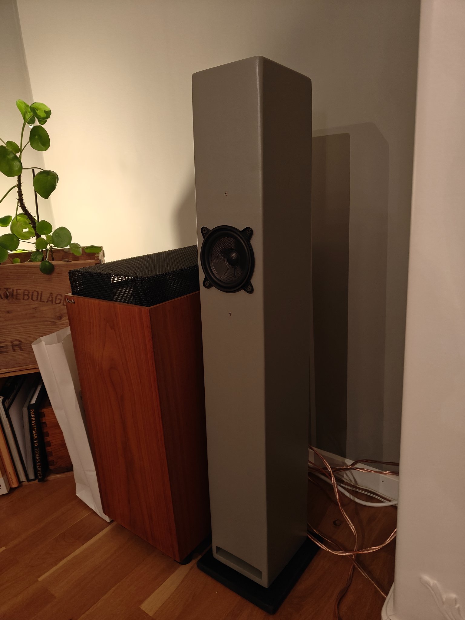

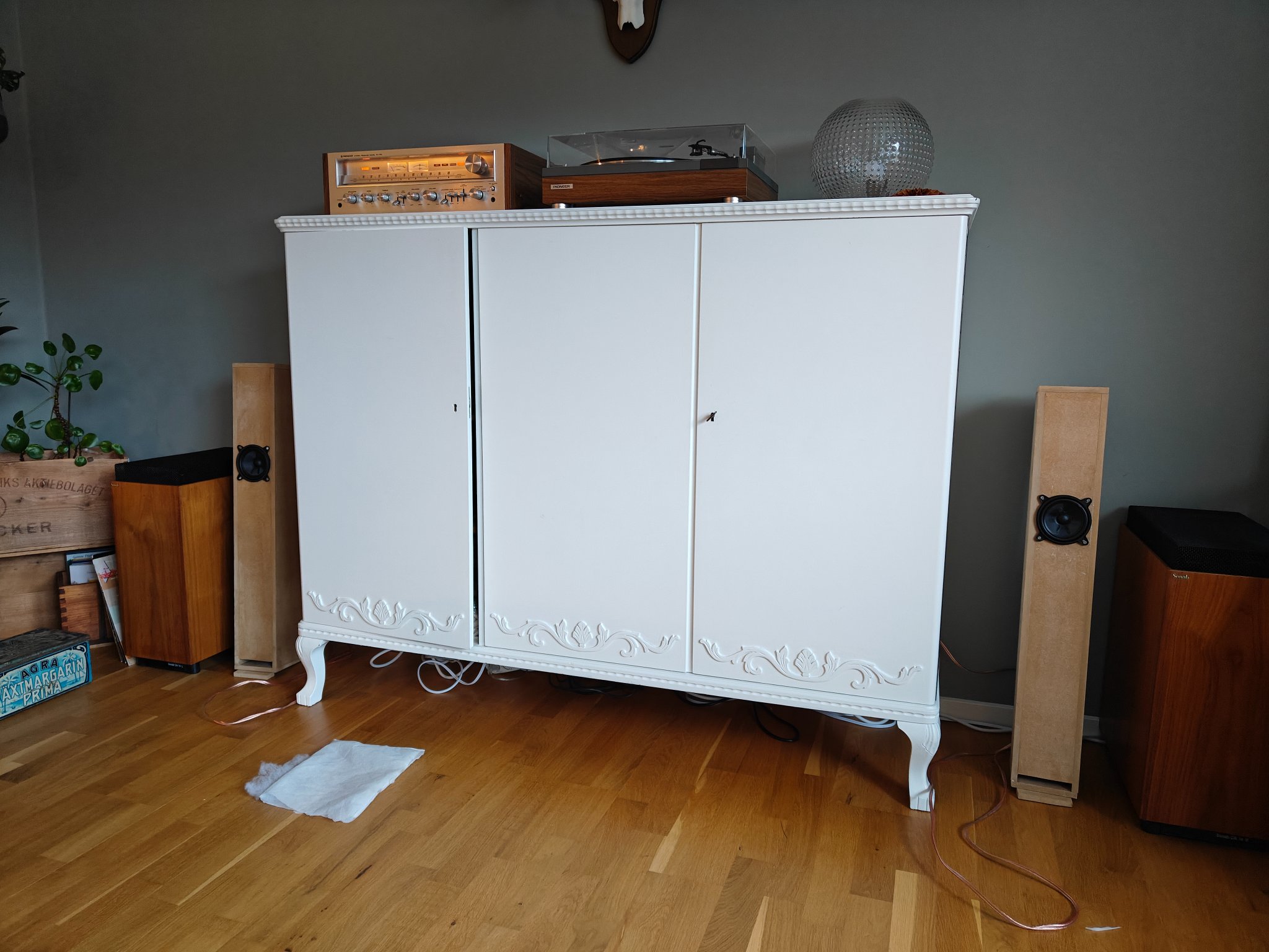

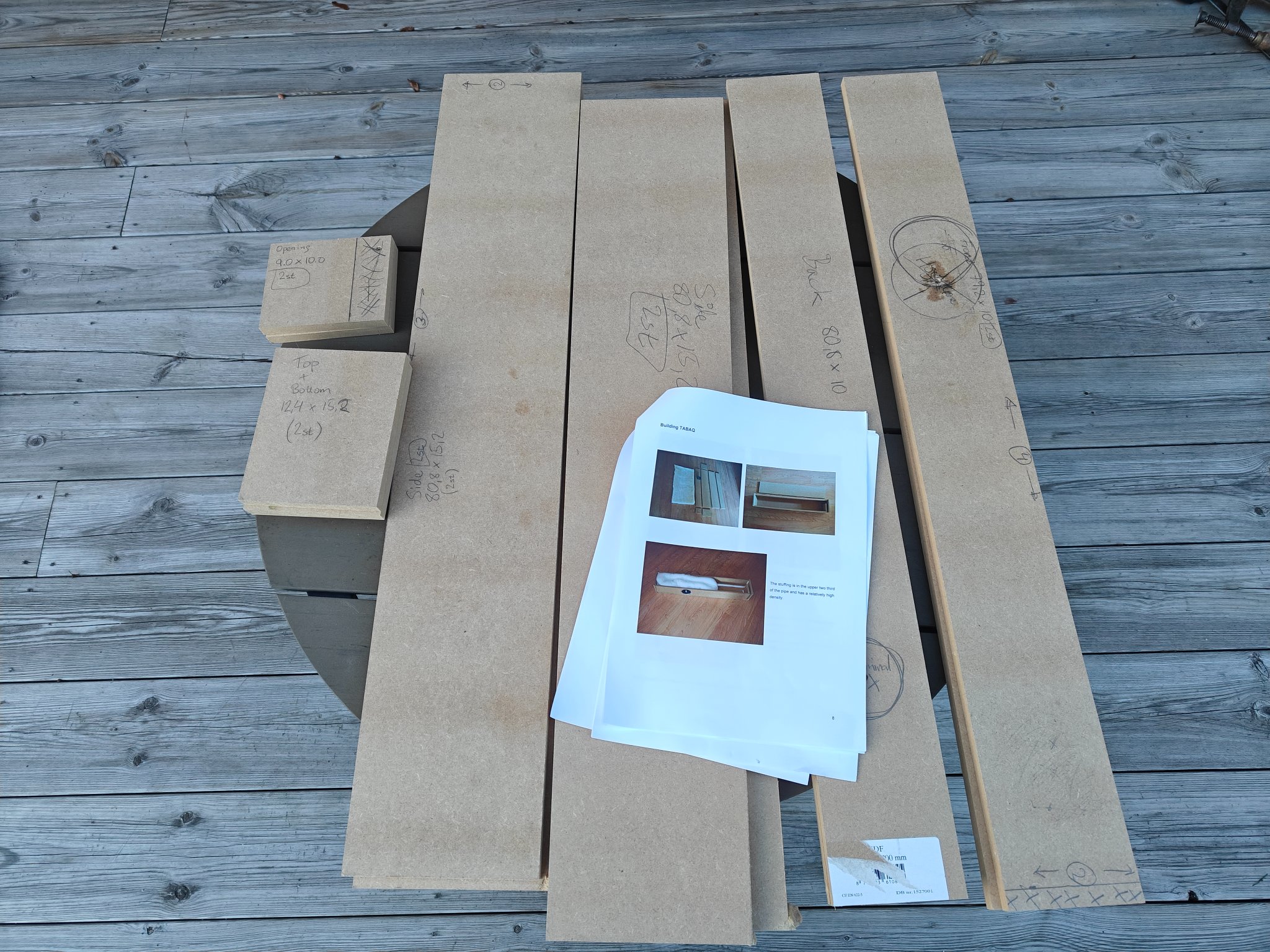

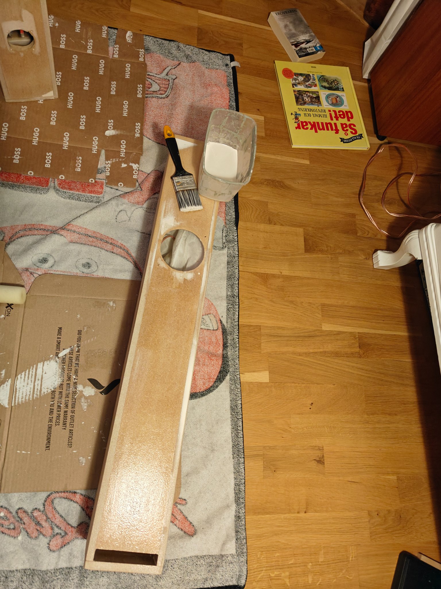

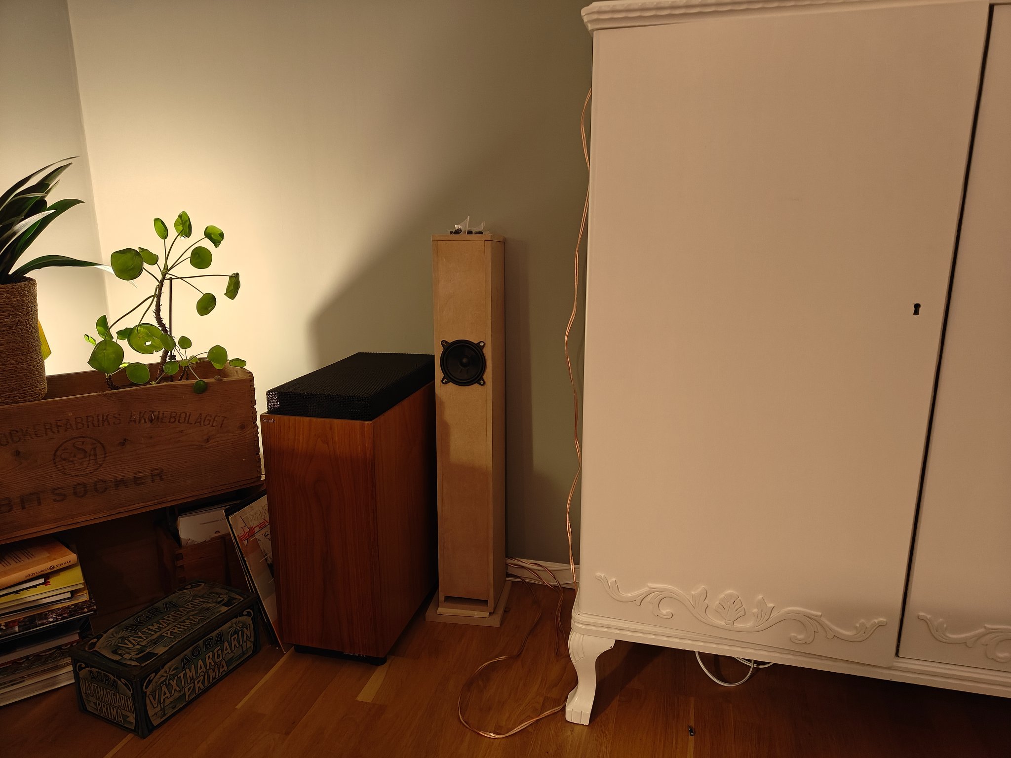

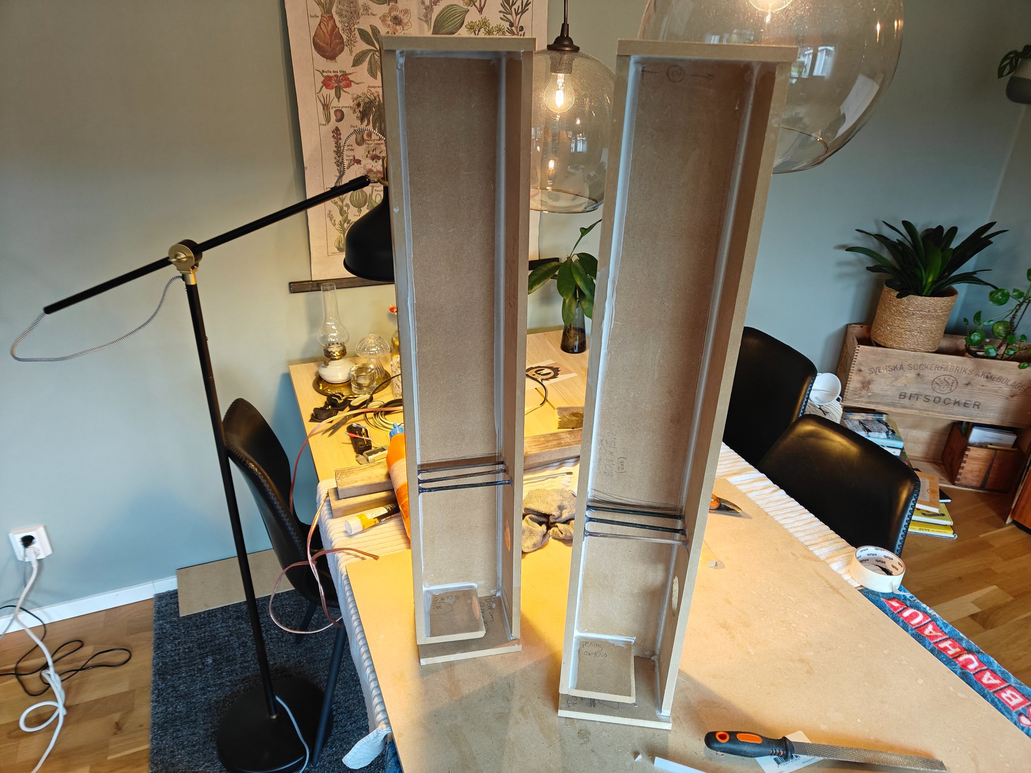

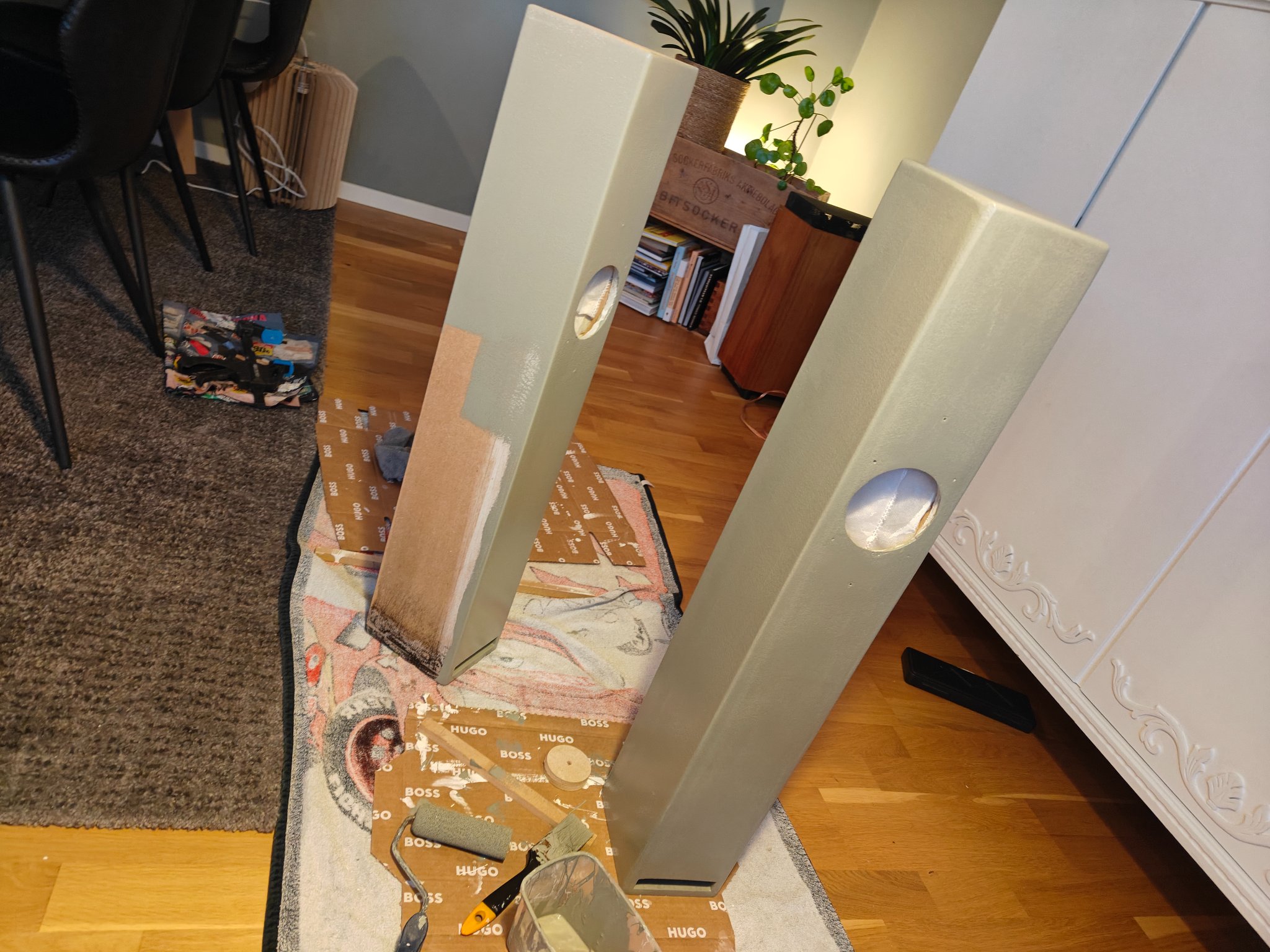

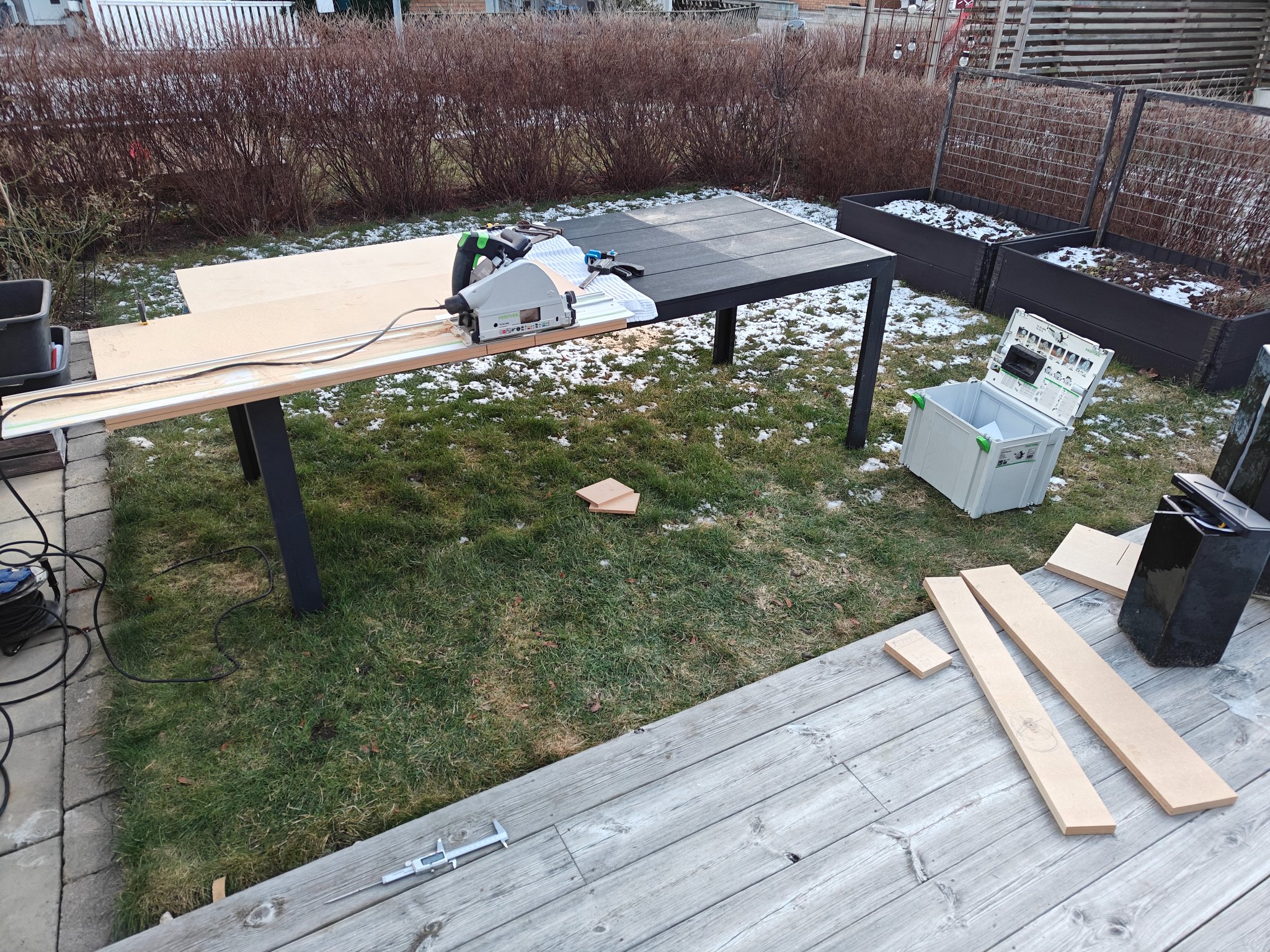

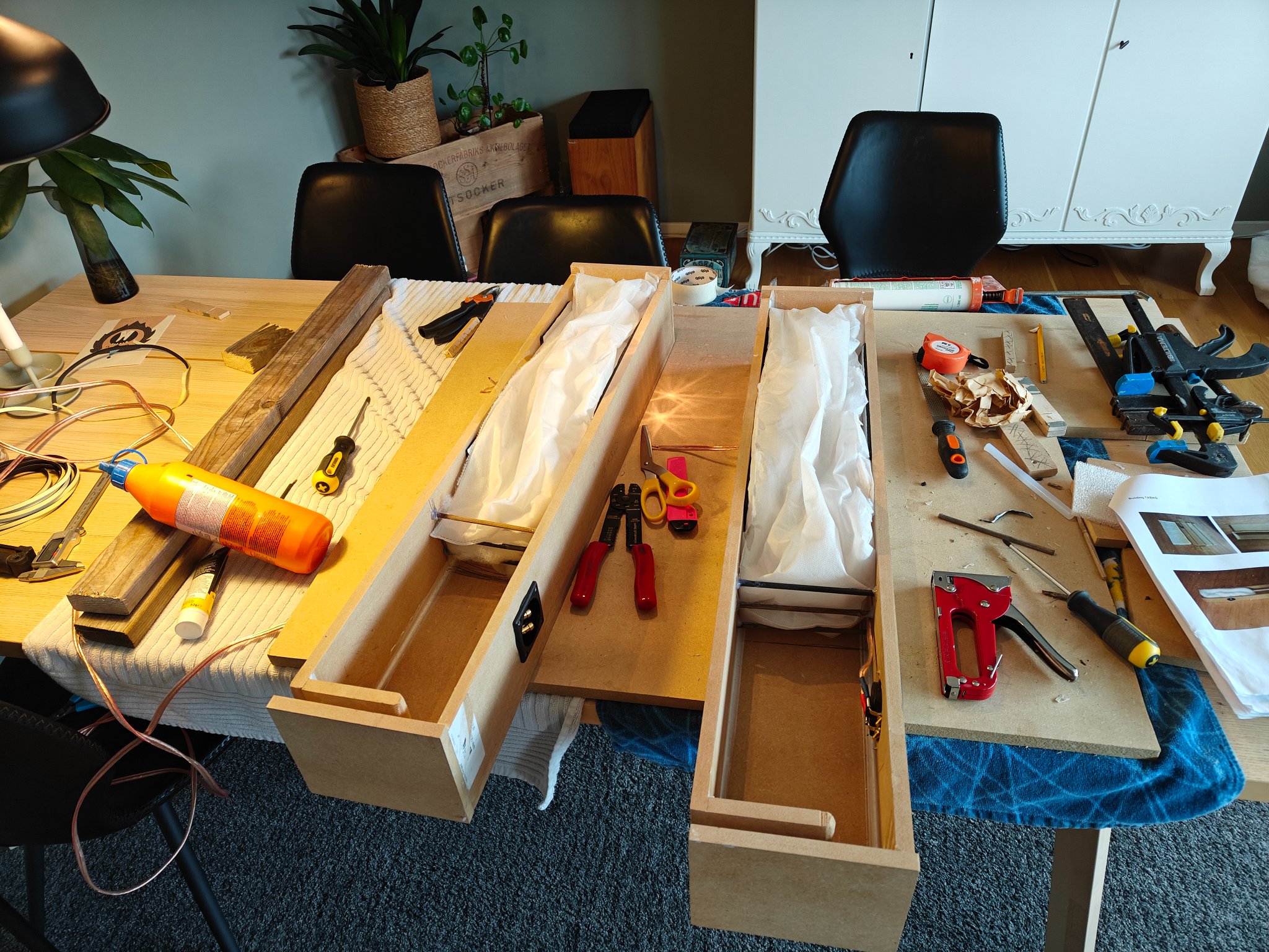

So I have been building some TABAQ:s this weekend.
Pretty straigth forward.
Now has the glue just dried and first sound test is... Wow! Cant believe how good they sound. 😀
There will be some sanding, touch-up and paint later on.
IMG20250220170530.jpgIMG20250221211427.jpgIMG20250222100554.jpgIMG20250222103904.jpgIMG20250222103926.jpgIMG20250222110441.jpgIMG20250222110740.jpgIMG20250222114612.jpg

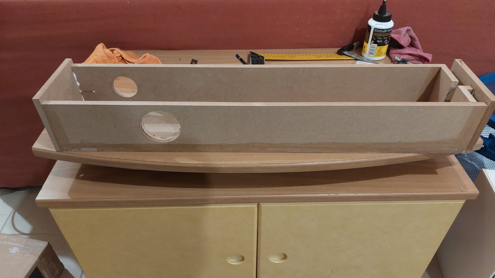

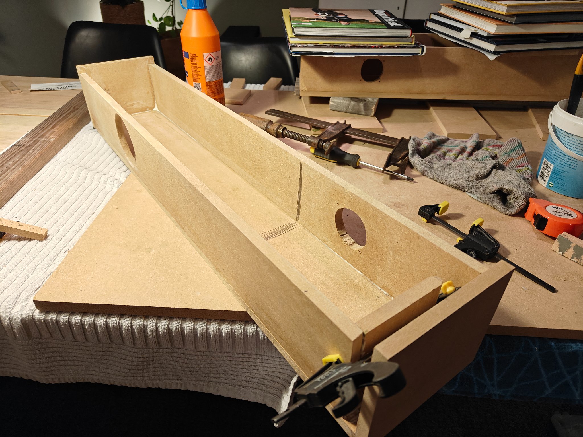

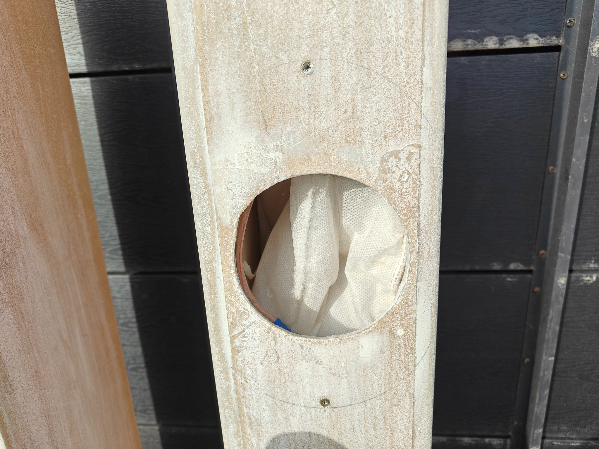

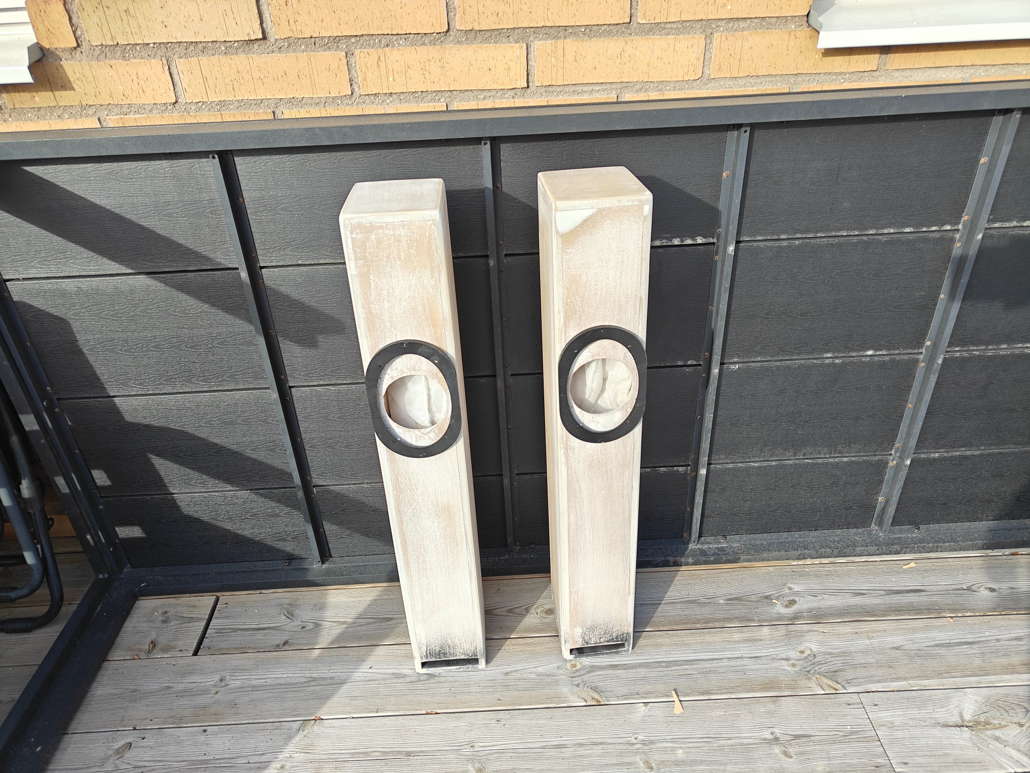

Hi, this is my first post after four years since I was happy with my previous builds. My 0.53x dual faital pro 3FE 25 karlsonators in foamcore began to loose some of their bass propably due to air leakage so i decided to use the 4 drivers in order to build the tabaqs. Two of the in the folded version and two in the normal (2020) version. No bsp, just DSP for now. I am very happy with them and likely they will be used in a home theater setup after i complete a 3rd folded one.
But! due to my excitement i made a stupid mistake and cut the holes for my drivers on the wrong piece of wood. I ended up with a pair of tabaqs (normal 2020 version) that have the ports looking back...
They sound very good in my ears, actually i cannot tell any difference between them and the folded ones that are build correctly.
So before i start painting them i would like to know if in "science" terms the wrong position of the port is so "bad". MDF is cheap and i dont mind building them all over again.
Thanks...

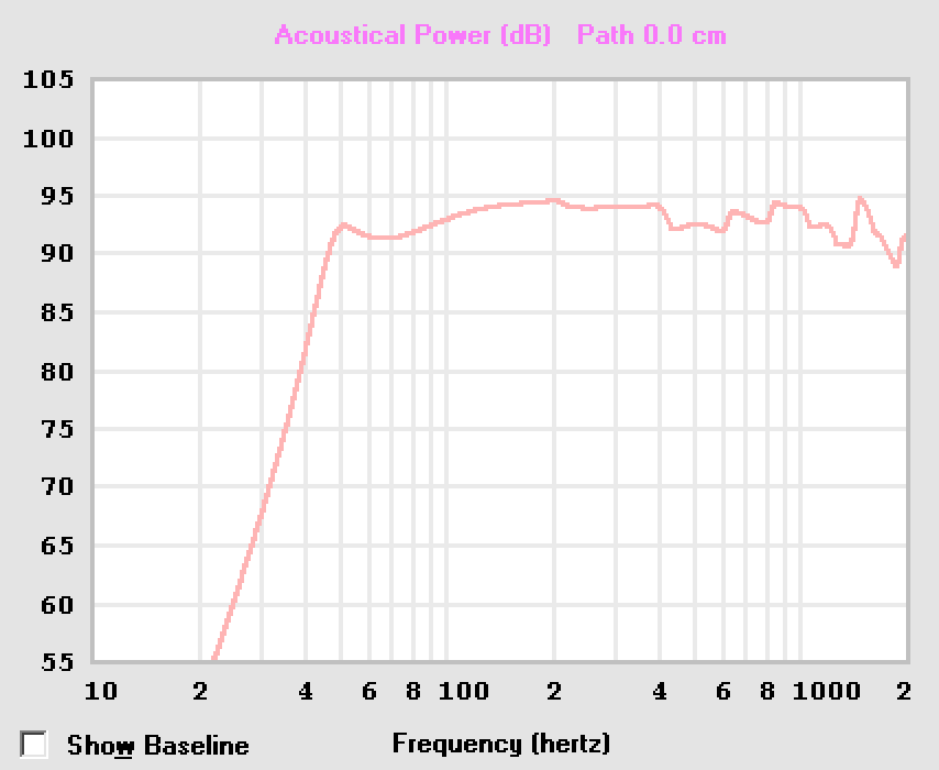

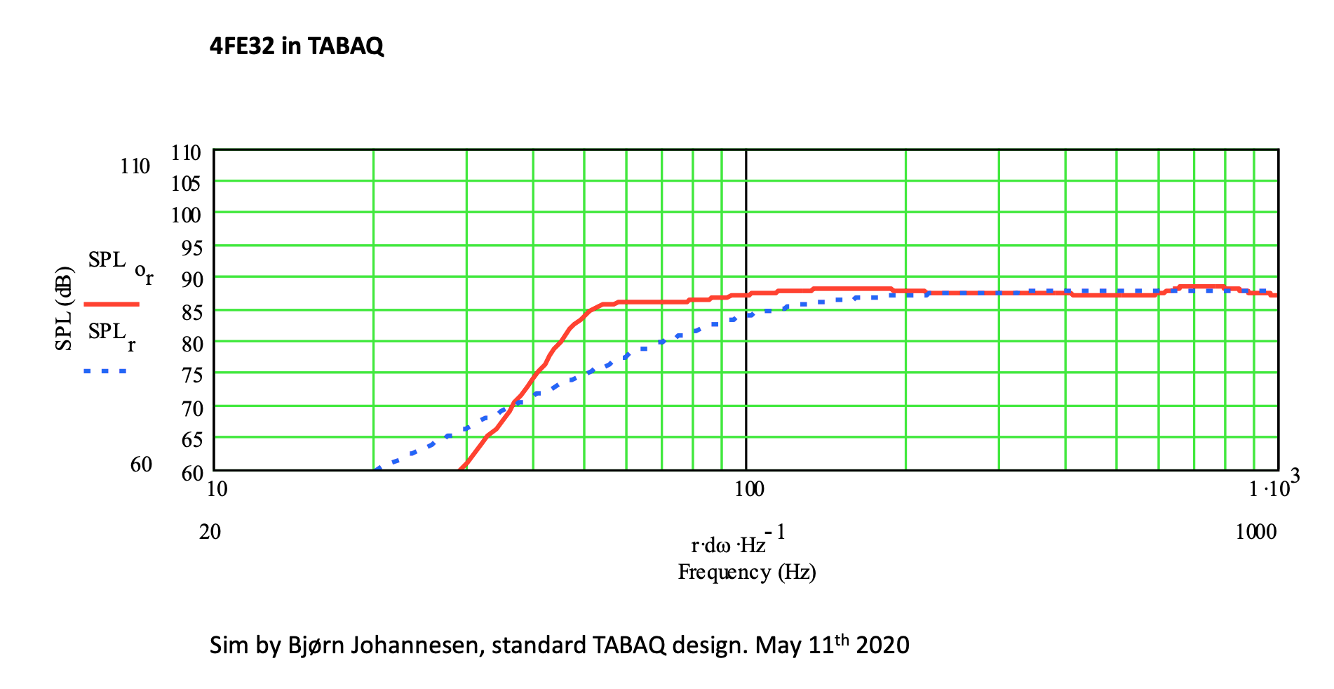

i tried to simulate the original TABAQ with hornresp, hornresp-record attached.
Driver specs are from here: https://www.lautsprechershop.de/pdf/tangband/w3-315sc.pdf
The result doesn't match with the Mathcad sim shown in https://www.diyaudio.com/community/attachments/the-first-version-tabaq-story-1-pdf.1081229/
Any ideas what i did wrong?
Thanks in advance!
I'm not very familiar with Hornresp software so, I can't say what you might have got wrong.
But, looking at the data sheet for the TangBand driver you have chosen, I think it's safe to say it will work well in a TABAQ enclosure - Fs and Qts are well within the recommended values - best of luck with your build 🙂

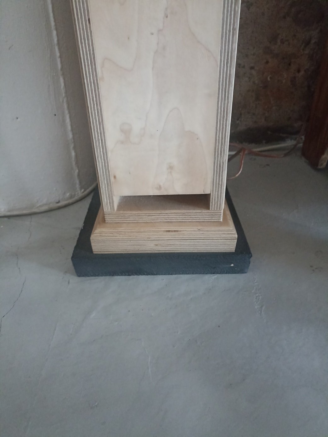

I’m hoping that there’s a way to increase the height of the TABAQ to lift the position of the driver
There are a few things that you can consider. I also like the driver position higher at ear level.
You can certainly make a down firing port to increase the length of the speaker box. I used plan B posted on this thread. Then I also added some extra thick feet for more stability. This raised the driver centre to 72cm from the floor. Lately I have been using 30mm thick EVA foam pads to de-couple the speakers from the floor, which improves bass and lower bass definition. My driver height is now 75cm.
More on round ports on this thread and Bjorn's answer.
Hope it helps.
