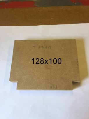

For building Tabaq wih boards of different thickness I made this little block. A couple of them.
The block has the inner dimensions of the Tabaq. No more math.
Just make shure the front and back pieces are 100mm wide.
Then glue one side to front and back with block inside. The cutouts are for not gluing the block by accident.
Thickness of boards doesn´t matter, the inner dimensions are there with the block.
Remove the blocks and add the port and the rest.
