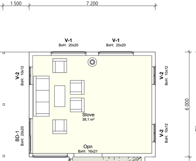

Hi! im back in the best and greatest forum thread ever made!
i have built and listened to the tabaqs for over 10yrs now. so thank you Bjørn 🙂
im ready for a new winter project here in Norway. and i would like to use the tabaq consept to a new level, in my head i have a idea of putting a subwoofer in to the tabaq but i want to have some input from you guys!
I need help with designing a speaker enclosure for my living room.
Under is a list of the drivers i have available
i have a pair of Patos Basic 401 MK1, they sound very nice in this room (a bit bass heavy) with a Rotel RA-11 Amplifier

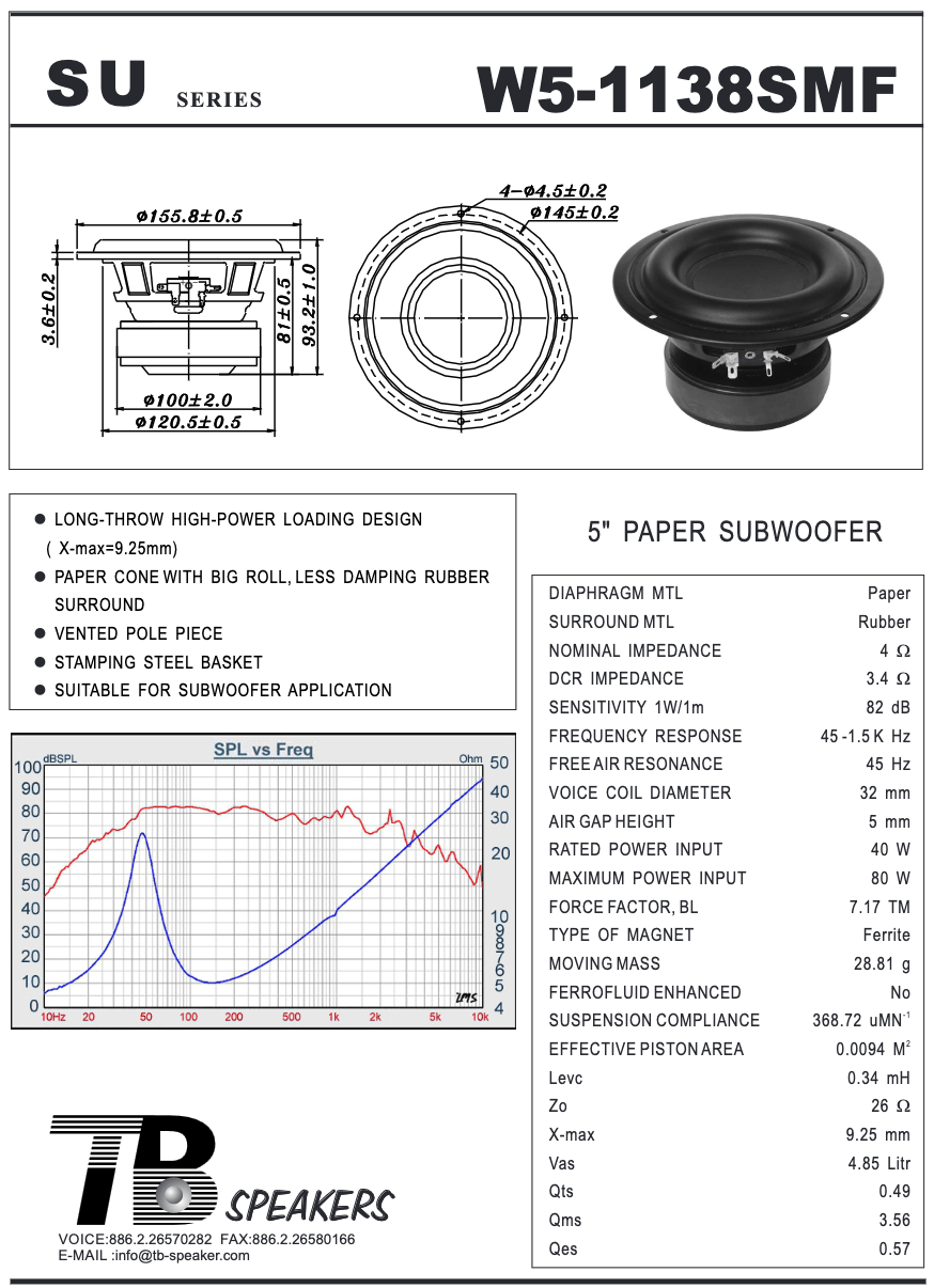

- Amp: Lyngdorf TDAI 1120: SPECS
- Tangband W5-1183SMF SPECS
- Tangband W4-1320SJ SPECS
- Monacor SPX-32m SPECS
- TEBM65C20F-8 Balanced Mode Radiator SPECS

So, more like « TABAQ inspired », or more precisely, a MLTL WAW.
I have done a TABAQ with the W4-1052SD. It sounded great, but keep in mind that what you see in the specs and the real world might be very different. TB has a tendency of doctoring their specs a bit. So, while it worked fine, it really neede two notches to tame some nasty peaks and make it really enjoyable. If you have EQ, then it’s even easier.
I have also extrapolated the TABAQ to use a SBA SB15SFCR39, which is an oval woofer, 5x8, and works really well in a MLTL. I mounted it vertically so it made a nice slim column. On top, i placed a small full range sealed in a sports cone, like X does with his builds. Your choice, but I would stay away from TB, unless you plan to cross them actively. If going passive, I’d pick a more behaved FR, like the SB65, SB10, 10F, B80, TC9, …. Since you already have support below, try to stay small for the FR to keep the beaming at a minimum.
