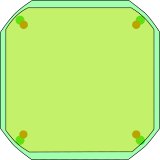

Well, somehow I was expecting the Peerless PLS-830987 dimensions and mounting holes to be straight replacement to the TC9/TG9.
I was mistaken. Not much difference but enough to make me skip the test in my current box.
Green is TG9/TC9
Yellow is the PLS-830987
