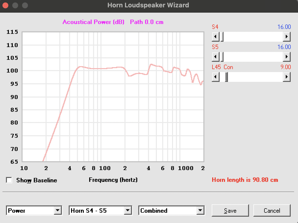

I made a template in HornResp of the TABAQ. I just need to key in the driver's specs and I look at the sim. If it looks good, I'll try it. If it has horrible spikes, I look for another driver and don't lose my time! 🙂
Most of the time, the only adjustment you'll need is to play with vent size or length to have a smoother knee.

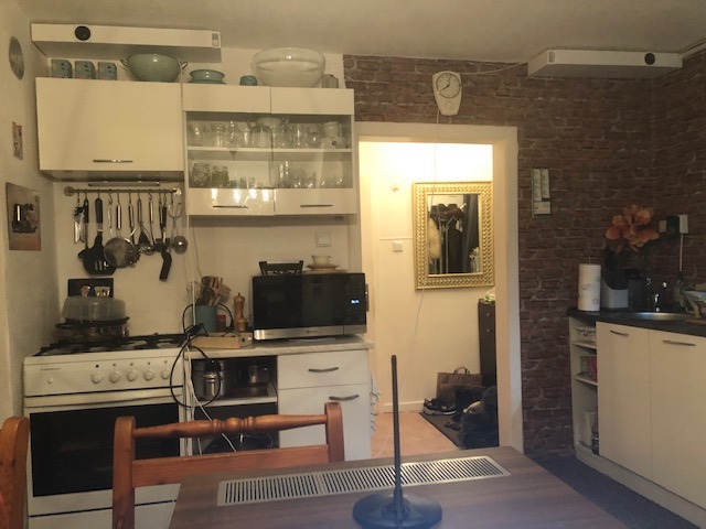

Very flat TABAQ and the best sounding kitchen in town.
Hello everyone. This is my first post. My name is Dirk and I am from Dortmund, Germany.

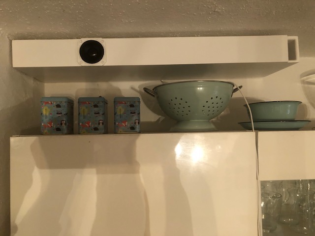

I built a TABAQ whose baffle is only 76 mm wide. Exactly as wide as the dimensions of the Peerless speakers. The cabinets are made of 9mm MDF and inside additionally weighted with leftovers of floor tiles. Otherwise, the cross-sections and damping comply with the specifications.
They hang in the kitchen lengthwise under the ceiling.

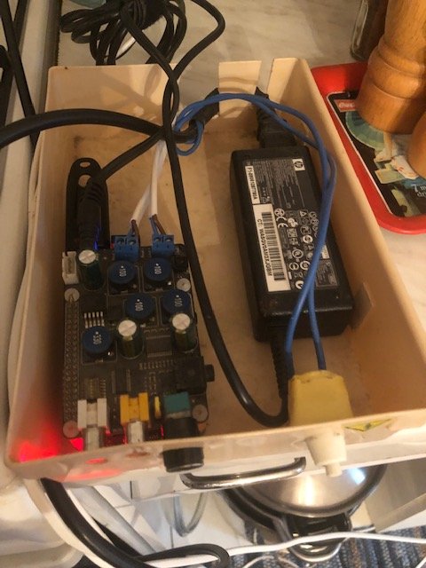

They are driven by a Raspi 2B with a DAC plugged in, which has an integrated 2*25 watt amplifier. At the moment everything is in an old lunchbox. Music software is the great music player Moode.

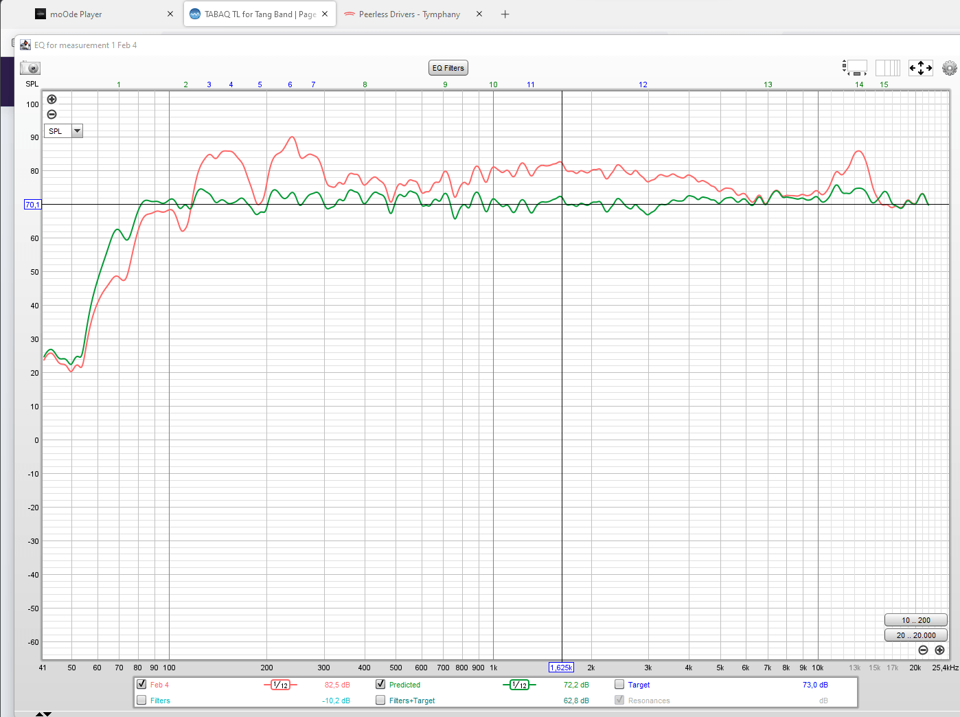

The disadvantage of the high position and narrow baffle is the need for sound correction.
I had to set around ten filters in the parametric equalizer.
Red: before
Green: with filters
Red: before
Green: with filters
