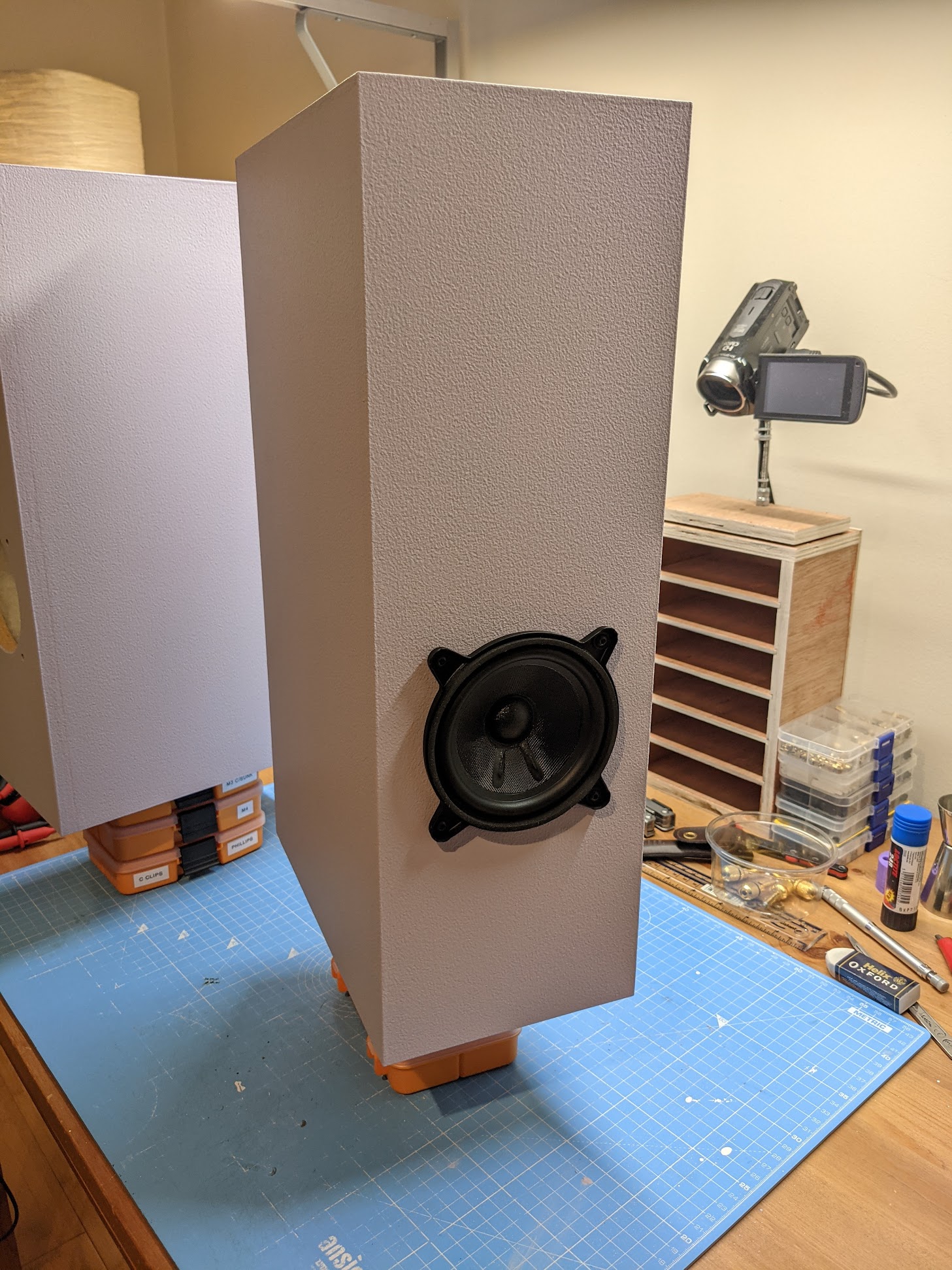

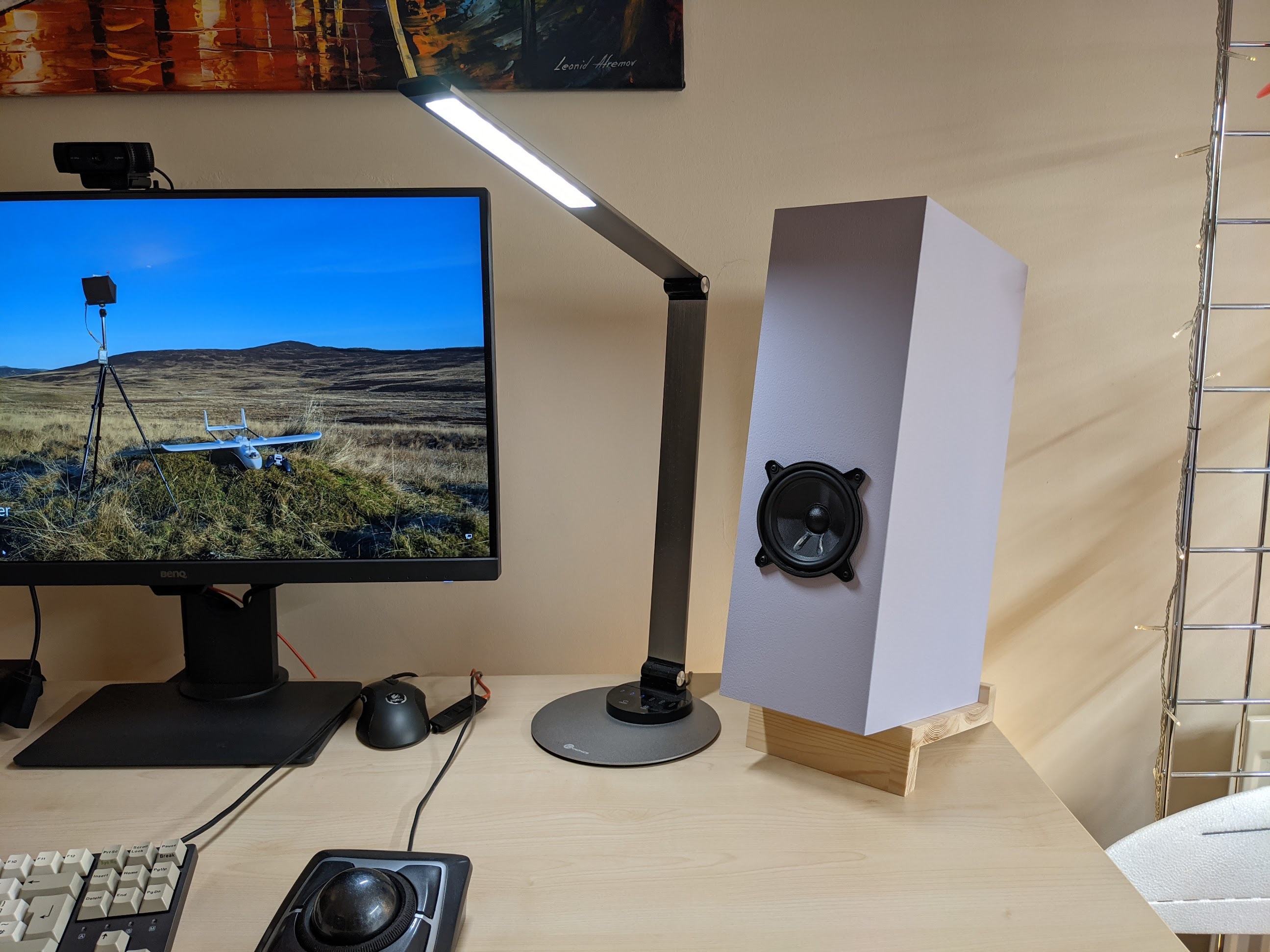

And now the finished product! This was my first time painting MDF & I think they turned out quite nicely considering.
Drivers are 4FE35 (ferrite) as the 4FE32 (neo) are out of stock. They are cheap enough I can easily buy the neo later if I want to compare. At first I thought they were very ugly, but now that I see them against the contrast of the light colour paint I don't hate them so much!
The wooden stands/wedges were made for my previous speakers, but the TABAQ Box sit nice & stable on them even though they overhang.

If you ever do get tired of the look of the faitals, you can cover them with a simple grille - 3d printed frame with cloth stretched over it and hot glued in place is what I did, looks sharp...

Nice!
That should be plenty for desktop speakers!
By the way... great taste in mouse/trackball ! Been a fan of the TurboMouse since the very first one! I can't go back to a regular mouse after so many years!
The only little annoying thing is that the scrolling wheel has stopped working after some update to the Mac OS so many years ago. But the first TurboMouse didn't have the wheel so I just got back to old habits.

Another option I was thinking about was either finding or printing some trim rings - I think I saw somebody earlier in the thread who found some generic ones on AliExpress that worked nicely.
It's regular wall/ceiling paint, applied with a foam roller. I followed the advice from Peter Millard, whose videos are also how I learned what a tracksaw is & how to use it! I was thinking about using spray at first, but with it approaching November here in Scotland it's just too cold & windy to spray paint outside & I don't have any indoor space to do it.
