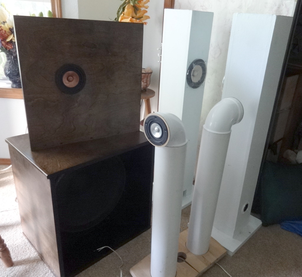

Being careful not to jack this thread; one is a tombstone shape I've shared in a "Lii Audio F15" thread here in full-range; the other, shown in the photo here, is my rendition of MJK's
"Jordan JX92S Open Baffle and Goldwood GW-1858 H Frame", using different drivers. You can see the MA Pluvia 7 HD on the 20 X 20" panel
Yes, folded, with the port firing out the front, so a little different than Bjorn's fold. I like the bookshelf form factor, so I have never built a tower version unfortunately.

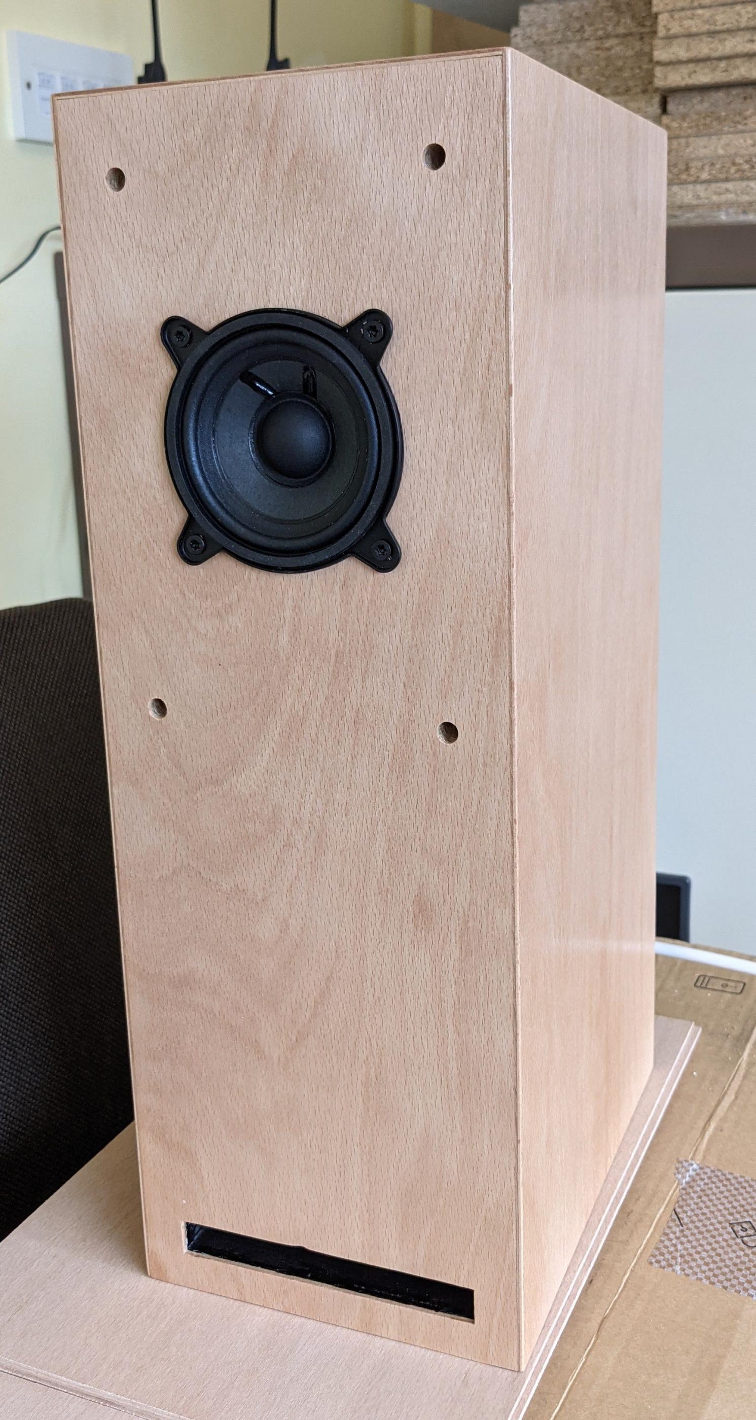

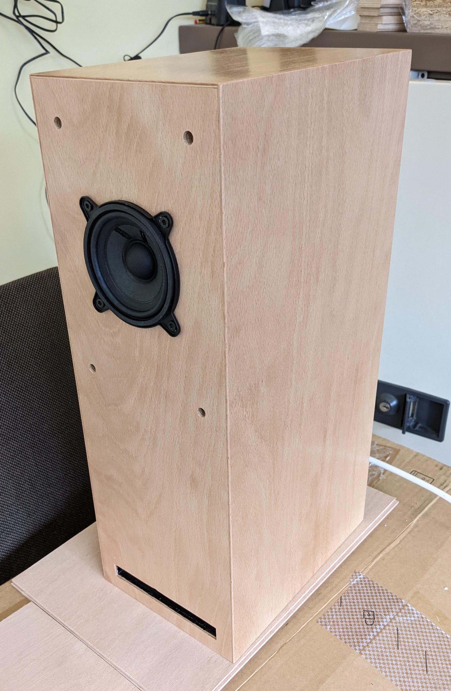

Hi All,
A while ago I posted a question about the 4" update by Bjorn Johansson. I have only received answer about the the original model (Thanks Perceval!), but I am stubborn and went ahead building the proposed model for 4" (More specific the 171 cm crossection pipe, the 22,8 cm crossection port and the 84g stuffing proposal for the TB W4 1320 SJ by Bjorn Johansson).
I am using the Tang Band W4 1320 SIF, which is very close in parameters to the unit mentioned above.

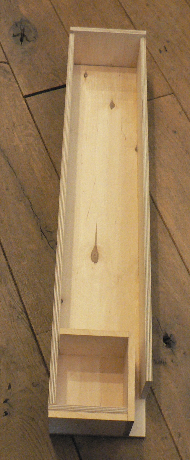

The chosen material here is 12mm birch ply, as this is stiffer than MDF. Also I kept to the proposed measurements, but slightly modified the design in order to get the driver closer to ear level, and at the same time dampening panel resonances and lowering center of gravity (the lower chamber will be filled with sand).
I have a question about tolerances in volume, specifically those of pipe and port. My port has a length of 9,7cm, but can I allow for a minus 5% difference in cross section or not?
Also I made a lucky mistake when sawing: This results in an extra internal volume of 0.3 Litres. Not a problem as I want to keep the back removable, and is just enough volume to allow for the internal beech battens needed for this.
But also here, to what tolerances are we working?
Kind regards, Roosje

The enclosure will not really have any problem if there’s a plus or minus centimetre here and there.
The vent is a lot more sensitive, but if the vent is supposed to be 9.2, and you are at 9.7, it won’t be too bad. The knee will have a slightly different than optimal, but the room will have an even stronger effect, so no worries there either.
