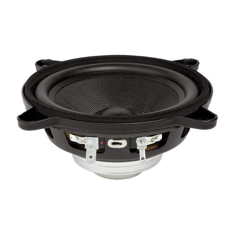

My FaitalPRO 4FE32 speakers arrived today. I was surprised just how small the 4” speakers were. It looks like the actual speaker cone is 3” in diameter if you don’t include the rubber mount to the frame.

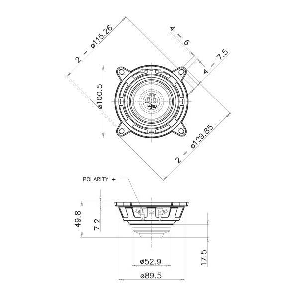

I measured the speakers and surrounds and it’s 5”
I am wondering if I make the front baffle 6” wide so that there is space either side the driver.
I am planning on a 15mm birch ply build but now wondering if I use 18 mm for the front baffle or stick with 15mm.
Am I right in thinking that the main thing is that the internal dimension is the same?
Would having a slightly wider baffle on affect the sound?
Also I don’t want to be, or sound stupid, but what dimensions would I need for the rest of the box to ensure the internal volume is the same.
Is there any effect, positive or negative on placing some bracing in the speaker or using sound deadening pads on the internal walls?
