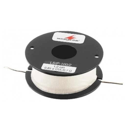

If they are suitable would I order the smaller inductor?
Another alternative is one made by Monacor which costs slightly more
Monacor 1.0mH Air Core Coil/Inductor 100W
Monacor :: Monacor LSIP-100/2 PS6.58
Inductance 1.0mH
Enam. copper wire
(Ø CUL)
0.85mm
Power rating
(RMS)
100W
DC resistance 0.7Ω
Dimensions 48x19mm

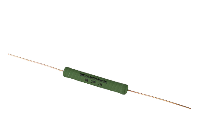

Also what value resistor should I order with this for the 4FE32?

15mm ply is fine.
The BSC with 1mH and a resistor is a starting point. Each driver will have little different performance so it’s up to you to like it or not, and to adjust accordingly.
The Faitals are quite strong up high, so, I would get a choice of resistors, maybe 5,8 and 10 Ohms and decide which one sounds best for you.
15mm ply is fine.
Thanks,
Which wattage rating do I need to buy for the resistors? The higher ratings tend to be cement type high powered resistors which I have read have a negative impact on the sound.

Those 1.10mH 0.90mm wire inductors should work well. The medium or small sizes are fine. As perceval pointed out – the 4FE32 drivers do have a harsh top end that needs to be tamed. They require a good number of hours (2 months in my case) break-in time also. I tried a few resistors but in the end, I settled for 8.2 ohm with 1 mH inductors. Yes, 10W resistors are good like the ones perceval posted. Mine are the white cement ones.
