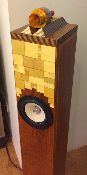

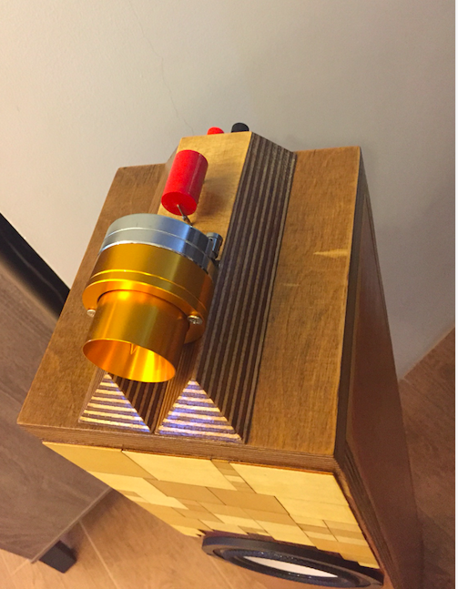

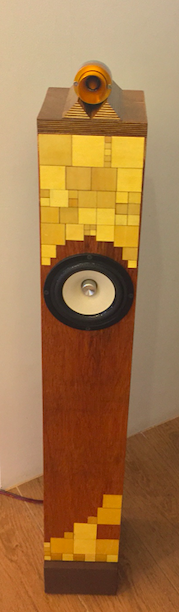

Finally make a definite version of my Tabaq with TB W5-2143, after I listen to my last Tabaq with Faital Pro 4FE32 for long time connect back the TB W5-2143 and I really missed the clarity and crispiness on mid/hight of the Faital so I decide to add an external twitter, now is perfect and match my expectations, with this tweeter also solved the beaming problem, just connected a 3.3 uF cap on the positive pole and that's it sound wonderful.....all the best to everybody

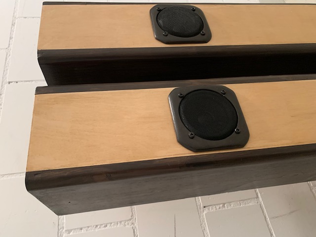

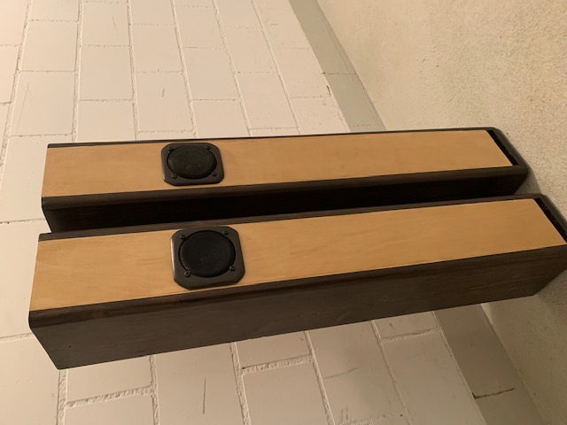

Hi Bjohn,
I am a happy Tabaq user since 3 years. I built the TABAQ box,and used in with 3 inch peerless. After seeing your update, I changed to 4 inch fullrange,. ( A Chinese rebranded import named Dainty). To me, this serves very well and I am extremely happy with it. Thanks for the design!
I have always wanted to hear how. the WIBAQ ( 8 inch) sounds. Space and WAF is the restricting factor for me. I just thought of an idea of using Two Tabaq boxes side by side, with two 4 inch fullrange, wired in series or parallel depending on the impedance availability. In this way, can I get a bigger SPL, with more power handling? The main advantage is the new box will still look like. a compact bookshelf, but got all the properties of a WIBAQ. Am I thinking right?
I just did a rough test by stacking side by side two tabaq ( one MDF, one foam core) , just kept as close as possible.To me, I perceive more bass , and If this works, and the principle is correct, I would like to build a new MDF cabinet, scaled for two drivers.
Thanks in advance
If you double the drivers, you will need to double the CSA, but keep the same line height.
The vent would need to be adjusted as well.
You will get better power handling, and a bit more spl, but you will not get lower bass.
Also, two 4" drivers do not equate to one 8" driver.
For example, the surface cone area (Sd) of the RS100 4" driver is 35.3cm2. Double that for two drivers, we get 70.6cm2
The surface cone area of the RS225 8" woofer is 213.8cm2.
As you can see, in this case, 4+4 does not equal 8.
You can do a 4 driver in bipolar config. Wired in series parallel you get 6dB more sensitivity assuming 8ohm nominal. Have two drivers face forward and two face backwards and there is zero baffle step loss. This buys another 6dB of bass amplitude but that may sound like more extension. So that’s about 12dB more than single driver below 1kHz, 6dB more overall.
The box is 4x CSA though - still manageable. Use four vents of same length.
Ryanj made something like this based on my design once. I think it worked out well - people thought there was a helper subwoofer going on.
