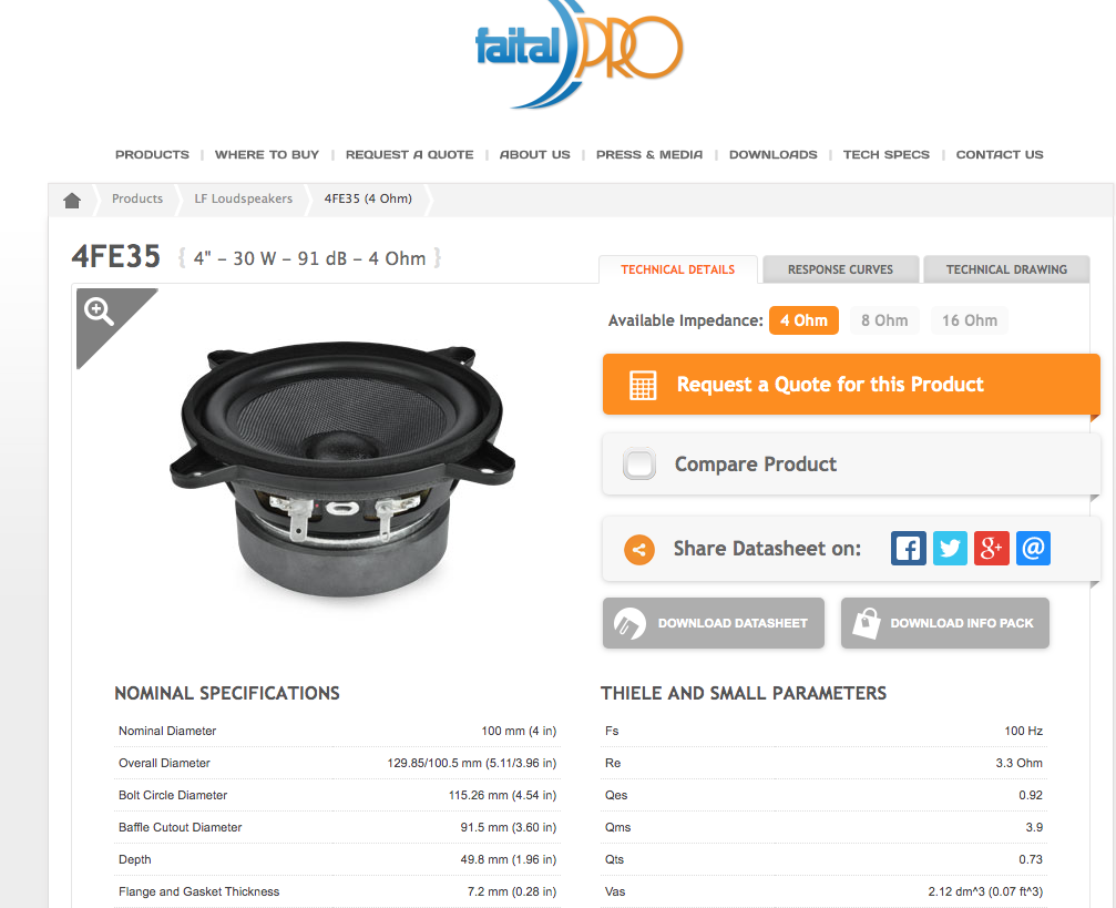

Actually Ghiro is right here screen shot from Faital official website.

Ready for my first build but concerned about the speaker depth difference between FaitalPro 4FE35-4 and 8Ohm versions could end up with differencies i'am not skilled enough to fix. Any help or suggestions?
Ghiro, so your 8Ohm Faital drivers have 8.5mm more depth than the 4Ohm drivers. That should not be a problem at all - the inside depth of the enclosure is 128mm - plenty of space for your drivers even if you mount them on the inside of the baffle. Go for it, enjoy the build and please share pictures and your impressions.
Then, there is a mismatch on FaitalPro's website.
The landing page shows one to be 58mm deep, and the other 49mm
But... If you click on the technical drawings, they are exactly the same size, both at 58.3mm.
I guess I would trust the tech drawings more than the person who copied the data on to the webpage.
The TABAQ design is quite forgiving, and like two cents mentioned, the volume occupied by a 4" driver with a different depth of 8mm will no matter in the overall response.

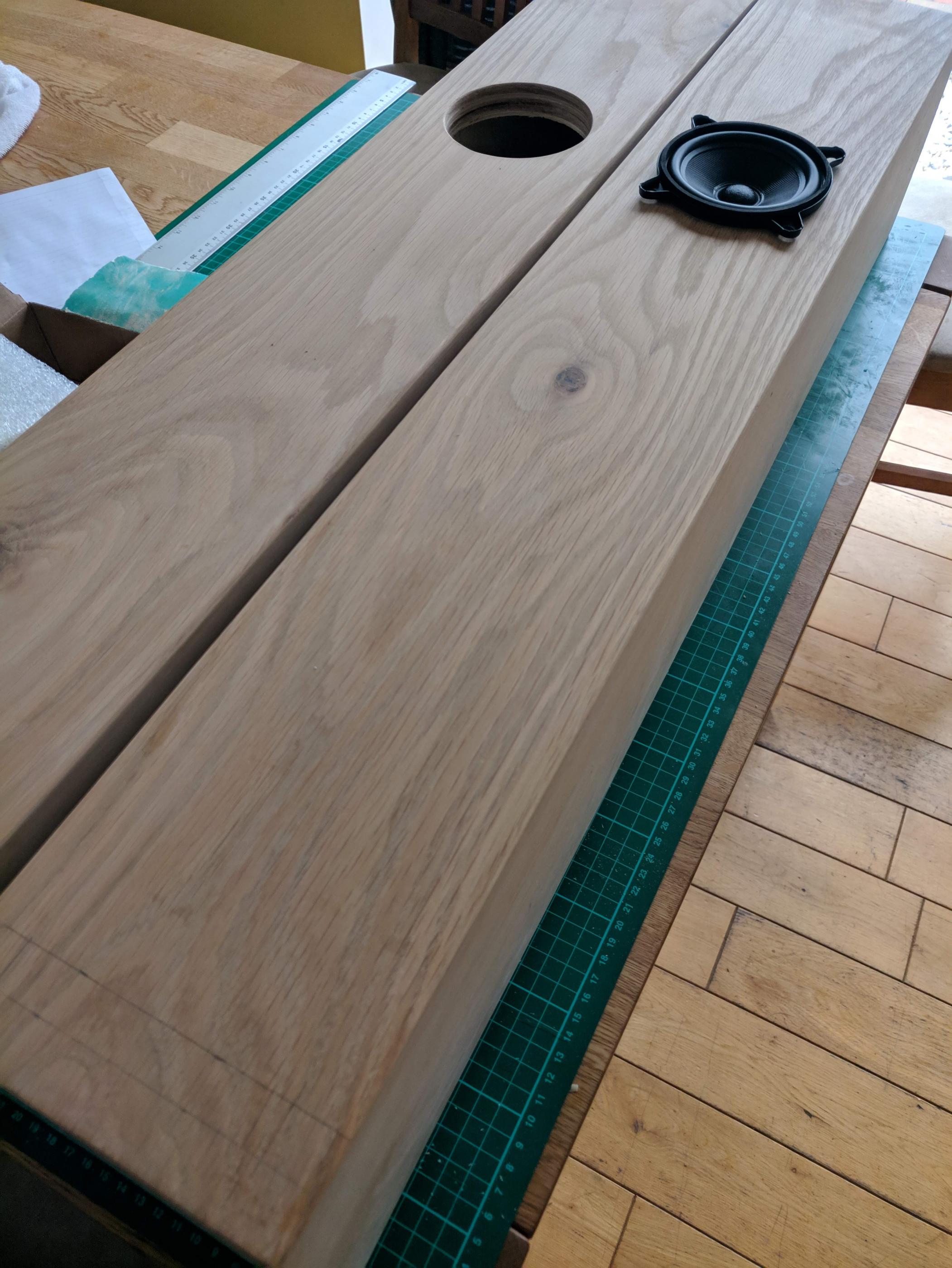

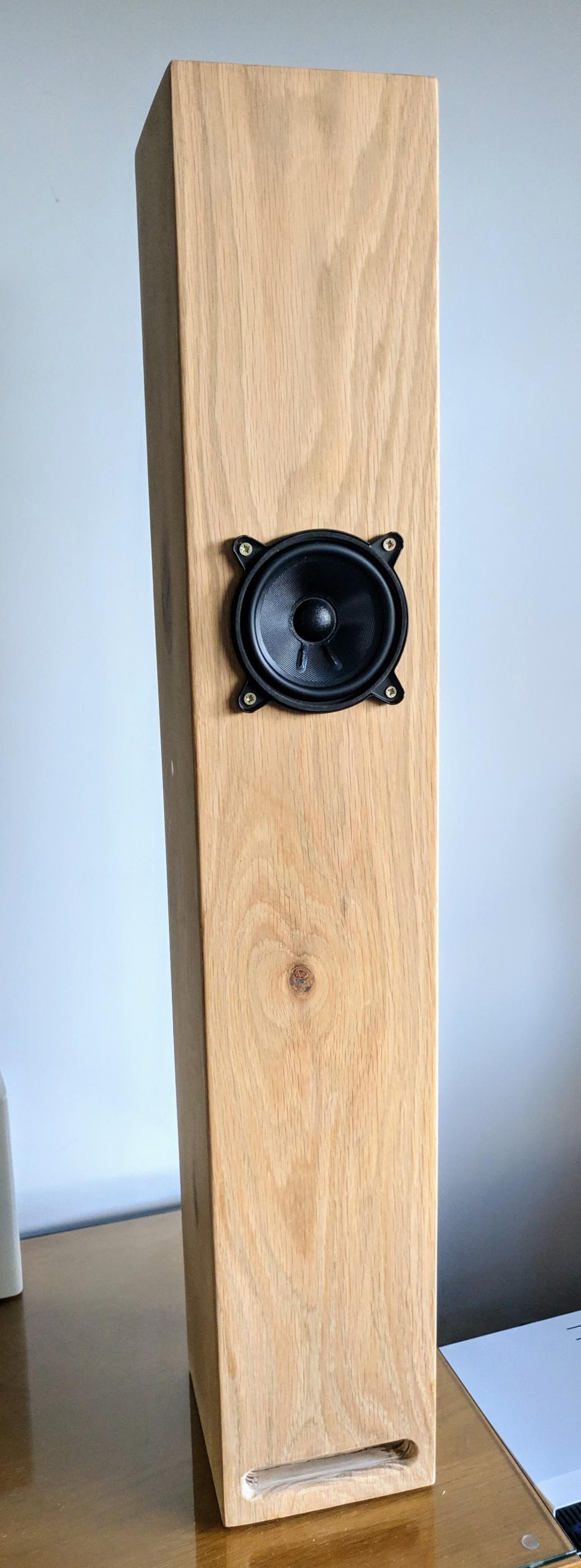

Can I please have some clarity on the TABAQ port size? In the plan I have the internal dimensions of the box are 12.8cm x 10cm x 80.8cm.
The port is 1.6cm tall x 9cm deep. Is that correct?
I should mention I am using the Faital Pro 4FE32 4" driver and have placed them 26cm from the top end.

Yes, you are missing a (notch) filter.
I can't comprehend how people listen to speakers without a filter...
Baffle step etc needs to be compensated
Well, I guess that is just us Germans wanting to do / make things as good as possible.
Thanks for your input. I would very much appreciate it if you could talk me through exactly what this means? I've only built full range speakers in the past and haven't looked into filters or crossovers of any kind.
Thanks in advance.
