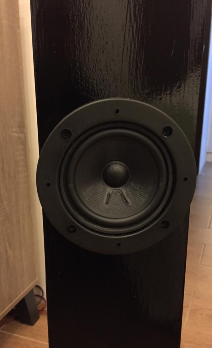

I did not add yet the BSC, I want to try first as they are without it also because I am using a tube tone stack bass/mid/treble so I can compensate, in fact I had to lower the mid on some records, but anyway I will do the BSC in future and see if I like it. If you talking about the ring that I add to the driver is not wooden but plastic I got it on Ali 2 Pcs Universal 4 Inch Car Speaker Solid Washer Adapters Brackets Speaker Mounts Plates Speaker Gasket for Cars-in Speaker Mounts from Automobiles & Motorcycles on Aliexpress.com | Alibaba Group, I really did not like how the Faital's looks with the open basket and visible fixing screws but now they are more acceptable with this simple plastic ring, thanks again Perceval for your work and help 🙂

Here you can see the ring better how it looks, the only problem is that is 4mm bigger than the enclosure but still acceptable, using a 16mm plywood the enclosure comes 8mm wider 13.2cm instead 12.4cm

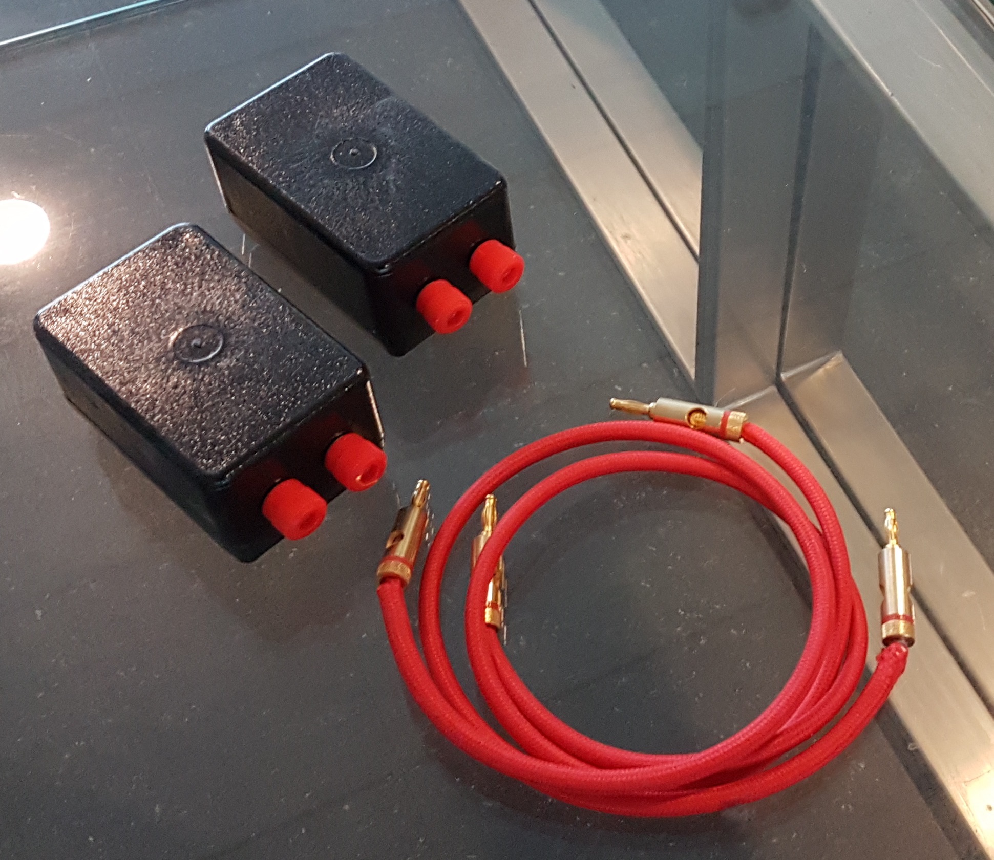

About BSC: I use external filter, so it is easy to test with / without filter or modify the filter (more Ohm). See picture attached.

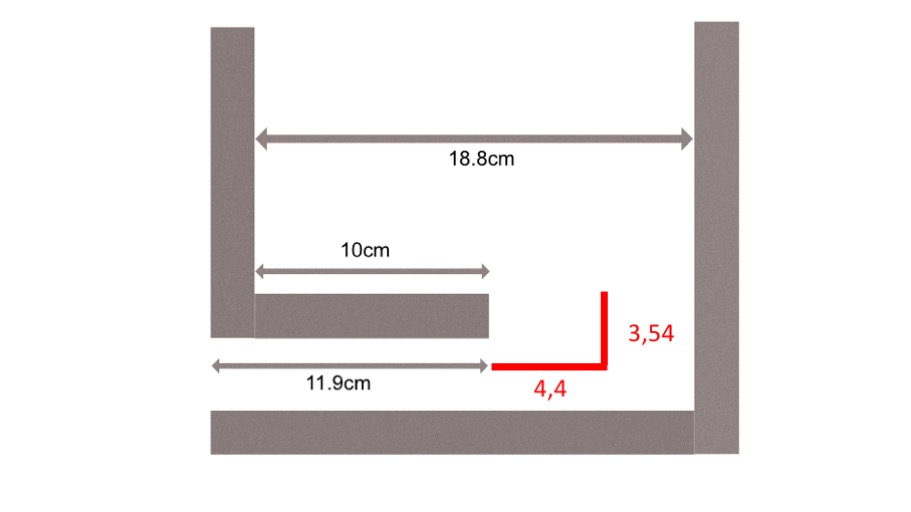

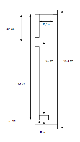

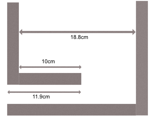

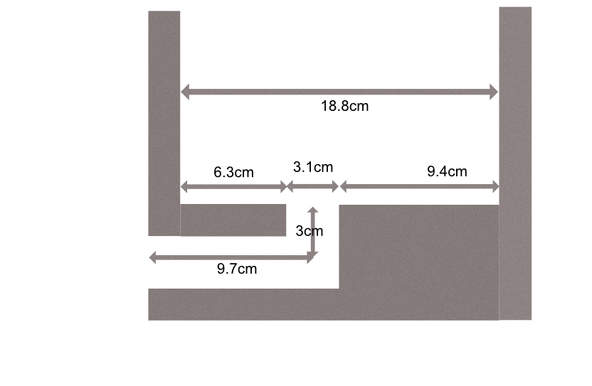

Hello Bjørn,
I got myself a pair of W5-1611SAF for the TABAQ large.
I was just going over the drawings, and wanted to double check something...
You mention that the vent length is 12.7 cm.
In the drawing, the vent is 10cm block with 19mm MDF baffle, that's a length of 11.9cm.
Wouldn't that come too short a little?
Your drawing vs real scale drawing of the vent:

Hi perceval
The port is actual too long. My bad 😀
Take at look at red line in the image enclosed.
The drawing has to be adjusted, which I have not done yet, but I am sure you can figure it out. There need to be a pice of wood at the back wall and the 10 cm shelf should be adjusted.
Hope this helps !

Hi Perceval
Your 3 cm is not 100% correct.
The length of the bend is
Half the hight of the port: 1.55 cm
The thicknes of the 6.3 cm "bottom": 1.9 cm
Total: 3.45 cm
The 9.7 cm is actually 9.75 cm
However, this is not a big thing.
Hope this make sense ?

Great ! Thank you.
Together we manage.🙂
Normaly two half brains is not working. 0.5 x 0.5 = 0.25 😀

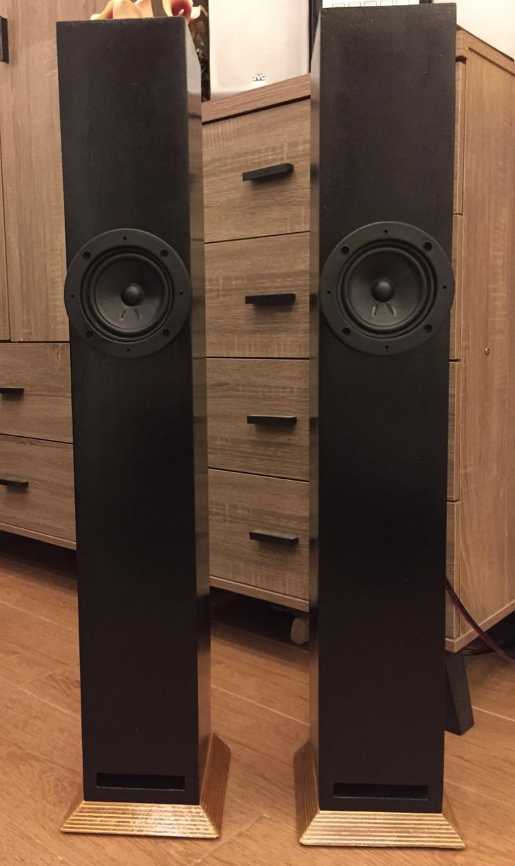

Finally finish the second Tabaq with Faital PRO 4FE32 , I decided to do not try the BSC I really love as they are, I can manage over the tone control so really no needed in my case.
After tested with all kind of music I realise once again how fantastic are this small driver, but the thing that really stand up is how they working at a very low volume, clear and incredible full body low freq. for a total warm music experience, the SPL of 91dB really make a difference especially with tube amp.

The 15cm internal width for the W5-1611saf TABAQ large is correct?
Yep!
