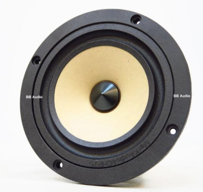

This one looks like the same, actually this driver is very similar to Markaudio drivers, anyway here the link [USD 44.84] British heli birds full frequency speaker 4-inch monitor speaker speaker machine is better than Mark Japan speaker CHP75 - Wholesale from China online shopping | Buy asian products online from the best shoping agent - ChinaHao.com
Good find, Kiss.
Yep, that's the one. I'd have to check if I got the 4 Ohms or the 8 Ohms...
I'd say, if you plan to use it with a small Class D board amp, get the 4, if using a regular old school amp, get the 8 Ohms version.
Pretty good driver, sounds ok-ish by itself, but great with a small notch from 3 to 9kHz. Drops pretty fast after 14kHz though, as most of those 4" drivers do.
Funny they say it's better than a MA driver... never got the chance to hear a MA driver yet... Almost got a couple of pairs over here, but the shipment from HK was overturned, saying it was "contraband" material.... funny translation, I guess! The joys of government regulations....

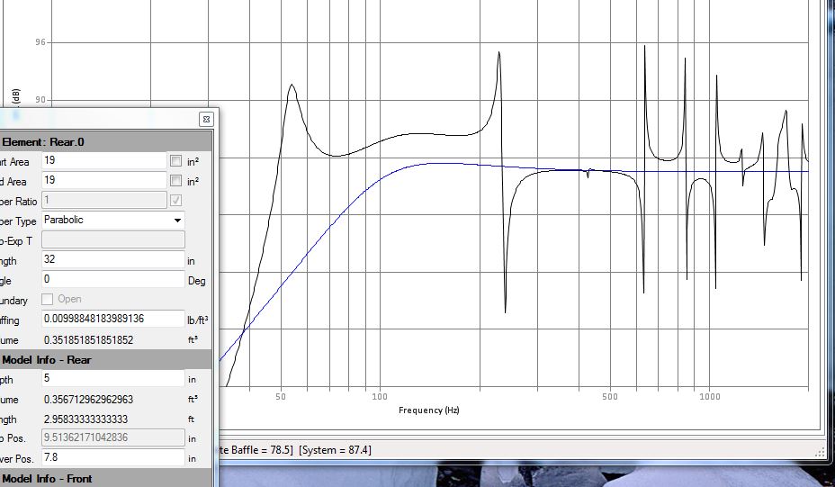

I have now spent some time modeling in the Leonard audio program. That program pretty much duplicates Martin King's program except it does not calculate stuffing correctly, but it is an easy way to start.
All the drivers I have modeled have basically the same issue of a strong peak around 55 hz that dips down around 70-75 hz. In my limited experience that indicates the volume of the cabinet is too large for the driver. I am using a cross sectional area of 19 sq in (122.5 sq cm), a length of 32 inches (81 cm) and a port 2.4 sq in (15.5 sq cm) and 3.5 inches (8.9 cm) long which I think is pretty close to the original Tabaq dimensions.
An example of what I am talking about is attached. The attached graph is for the Peerless 830987. Is the stuffing supposed to take care of the peak?
If you transfer Bjorn's stuffing weight for the original Tabaq into Leonard Audio, all the LA stuffings are very light. Enter stuffing weight manually and start at 3-4kg/m^3.
Might be useful to duplicate the model in Hornresp with the TL wizard.

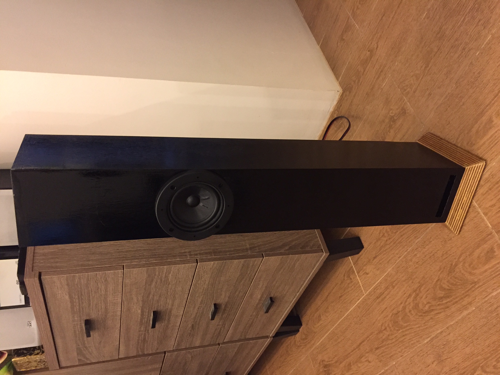

Tabaq original with Faital Pro 4FE32 8 ohm, what can I say well I am shocked, there is no other word for describe how I feel at the moment, when I received the package from europe I thought dam it they mistake the driver, when open the box the driver look so small and no wait at all so I doubt to get a good performance, but how wrong I was and so happy to be wrong. I immediately test with some song of Buble and Buddy Guy and compare with my other Tabaq with TB W5-2143 and immediate come up the more clarity on mid freq., low freq. very good also, less punching than TB but with more body , high freq. just perfect. I used marine plywood 16mm, then treated and painted in glossy black, that's how my wife want the design, fair enough considering she will be the user. Again I cannot find word for describe my gratitude to Bjorn and Perceval.

Did you make a wooden bezel for the Faitals?
Glad you like them!
Of course they will have less low end reach than the W5 TB, but the 3" FP will not be beaming as much, so the highs will have a better spread. Plus, they are drivers recognized for their clarity... Sometimes a bit much. Did you add a BSC?
Particularly nice that the wife loves them! . That's a big plus!
PS. I like that base plate!
