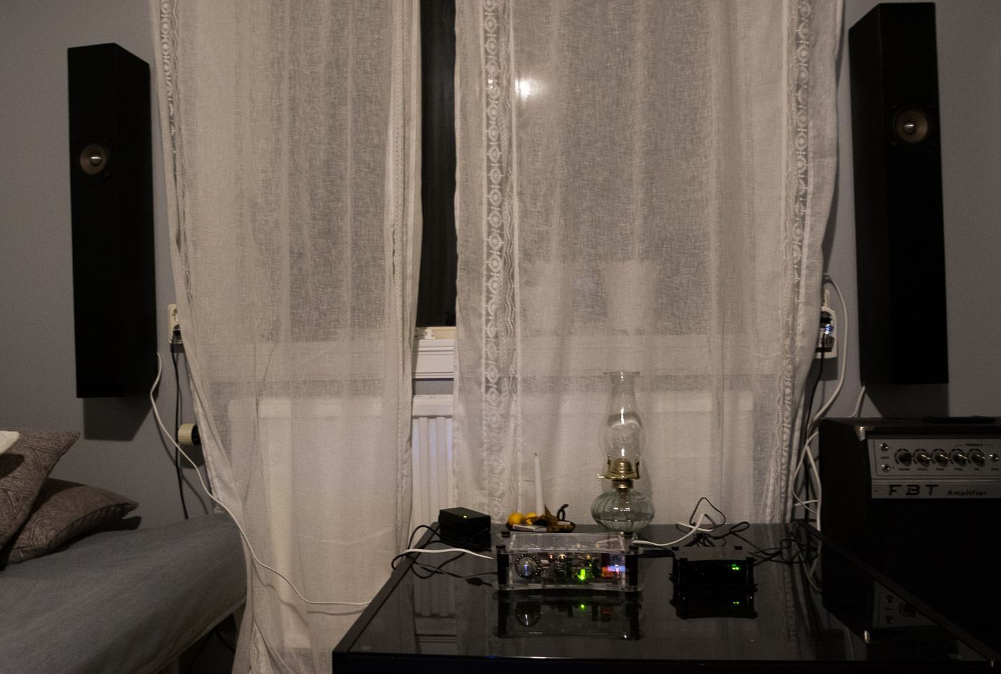

I had to dust of my W4-1320SJ whith:
Rasberry Pi 3 + Allo Boss + Volt+
and Volumio with Volumio Parametric Equalizer.
I can hear 30hz!
And I'm surprised how good it sounds after this years!
Post #2 in this thread.
Solve, very cool!
Nice little setup! I also like Volumio.

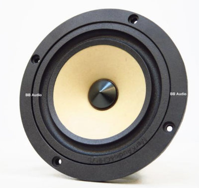

I have done a set of TABAQs with this one:
2 PCs/lot Sounderlink 4 inch full range speaker woofer tweeter midrange driver for Diy HiFi monitor stage audio system-in Bookshelf Speakers from Consumer Electronics on Aliexpress.com | Alibaba Group
They were quite good, but need at least a notch filter, or two.
I actually went around that by using a little tpa3116d2 amp with bass and treble controls, and with some small adjustments of both knobs, I got a very good looking FR and pleasing sound
The best Chinese ones I made so far, although still needed a notch filter, are these... but I just can't find them.
attachment.php
