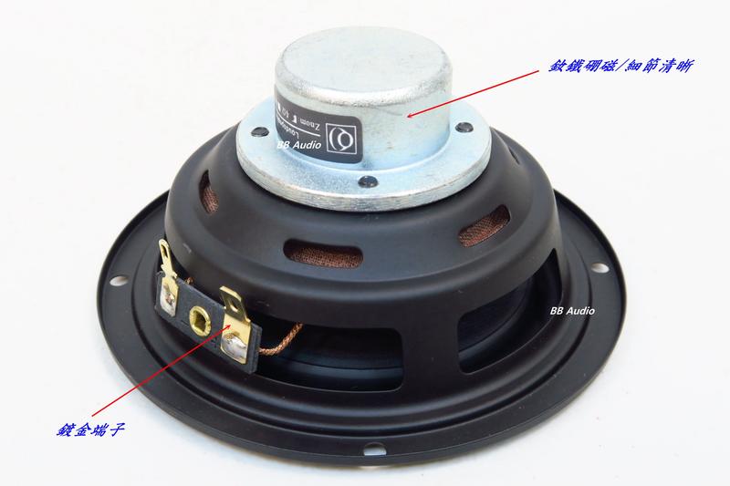

Which drivers did you use Jeff? I just took delivery of Peerless 830987 drivers, and the wood was cut earlier this week.

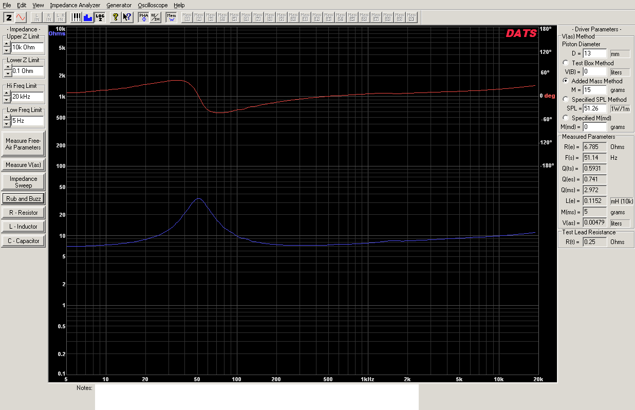

Chinese or not the response curves looks very flat to me. Would you like to post small-thiel parameters of this driver as well as the company and their price ?

The graph is from DATS, so you are seeing the phase and impedance curves, not a frequency response.
Also, no data from the company besides the ones I can gather in DATS.
It's typical over here. No data besides the size and the weight of the driver.
That's why it's always a surprise when I take a chance on some local drivers. 🙂
One could probably find this driver on Aliexpress.
Price was less than $20... I'll look it up again.

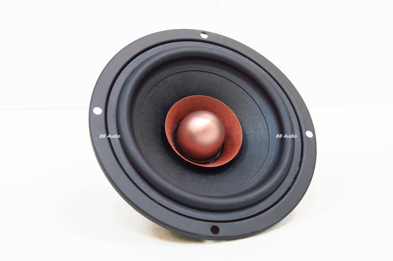

Found them on Aliexpress.
Although mine were the 8 Ohms version.
$38 for a pair.
They have some info, and maybe even a real video of it.
I know I added a small notch to compensate the rising FR and balance it to my liking.

It looks about right, what I can remember of this driver, and I added a small notch on top to bring that that HF hill.
