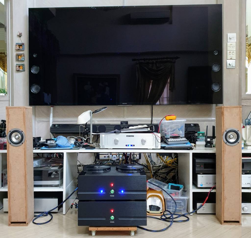

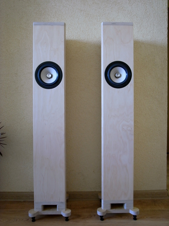

A TABAQ with W4-1337SDF is born today, it is connected to ZM SissySIT. How does it sound? Wonderful! Wasnt expecting the sound to be so full. Thanks to Song for his help in putting the TABAQ together and Bjorn for sharing the design.

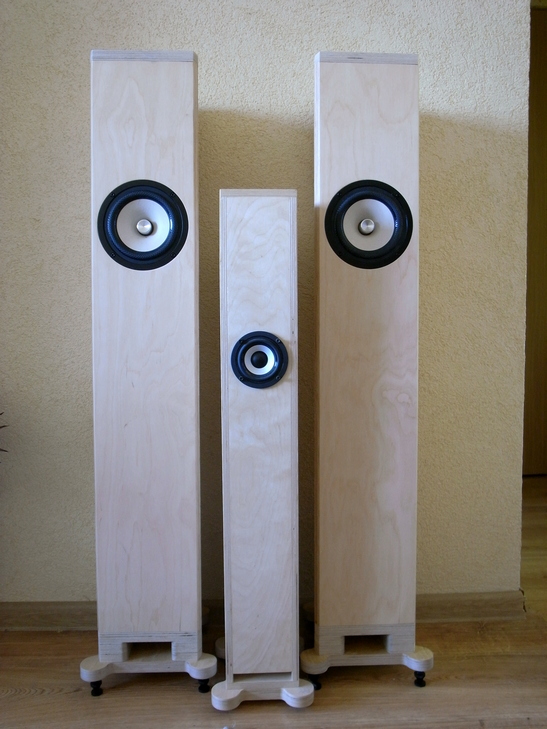

Recently finished TABAQ's with Tang Band w5-2143 . They're much bigger comparing to "standard" TABAQ's.
Very good results.
Many thanks to Bjørn for calculations

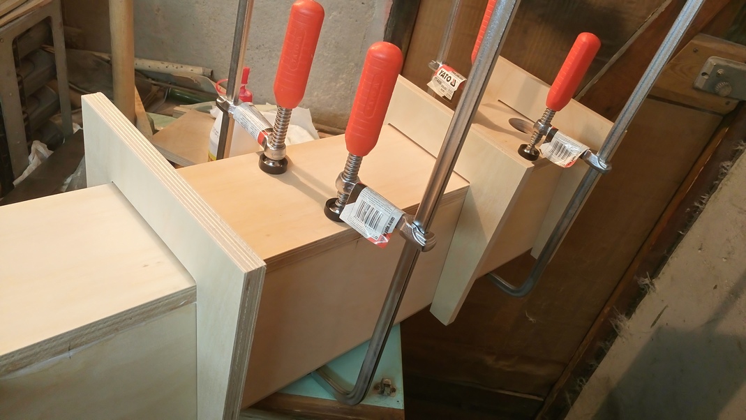

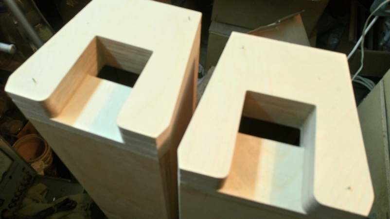

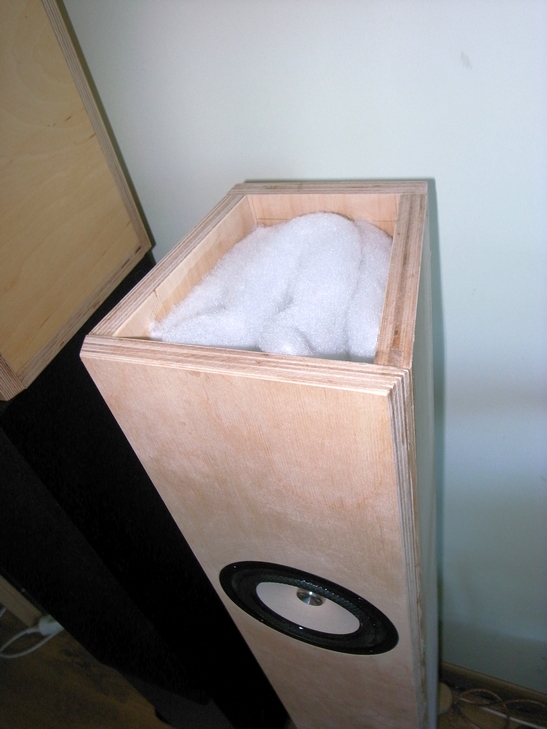

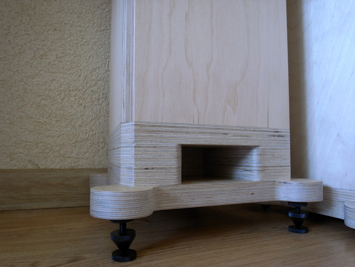

Pictures from building process, not so good quality. They explains the design more. Everything built from 18mm plywood, except the base with feet is made from 21mm and stuffing holder from 12mm plywood.

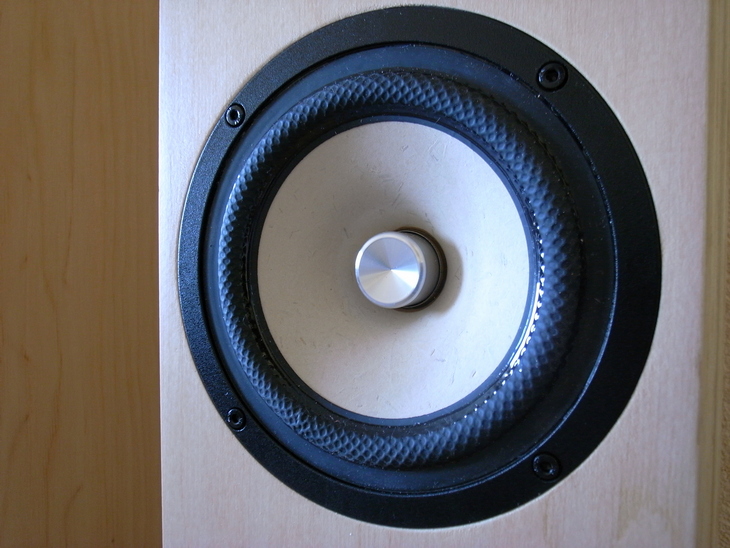

Gytisk, Very nice indeed... attractive looking. How many hours do you have on the drivers? I will be interested to read of your experience with their bass capability and voiceing ability.
Thanks plund,
drivers are new, currently not more than 20 hours with variuos music, mainly rock.
My room is quite small, 13 square meters, speakers standing near wall, there is enough of bass in TABAQ enclosure. Regarding voices, first impressions are good, may little to bright, but need to investigate more, because currently listening with D class TPA3250 amp, which are bright too, later will try with A class amp. I think directivity could be better, but in general is OK.

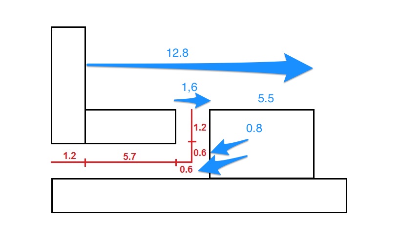

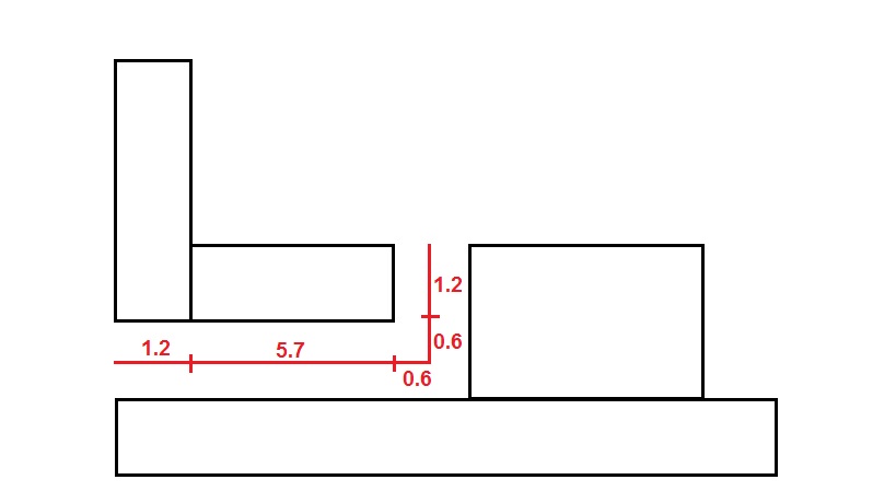

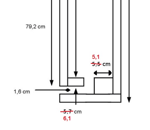

Vent path length
I am planning to build TABAQs with the Peerless 830987 Drivers, using the plans given in post #2018 (TABAQ UPDATE 2).
But the vent path length (through the centre) according to me is 1,2 + 5,7 + 0,6 + 0,6 + 1,2 = 9,3 cm, and not 9,7 as stated on the plans. If the vent length must be 9,7 as Bjorn also indicated in post #2266, then should the measurements be changed as suggested, or am I missing something here? Not that 4mm is the end of the world.
