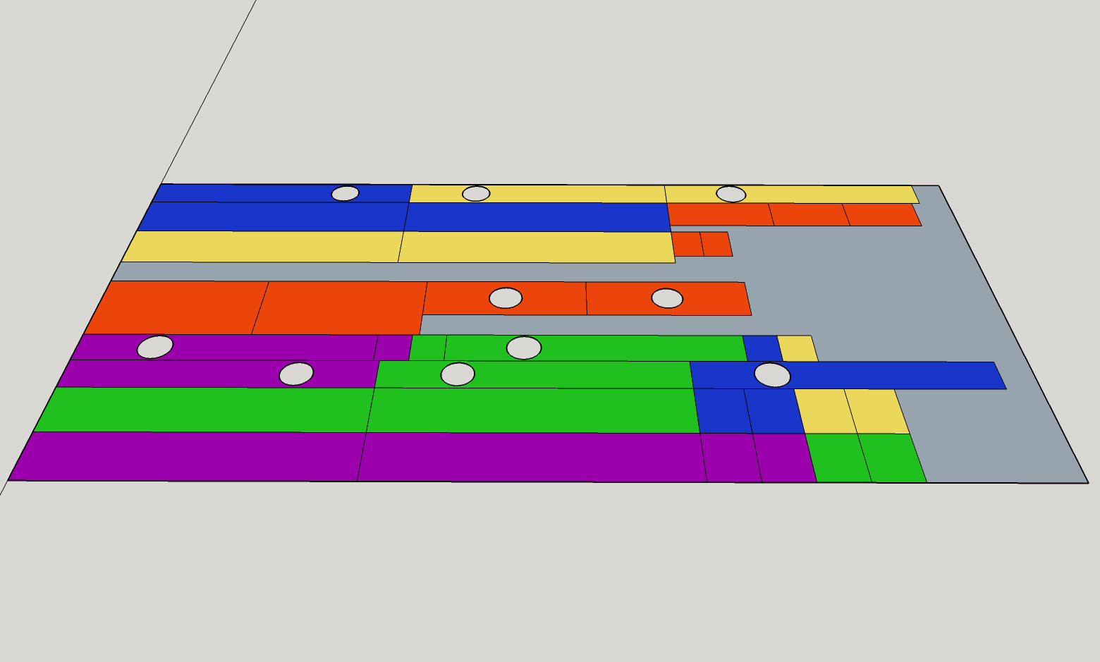

When I made my Frugal Horn MK3 I really appreciated that you could build the pair from one single sheet of MDF/Plywood. So started playing around in sketchup.
See included image to see what I came up with
The colors are to help me make sure I've added parts for all 5 speakers.
You see, this will allow us to build a 5.0 system of Tabaqs from a single sheet of mdf/plywood.
I've gotten a quote for having them CNC-cut at a woodshop 2500sek or ~260USD for the first run where they need to do some CAD work.
So, is my idea useless or good? will I break any rules if I make these and share the CAD file used for cutting it?
I've done something stupid.
Hey blompa, not sure why you say this?
Well done for getting 5 speakers cut out of a single mdf/plywood sheet. You will not break any rules for sharing your CAD files, but you will need Bjorn’s permission if you intend to manufacture these speakers and sell them. Go ahead and build them – we are waiting for your listening impressions.

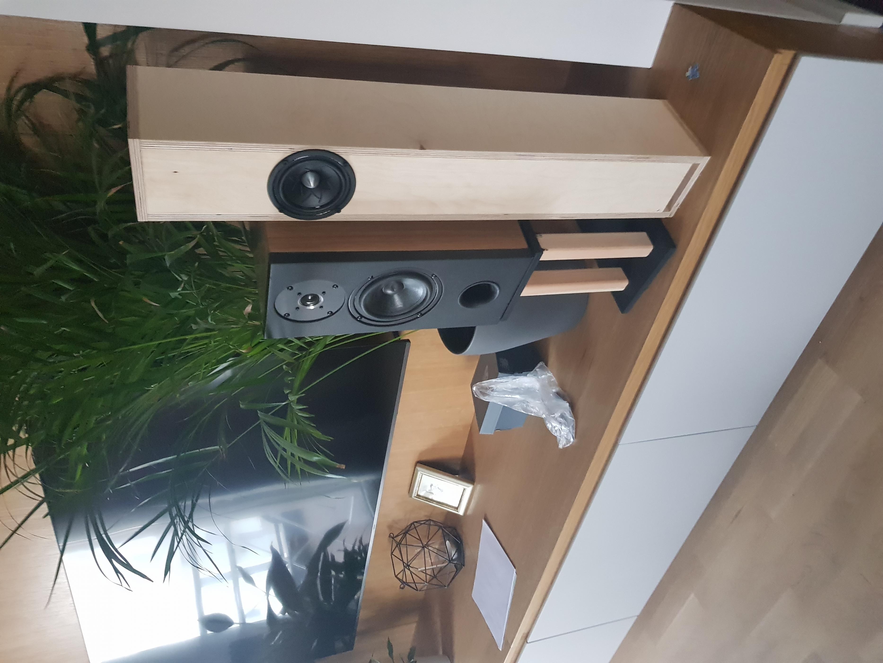

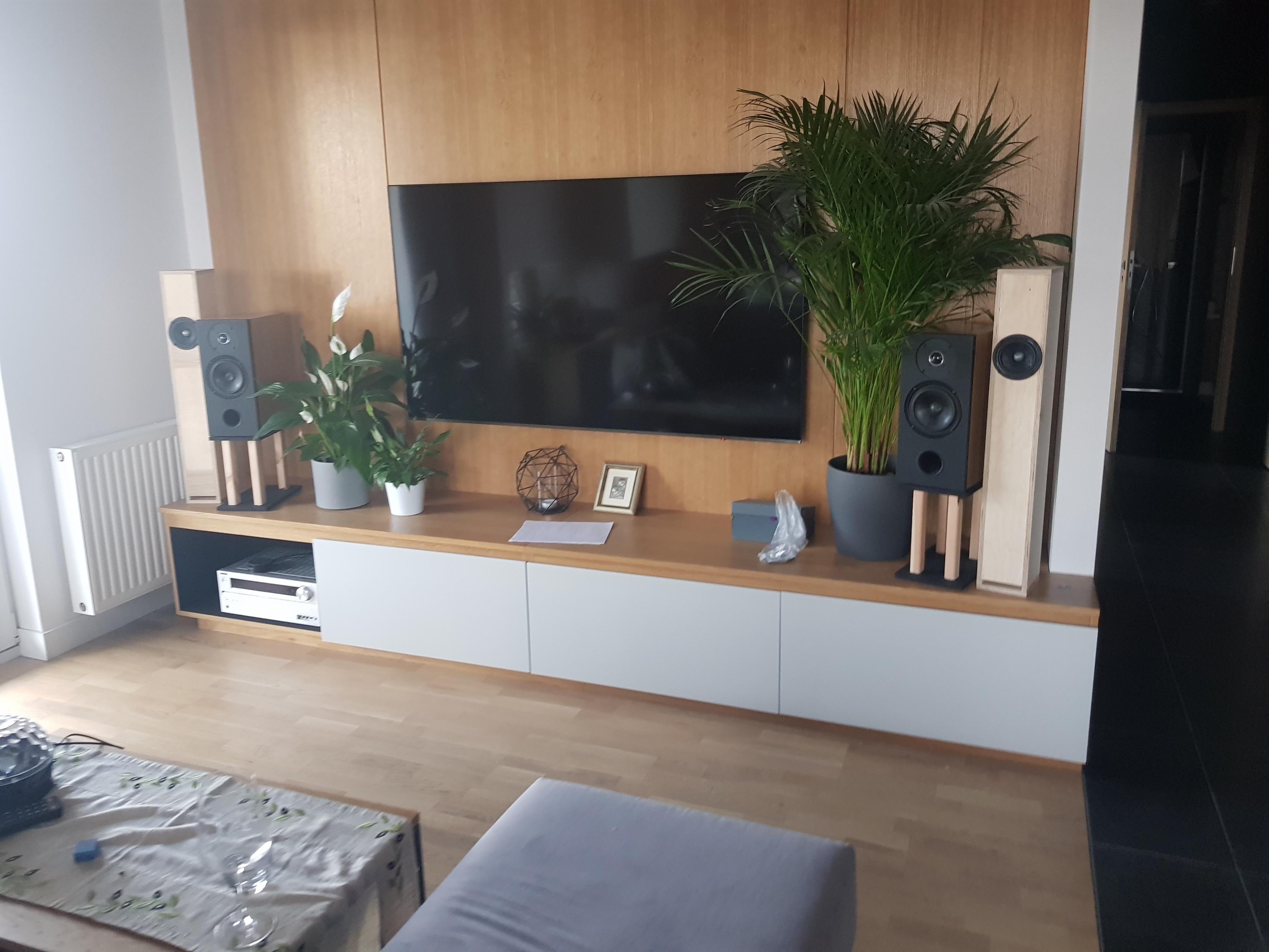

Hello Guys,
I have read almost all pages of this thread and decided to try build tabaq by myself. All i can say its hard when You do all that stuff just in flat🙂
Due all of this i end up with speakers like in pictures🙂
Now i wonder how i finish them and i think i will paint all parts on black besides side walls on which i put some lacquer.
Right now i put about 75g stuffing in each speaker, its correct?
Thanks all for that thread, its a ocean of knowledge🙂
The last thing, i cant really say something about sound because i listen to them for about 10mins😉 right now all i can say they are pretty cool for a 4" speaker😉

Hello Guys,
Beautiful built congrats, if me I will sand very well the plywood as it is then 3/4 coat of polyurethane transparent, after every coat 600 grid sand paper lightly, for every coat at least 24h for get dry then sand then paint again, if you like a more dark effect before the polyurethane you can use coffee for stain the plywood....enjoy the music......🙂
Well. I have neither need nor really space for them. I also lack a surround receiver to run all 5. 😛 That's why it is a bit stupid.

Thanks. Good to know. I have no plans regarding commercialization. If I go through with this I will try to share the cnc cutting plans if they are given to me.
Well done Saided - they look great from here, even if you don't have a workshop. We are interested in how they sound (and how do they compare to your other speakers), and what drivers did you use?
Meny thanks😉
Just need a bit more time listening to them to be able to compare them with other diy speakers of mine and describe how they sound.
What about driver, i used the tang band w4-1052sd.
Thanks a lot to all of You for such a kind words😉

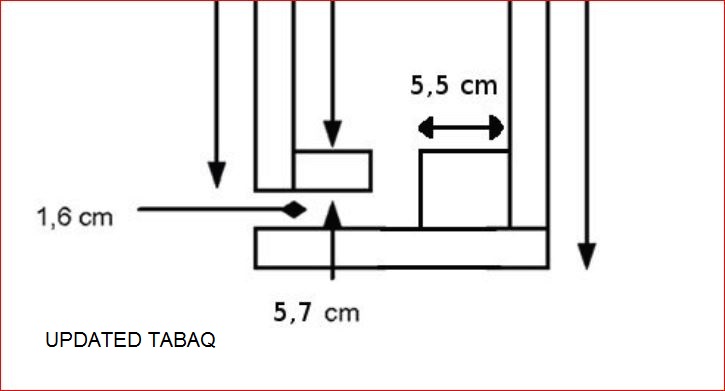

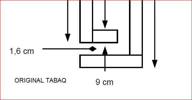

Confused about which plans to use
Dear Bjorn and other fellow builders,
I have built a few tube amps and am now venturing into speaker building. I can do decent woodwork (or let's say, I will try...). I have read all the thread over 2-3 weeks but I'm somewhat confused about what plans are the correct ones. I have bought two pairs of drivers :
  • Peerless PLS-P830987
  • Faital Pro 4 FE 32 A
Am I ok with the plans "TABAQ UPDATE 2.pdf" from post #2511 ?
  • page 2 of the plan for the 4" ?
  • page 4 of the plan for the 3" ?
And everything is in 12mm MDF, correct ?
Sorry if this sound a bit newbie but I'd rather not build it twice...
Thanks all for your dedication !
Charles
Hi Charles - welcome here. If I understand the difference between the original TABAQ and the updated TABAQ plans, the only difference is in the length of the port. So,
For 3” drivers (i.e. P830987) => use the updated plan with the 9,7 cm port
For 4” drivers (i.e. 4FE32) => use the original plan with the 13 cm port
In both cases you can mount the drivers 8” (20,3 cm) from the top.
If you build two sets of TABAQs – one set with the P830987 drivers, and one set with 4FE32 drivers, I would be very interested in your listening impressions comparing the two. I’ve built TABAQs with P830987 drivers for a family member, and I was really very impressed. Now I am considering building a set with 4FE32 drivers for myself, simply because I can source the 4FE32 drivers locally at a very good price.
I see you have built tube amps, so just be aware that the TABAQs with P830987 drivers are not very efficient and will require a 25W amp.
