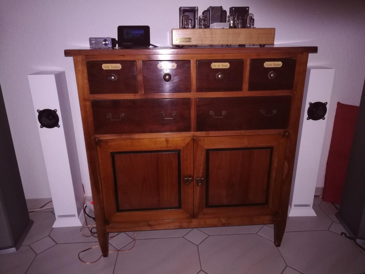

I'm finishing my first Tabaq pair using the Faital 4FE32 in 12mm MDF. The case are decent thanks to the precise cuts of my local shop.
However I'm having a hard time getting a nice surface with my paint process, the issue being edges (and my painting ability...). What is the common practice, can I round them so the paint is continuous ? I did a very small softening with sand paper, but maybe using a short-radius router bit is preferable ? Or would it alter the sound emission ?

Charles,
Did you seal the MDF before you started finishing? Are you concerned about the joins showing through the paint?
My process for finishing with paint is to put on a spit coat of sealer ( thinned sanding sealer ) then a coat of full strength sanding sealer. These will not take long to cure usually. Then a light sanding, heavy sanding should be done prior to sealing. Once sealed apply primer and sand lightly with 100, and then 225. Unless you are doing an automotive gloss type finish that will be smooth enough to apply your paint.
If you are looking to do automotive gloss type finish then the advice kissabout2002 gave regarding successive layers of primer and sanding to 400-600 is good advice indeed.
I find that trying to prime un-sealed MDF results in wasting a lot of primer before your done...

See my build thread for some pics of how I finished my TABAQs:
TABAQ with FaitalPro 3FE22
I made my boxes from some pretty rough chipboard, but I chamfered the corners, and then filled the edges with wood filler. The ones pictured in my thread I then spray painted since I was in a rush, but the next pair look even better because I used 3 coats of good quality satin finish exterior acrylic paint applied with a roller. The roller creates an "orange peel" effect which effectively hides any surface imperfections in the less than ideal surface, it's a technique I learned while working for a sign maker. I can post some pics of these if you would like to see what I mean...
Can't see how chamfering your corners would affect sound quality, but one of the experts will have to weigh in...can't say I noticed any problem with my speakers.
Luigiman, Mightym and kissabout2002 thanks for your inputs.
I made several errors in this first build... not chamfering the edges enough, not using a filler, etc. I used acrylic paints starting with a primer for MDF, then a primer acrylic and a finish acrylic white satiné.
It's not so much of an issue as they will go into a student's appartment and they care more about the sound than the look. My son already asked if I made them white to allow for their permanent customizations and autographs with a permanent black marker... luckily I live far enough to not see how they live...
anyway they are dring the last coat and when the drivers are mounted and the base are screwed in I will post some pics. Thanks again for the hints, will study primers and sealers before making the next ones.

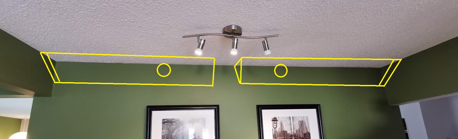

A question - is the idea proposed in the attached picture feasible? I believe there are 2 considerations:
1- Can the footprint be triangular, if the same cross-sectional area as the rectangular version is maintained?
2- Will the ceiling & wall significantly (and/or negatively) impact the speaker response?
The footprint can be any shape as long as the cross section (area in cm2) is the same.
The bass will get a lift when placing the cabinet like you want. But the line is well stuffed so I do not expect the bass to be too dominanting. You could add some stuffing if needed.
why not flip both around so the drivers are further apart, might be better for stereo separation.
I concur. In addition that will place the port slots away from the corners. If left in the corners they will provide boundary reinforcement resulting in potentially unwanted bass boost (see Bjorn’s comment above).
It looks to me from the picture mngnt posted, that the drawing isn't to scale.
I would concur with the recommendation of putting the vent's to the center, as the output from them is low frequency, and that tends to be non directive in nature as well.
You cannot discount the placement reinforcing the low frequency from both the driver, and vent. These are designed to be placed against a wall, but the corner will add an additional 3Db of reinforcement...
Bjorn knows his design, I would imagine that his comment on increasing the stuffing is cogent...
The maintained CSA would result in a box 20.1 CM each direction in the rear, and 28.4 CM on the face ( equilateral triangle..) Shouldn't be a problem to fit the driver...
Thanks for the replies all!
Yeah the drawing was just a quick sketch to demonstrate the idea, good call on flipping them with drivers on the outside.
I'll model them in Solidworks to get the correct size and shape (didn't want to spend the time if it didn't make sense from a design perspective). This is the 'far' wall of my kitchen, so the angle will be a compromise between optimal listening angle and what's feasible physically.

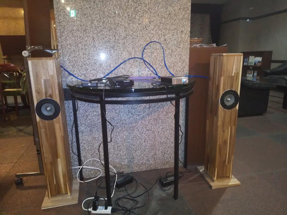

Thank you so much Bjorn for great design.
It was easy build and great sound.
I found 15mm Acacia laminated wood was cheaper than MDF here.
I tried W3-1319SA but no bass came out.
So I bought W4-1320SIF.
I have built for hostel lobby.
The lounge is large but sounding great!
I staff less wool for more bass.
Bass sound really good.
I like bamboo corn the most.
Smooth vocal,percussion,strings...
Now I want to listen W5-2143 TABAQ.
