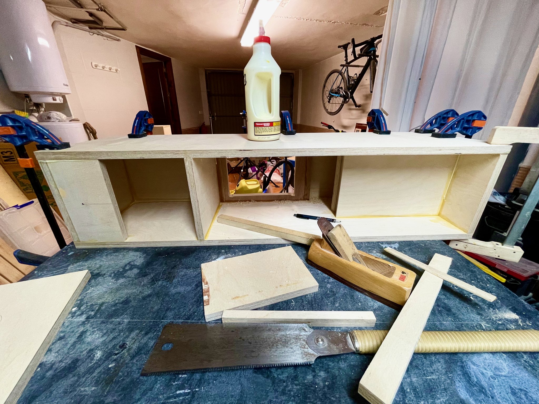

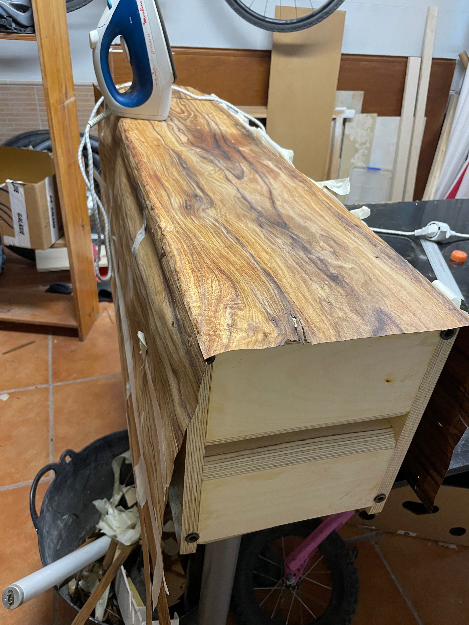

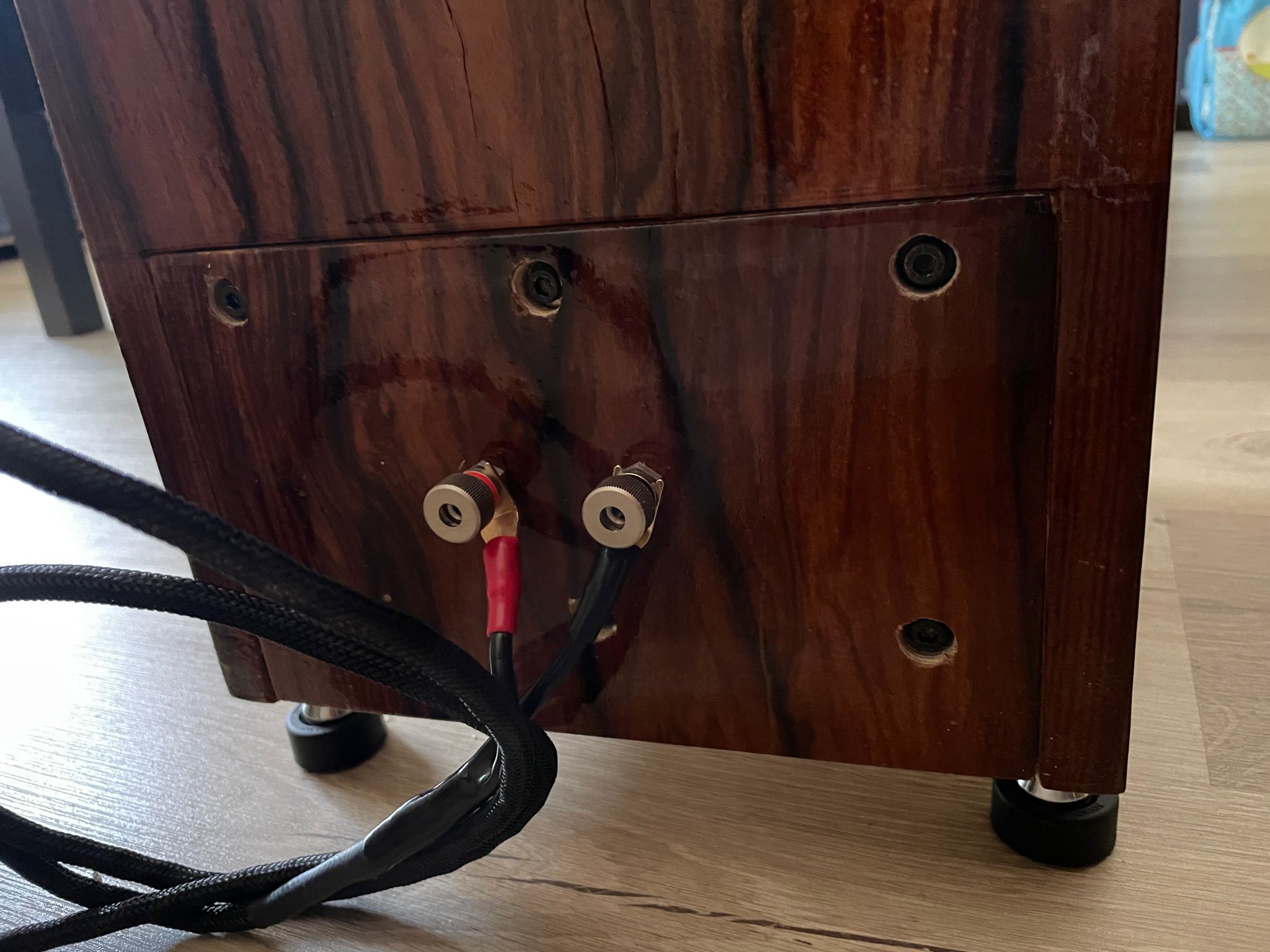

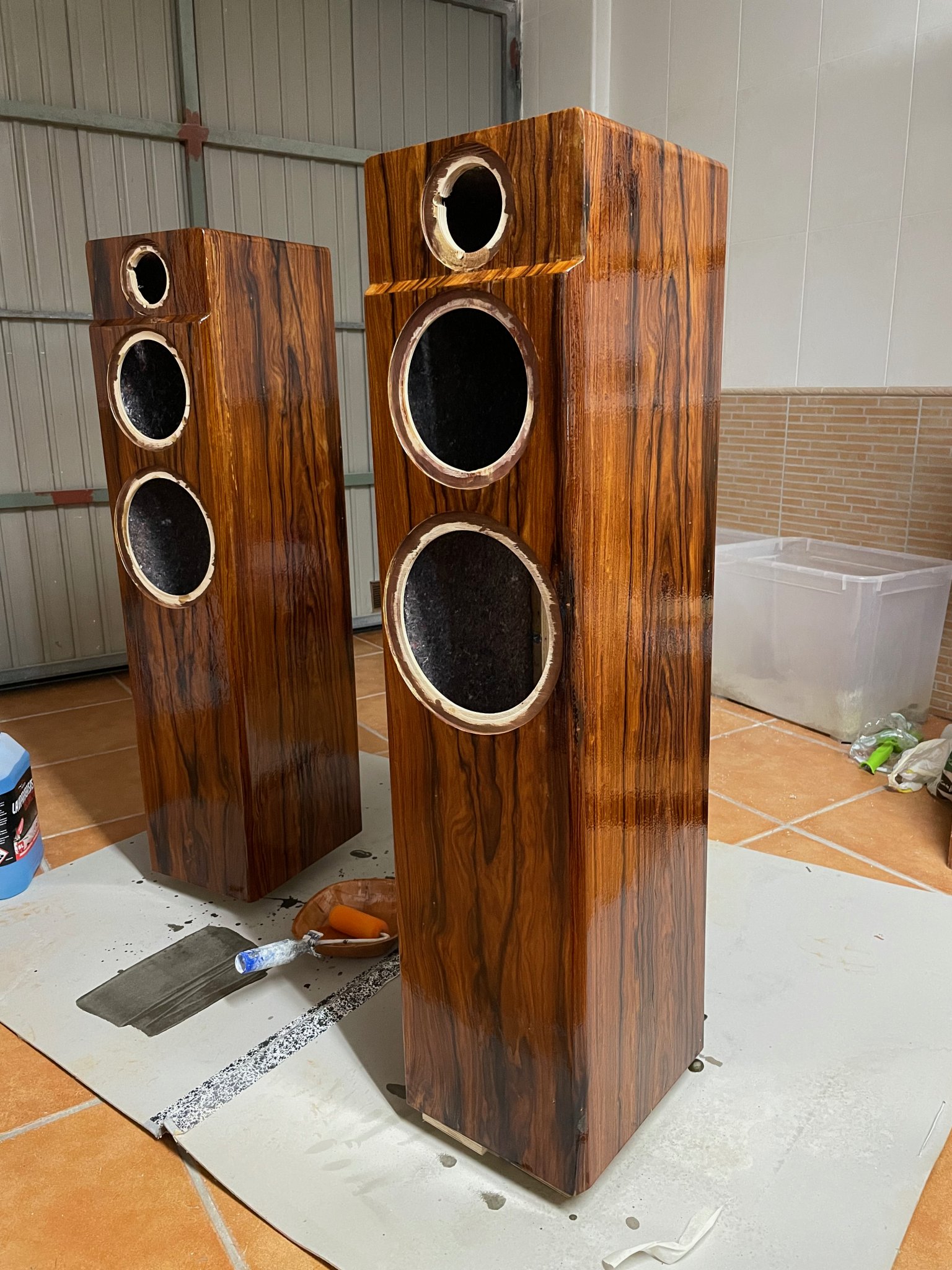

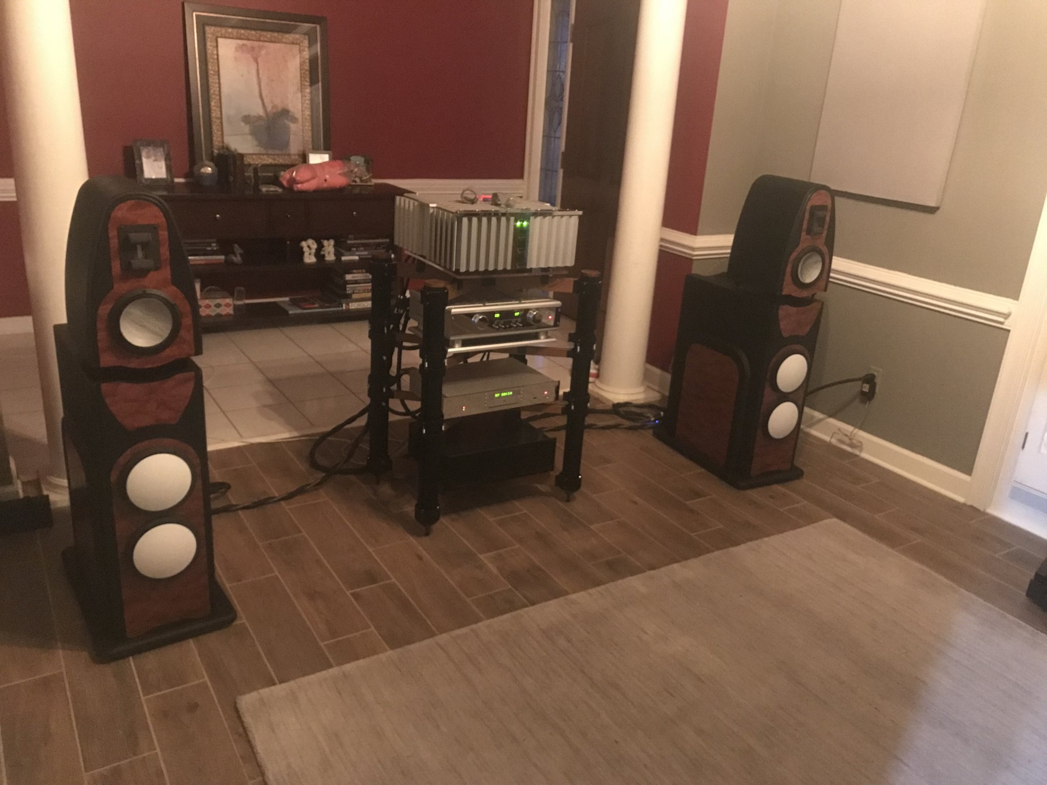

Hi guys, just wanted to show my impressions on the ScanSpeak Discovery 861, from Troels Gravesen. It has been a great fun work and a very pleasing result. They offer a great level of transparency, with a very natural sound. The musicians stay right in front of you with a nice and natural soundstage. There's nothing I could emphasize, they just do everything good, in my opinion. I finished them in rosewood, that turned a bit reddish once I lacquered them. But looking good nevertheless. Not the best veneer on this web. In fact, it was very complicated, as rosewood did not make it easy at all. But enough to me. I did a detachable binding post board and the same for the filter, in case I need to do any repairs. Well, for the money, a great build, that will satisfy most of us, for sure.

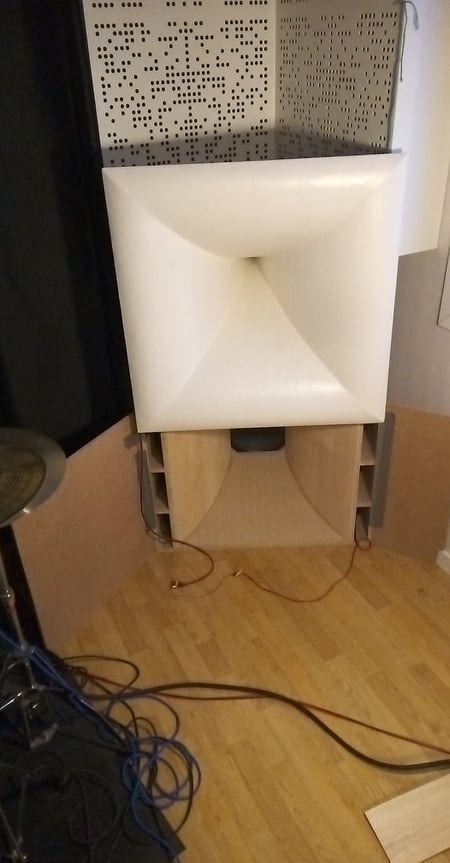

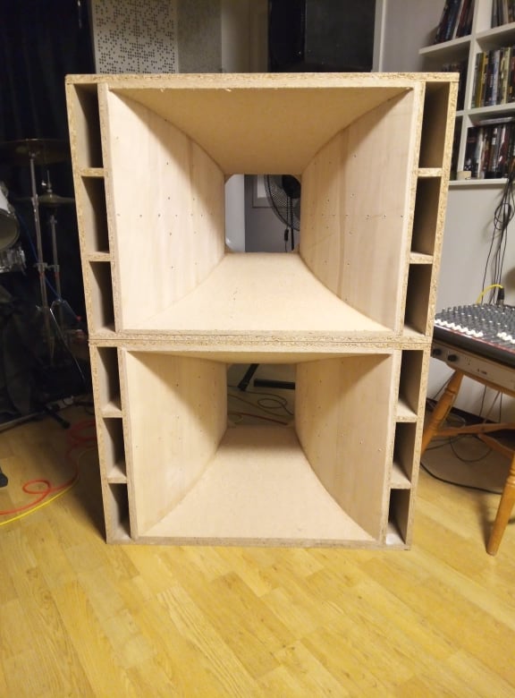

My man cave system, or "the Voice of the sugar shack". Obviously inspired by Altecs Voice of the Theatre but on a budget. 18Sound 12" woofers (12MB600 if I remember correctly) in the bass bins and cheap P.Audio 2" compression drivers in the 200Hz Lecleach horns.
It took a couple of notch filters to tame the 2" drivers and a BSC-like circuit in series with the woofers to supress the slightly exaggerated midbass.
Why bother building "hornflex" cabs and then shave off the extra midbass efficency provided by the horn loading, someone might ask.
Well, they allow the woofers to be physically time aligned with the mid drivers without having the mid horns sticking out 2' from the bass cabs. I also like to believe that the horn loading provides a "punchier" midbass which integrates better with the mid horns, plus they do look quite cool 😎
They currently operate as a two way system (and they do it quite well, although within a slightly limited frequency range) but I recently started to experiment with super tweeters. In the same room I also have a pair of bass horns disguised as furniture, leftovers from an earlier horn rig but probably useful to add a little bottom below 50Hz or so.

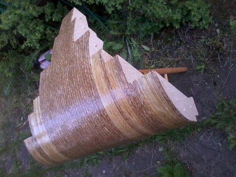

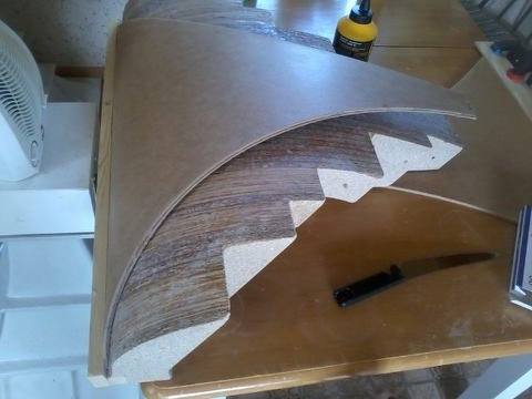

Looks impressive - good work. How thick is the ply that you have bent?
The mid horns are made from two layers of 1/8" masonite, cut out with a friends DIY CNC router. I made one or two attempts with 4mm plywood but it was very difficult to bend into shape and it turned out that the X and Y axis on the router had been slightly misaligned, resulting in prototype horns with twisted throats.Looks impressive - good work. How thick is the ply that you have bent?
After calibrating the machine and resorting to masonite everything went much smoother

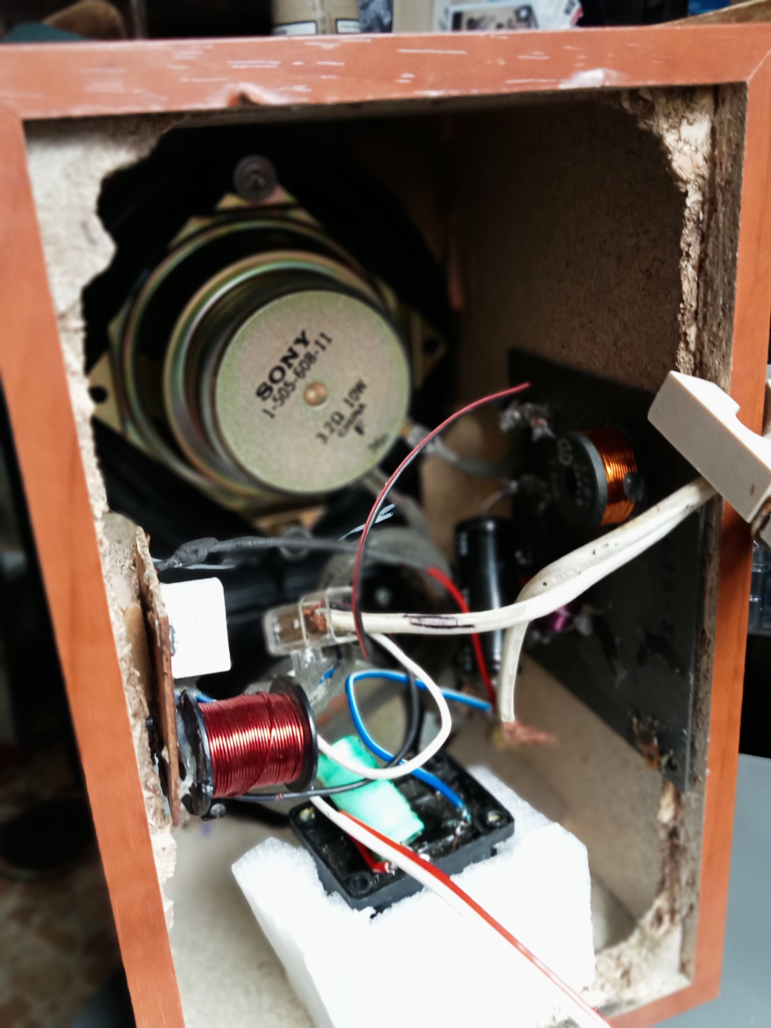

Ladies and gents, my latest creations...well, uhm, not so much to create, just adapt the pieces.
(the amplifier's got a phono input! Savaged from an Akai...the BORG cube is Panasonic...The inputs are managed electronically but the playback & CD inputs are disabled somehow-there aren't any CD or Tape machines now-, so gotta put a switch or rotary to select extra inputs )
The cables are Q&D, I guess 🙄
So the curious ones have already jumped on the photos, and the well informed ones would recognize a Pioneer unit at the bass section, together with the box.
The little box is from the Panasonic combo, but it is used only to support mid& tweeter & X-over.
And, yes, the waveguide combo is from some RCF 3 way ( '80s ?!)
That's all, folks!
