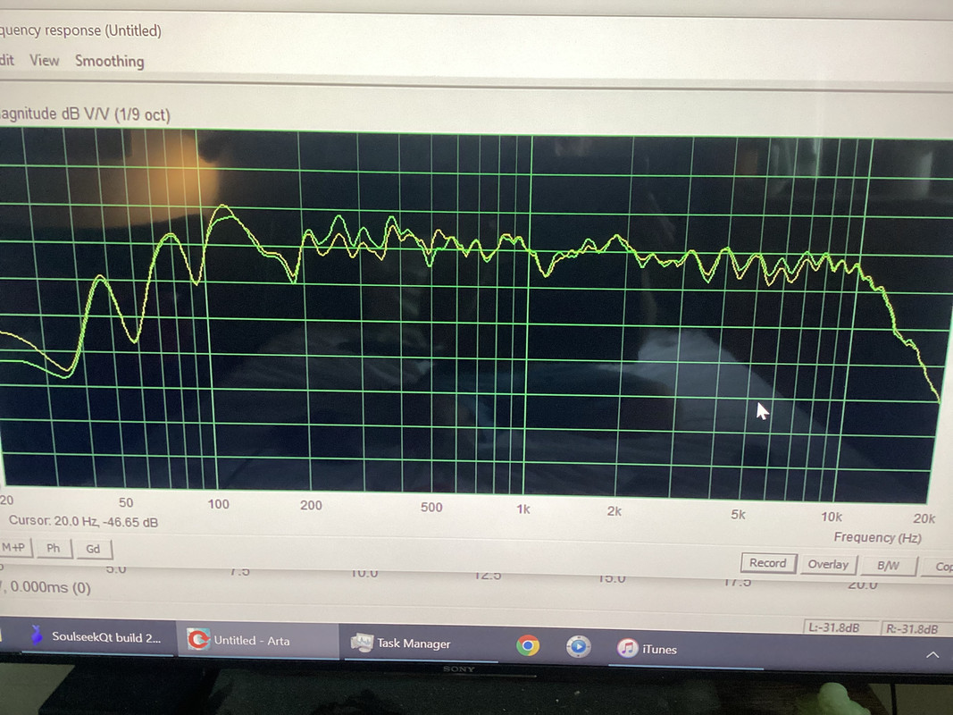

PHL vs Audax
green is PHL
yellow Audax
as you can see, almost identical apart from uner 400hz where the PHL show its better performance under 400hz...
Thanks... interresting. Seems the room and the baffle is rulling the measurement ?
What are saying your ears ? One is perefered subjectivly ?
im not sure i understand the first sentence. if it measure ruler flat, that clearly indicate that the room have little to no effect here...Thanks... interresting. Seems the room and the baffle is rulling the measurement ?
my ears say that both the audax and phl sound incredibly good. I will listen to the PHL for a good week. so far id say both sound incredibly similar.
You mean it is from outside ?
Good and same sounding ?
What is the decibel gap between two lines on the Arta screen
mesurements were taken 1.5m away from the speakers, in my treated roomYou mean it is from outside ?
the green is the PHL
Yellow is Auadx
Ive measured the Audax first, removed the audax and palced the PHL and measured. didnt play with the volume.
eidt: gap is 5db
after using the phl 1120 for 2 weeks, ive put back the audax.You mean it is from outside ?
all in all, the audax are more detailed, more space between instruments and more musical, with a realer tone.
the PHL sound like hi-fi, the audax sound like the real thing. Id also suggest the audax seem faster, details seem to almost flow out of the audax.
the most obvious aspect for me is how much the audax makes me wants to listen to the music: the audax gives me the: one last track before i need to go to bed. while the PHL does not entice me to listen. My brain/mind is not as wowed, nor less emotionally involve. THAT is the most important factor when you ahve a new components. Do you listen to more or less music since that component was integrated in your system. It just took me over 10 years to completely trust my ears and trust that most important aspect.
crazy how this wasnt apparent in a quick A-B session. its really after living with both midrange that i could be certain of this..
