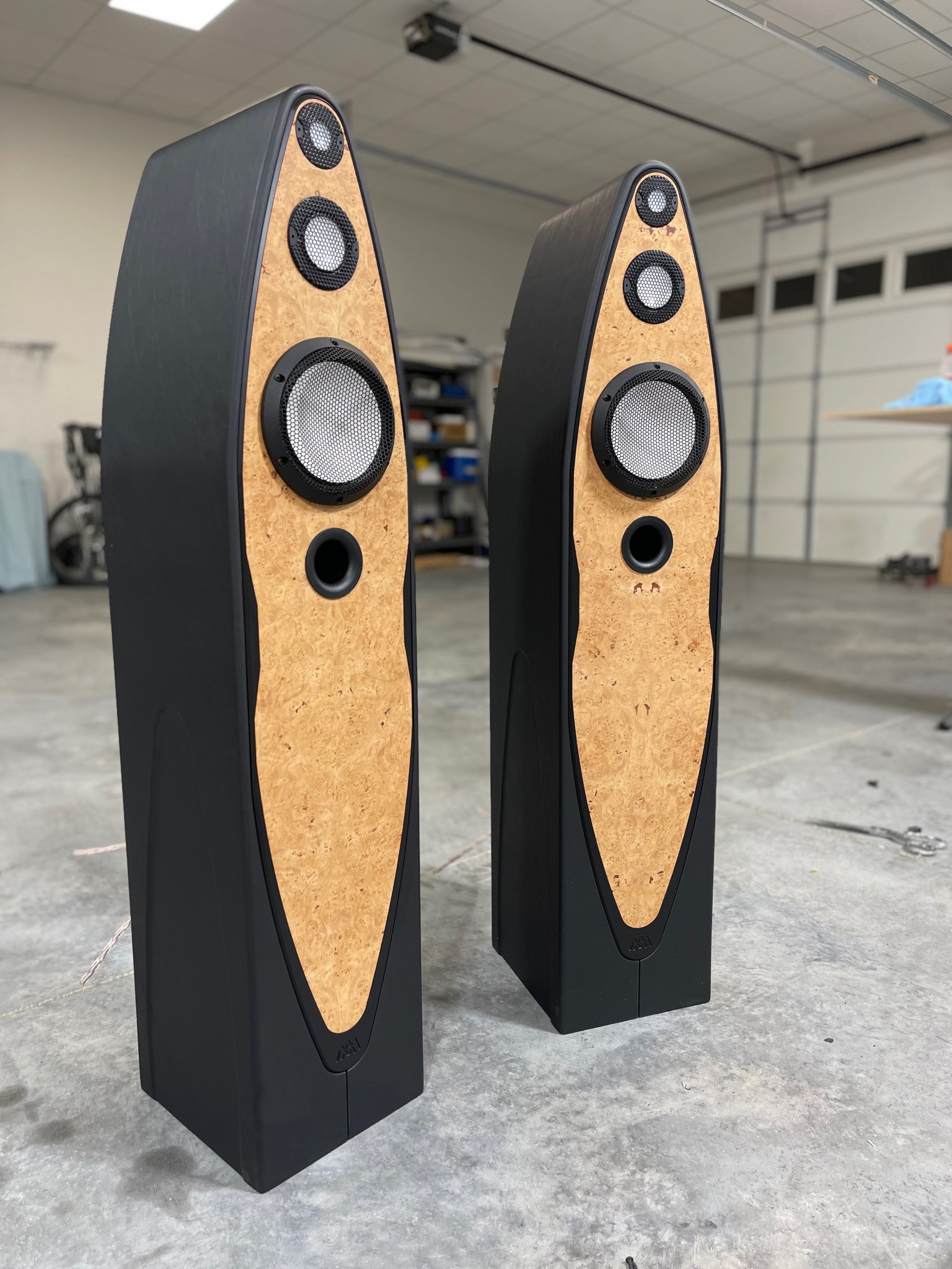

Defo,Faital HF146 + Ciare PR614 crossed to a rear firing Dayton ND105 at 500 Hz
Love the cabinets and the countertop. What are they?
Cabinets are plain MDF and countertop is Ikea Bestå 😀Defo,
They both look amazing. Looks and measurements. Do you have a favorite sound wise?View attachment 1013250

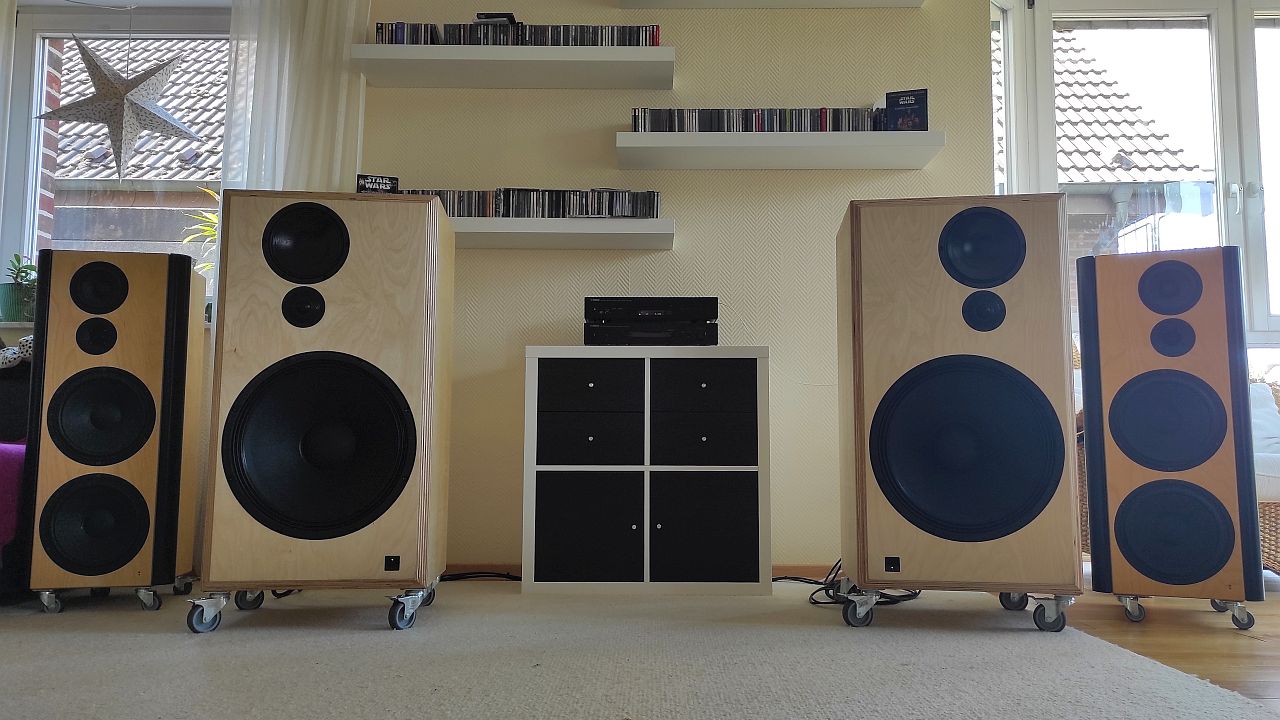

Front system (living room):
Hi: On pic Bliesma T34A-4, actually swapped to SB TW29DN
Mid: 18Sound 8NMB420
Lo: Faital Pro 18FH500-8 @140l BR, 33Hz
Amps/DSP: Hypex FA503
View attachment 1013283 View attachment 1013284
Background system (now in my home office):
Name: "Scandinavian Connection"
Hi: Seas DXT
Mid: SB15NBAC30-4
Lo: 2x Scan Speak 26W8534G00 @65l CB
Amps/DSP: Hypex FA123
Best regards
Peter

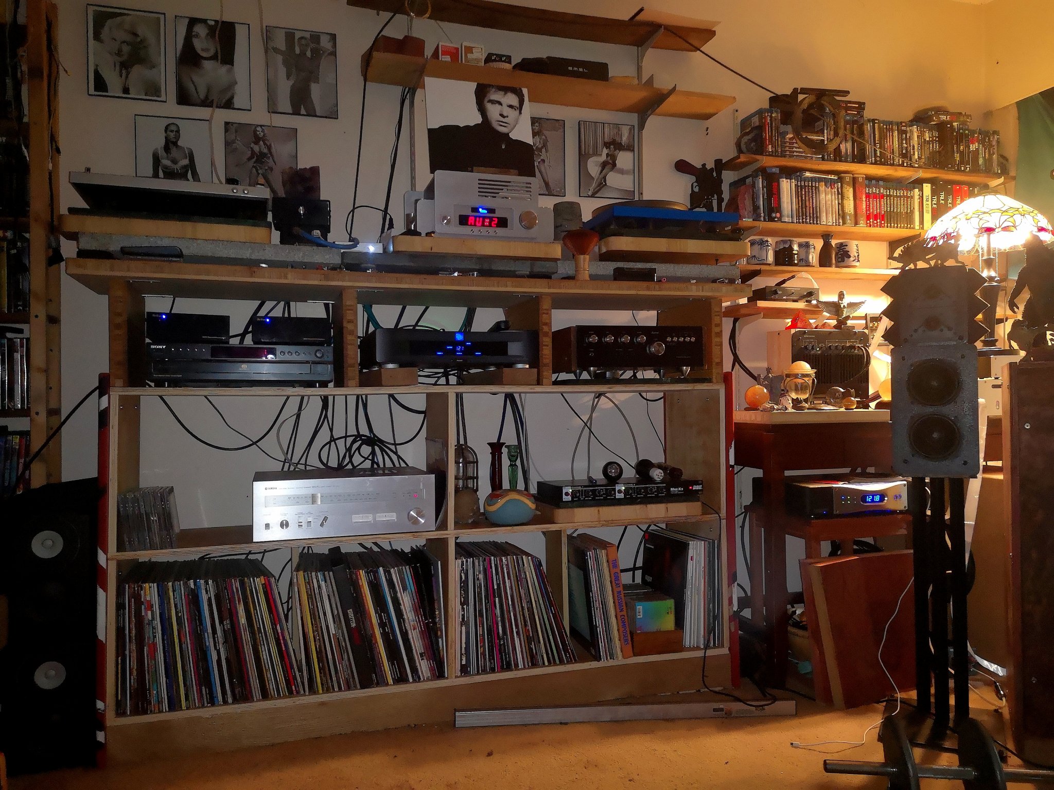

I finally gave up on the inconvenience of my previous tube rolling ways, and got a second turntable and extra headshells for rolling cartridges. And now that I have one, and two favourites for it as extras, I don't really change cartridges much anymore.
For speakers, I use a sealed bipole subwoofer and two old M&K Satellite 1B, mixing active and passive crossovers to knock down room modes with wide crossover points, and a boxed mono midbass dipole coupler made from parts of two previous open baffles.

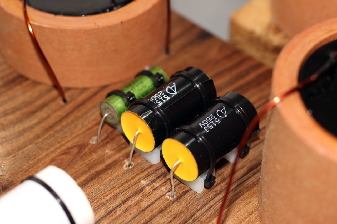

I just built a new crossover for a coaxial speaker based on Beyma 15XA38ND and it turned out very eye-catching so I thought why not to share it here. Maybe it will give dudes idea to build networks with similar idea. The owner of the speaker decided to place the crossovers on top of the speaker instead of shoving it inside the cabinet.

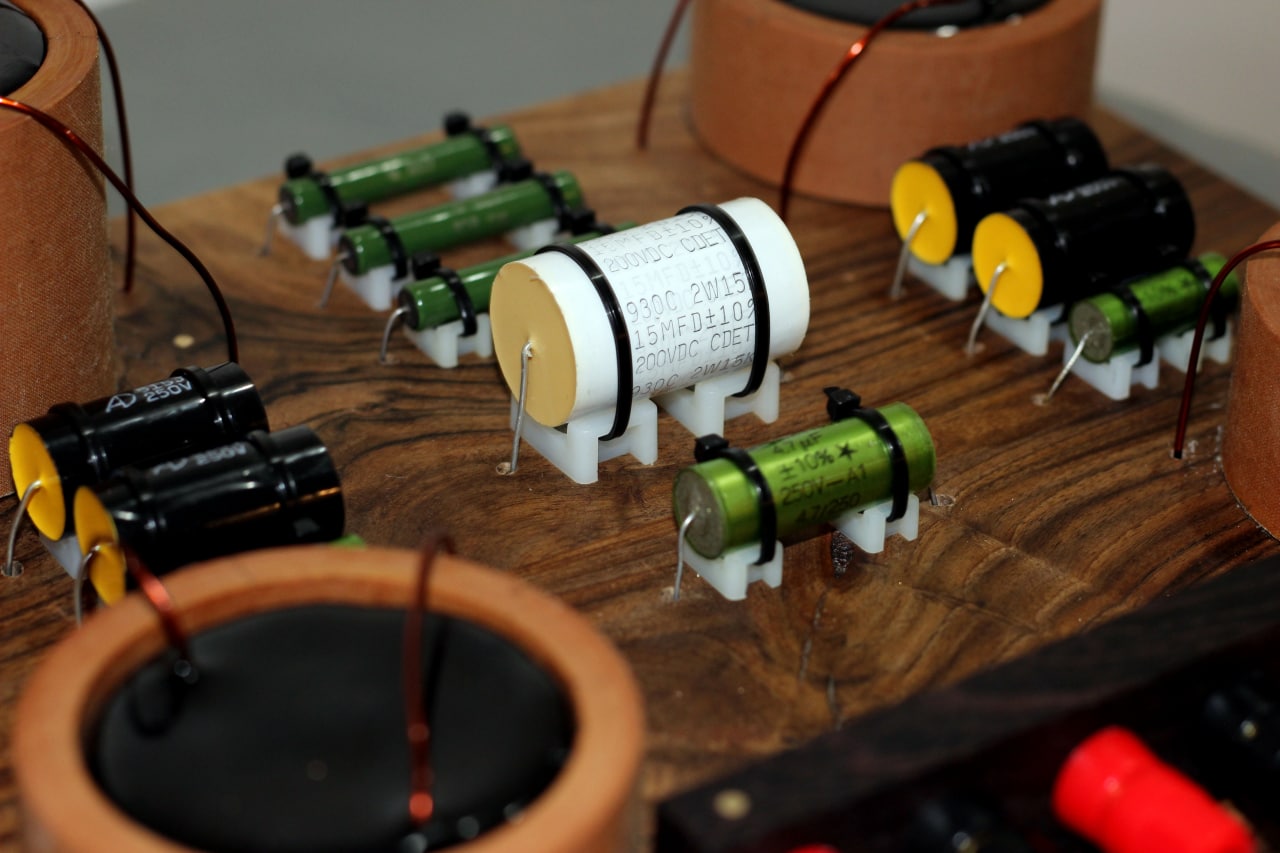

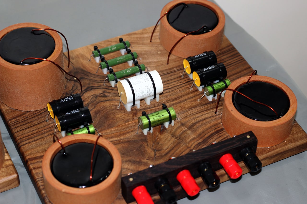

I particularly like your DIY potting of the coils! 🙂 Did you purchase magnet wire and wind them yourself?

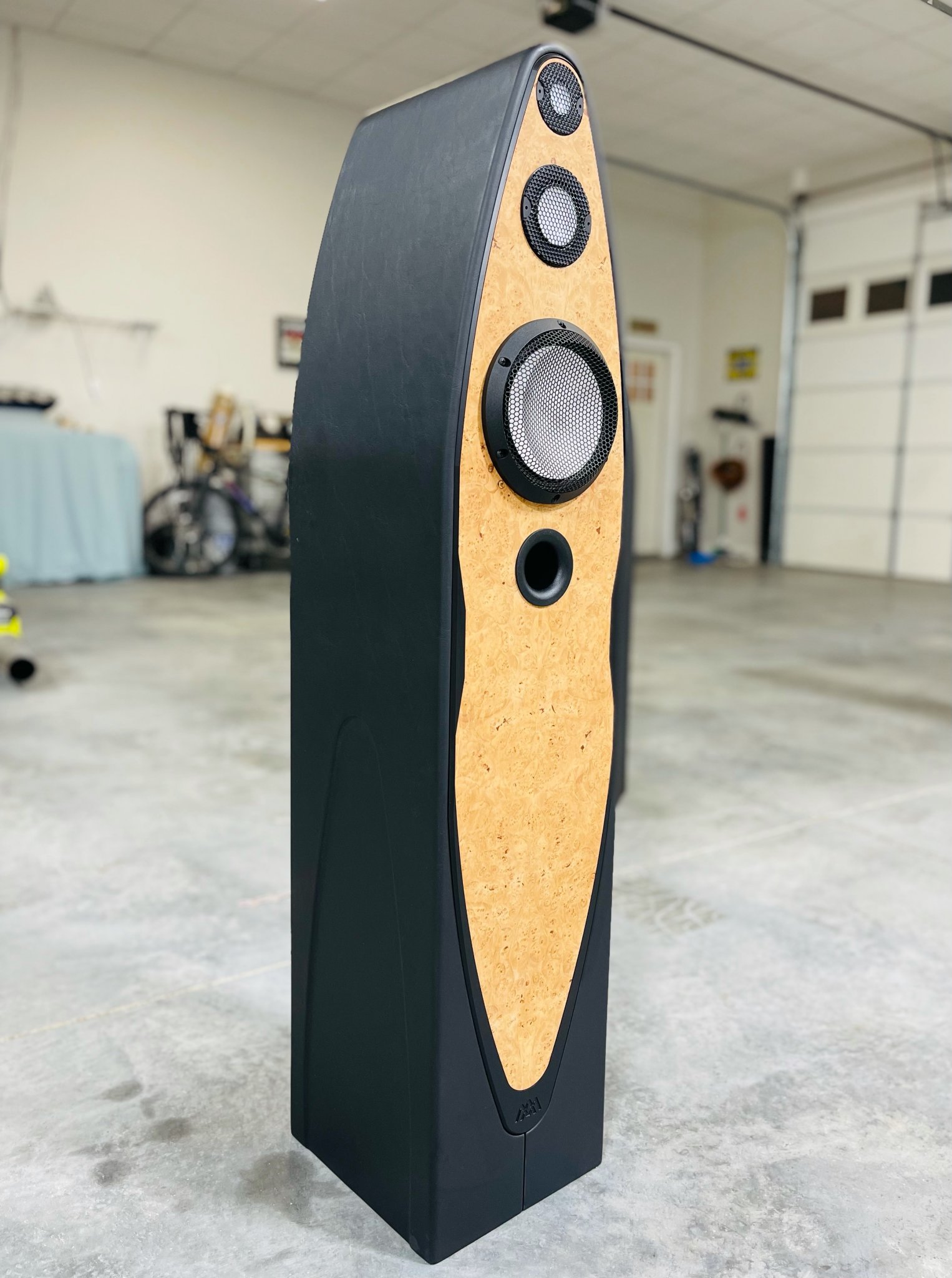

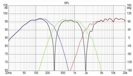

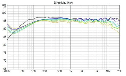

High efficiency 95dB/2.83V, 3-way, 1st order series crossover.
I began this project around 2012 armed with a mini dsp, 12" woofers in a 125L cabs using the pr170mo along the PR17 supertweeter xo'ed at 5khz. Passive xo between the mids-tweet and active woofers via mini dsp. It sounded great but i could never make the bass sing along the mid and treble.
2012:
2020:
About a year ago, i had way too much time on my hands and so this project came back to life!
A friend that used to be active here and is an "Audio Industry" personality who prefers to named as "Magnum Innominandum" helped me greatly to design this speaker. He helped to design the cross over and the entire system really. I'll quote some of his comments about the design.
Drivers:
Planar tweeter: HiVi RT2HA: https://www.parts-express.com/HiVi-RT2H-A-Planar-Isodynamic-Tweeter-297-407
Midrange: Audax 170MO: https://www.madisoundspeakerstore.com/pro-sound/audax-pr170m0-6.5-midrange-100db/
Woofers: Eminence Omega Pro 15's https://usspeaker.com/OmegaPro-15A-1.htm

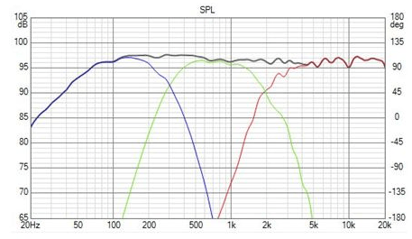

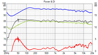

Measurements:

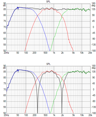

FR measurements: Yellow line is 1.5M away from the speakers, mic at the mid level. the green line is the same speaker but now measured from the listening position.

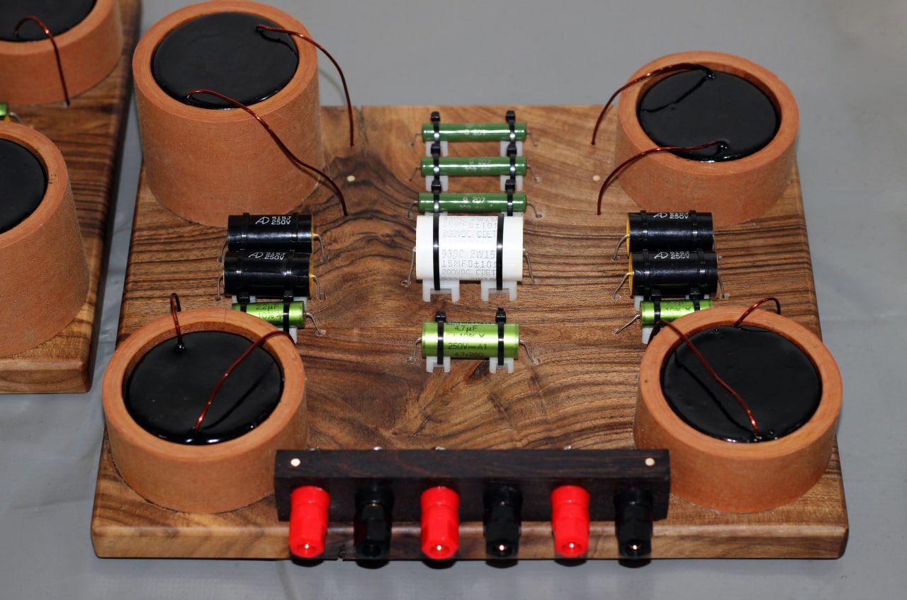

Series xo:
The whole crossover contain no resistors to lower sensitvity, only two Inductors and two Capacitors.
The reason I always prefer series networks for 1st order crossovers, is that due the use of "shunt elements" at frequencies where the driver impedance is approximately resistive means the drivers inductance and LF resonances do not require compensation networks.
This is totally independent from all the articles all over the net where debunkers try to prove that there is no difference between series and parallel network. This case is only true for resistors, not for real drivers. A parallel type crossover would require both voice coil inductance and driver LF resonance to be compensated, making the parts count very large, especially for the midrange.
In effect, the planar Tweeter is a resistor, the midrange will need RC "Zobel" to compensate the voice coil inductance and at least one RLC "Trap" to compensate the impedance "humps" at low frequencies to make it behave like a resistor. The Bass Driver would need a RC "Zobel". Then an equivalent parallel crossover will work broadly equal. The series network does not need these compensation elements and is super simple.
Midband sensitivity is around 95dB/2.83V/1m with around 6 Ohm impedance.

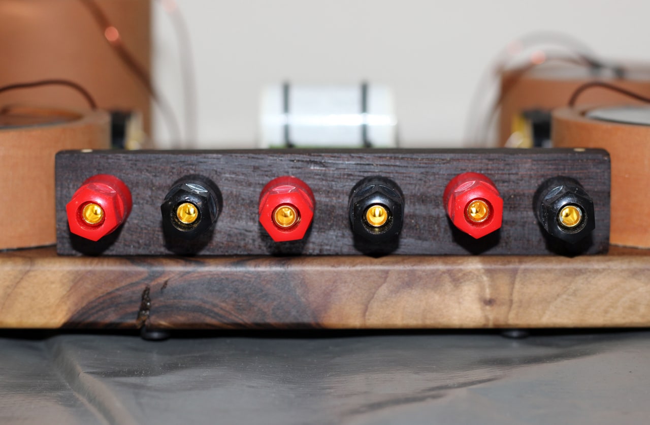

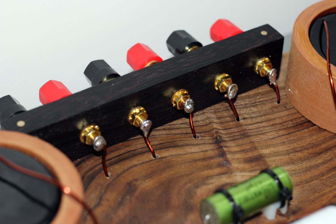

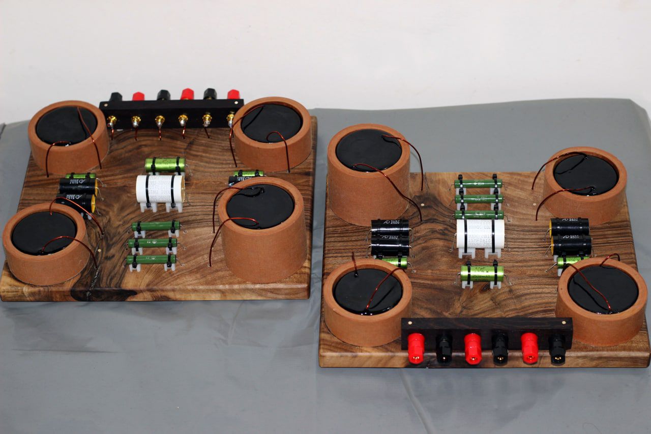

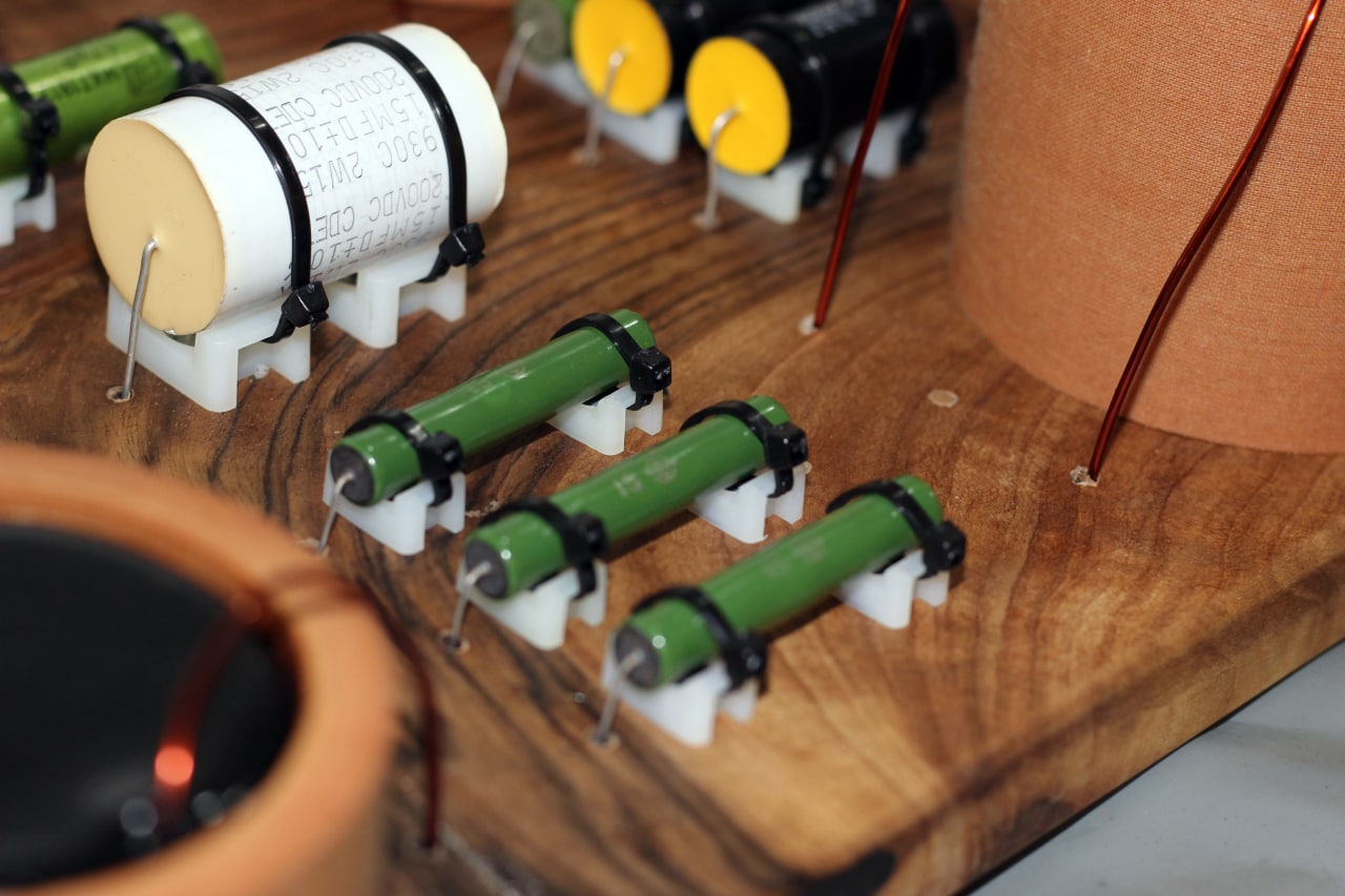

final crossover pics. MIT multi cap PPFX caps used in the critical midrange. MKP type caps for the bass.
test xo:

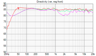

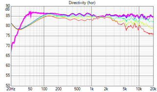

Mid-tweet offset:
normally, a offset of the mid-tweet in relation to the woofer result in a smoother transition between bass to mid. I would have prefered to have the woofer, the mid and the planar all centered but here's the simulations:
no offset:
offset:

How does it sound? Like the real thing. The closest system to truly create the illusion of live music ive ever heard. Mindblowing sound. Very inspirational. I'll be building a couple of versions with different drivers and cabinet arrangment along different mid driver to find my favorite combination. very very exciting stuff.

What are the cut offs please ? Are they assymetric or symetric xo between drivers. Curve looks good to me whatever it says nothing from the sound I surmise to be good with that drivers... I know wolfteeth here who is an experienced diy designer likes this tweeter too if my reading memory serves me well.

if i look at the graph ive posted showing the mids removed, id say xo points are about: 300hz/ 1.8khzLike the idea of full sealed and no resistors. Cool design.
Do you always have ECDESIGNS stuffs ?
i dont remember if i had to inverse the mid phase. ill confirm later once i swap the audax for the phl 1120 im waiting to try here
Having a sub enclosure for the mid proved to be CRITICAL. I should show more measurements, but my first set of measurements were done without the sub enclosure closed, and I had serious peak around 600hz. adding foam and closing the sub ennclosure removed entirely the peaks in the mids.
Actually, here you can see: this was measured without the sub enclosure. look between 600 and 1.2khz response:
then look between 600 to 2khz once its closed: dismiss under 100hz, there was no ports installed.
I think a sub enclosure was probably critical here.

Xo points were actually 1200hz and 300hz..most of the higher spl non-linear distortion below 4kHz is 2nd order.
Note that it might be an ELECTRICAL first order - but it certainly isn't going to be a resulting 1st order crossover crossed that low (..if it is crossed that low). (..and that smaller Inductor forming the high-pass for the tweeter looks fairly small.)
Acoustically, its a 3rd order highpass on the Planar and 1st order lowpass on the PR170M0.
