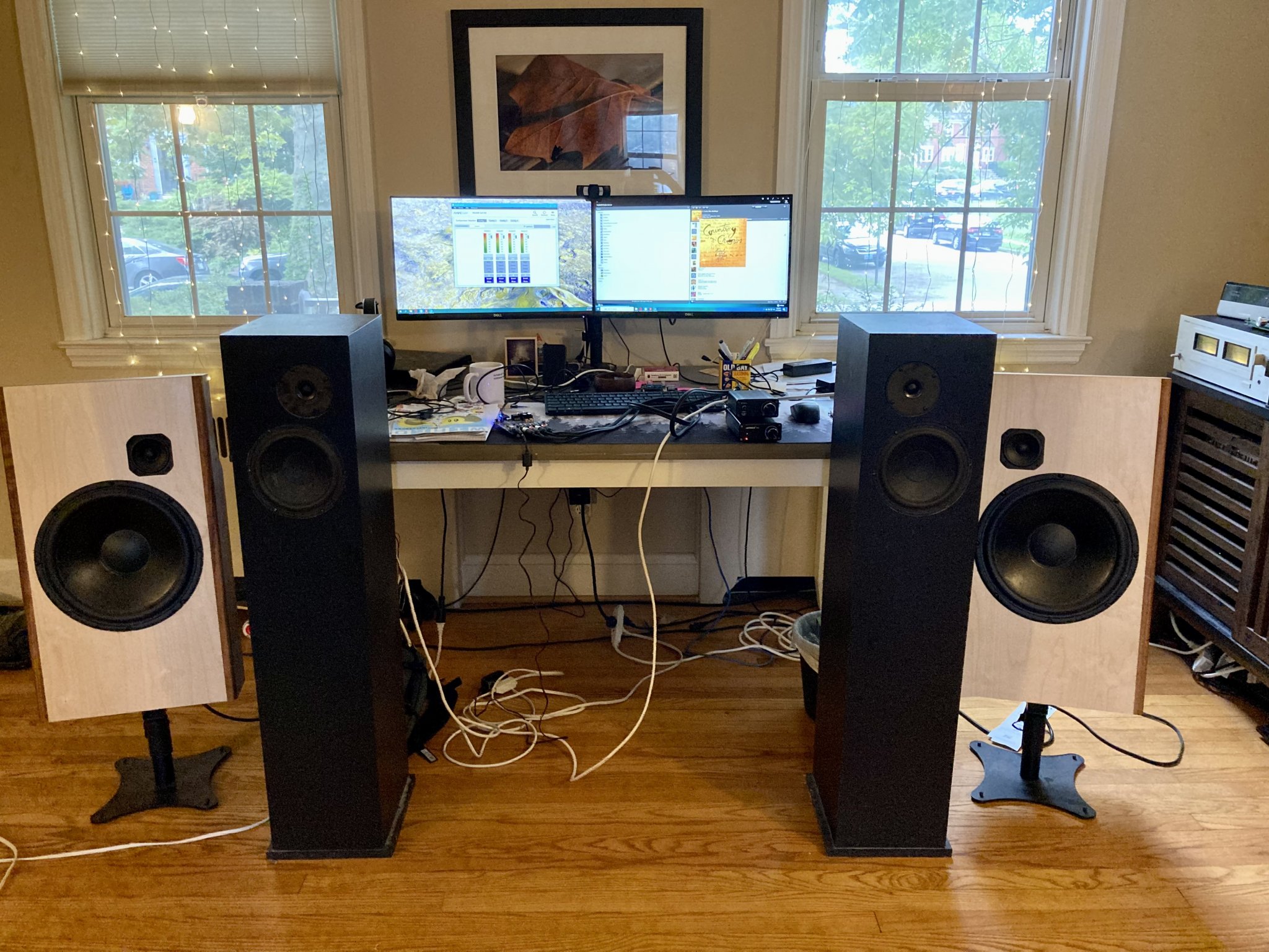

Decided to mix things up a bit and compare two completely different philosophies and directions among loudspeakers In my house. My first real DIY audio project (Econowaves circa 2009) and my current favorite speakers (Manzanitas purchased in 2021, built by @Dkalsi). Accompanied by my last class AB amp build (TubSuMo designed by the late great vzaichenko) and an ACP+. DAC is a Topping E30 and source is a SlimDevices Squeezebox.
The Econowaves certainly have the edge on treble and stereo image. The Manzies have that extra-special OB midrange and bass. Both designs are timeless and eternal for diyAudio geeks. I am very fortunate to have these to play with. And my inner adolescent can’t help but play both, simultaneously loud. 😎
Happy listening, building, and tweaking to you all.

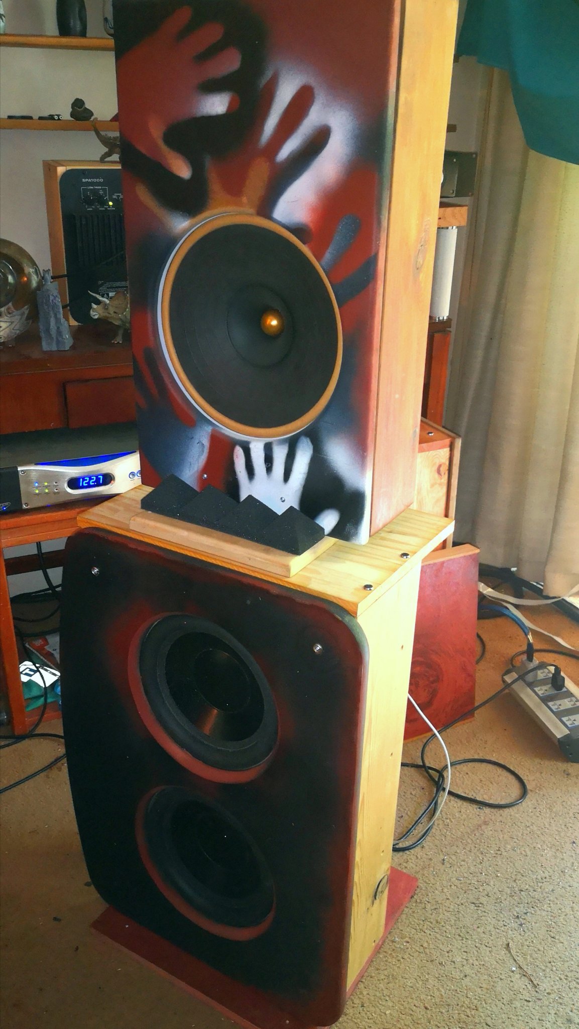

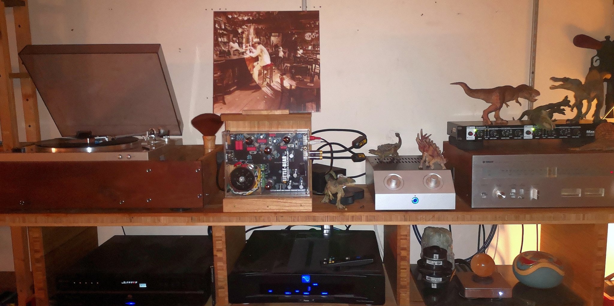

decluttered and removed some granite slabs.
Small amp for some dipole full ranges and a larger one for the bass bins, also dipole.
There's an added coloration in the full rangers that makes movie dialogue easier to understand, easily removed with the active crossover point by shifting to a 500 or 600 hertz crossover point from about 160 hertz for music, and no comb filtering from the drivers themselves.
After about 5 years, I got around to twisting the transformer lead pairs in the phonostage, and braided the one 3 wire set.
The hum is barely audible between tracks with these speakers, rated about 97db/watt.
With some 87db/watt Scanspeaks or 90db/watt Tannoys, it's not noticeable.
My crossover has a built in 32 hertz 2nd order highpass, but I managed to rattle a bass bin yesterday with only about 100 watts.
I do have extra subs and amps, so I may go three way active, and further protect things.
Not sure. I have been enjoying an all open baffle sound over cabinets here.

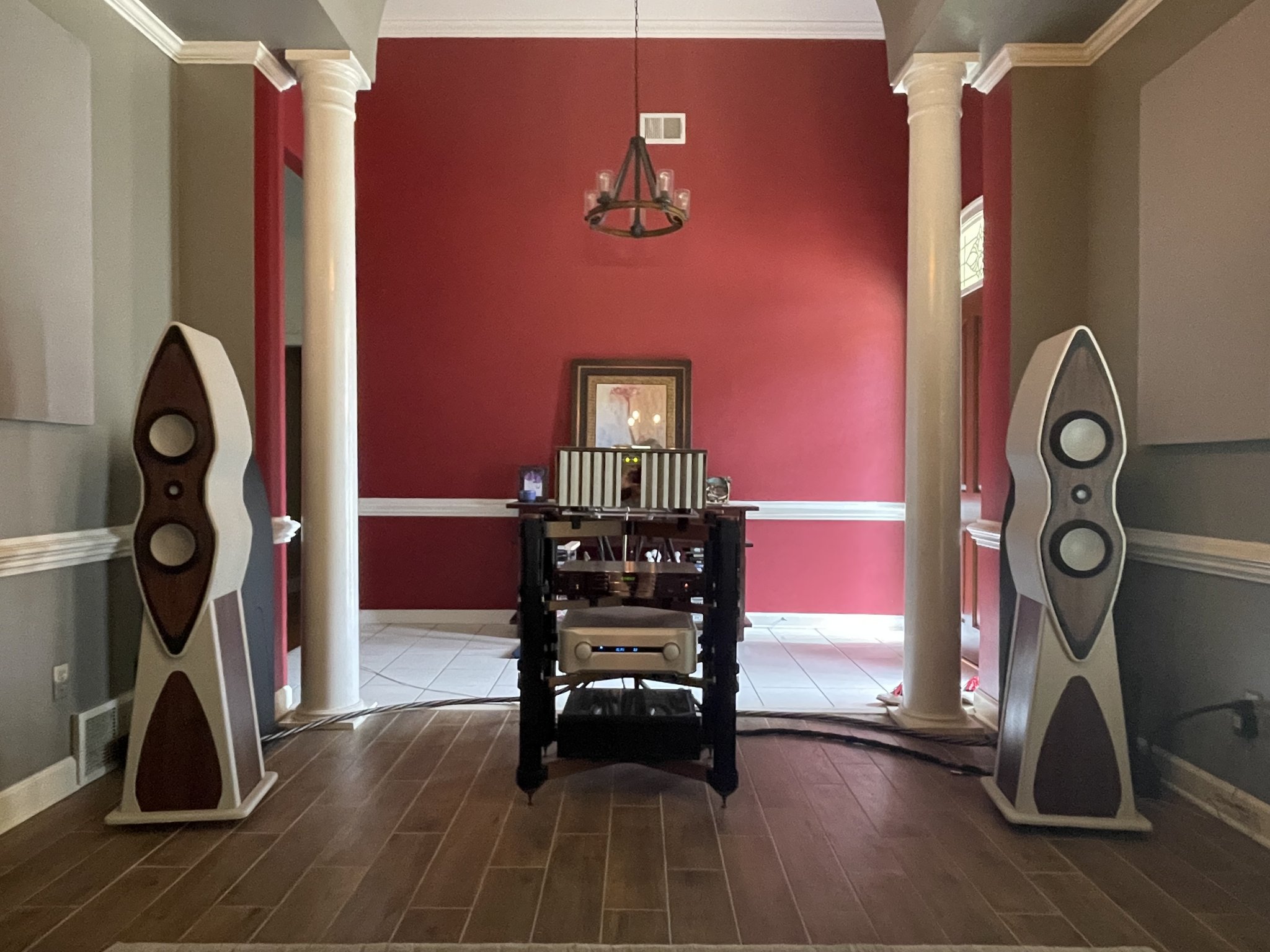

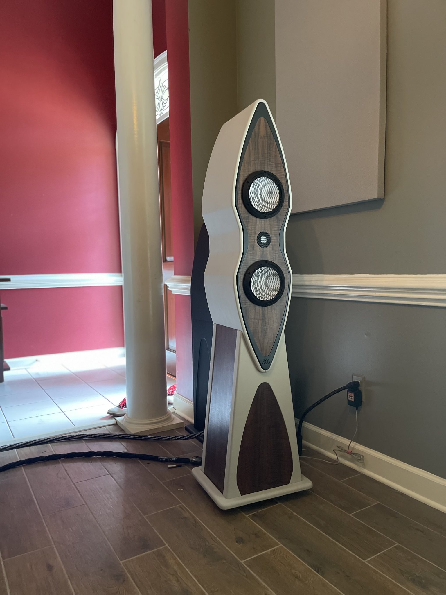

The Master Artist Signature MTM Towers in Linen Grey leather and Real Walnut Claro Figured panels. We use dual Accuton Cell Ceramic midbass and Cell Ceramic tweeter. Wired with Kimber Kable 4tc wire. We used Mundorf binding post and Parts (Including Goertz Copper Foil 12awg inductors on the woofer, ClarityCap CSA cap and Mundorf Copper Foil 16 awg inductors on the mid, and Mundorf Supreme EVO-Oil/ClarityCap CSA combo caps on tweeter, Mundorf MREsist Supreme resistors in all critical tweeter and midrange circuits) picture with speakers has my esoteric c02 preamp in it, replaced earlier in week with the burmester 077

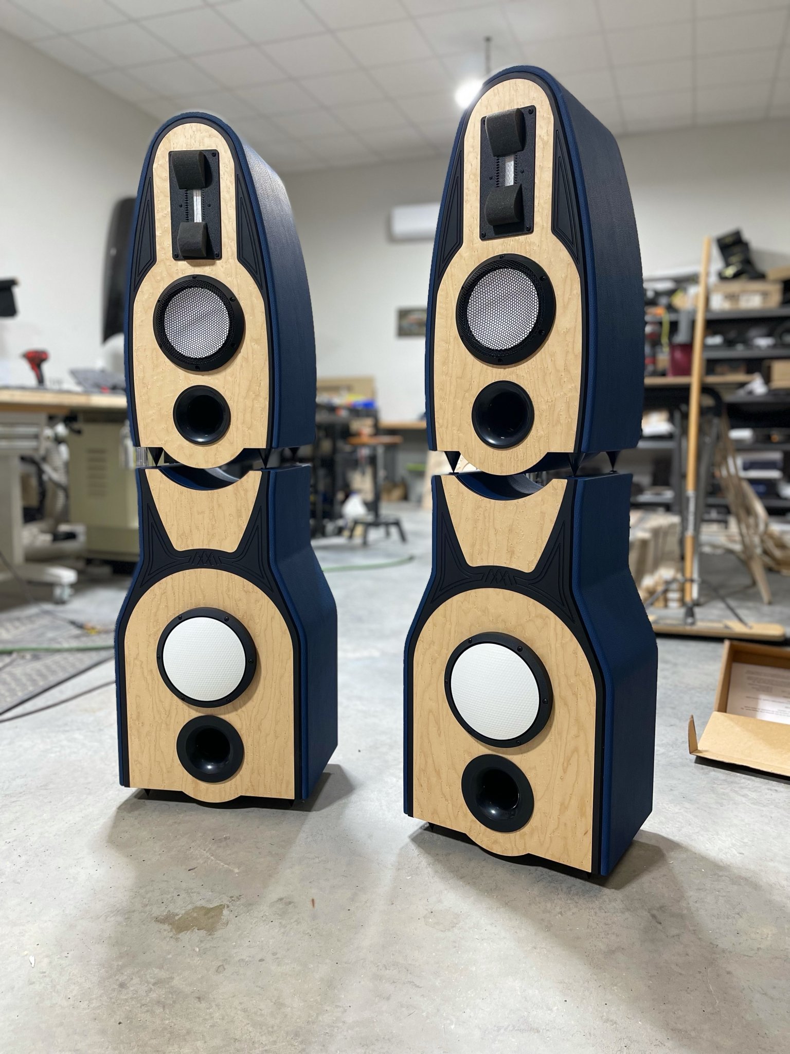

Master Artist Signature Monitors with powered bass mobule, same network specs as above. Wrapped in porsche blue leather and has birdseye maple real wood veneer. raal 140 ribbon tweeter, accuton 7" cell mid bass and accuton 8" cell woofer
