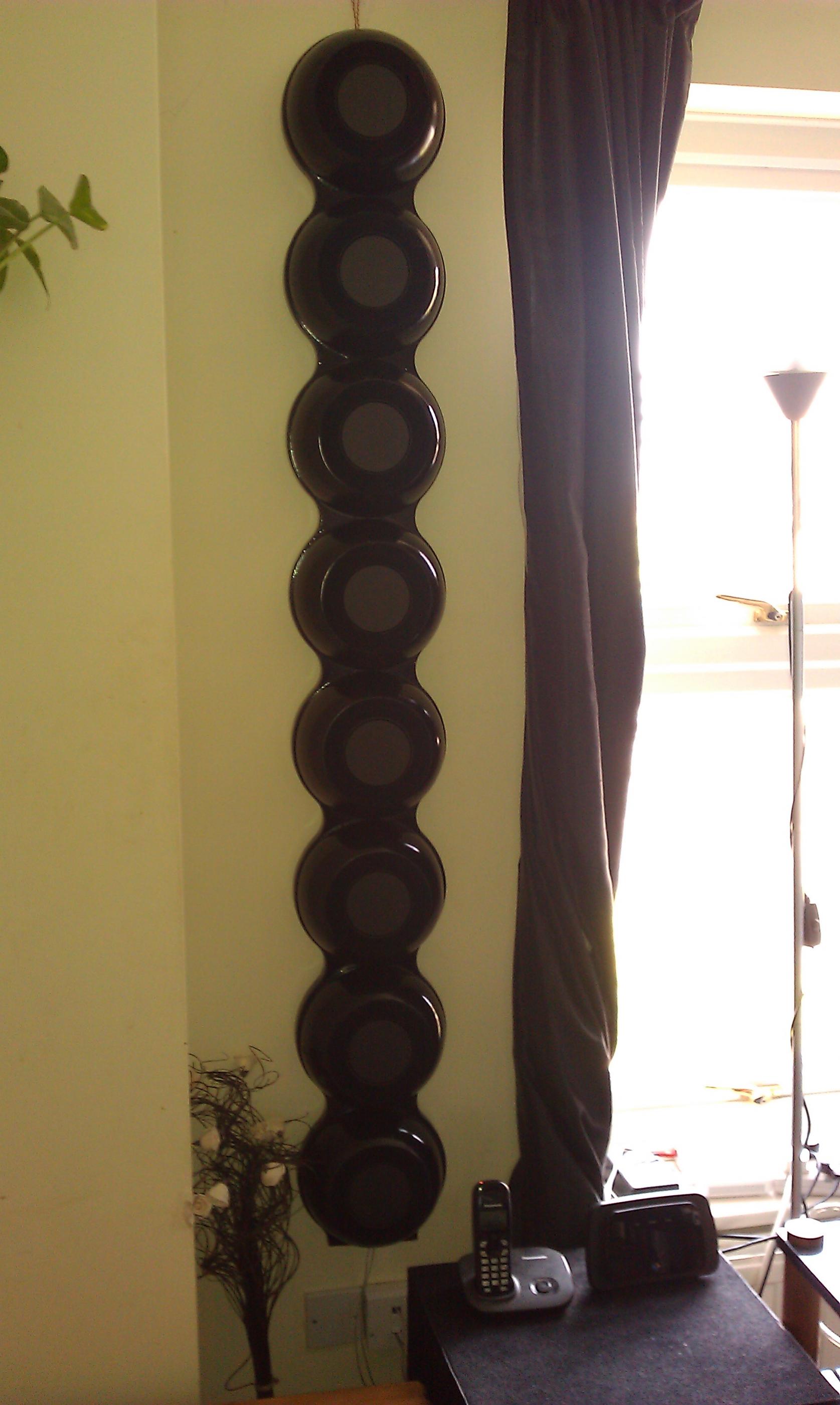

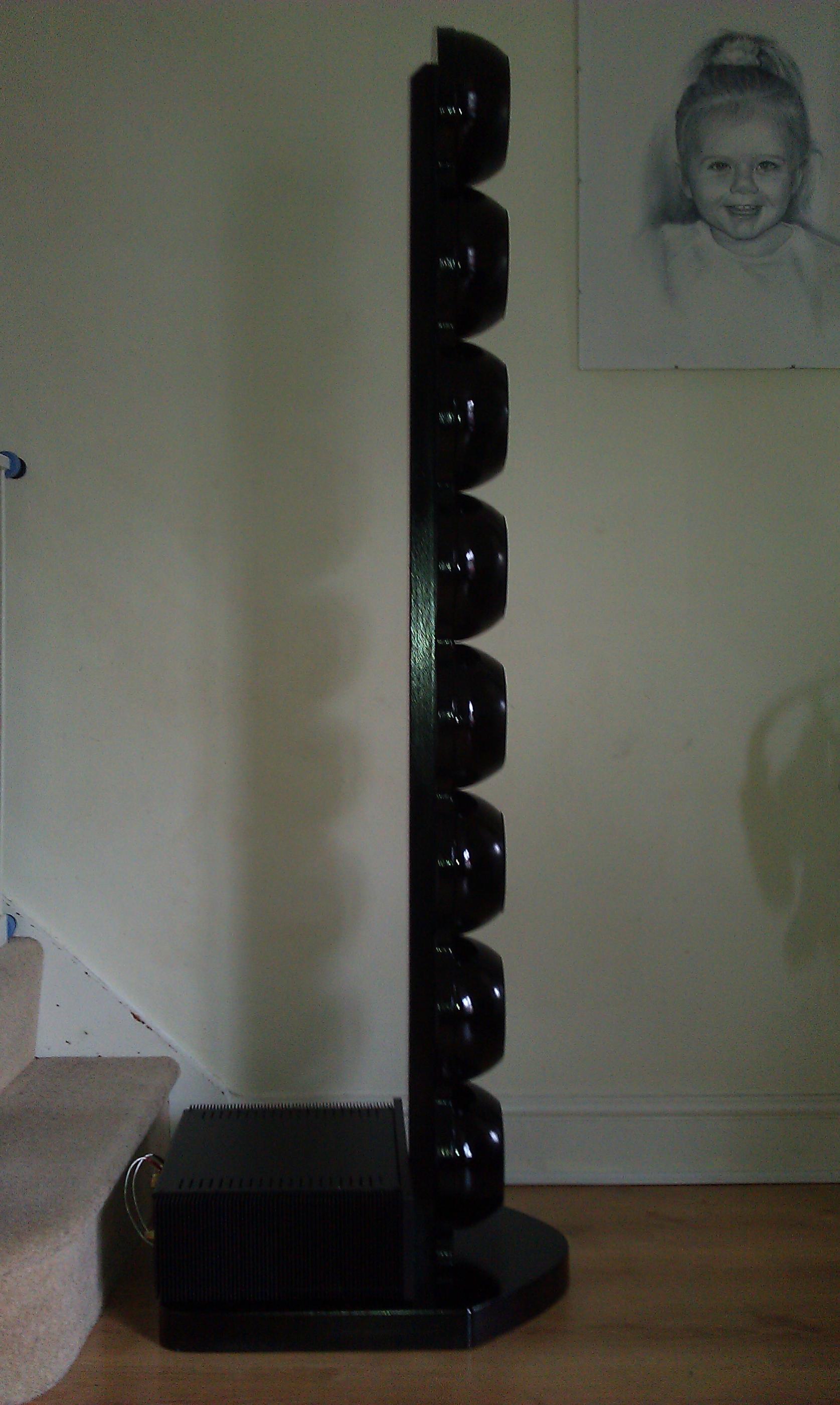

All are all fully active, no passive crossovers at all, no domes or ribbons, only Manger or full range BMR plus olw mid / and or bass.
Line array, two way, three way, sealed box or open baffle.

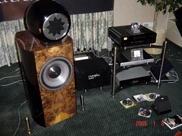

The " Beauties"
The "Finale" 3 way with open baffle 10 inch Volt 10 inch midrange.
The "Encore" 2 way with the Beyma 12LX60 bass mid.
Also the original "Ovation" with a 10 inch Focal Kevlar bass mid.
Cheers
D.

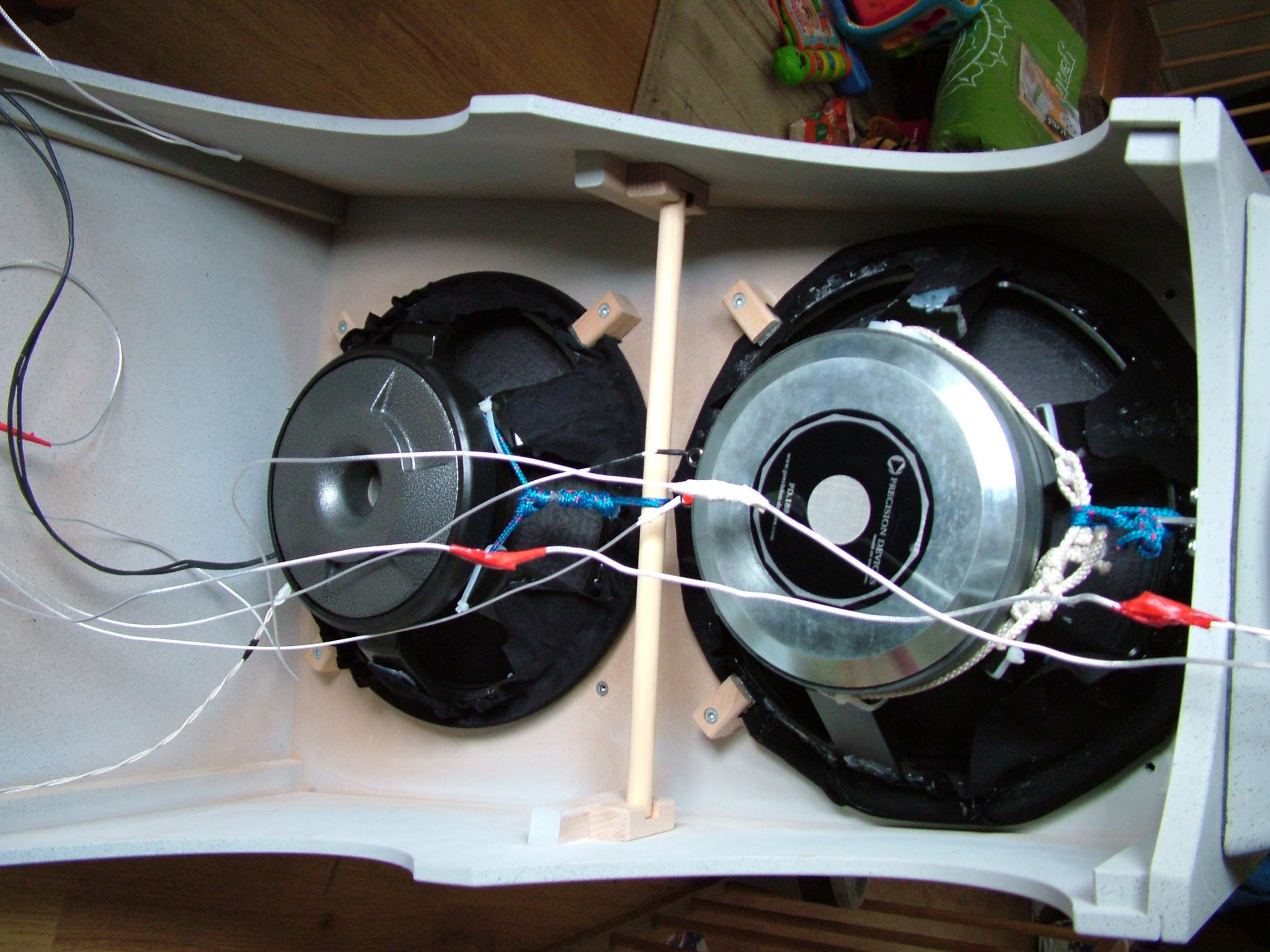

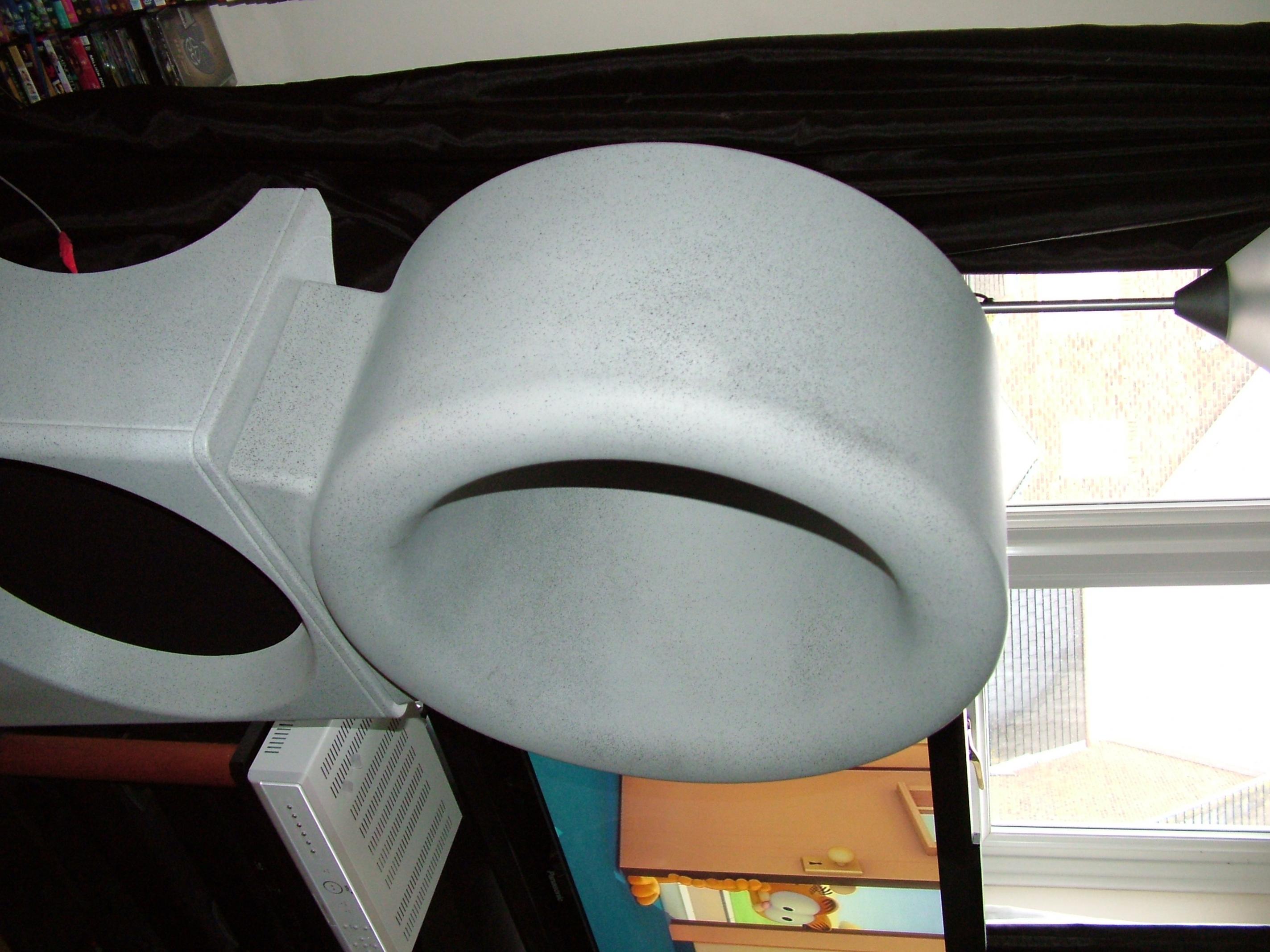

Manger in solid wooden horn
Hi Oldies,
Yea the twin 15 inch Beyma and Precision Devices on bass and low midrange then Manger above 400Hz is big, heavy, exotic and sound great, but...UGLY!

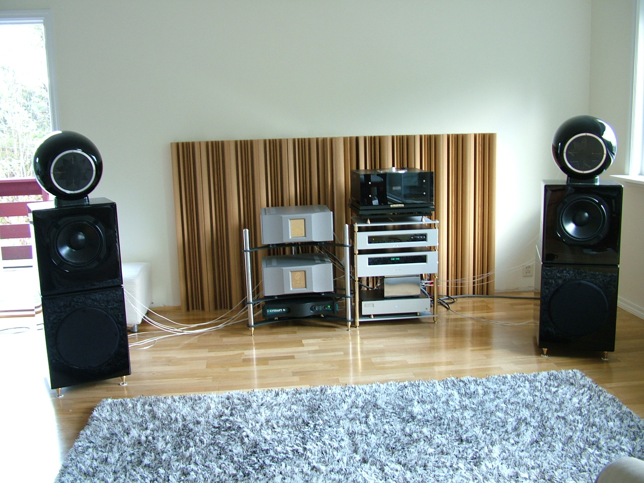

My DIY speakers
I built these speakers a few years ago to use in my home theater.
Not quite finished, stand and feet will be manufactured in the future.
Built using mainly Dynaudio's drivers.
The material is oak veneer on 30mm MDF
I have used Dynaudio's speaker designs as a basis, and modified them to my driver, that is a little better than the original design.
Sure, you can buy ready-made, but how fun is that? 😛
It took me a few years to collect all my drivers, since Dynaudio not sell drivers to private clients anymore, but it was worth the wait.
Dynaudio Finale, Dynaudio T330D Esotar, Dynaudio D54, Audio Technology 7", Dynaudio 30W100XL, Dynaudio 30SL (new slave, changed from Peerless)
