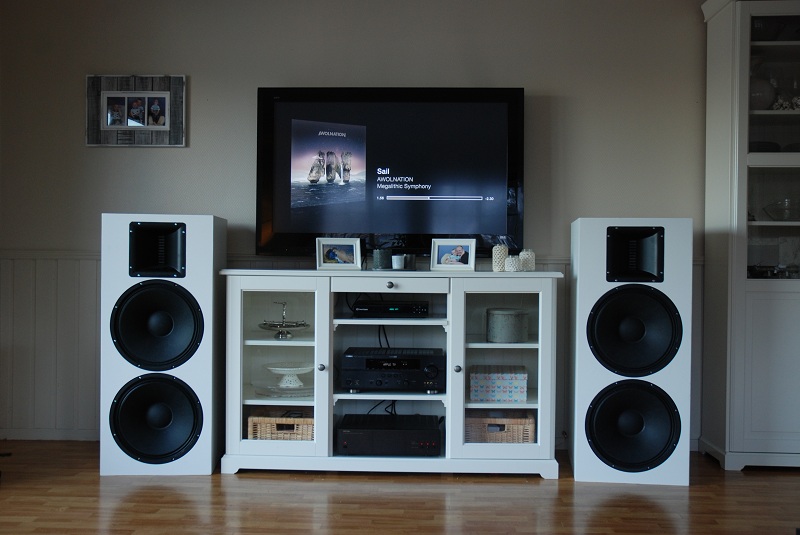

inConcert Miles, a design from StigErik (tangenavdesign). At the moment having a guest appearance in my living room. Normally they reside in my HT, with a "miniMiles" (Beyma FR15A/2) center and four JBL 8340, but I am expanding my HT and needed a place to store them. ;)

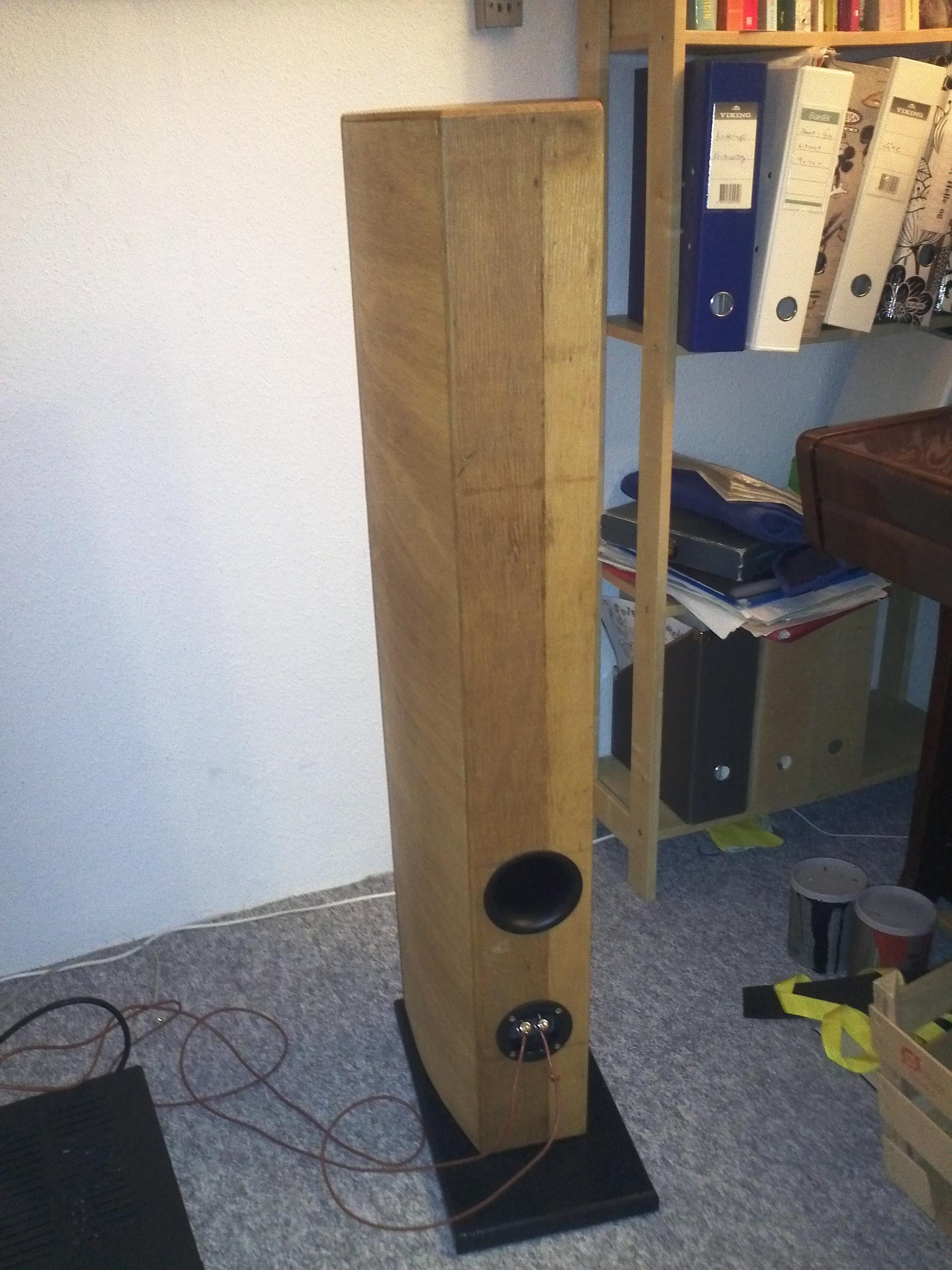

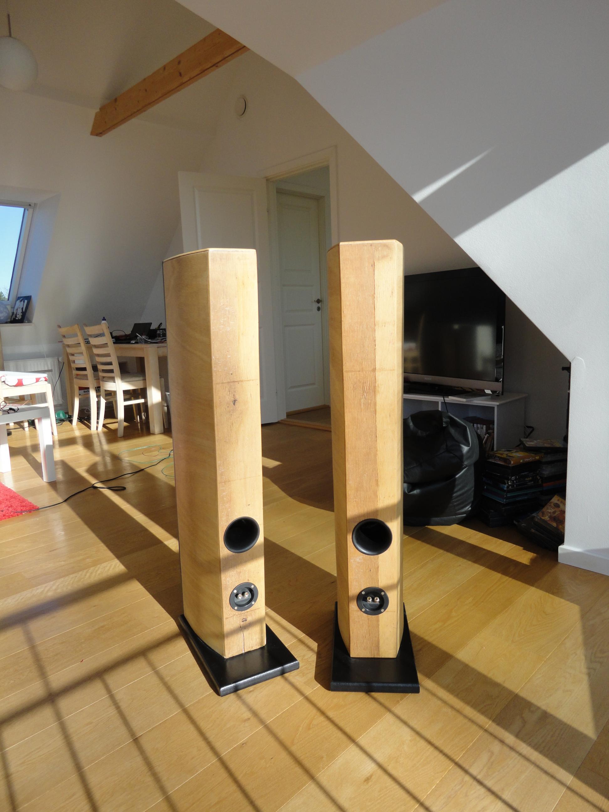

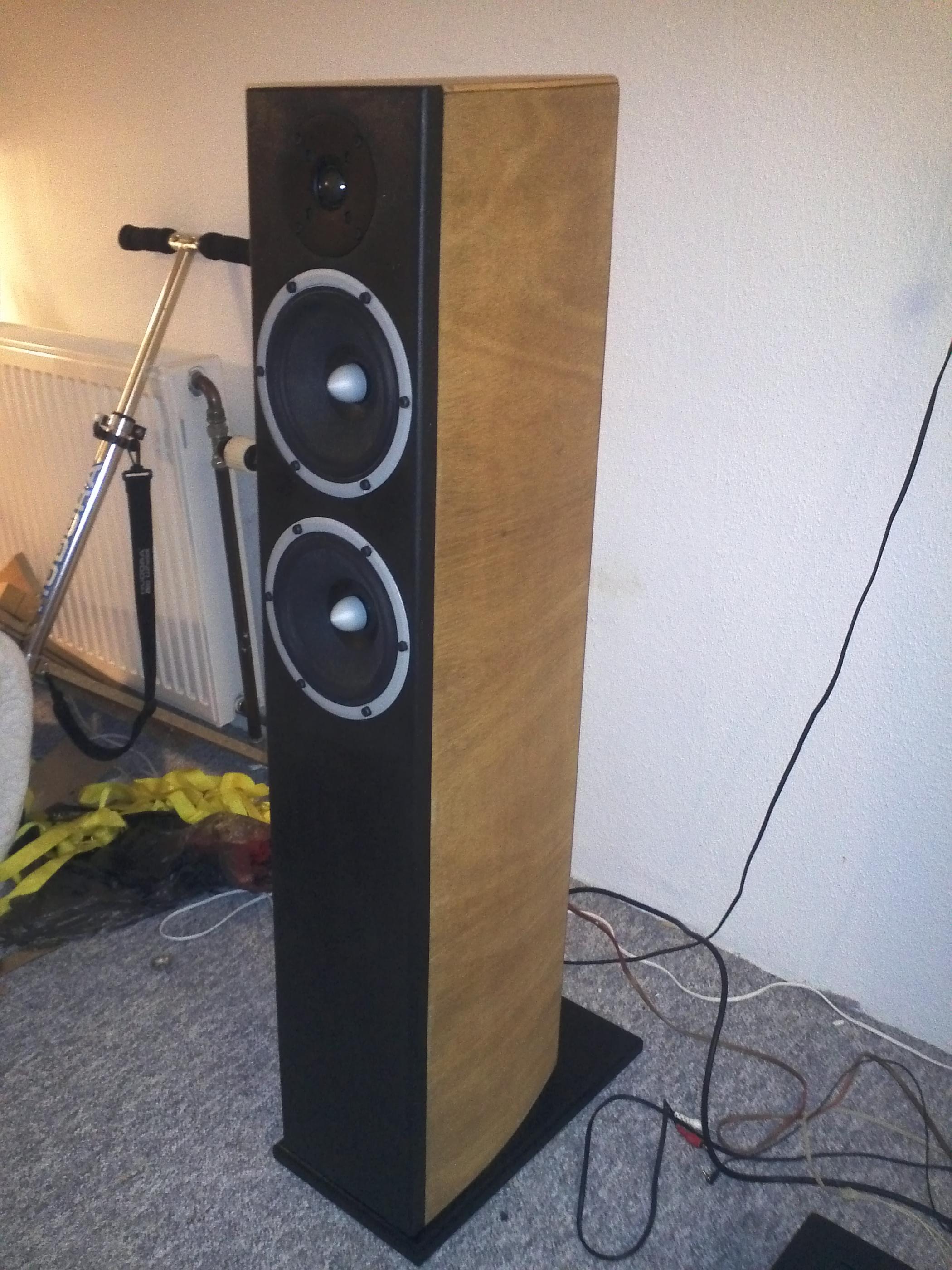

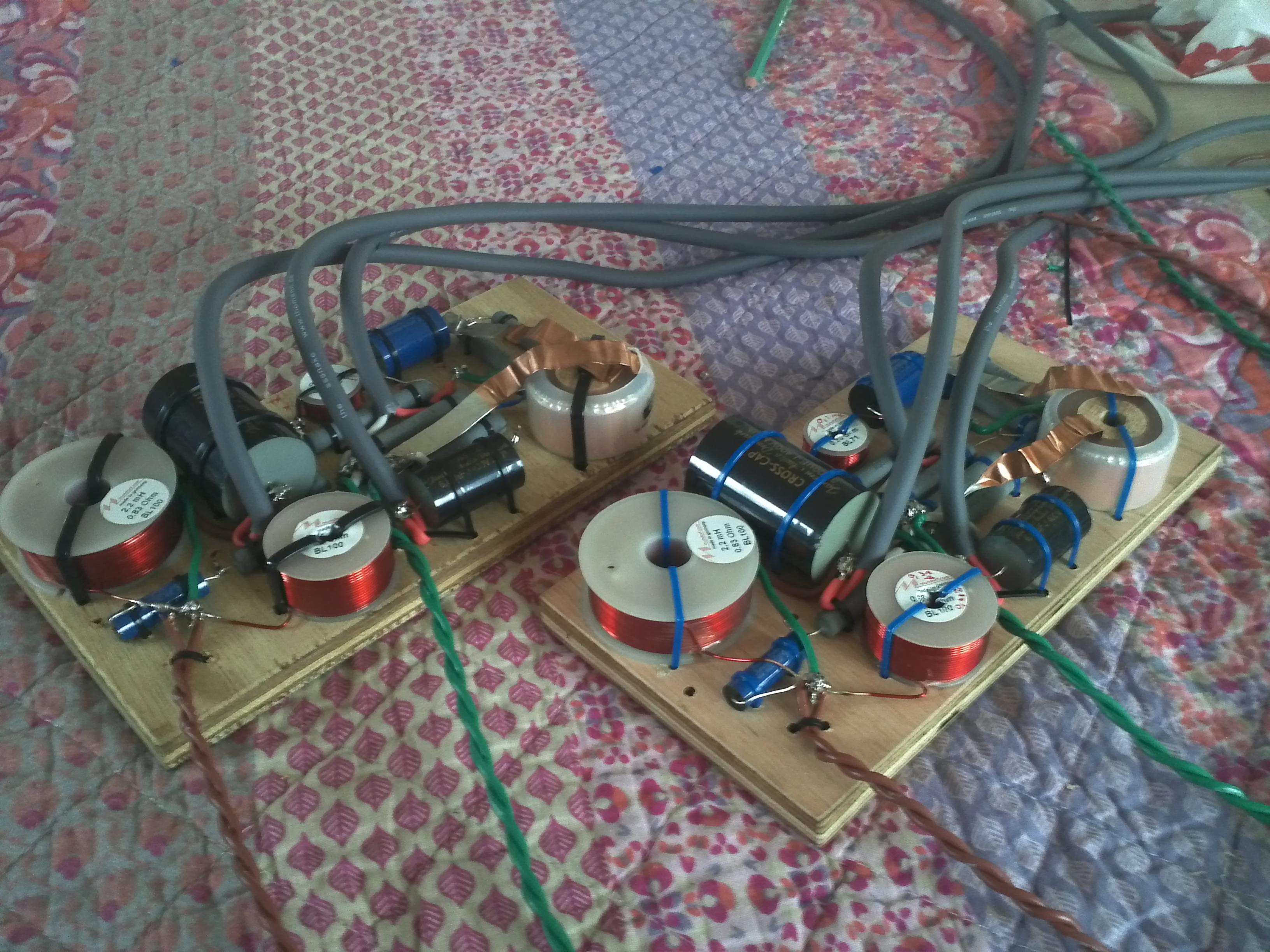

My version of the Peerless Nomex 164 (Troels Gravesen)

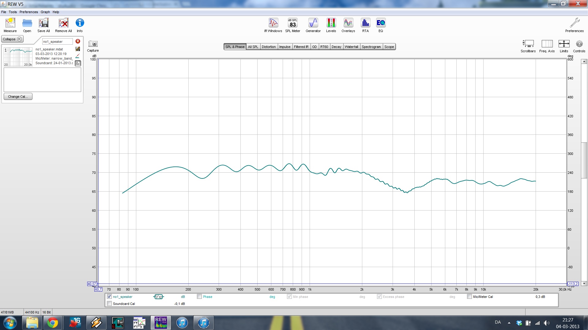

Here's some pictures of my version of Troels Gravesens Nomex 164, featuring the Nomex HDS exclusive bass driver (830883) and a curved cabinet.
The 830883 unit is very similar to the 830875, but small changes might have to be implemented. Right now I have just adjusted the tweeter by changing the L-pad values to 1.2 Ohm and 15 Ohm, but I might try 1Ohm/18 Ohms as well. I have done a measurement as well and the response is very linear (but with a small dip at the crossover frequency, around 3½kHz). I hope I can fix this by adjusting the Zobel network to the 830883s slightly lower voice coil inductance. (Change C2021 to 3.3uF if you follow the link to Troels' design).
