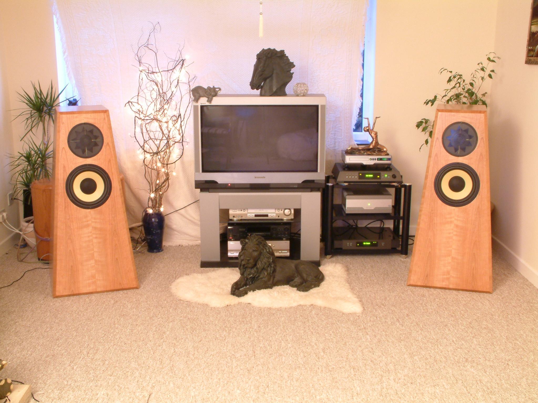

Peerless HDS Excusive system.
Active system. 4th order Bessell. Crossover points
40, 150, 450, 1.4 kHz.
Why Bessell? I found linkwitz-Riley better than Butterworth for a two way I made.Active system. 4th order Bessell. Crossover points
I used 4th order LR filter for about a year until I tried the Bessell on the advice of an Australian DIY'er. I'm having a way easier time getting a flat response out of my system for one(Why this is, I'm not quiet sure). Another thing I noticed is that imaging specificity is a lot better, the system is more musical sounding(???), and there is less aural fatigue. I never would have thought about trying it if it wasn't for that Aussie. OI! OI! OI!
I found the butterworth lumpy handing off the the woofer to the tweeter on my two way. It just didn't sound right. When I switched to the LR at the 3KHz Xover it all just fell together with no further adjustment needed. I didn't try the Bessell. I understand it is a better Xover for transients.I used 4th order LR filter for about a year until I tried the Bessell on the advice of an Australian DIY'er. I'm having a way easier time getting a flat response out of my system for one(Why this is, I'm not quiet sure). Another thing I noticed is that imaging specificity is a lot better, the system is more musical sounding(???), and there is less aural fatigue. I never would have thought about trying it if it wasn't for that Aussie. OI! OI! OI!

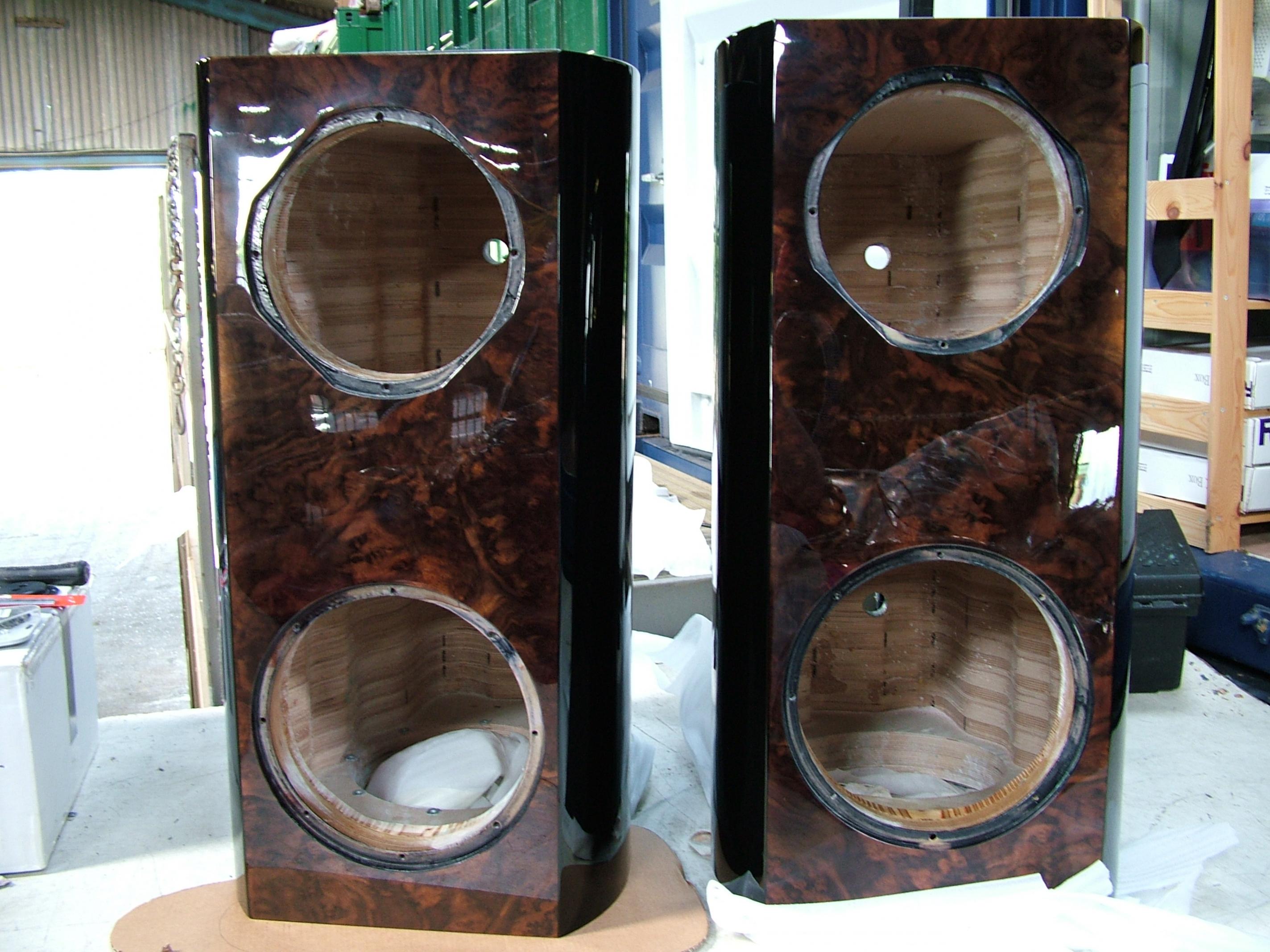

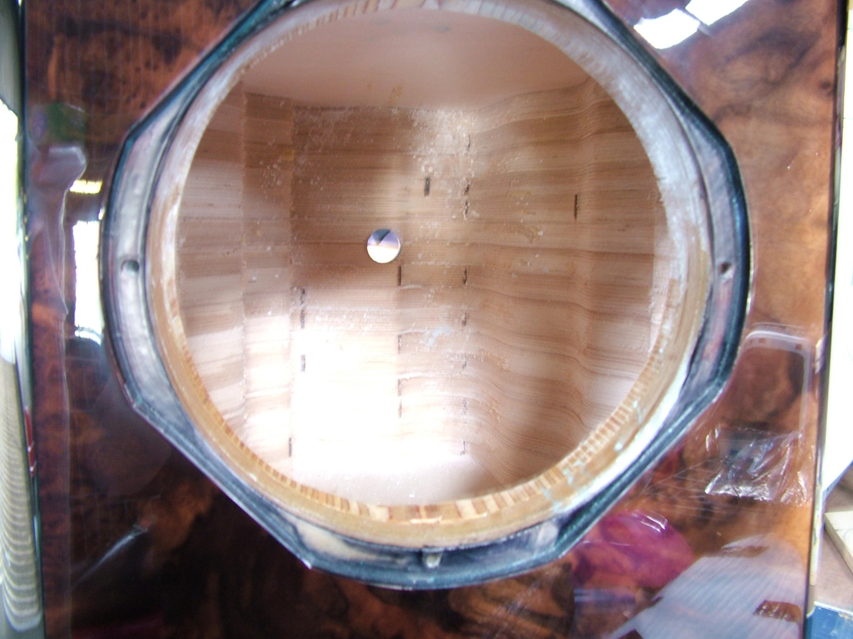

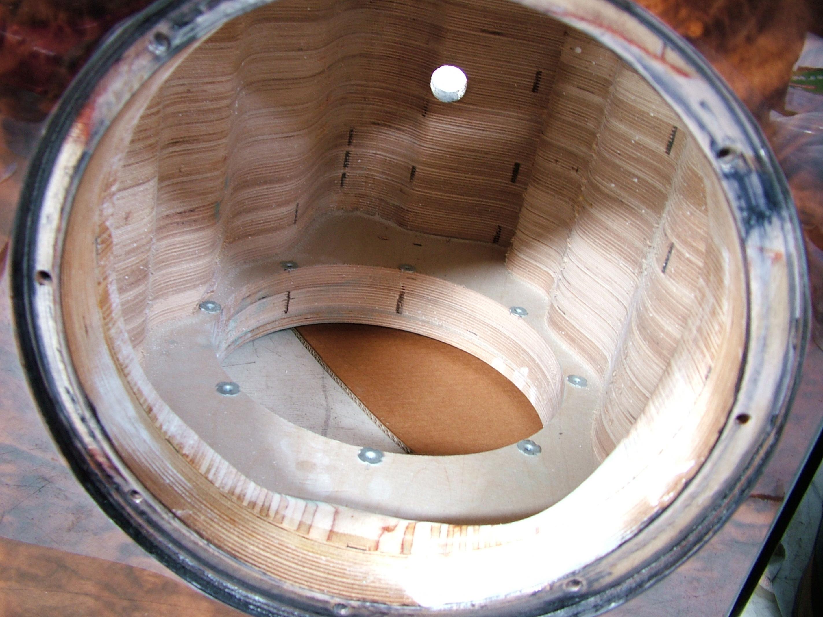

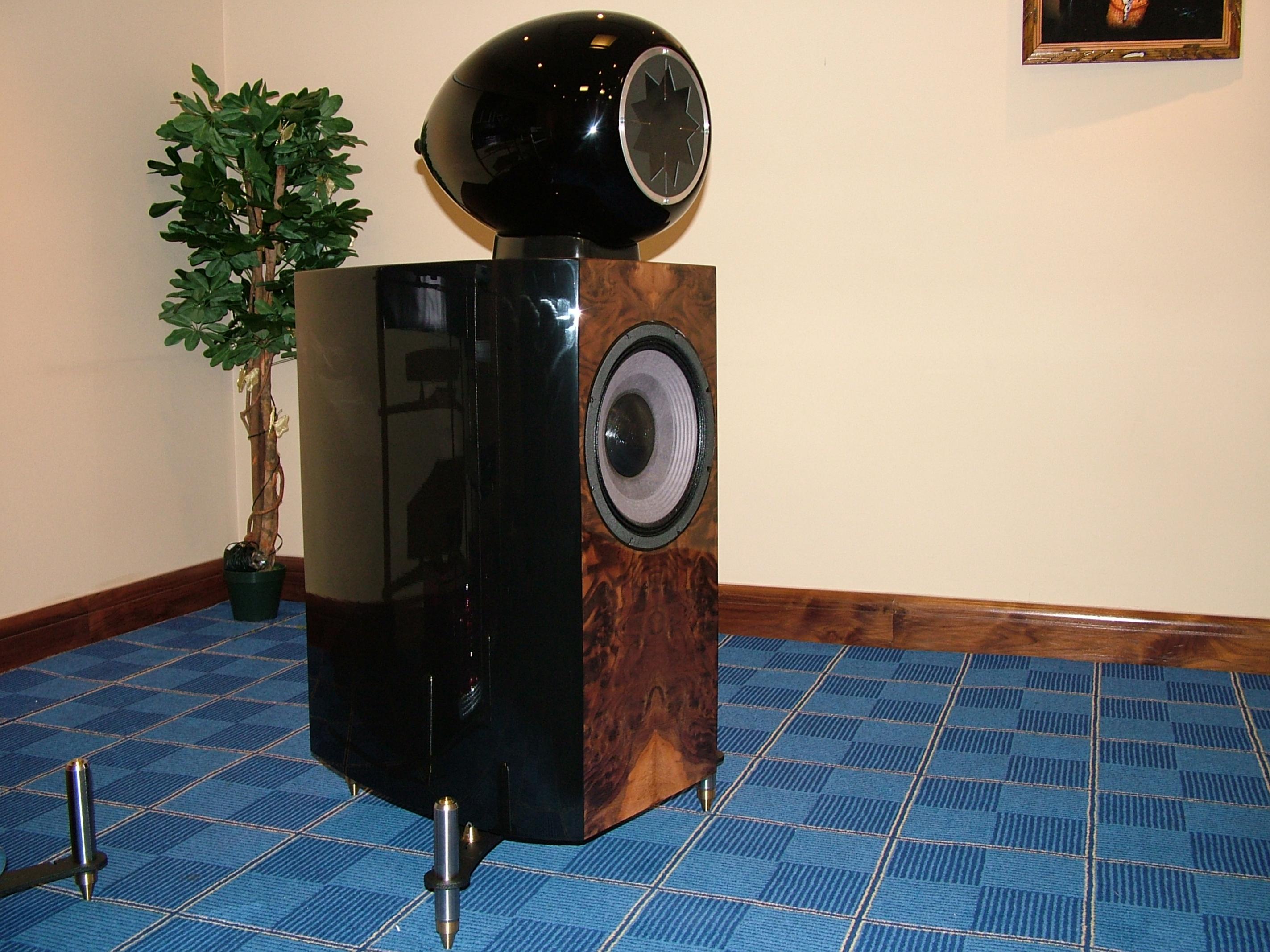

Internal construction was special
Each Encore bass cabinet weighed 100Kg before the bass driver ( 12Kg) the Manger head unit ( 20Kg) and the Sistrum stand ( 15Kg)...

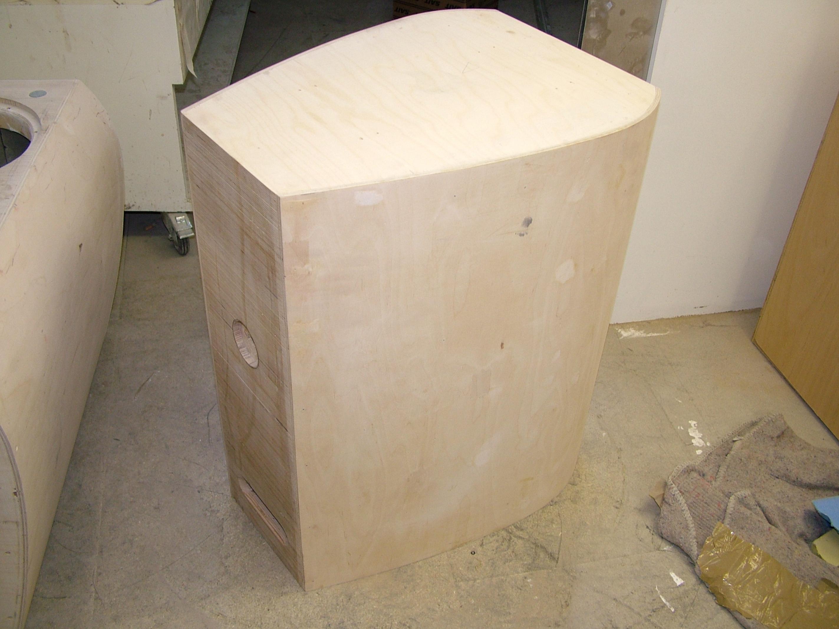

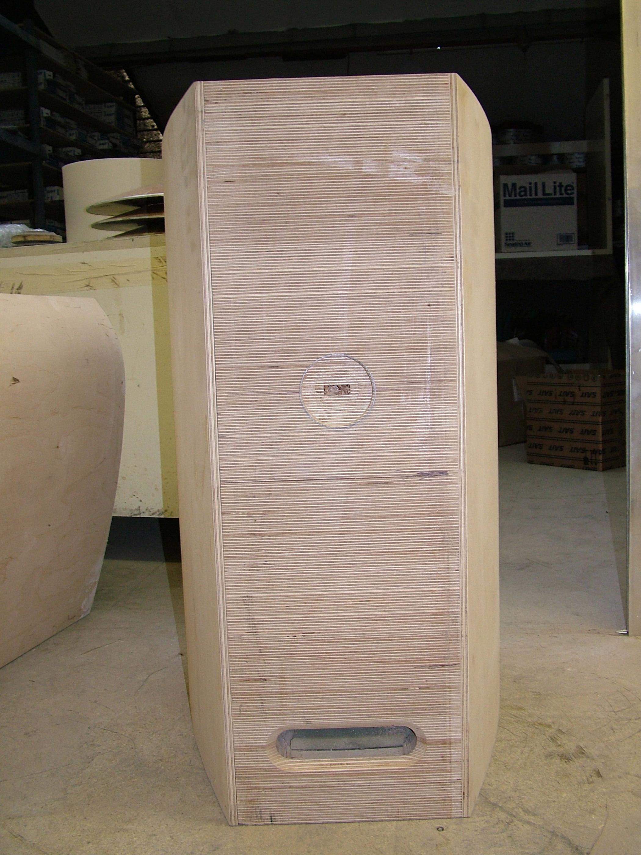

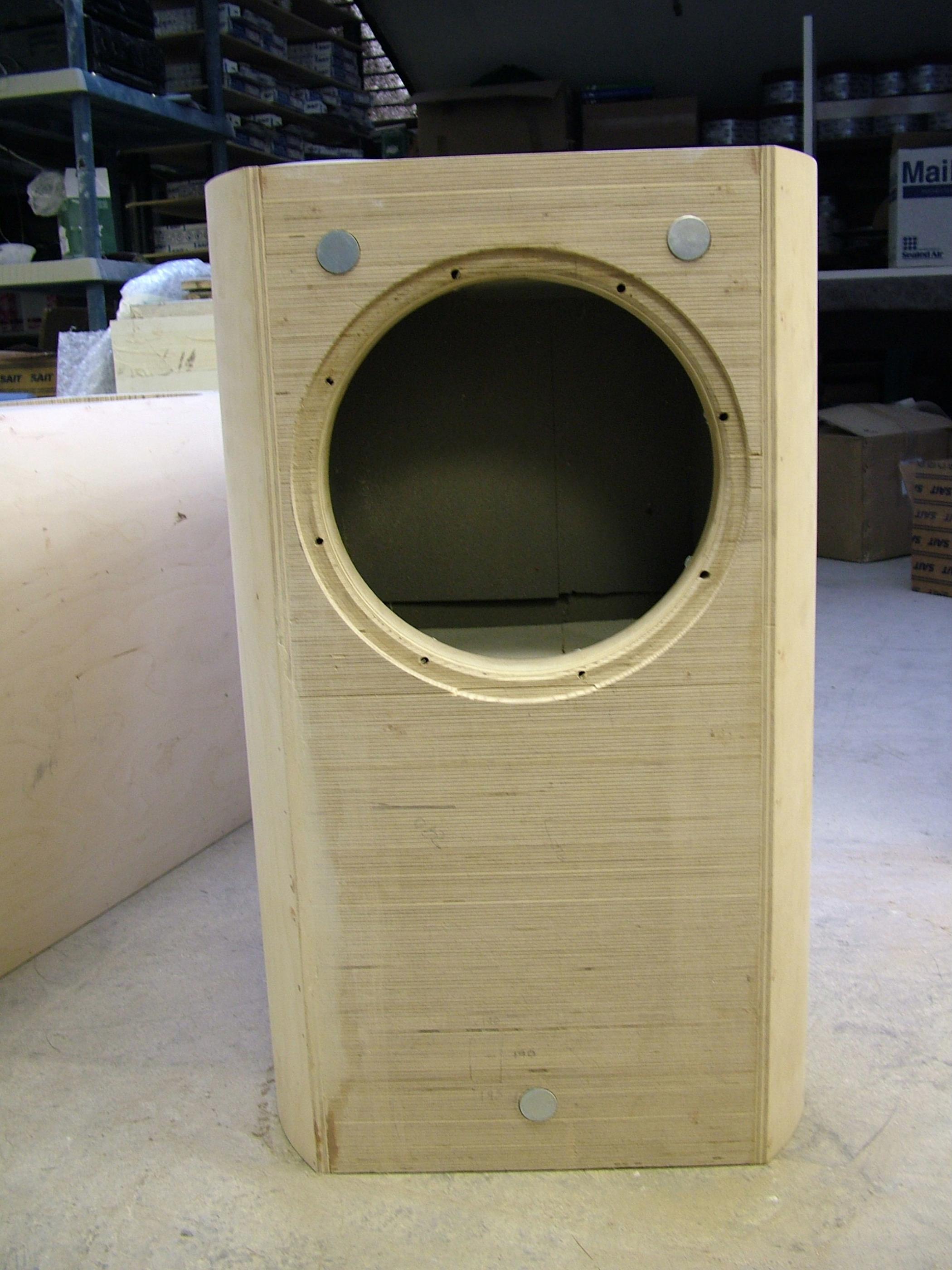

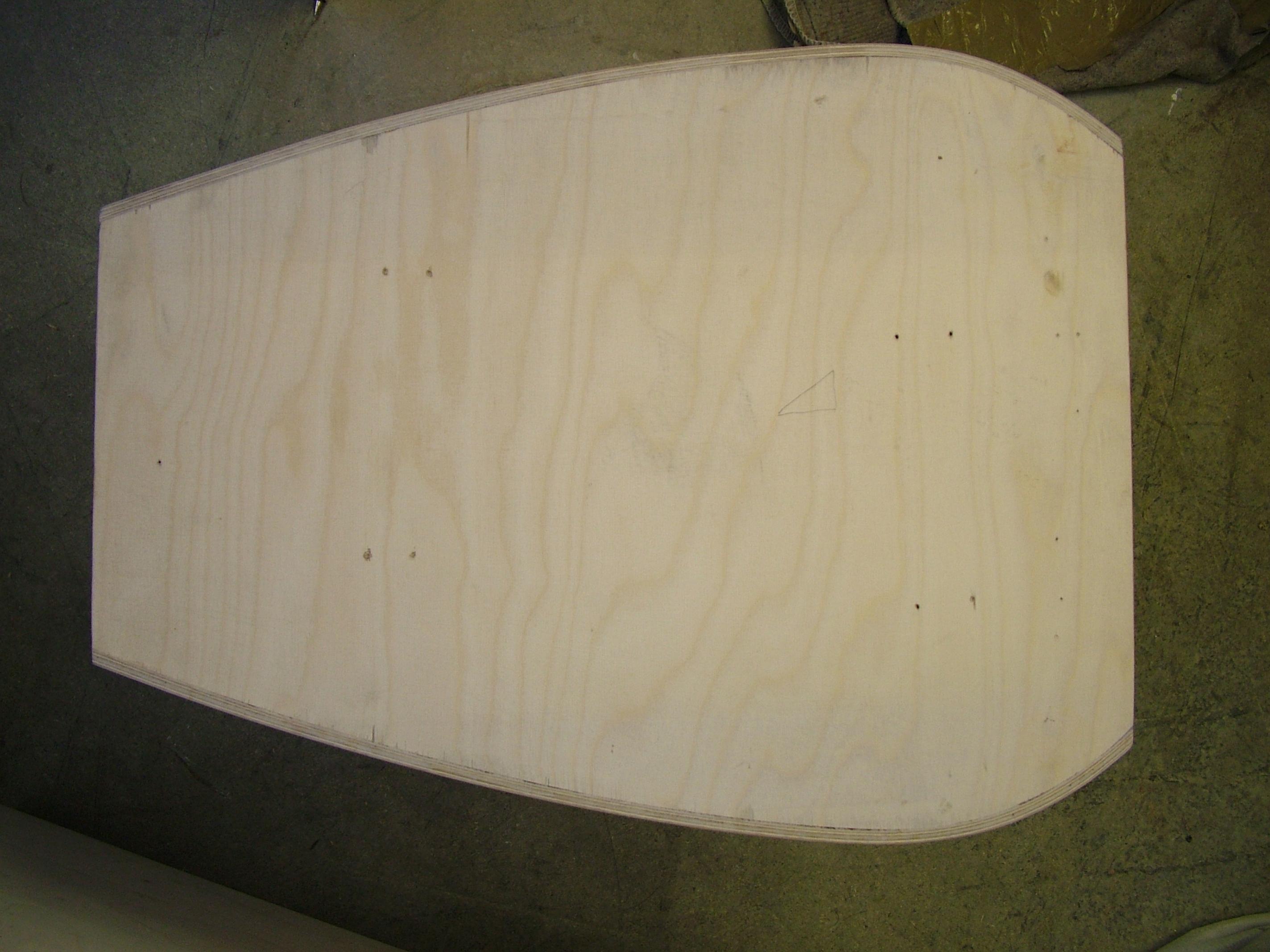

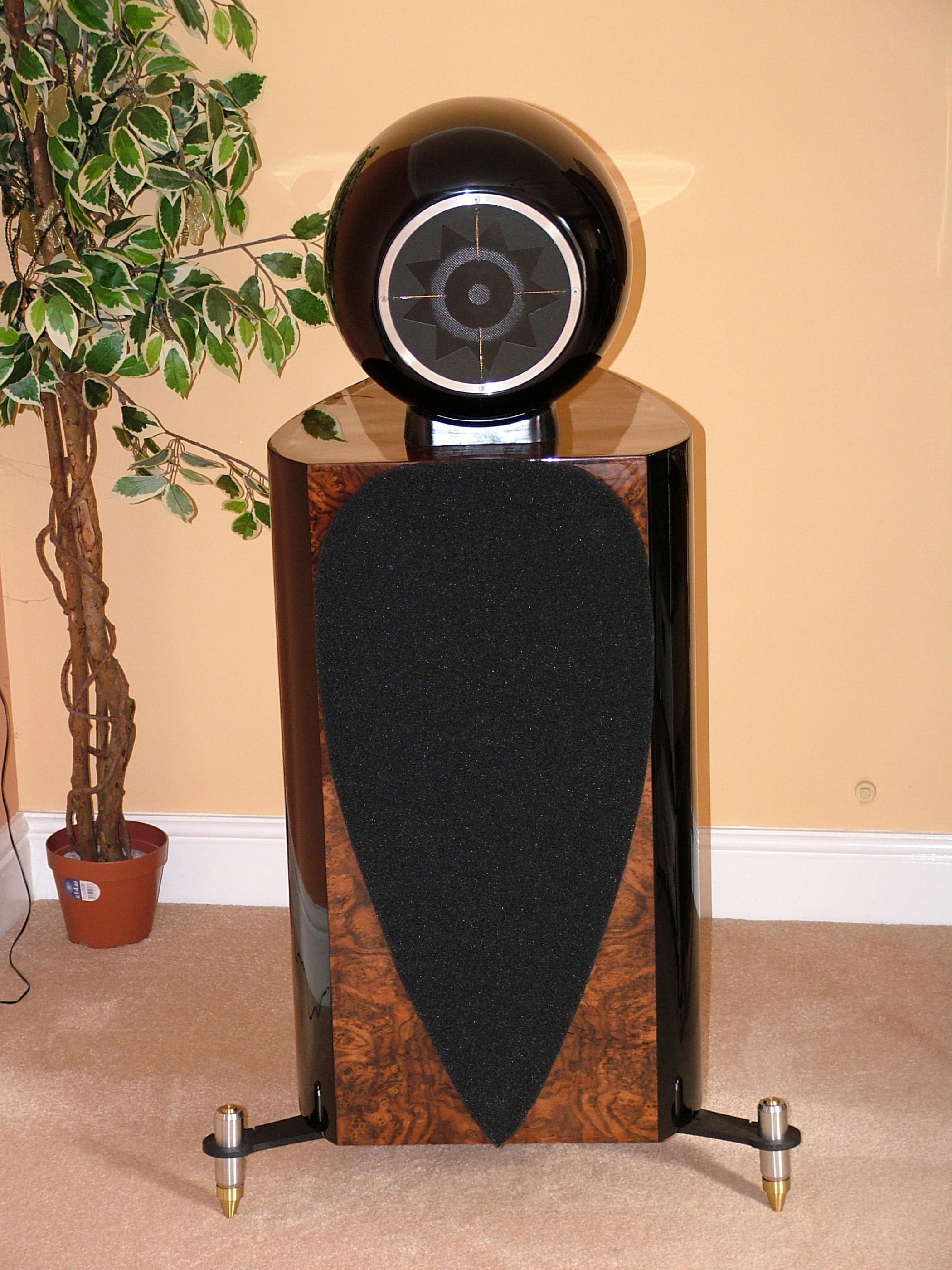

External ply cladding over ply stack
In order to get a flawless finish ( mirror black, not just gloss black) we had to clad over all the stack surfaces before sanding / painting / veneering and lacquer.
