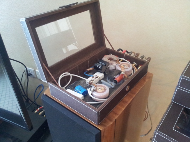

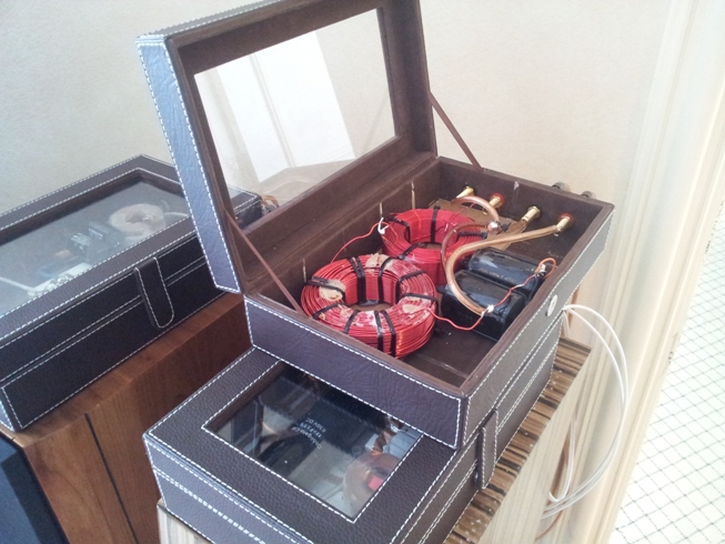

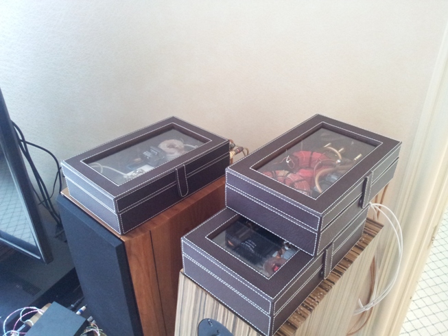

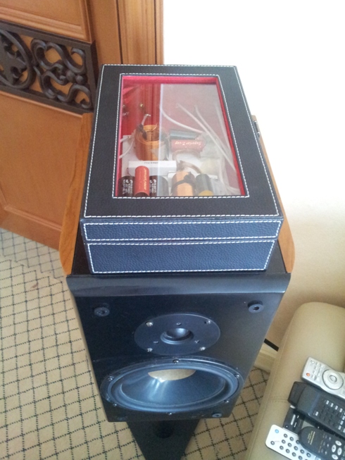

I decided to tidy up my external crossovers and Found some leather wrapped jewelry boxes at a Mall here in Surabaya. They really turned out nice and now all my speakers have the crossovers in these beautiful leather boxes sitting ontop of the speakers.
Those look great in those boxes!
Im a newb when it comes to fancy crossover stuff... can you enlighten me as to why the components in those crossovers are so large? Those look like they are the size of large amps!
