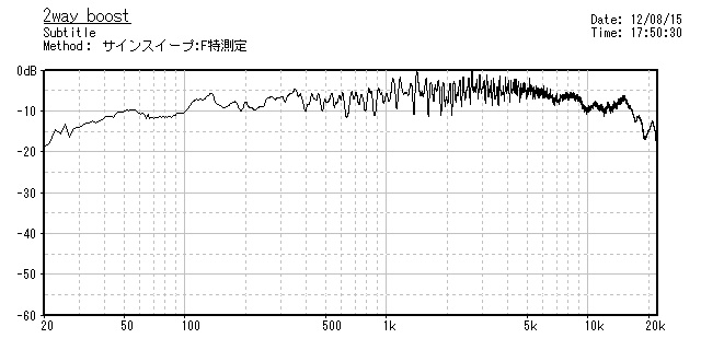

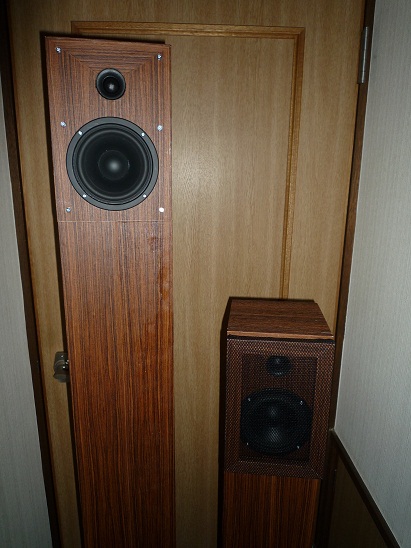

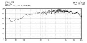

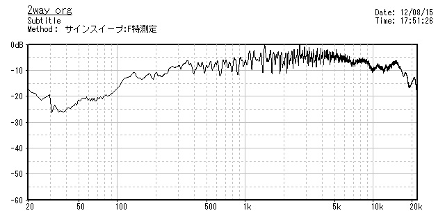

Low boost in a sealed speaker. However, intermodulation, the amplitude limits, not be able to make a loud sound.
Therefore, may be remodel to the bass reflex type.
(The frequency response is naked and low boost)

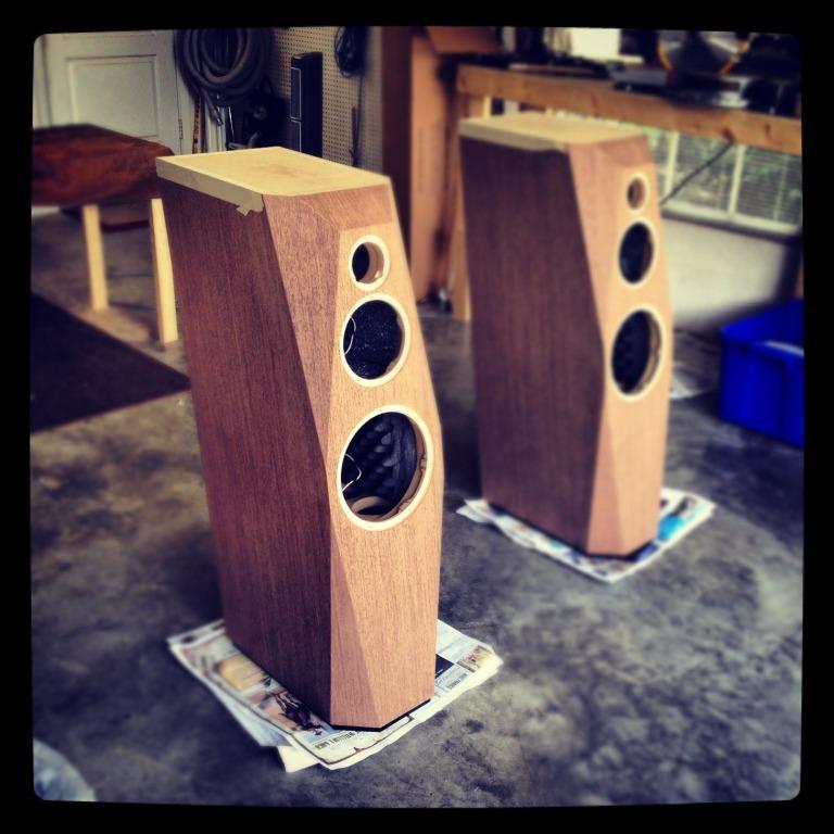

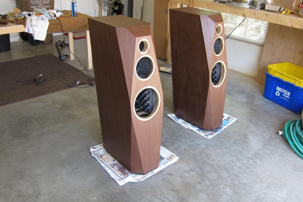

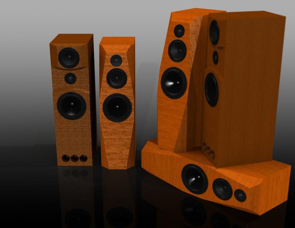

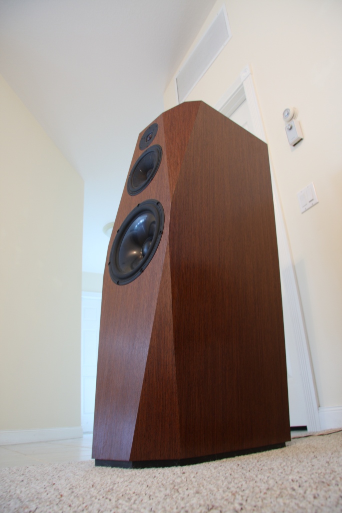

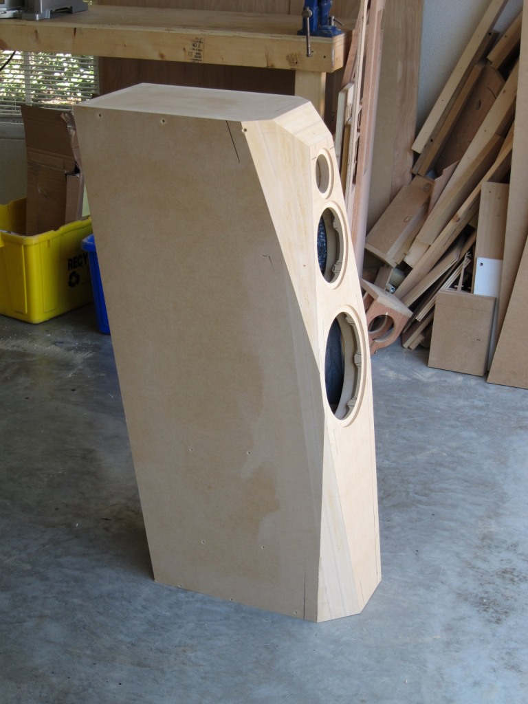

3-Way Scan-Speak,
Impressive work - bravo!
So how do they sound?
Same drivers (6600/8531T/8861T) with different design from avalon acoustics I let you guess which one 🙄3-Way Scan-Speak,
Next pictures with white gloss paint on when they'll be finnished!
The right channel as it looks now.
nice!

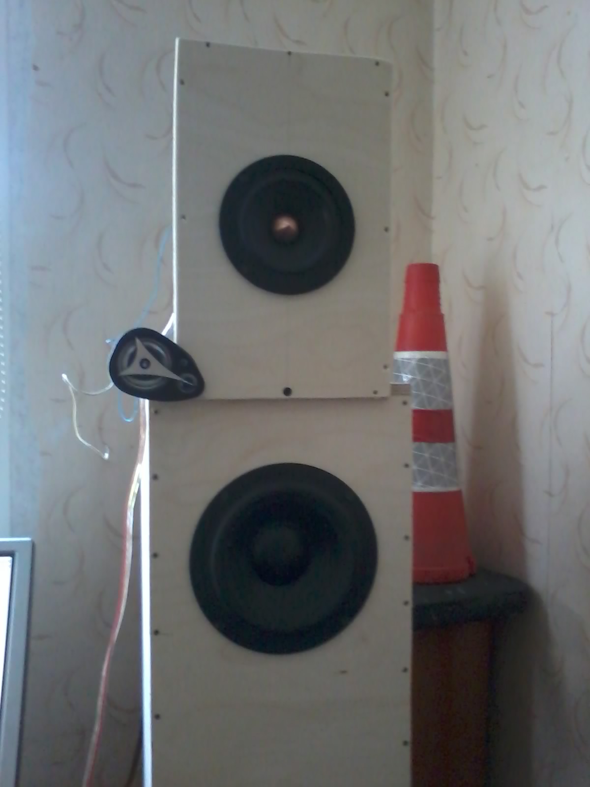

Have the same drivers. The woofer i will use is eminence gamma 15a2.
But i have the selenium and the eminence on top.
Where do you cross them?
Hi Razvan,
nice to learn that you're using same drivers; I cross them at 500Hz and 5kHz.
Dorin
Dorin

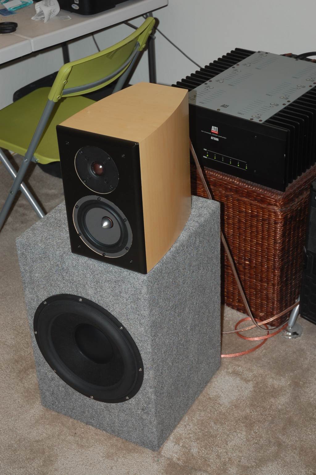

My 3-way nearfield speaker system
Tweeter: Scanspeak 9130 (formerly Peerless "HDS")
Mid: Seas M15CH002
Sub: Peerless XLS-12 830500
Monitor box from PE.
Sub box (great build, with brace) from avpriority@ebay.
Crossover via miniDSP 4x10:
LR4 100hz
LR4 2800hz
Amplifier: ATI 1506 6x150w
I sit on the floor close to the speakers and listen to classical music.
The soundstage produced by these monitors is incredible, you can easily locate the different sections of the orchestra, and it has enormous depth, as if you're sitting in the back of the hall.
This project hardly qualifies as DIY as all I did was drill, screw and config the software.
It just shows the beauty of the modern consumer world where anyone can build epic quality speakers with minimal skills.
