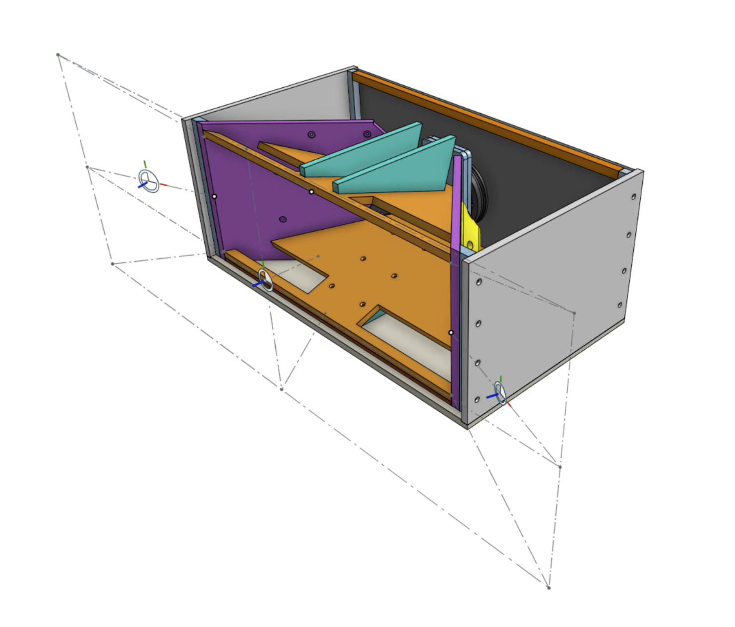

I'm getting close to completion with my drawings now, but I just can't seem to figure out how the grill frame and secondary horn are supposed to attach to the front? Is the grill a continuation of the primary horn angle-wise? If anyone could take some close up photos of their grill frame and/or secondary horn attachment I would be sincerely grateful!

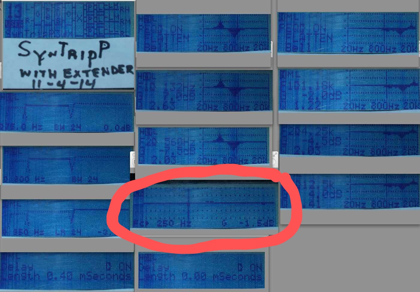

As my Sound Quest moves forward, I am currently designing Sound Systems using only Analog devices on the entire sound chain. At the exception of the original media player which can be a "CDJ" type of device, the entire audio path is analog from DJ mixer to Amp. Signal Processing is done using mastering grade and 90s 19" rack units like Drawmer compressor and EQs, 500 series module and 31 Band EQs. The crossover work is usually done using near vintage Rane crossovers or similar second hand units and I have been getting great results as far as sound quality is concerned. I do know how to use DSP and am very familiar with them in every way, however I would like my future builds to be compatible with a fully analog processing chain. This would be my 11th criteria right after the 10 criterias you based your work on (which I all fully agree on and would like to maintain valid).
Now the use of Analog Crossovers usually comes with serious limitation vs. DSP capabilities, the biggest ones being fixed filter slopes (in most case LR24 or BW24 with some exception for very hard to find devices) and the lack of analog delay tools for time alignment. I do own some units with 2ms delay capabilities on the LF output but delay on HF is a tool I haven't seen anywhere so far on analog crossovers. I could of course try to build one myself but I still lack some knowledge and skills to do so.
So here come my questions : do you see any adaptation to the current design that would remove the need for delay between outputs on the active configuration, and do you think that using identical filter slopes for every driver could work if well compensated with EQing and level matching ?

1/3 octave EQ on each output won't provide the filter Q resolution to achieve flat response with the SynTripP design. You could use analog parametric EQ to do it and still use LR 24 slopes, though using the same frequency and slopes for the 10" and HF driver will require more PEQ bands to compensate for the differing slopes.

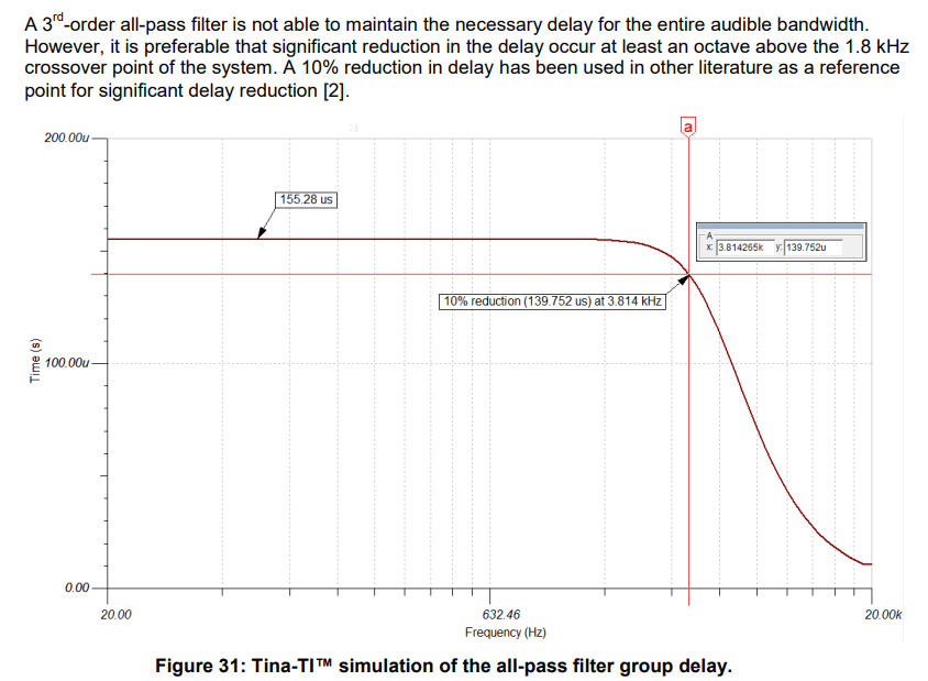

The 0.4ms delay on the HF could perhaps be done with an analog all pass filter, you may find response "close enough" without.

My research on allpass filters for HF delay tends to show that delaying the HF driver will lead to a non linear delay (as shown on the attached picture). I don't know how this would affect the perception of "unified sound" coming out of the synergy horn, but looking forward to test and measure it.

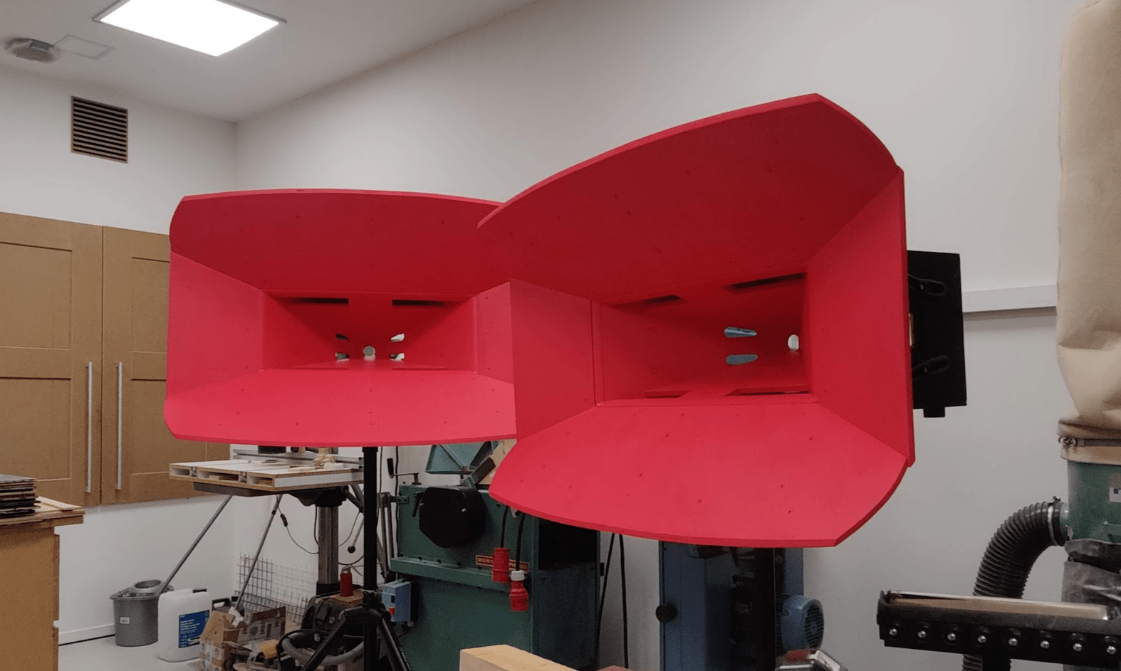

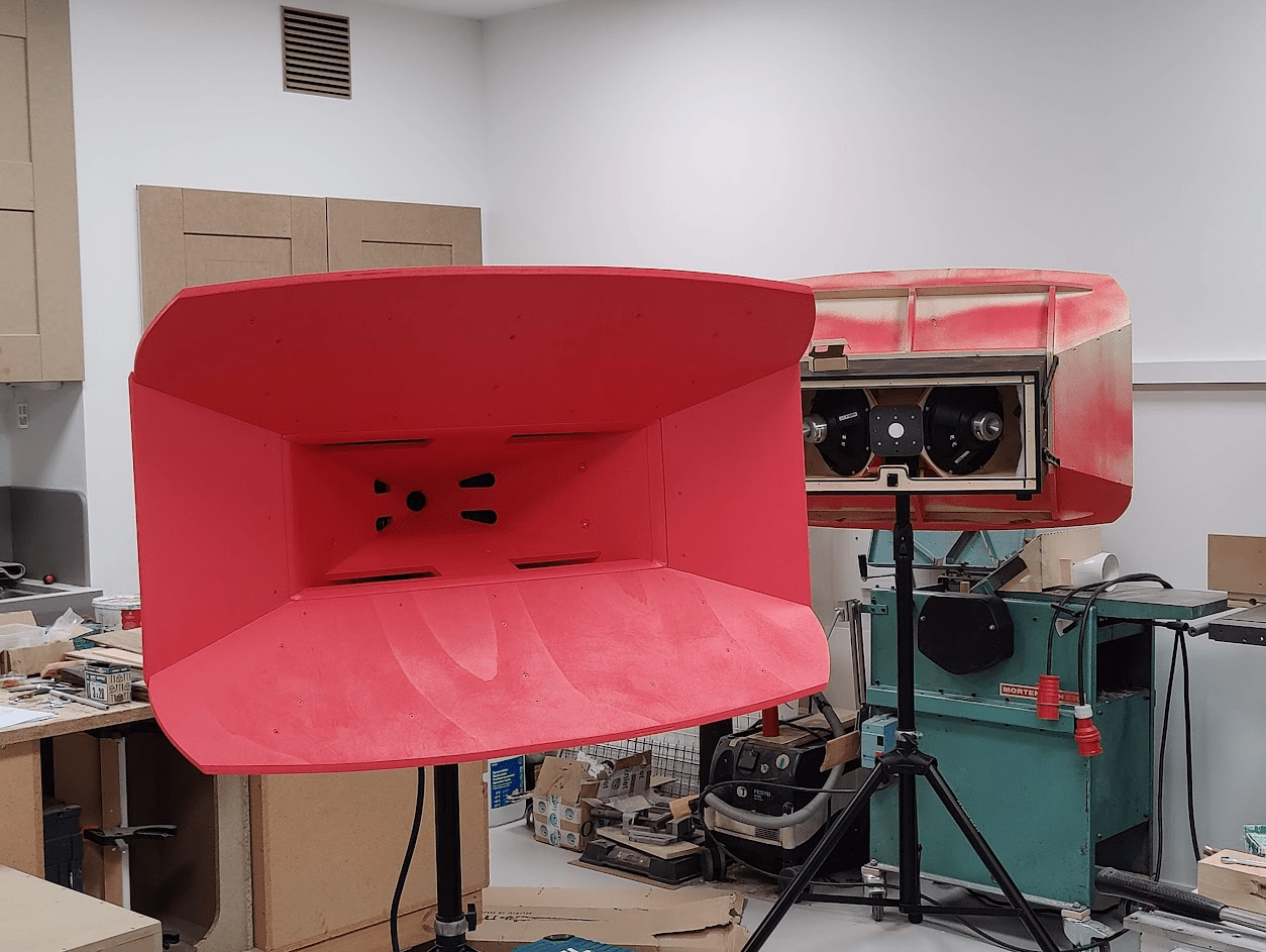

We’d like to share some of our experiments with additive manufacturing methods, i.e. large scale 3d printing with pellets instead of filament. We have made a keystone subwoofer quite some time ago, you can find it in the keystone thread.
We have adapted the SynTripp design to make it printable. Also we’ve adjusted the throat horn curve a tiny bit, as well as the extension. We've increased the extension length by a bit to increase directivity to lower frequencies. Here are some photos of the build process. We nickname it the "SynTripPp" with the last p for printed.
It feels really dead and stiff. It's made of a composite which has a substantially higher tensile strength than baltic birch. The downside, the way we designed it, it is also heavier than made off wood. You can't have it all
What are your thoughts?

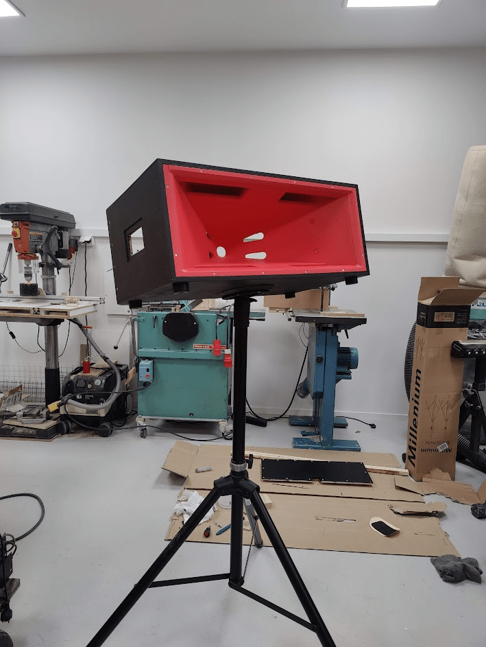

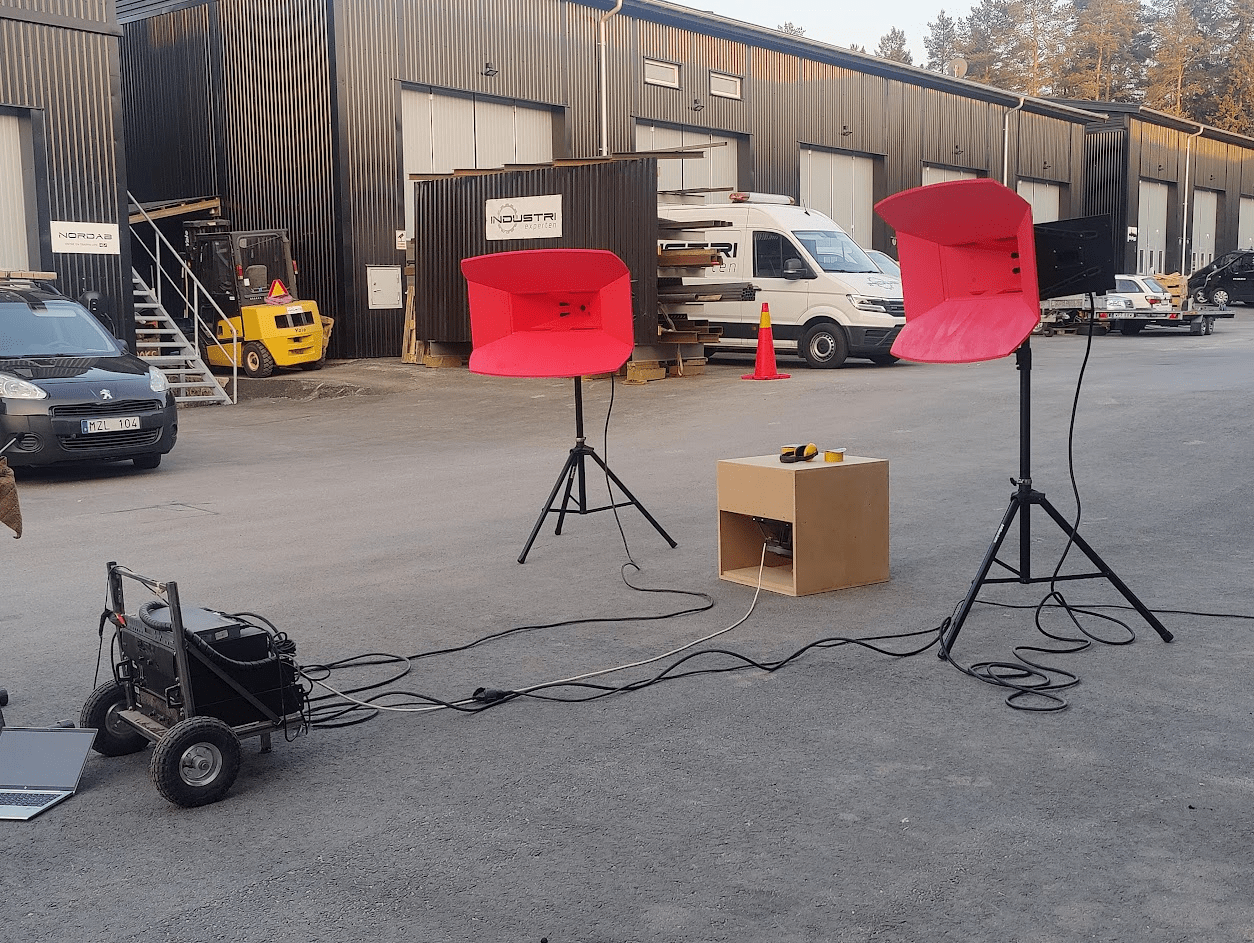

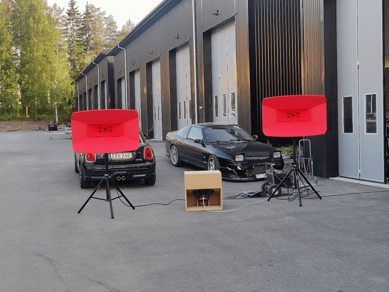

Hello Leo,Art, what the ****?
Yesterday I listened to both of the boxes outside for the first time, and the sound is unreal.
I've never heard sound of this quality in my entire life. I had some really high expectations and was still completely blown away. I'm pretty sure you could call this a spiritual experience... I'm not even going to bother talking about the insane clarity/directivity/loudness, but one thing that fascinates me a lot is the complete lack of ear fatigue - even at really high SPL.
Here's around 500 pictures of the building process: https://photos.app.goo.gl/5YFyKBcgGxER1Wp59
I'm still kind of in a shock and don't really know what else to say except thank you, Art.

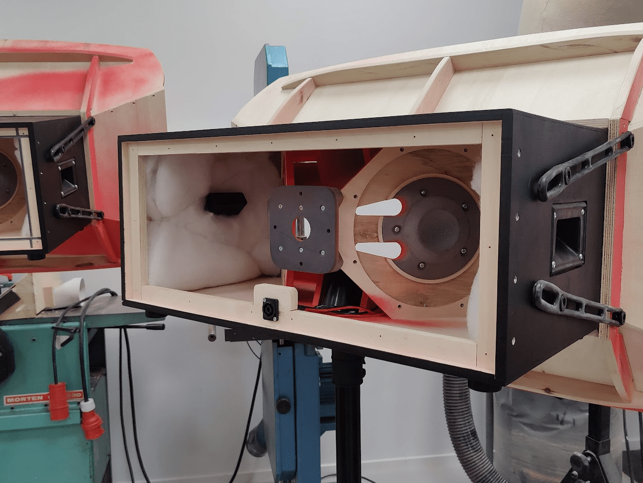

View attachment 1184274 View attachment 1184276 View attachment 1184287 View attachment 1184275 View attachment 1184279
Awesome Build! Our local collective wants to replicate that! Since we are students and don't have experience with woodworking our uni will help us out.
I still got a couple of questions though:
1. In the pictures you use this i assume Rubber Belt thingy to mount the secondary horn. Could you give me a name of that or tell me where to find something like that? Seems easier to mount than with ratchets!
2. You also seem to have added some more structural support to the secondary horns with those horizontal and vertical beams. Could you be so kind as to explain why that was necessary, if at all? We would preferably just cnc everything and then screw everthing together so we don't have to first learn some woodworking haha.
3. From your pictures I gather you have actually made the parts for the secondary horn by hand, right? That seems a bit too hard for us with all the curves and angled edges etc. Do I understand correctly that the angled edges on the curved parts of the secondary horn are only for better visual presentation? Just leaving them out would make it a lot easier.
