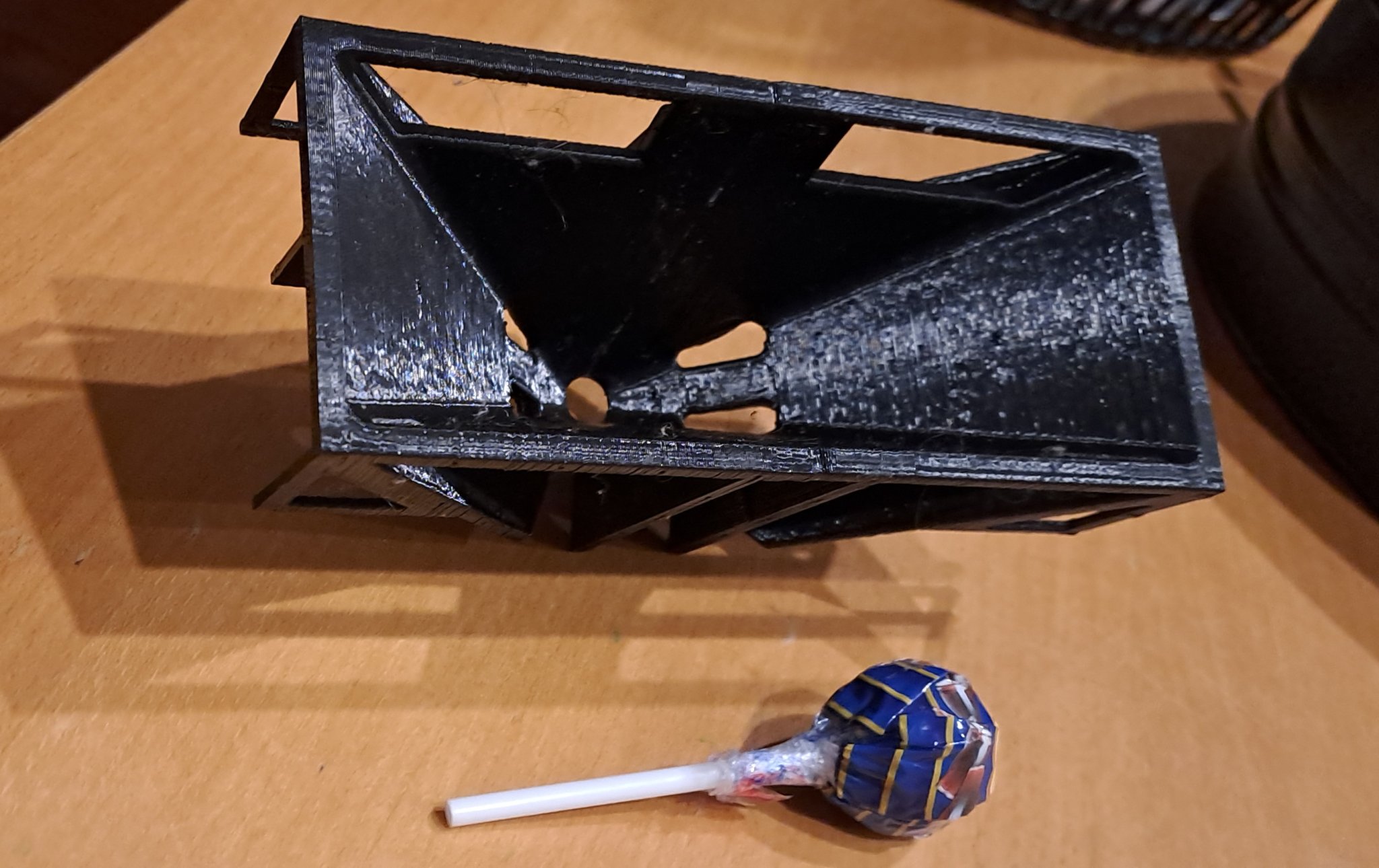

Slowly working up the courage to push play on a 3D print of the horn body. I've successfully printed a version at 25% scale to get a rough idea of support required and found most of the overhangs seemingly OK. It only needed some support underneath the triangular braces running front to back in the centre of the long side of the horn. I'll try and document my experiences (good and bad) of printing these in PETG CF on a Sovol SV06+ in case this is of some assistance to others. This is right at the limit of my skill and my printer's capabilities - bed adhesion is probably going to be the most difficult aspect. I'll have to look at fasteners once I've managed to print it full sized! In any case, I've dropped a load of cash of filament so there's no turning back now! 😛
Perhaps @MrSpeakers or others who've printed these could comment on the throat adapter, which appears to be incorporated in the horn body file...is the transition optimised for a CDX14-3050 ? I tried to peek at the original photos of the print in post #39 and it looks like maybe a 3060 ferrite attached but hard to tell? I've yet to purchase the compression driver so I would aim for a good match to the horn throat.

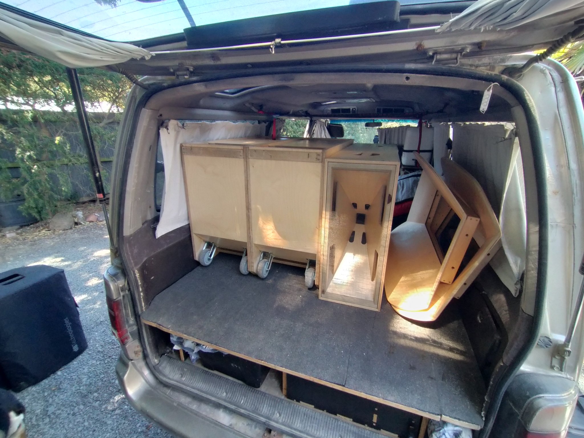

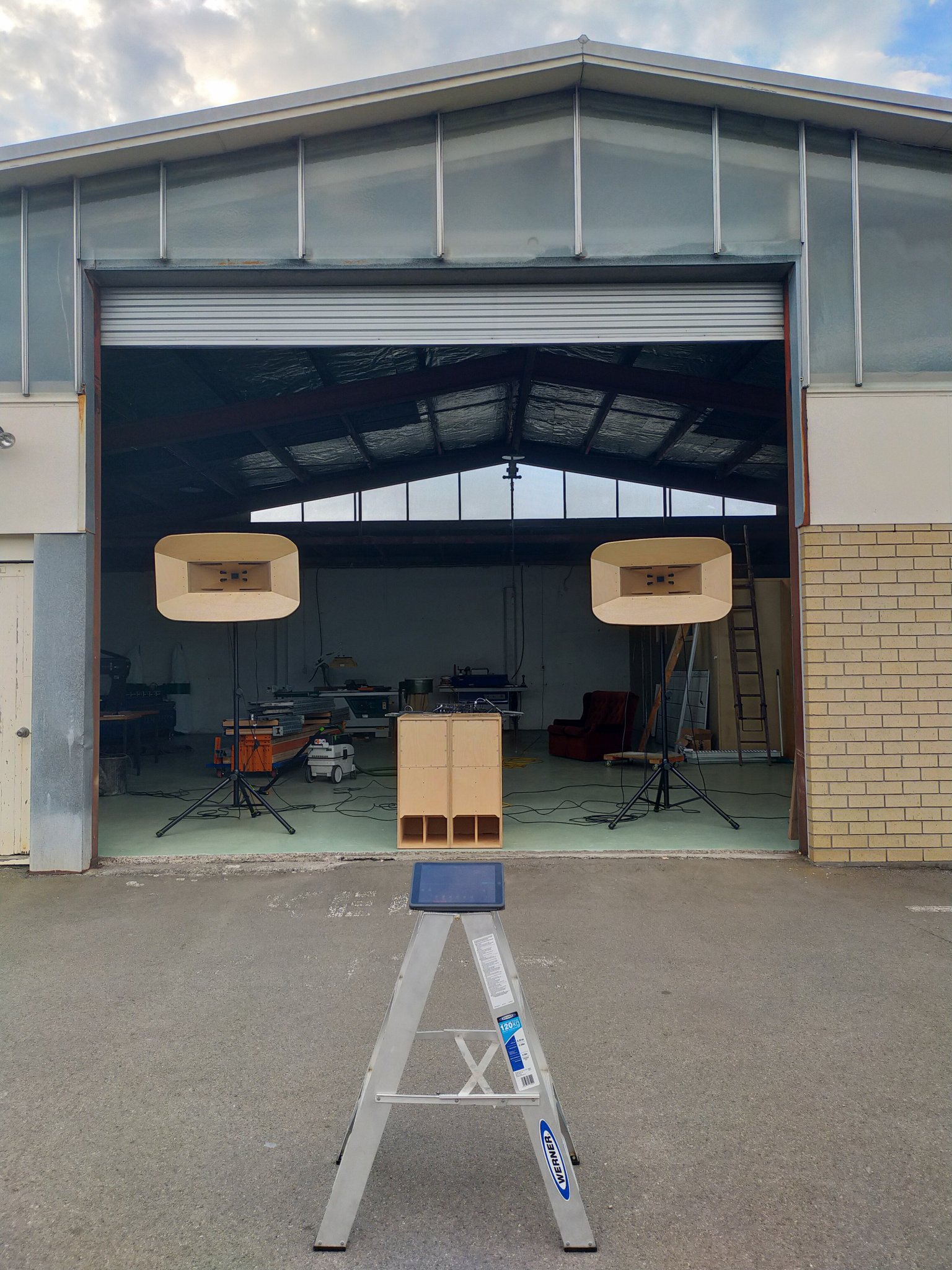

I built a set towards the end of last year, I'm down in New Zealand, Christchurch to be exact. We have a pretty strong sound system community here. I wanted something to run that was easy to deploy and I think this has really ticked that box.
I have been running mine for most of our summer down here. And with so much fantastic feedback. I have had these out at approx 10 gigs this summer, and I am only feeling more and more confident in them.
Super compact setup.
The whole system is less than half my van full.
Here's a rundown:
  • Built from CAD file @leosandstrom 👋

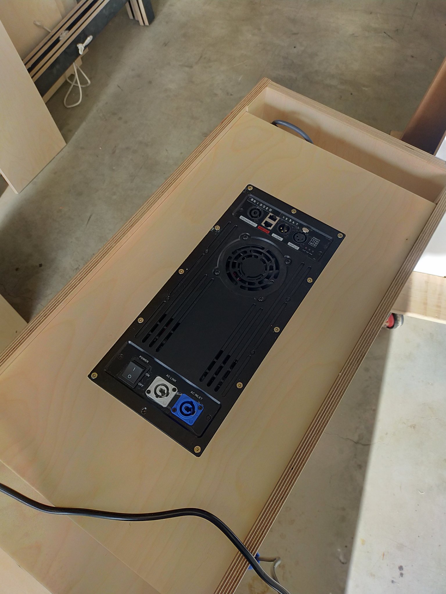

  • This was modified, adding extra compartment on back to house amplifier module with some slots in there to help it breathe. (They are front vented, but it cant hurt right?)
  • Amplifiers are OMB Audio PDA3000+CQ260 2x1500w@4ohm (These are what I use in my Subs, so are easy to tune the system by linking them all up with the RS485)
  • CNC cut, and fiddly bits cut on the track saw.
  • Horn extensions are simply bolted on from the sides, I have a bit of foam tape on the front face, and 3d printed up some long thumbscrews, there are threaded inserts in the sides of the cabinet.

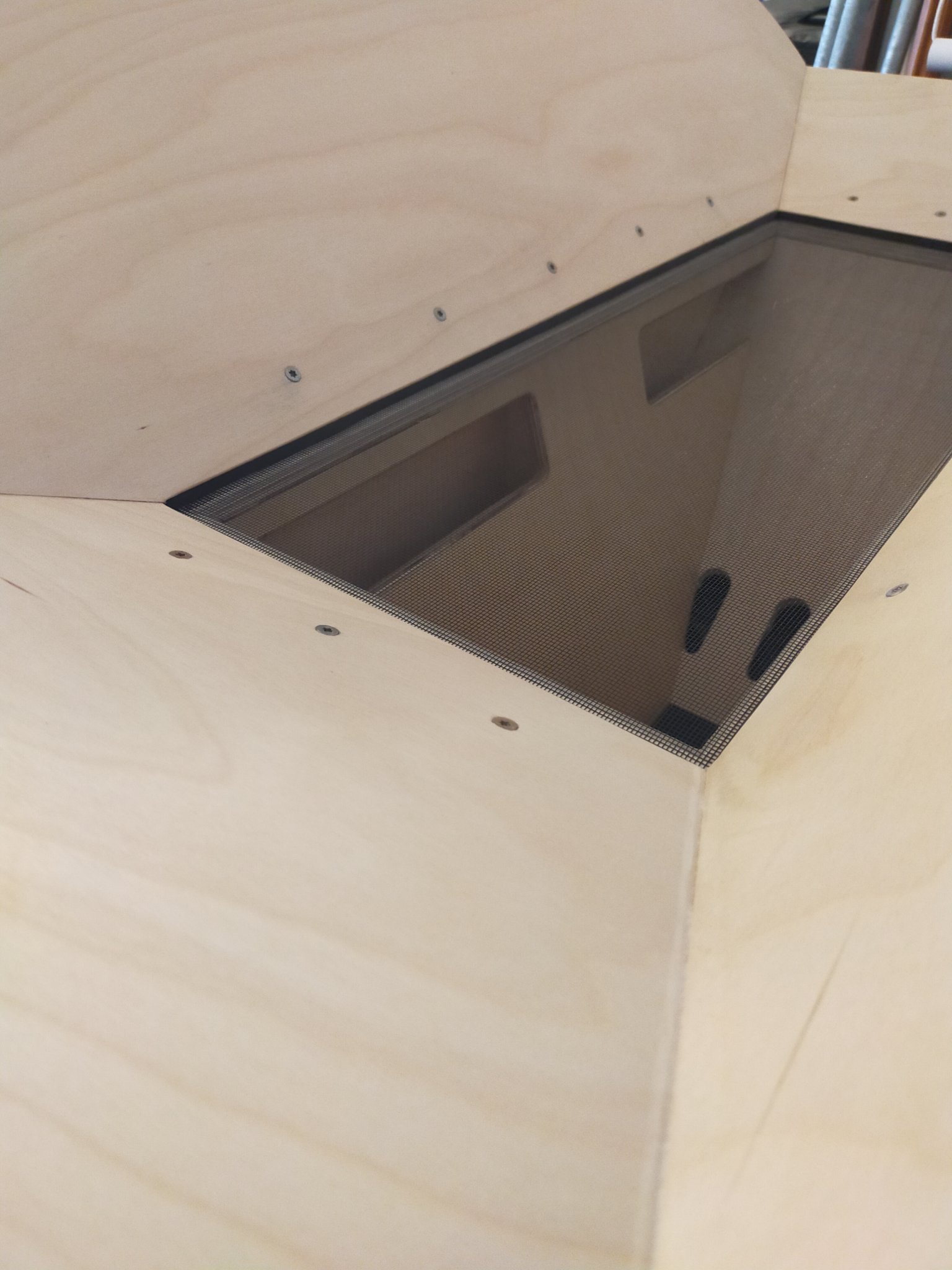

  • I used flyscreen as my grill, just to stop people putting their fingers in there...
Fly mesh grill - foam under horn extension to compress when fitted with bolts to avoid rattle.
Holes in side of frame - bolt through into threaded inserts.
Line Array amps - you can also see the thumbscrews for the horn extensions in this pic.

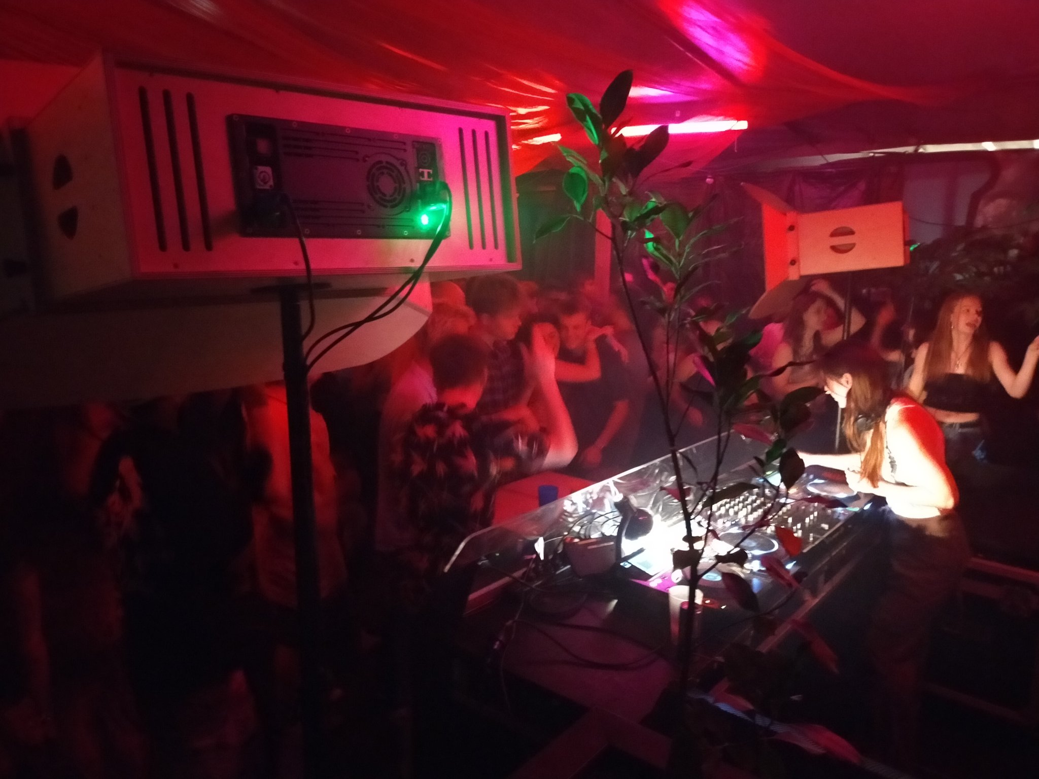

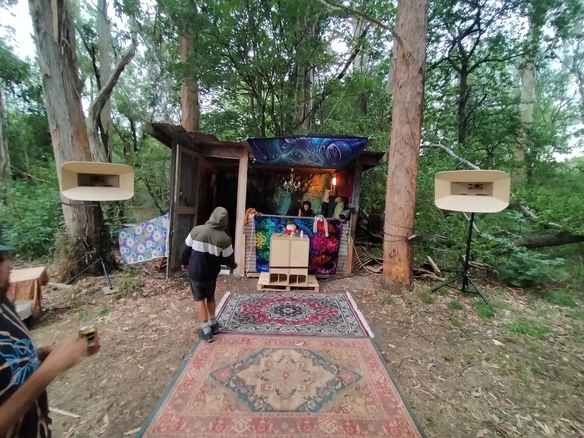

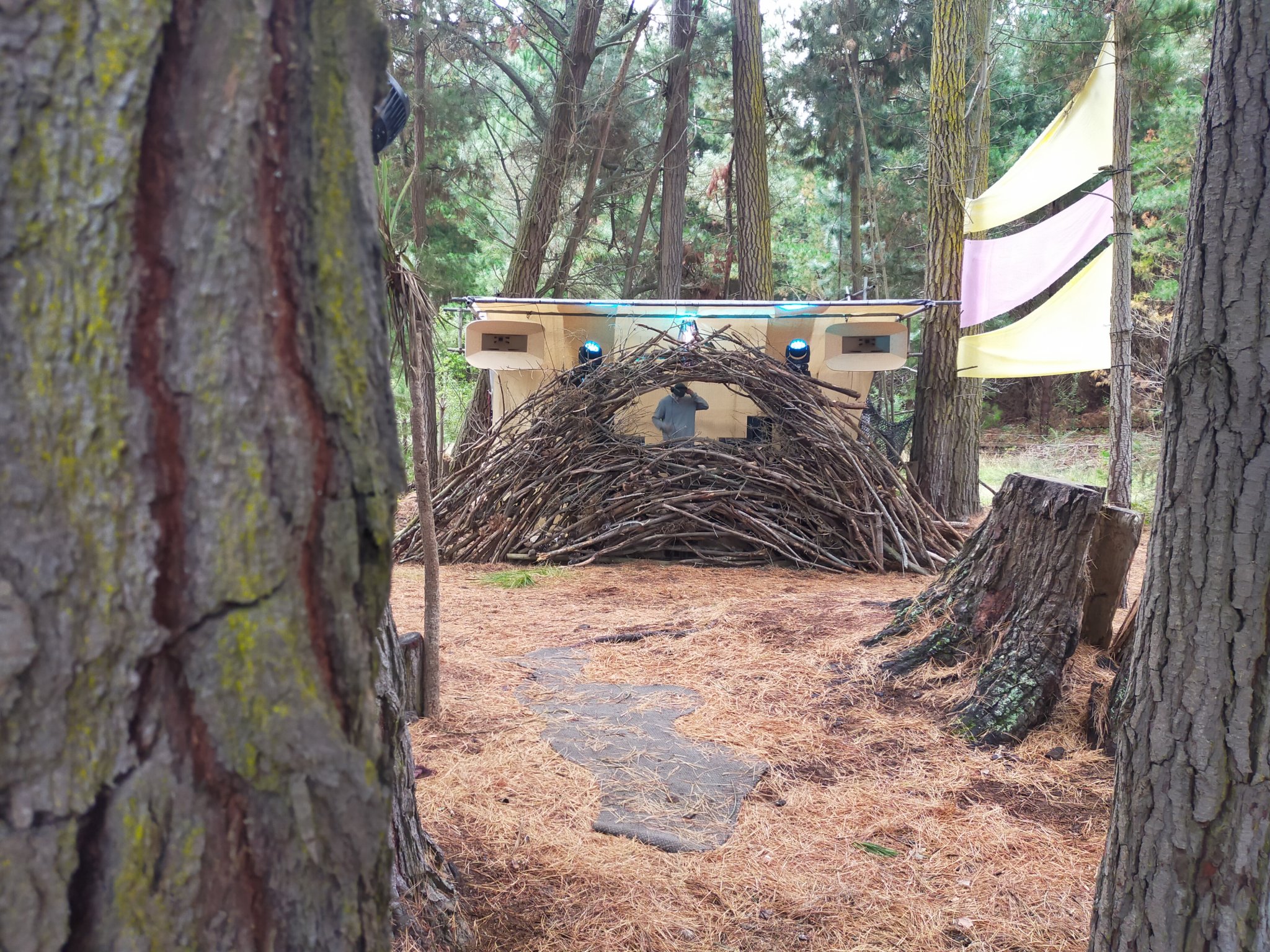

Need more height, stands seem sketchy at their highest... First run outdoors... Output with subs coupled was great.
Mounted on scaffold. DJ is on a 600mm high stage. Subs coupled underneath.
These entertained approx 300pax no problem at our festival stage. 1 of 5 stages, and we constantly got the praise of best sound. I was tuning for low fatigue - even all sorts of musical styles, and never needed earplugs. Having the tops up high made for great coverage.
We had a friend running analog visuals (OHP) on this projection screen.

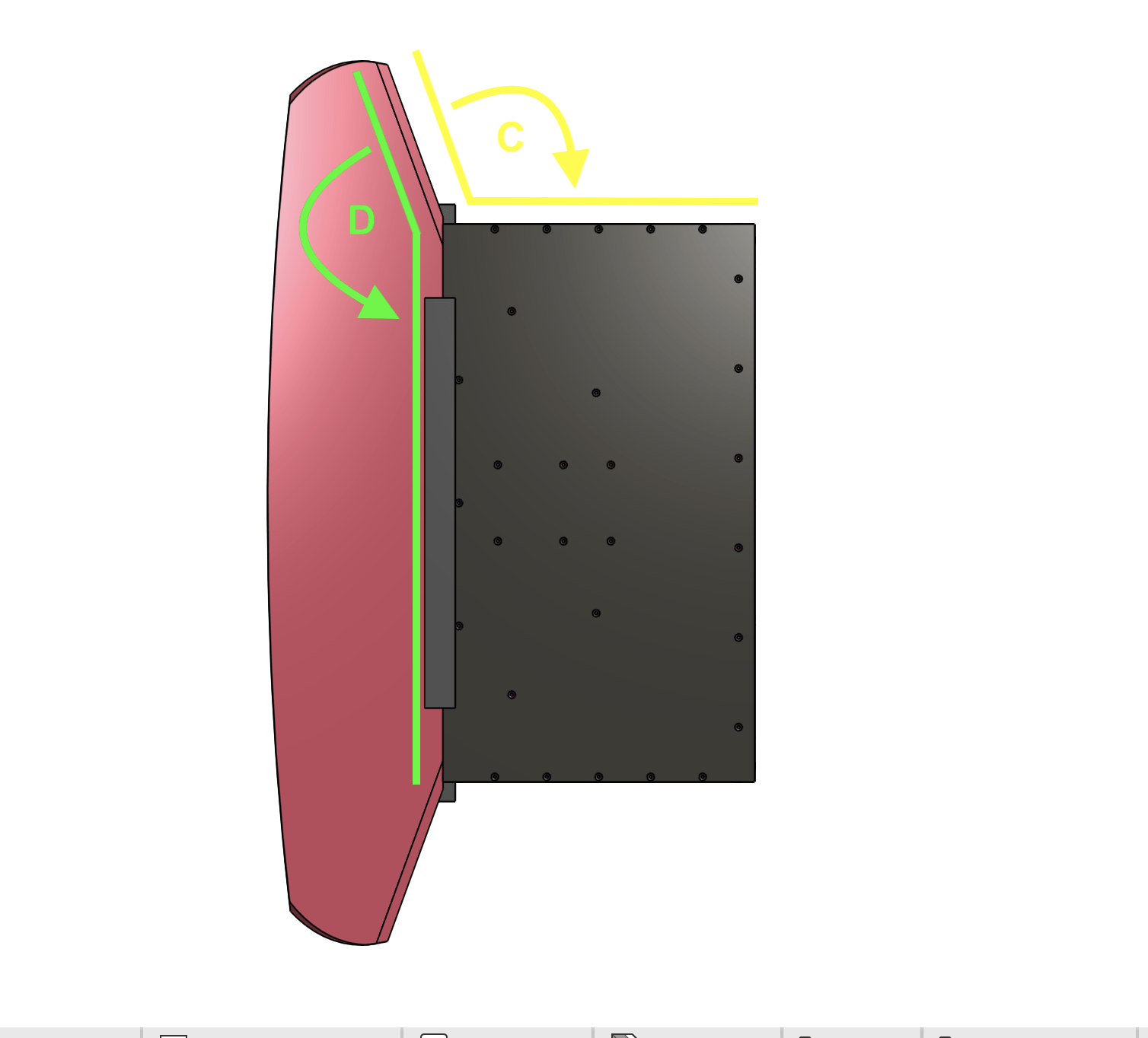

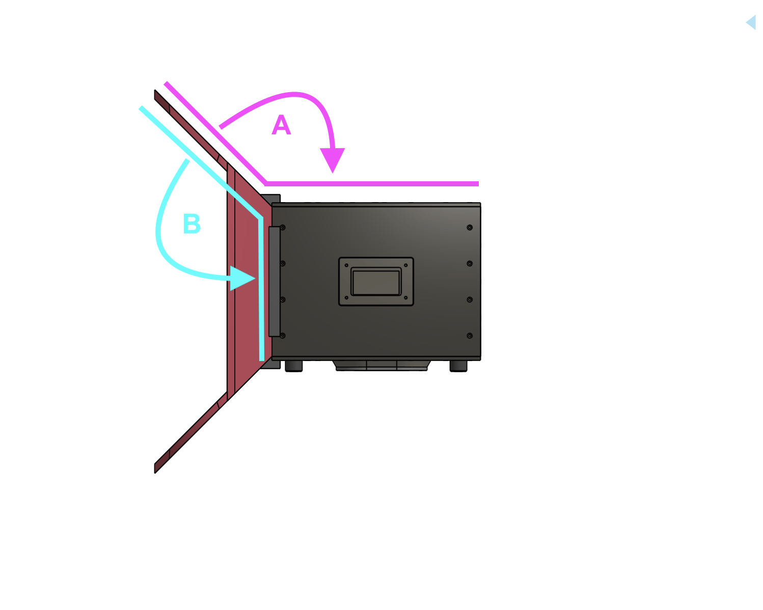

Hi, I've been trying to figure out where's the info on the sketches on post 41 but I don't see well... I'm unable to see what angles are A, B, C and D.
Can anyone chime in and confirm please?
