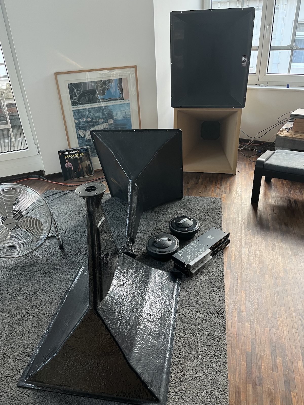

Thx a lot... will think about it. But i think before i start i need another HP6040 (or at least HP9040) in spare for testing ist 😉
I don't want to destroy my hp6040 without a proof of concept, because they are not easy to get in Europe.
HP9040 is not such a big problem.

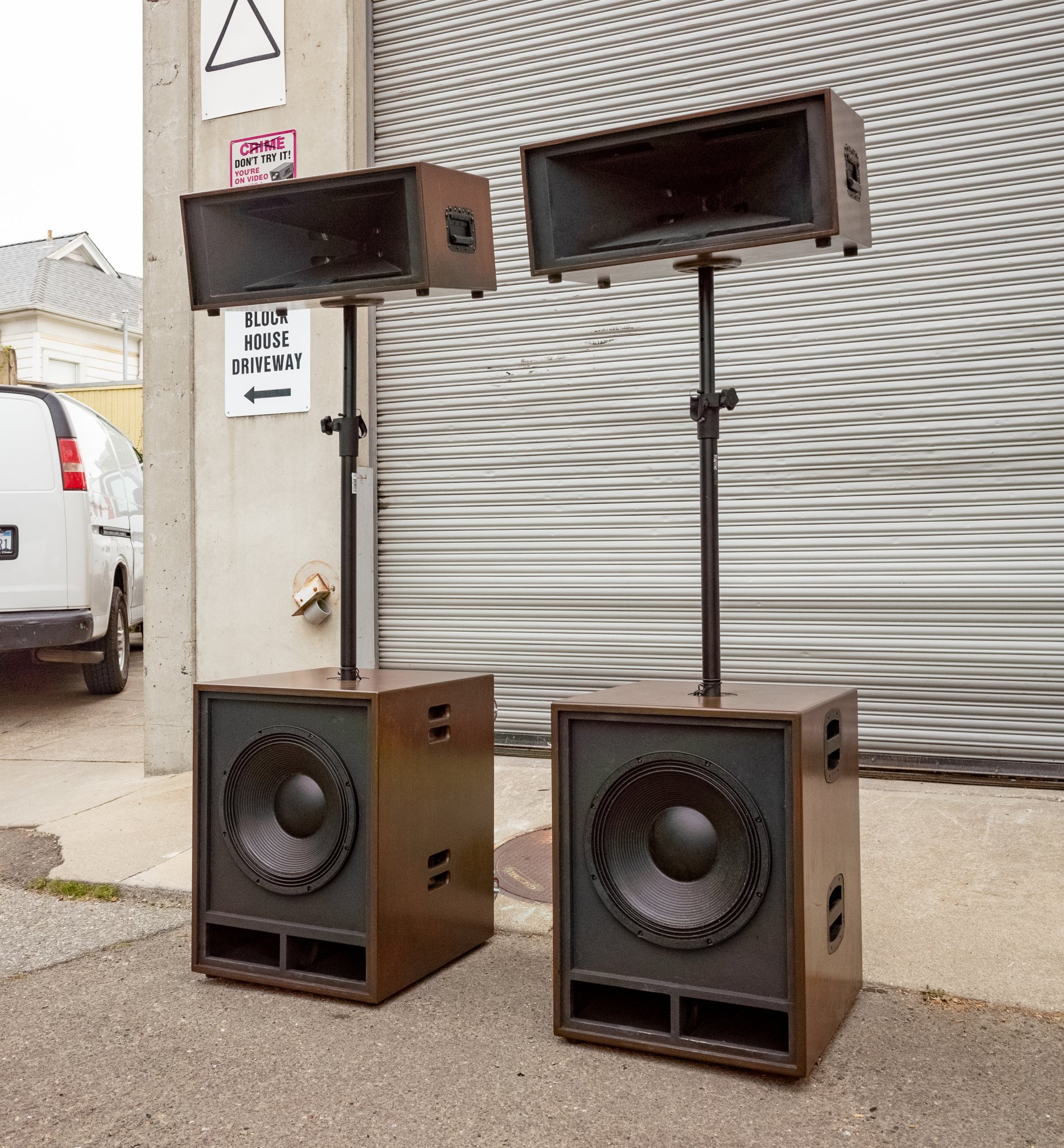

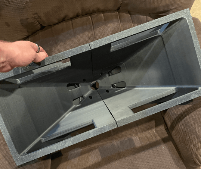

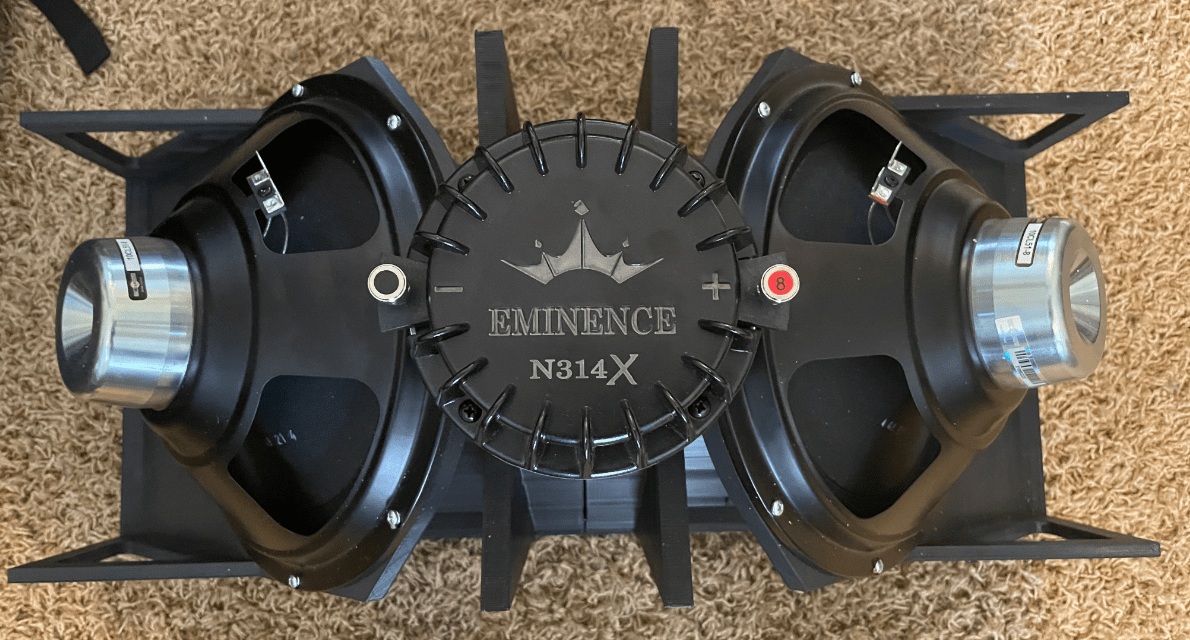

Gosh sorry I missed your questions! I assume you resolved it by now... We just wired the 10" in parallel and did a separate wire for the compression driver. We're amplifying wiht 500+500W Hypex amps per channel, incredibly low distortion compared to usual PA amp dross...Hey! Just got the drivers and tweeters assembled with Mr. Speakers' 3d-printed chassis. Curious about wiring and power for 2x 10CL51-8 and Eminence N314X-8. Not sure whether to run the tweeter and midrange separately or if we wire them together. Do we use a passive crossover built into the cabinet or do we run a rack pa crossover such as the Behringer Super-X Pro CX3400 V2.
We printed in Black ASA (we think, asked for white and our printer service messed up) and assembled using the best guesstimate of hardware from home depot. Very happy with how they came out so far!
Was hoping to catch Mr. Speakers at CanJam NYC to answer some questions about his SyntripP build, but heard he couldn't make it. (Hope you're well.)
Questions for Mr. Speakers NYC CanJam2023 1. Did you use an aftermarket crossover? What was the most optimal crossover frequency for your system? 2. Did you apply any paint to the 3D-printed horn for environmental protection? How is it holding up? 3. What subs pair best with the Syntripps from your experience? (Besides Keystones) 4. What did you use to fasten each horn half together, other than the 4 screws? 5. What did you do for sound treatment within the box? 7. If you had to rebuild the system from scratch, what would you have done differently? 8. If you could pair the Syntripp with any DIY sub, which would you build? (Keystone included) 9. Using the Syntripps as main mid-tops, what would you recommend for DJ monitors? Anything in the DIY space that resembles a smaller Syntripp?
We painted it to look nicer, and the tan color doesn't get trashed by playa dust at Burning Man.
For the subs we're using a 21" bandpass that's tuned to 20Hz. gsgad.com
We did glue the halves together as well. Lotsa screws and a little glue on the box seams.
Just lined with some fiberglass fill. Could use wool or poly too... I don't think it's too critical.

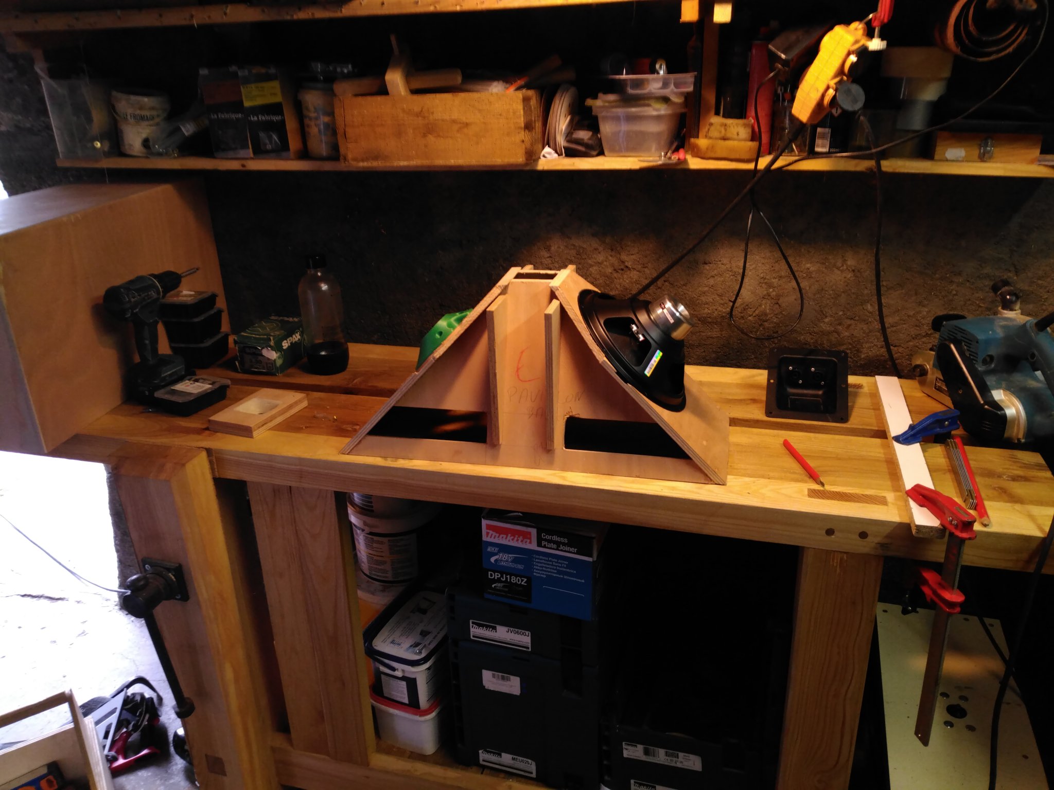

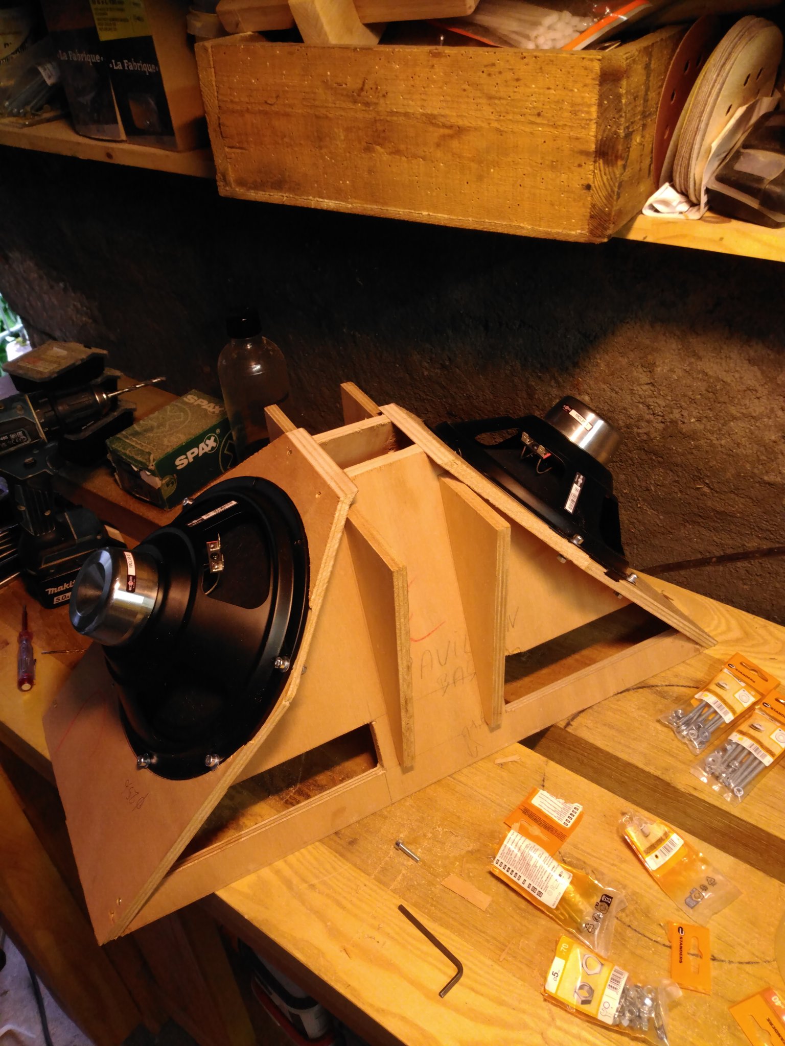

I'm still aspiring to build four for my class, first one is going well, with some issues:
I followed the pdfs I mentioned (like 6 months ago I guess?), and routed out the rings for the 10" speakers,. Turned out the ring was too small! For some reason I just remade the entire panels. I remade them when I received the speakers and took the measurements straight from them.
I saw a box and built a box, forgot to make the back panel detachable, now I've got to run a tracksaw all the way round the back and bolt it back haha.
The horn side and top panels are flush in the front with the cabinet but about 5mm out (sides to top and bottom) at the back where the horn plate adaptor goes, I'm going to sand that down like nobody's watching. (hopefully no one will be watching)
The flushness in the front is also and issue mind you because the grill will have to go somewhere. But that'll be for v2.
I haven't even considered the pole mounting attachment, yet another problem for future me!
I have no idea how to attach the 10" speakers to the panels, at least they fit! Screws wouldn't work, and nuts and bolts would show on the inside of the horn. I should really read up on the build process art wrote.
I'm humbled by this project! Very happy to have bitten off more than I can chew.
I can't wait to hear them 🙂
Build pics are on their way!

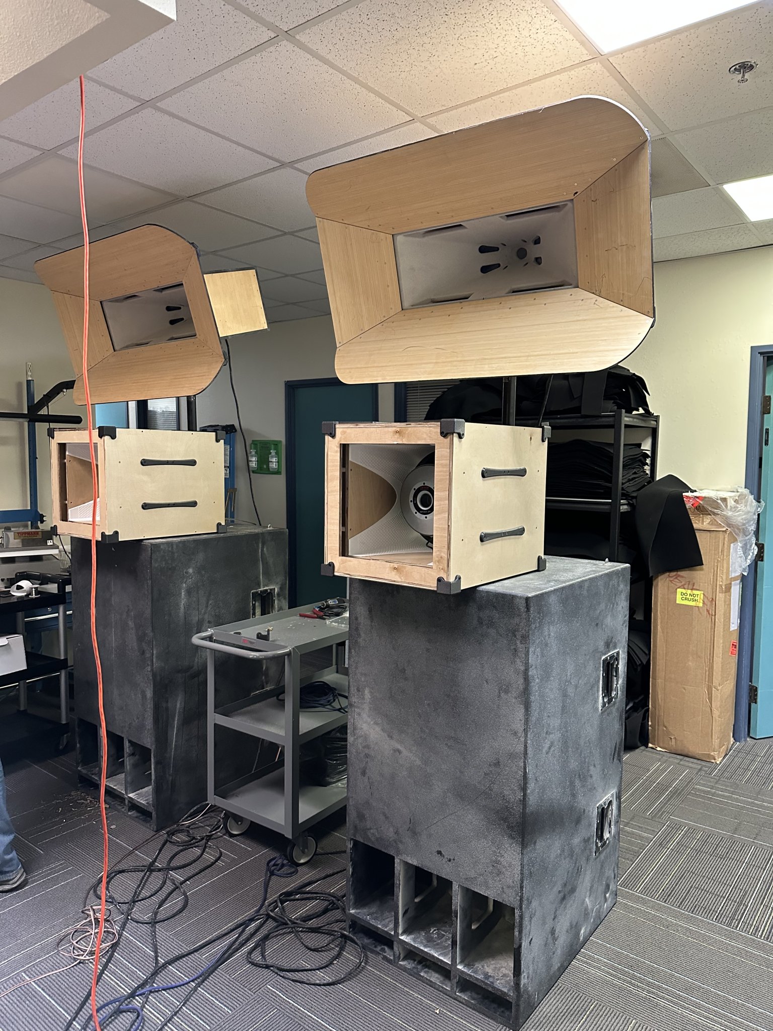

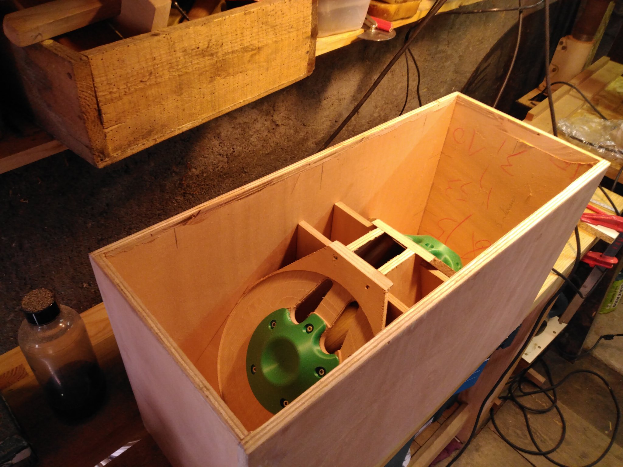

Back in the garage for summer break! The horn assembly isn't glued up yet. in the 2nd photo you can see that I had to cut the back out of the enclosure haha. Got the wood to make the brackets to bolt it back on. Bolted the speakers on, only two nuts showing in the horn in the end. Two of the bolts came too close to where the top and bottom panels of the horn were set, so I left them out. I screwed the cone fillers in but I feel like glueing them?
I've got to mark out and drill the attachment holes for the HF driver on the throat adapter then countersink the bolts as the threaded inserts that came with it aren't long enough.
Once I'm happy with the dry assembly I'll glue it all up, prbably still have to work on the transition on the throat adapter since I built it before having the driver to reference. My teacher recommends acrylic "silicon", the stuff we use to seal door frames and windows that can be painted over. Then it's another round of wood filler and sanding before painting.
