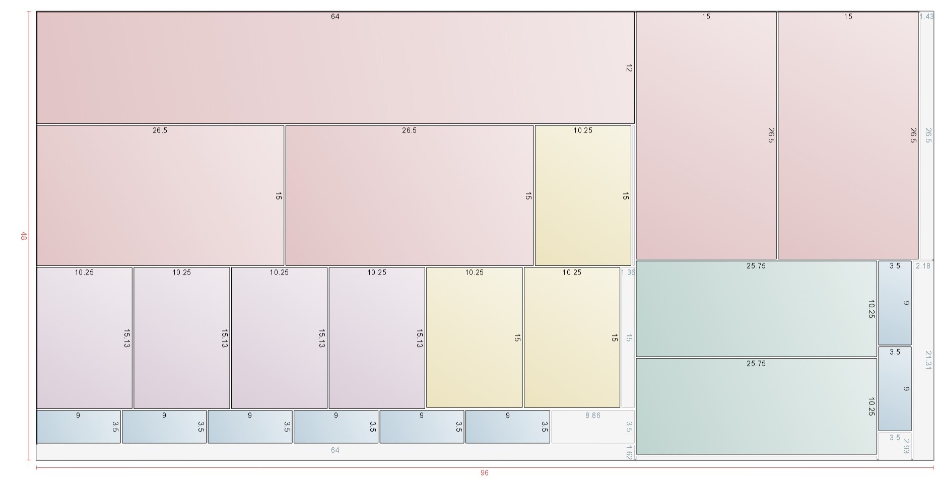

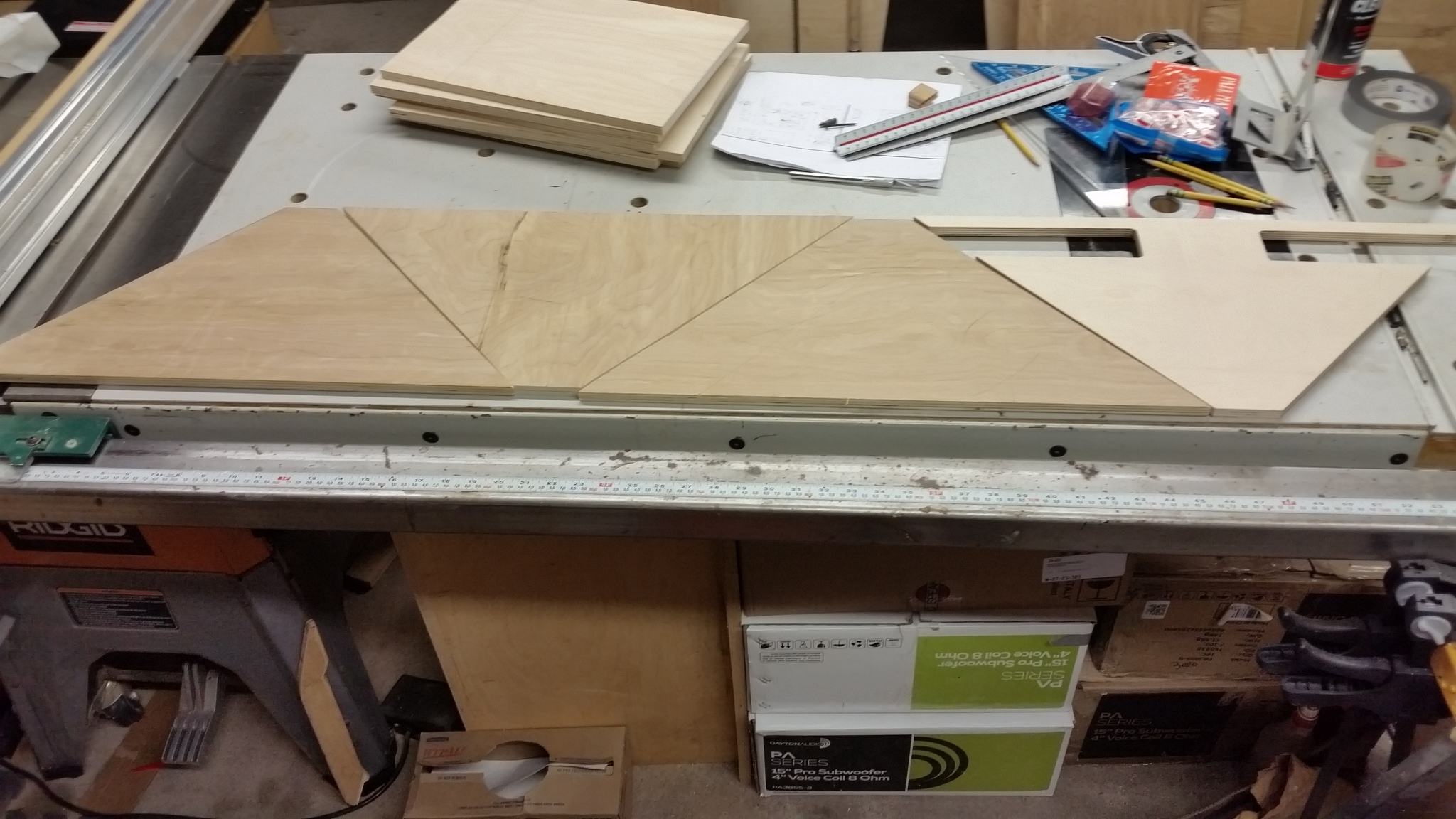

What I used for a preliminary cut-list, and how I wasted less wood fashioning Part 'D' ..(that's what the 12 x 64" cut is for...)
I've no idea if this'll help someone, but if it does, then good...

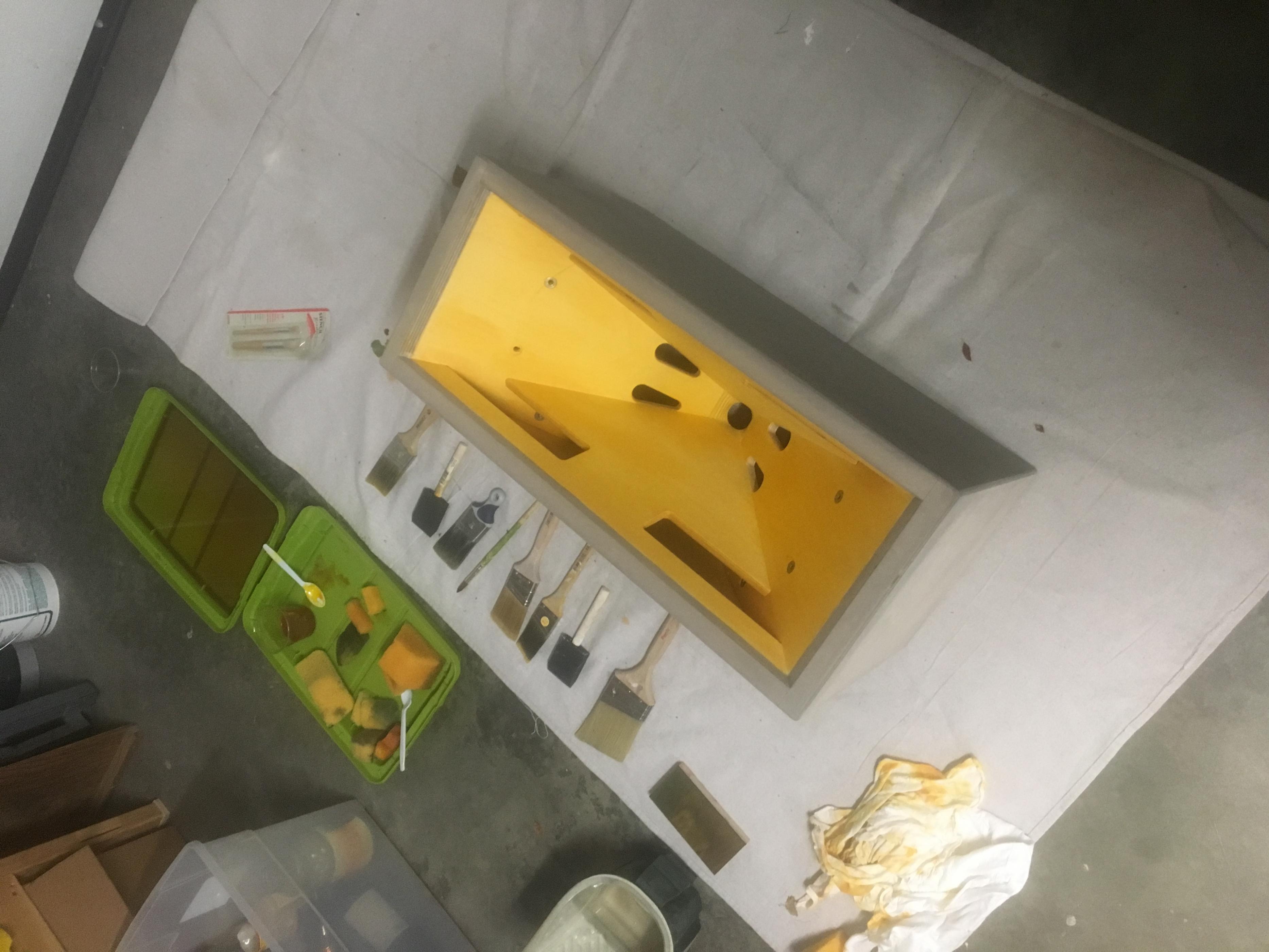

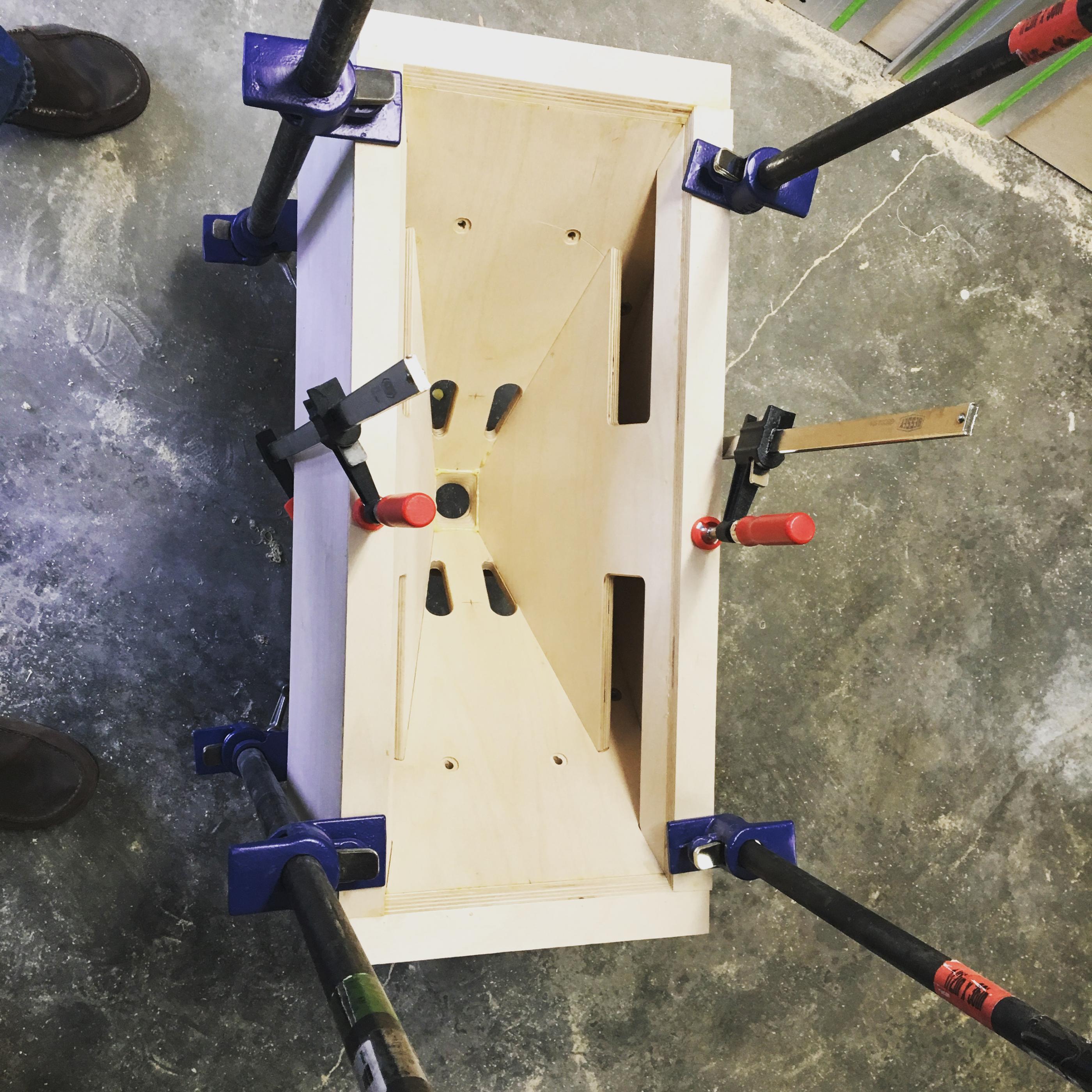

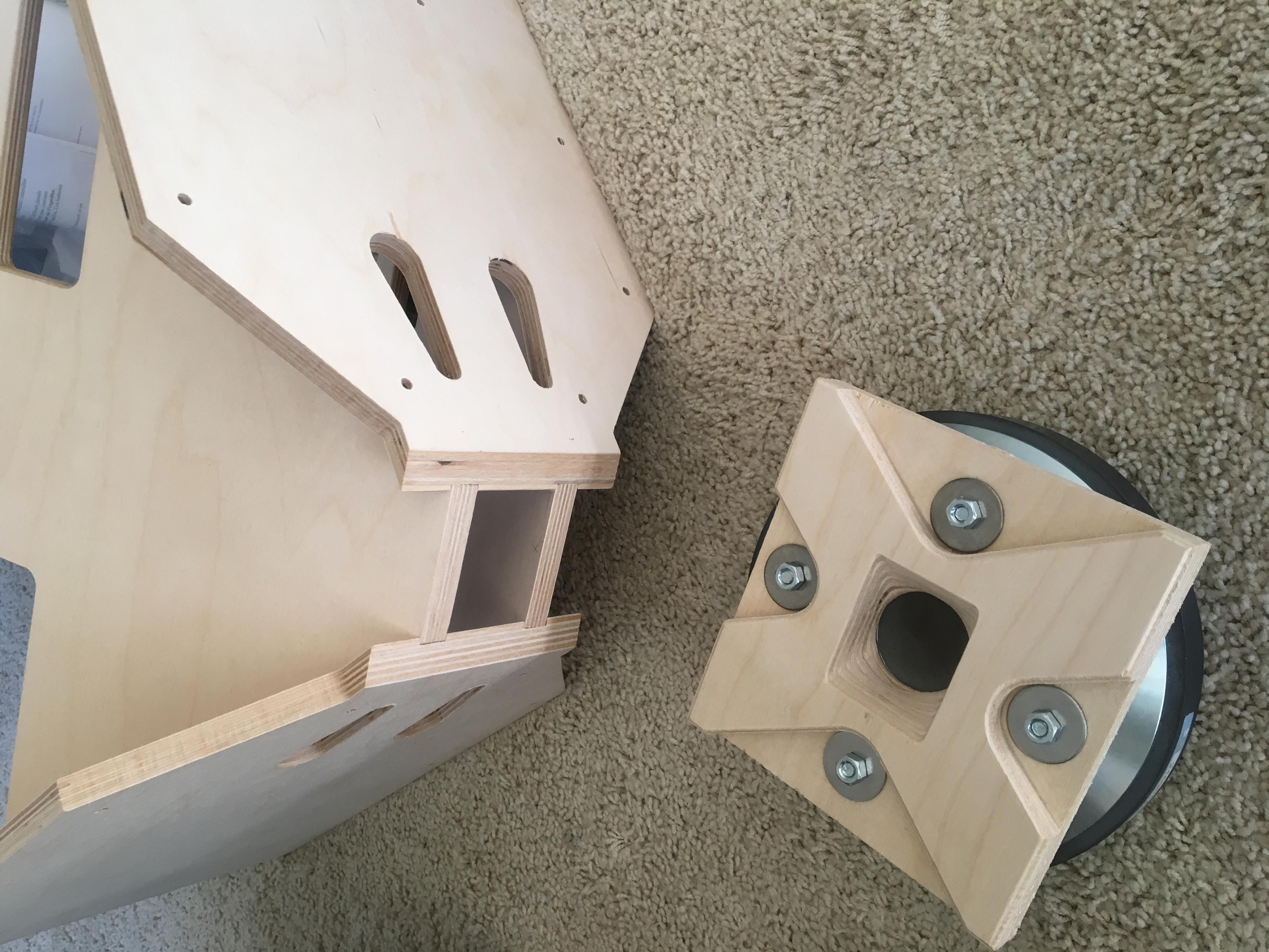

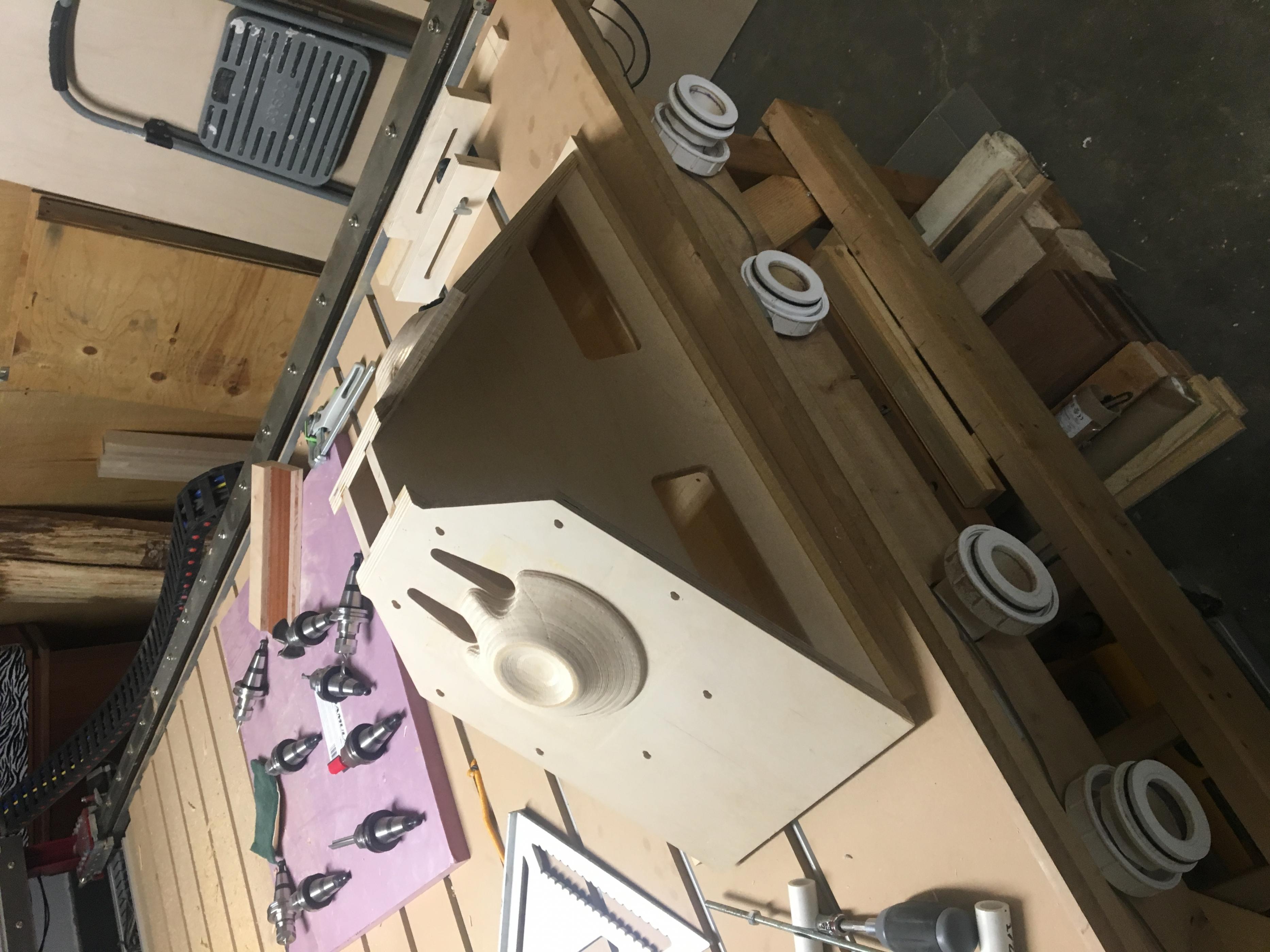

We wanted to post a few pictures of our SyntripPs and give a huge thank you to Art for putting these designs out there! Additionally, we have a few resources that might be a useful contribution to the community here, like a pretty professionally made SketchUp Model of the SyntripPs that should work well for anyone wanting to build their own set on a CNC router. This includes a model of the volume plug for the B&C 10CL51 woofer, and a model of the horn throats, which we also cut on a CNC. Before we post any plans i'd like to get one of the pros on here to sign off on them and make sure we have our dimension right (we may have taken a dimensional liberty or two). We are also using the B&C DE90TN 8ohm that Art sold us. I'll try to get some measurements out for the community here soon.
And thank you to everyone who has helped out on this thread, our non profit radio station KONR 106.1 Out North Radio and the dance music scene here in Alaska is eternally grateful!
Cameron and Kris,
Build photos.
Build photos from Cameron and Kris's build.
We finished them out with an orange and gray stain, with an Osmo hard wax oil finish.
