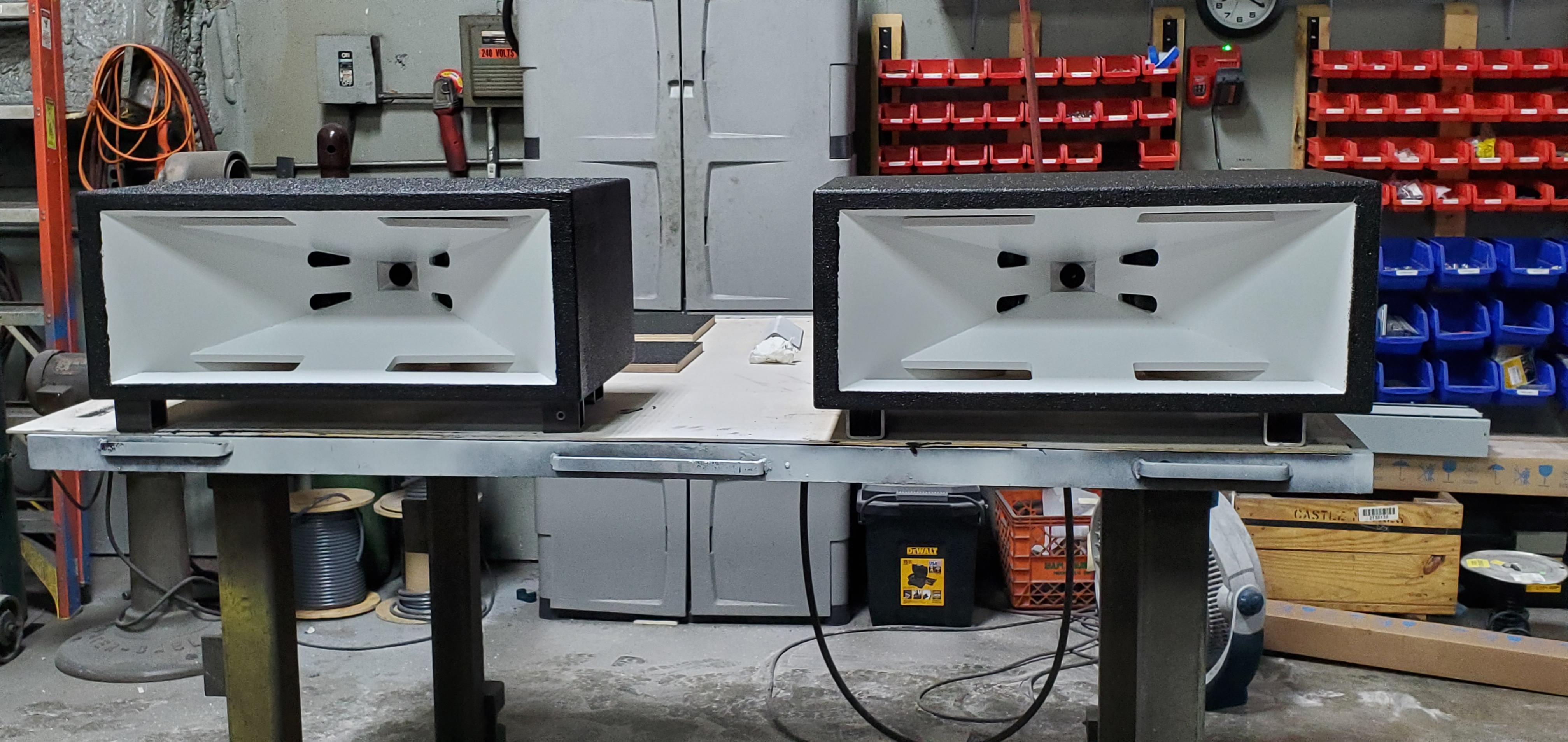

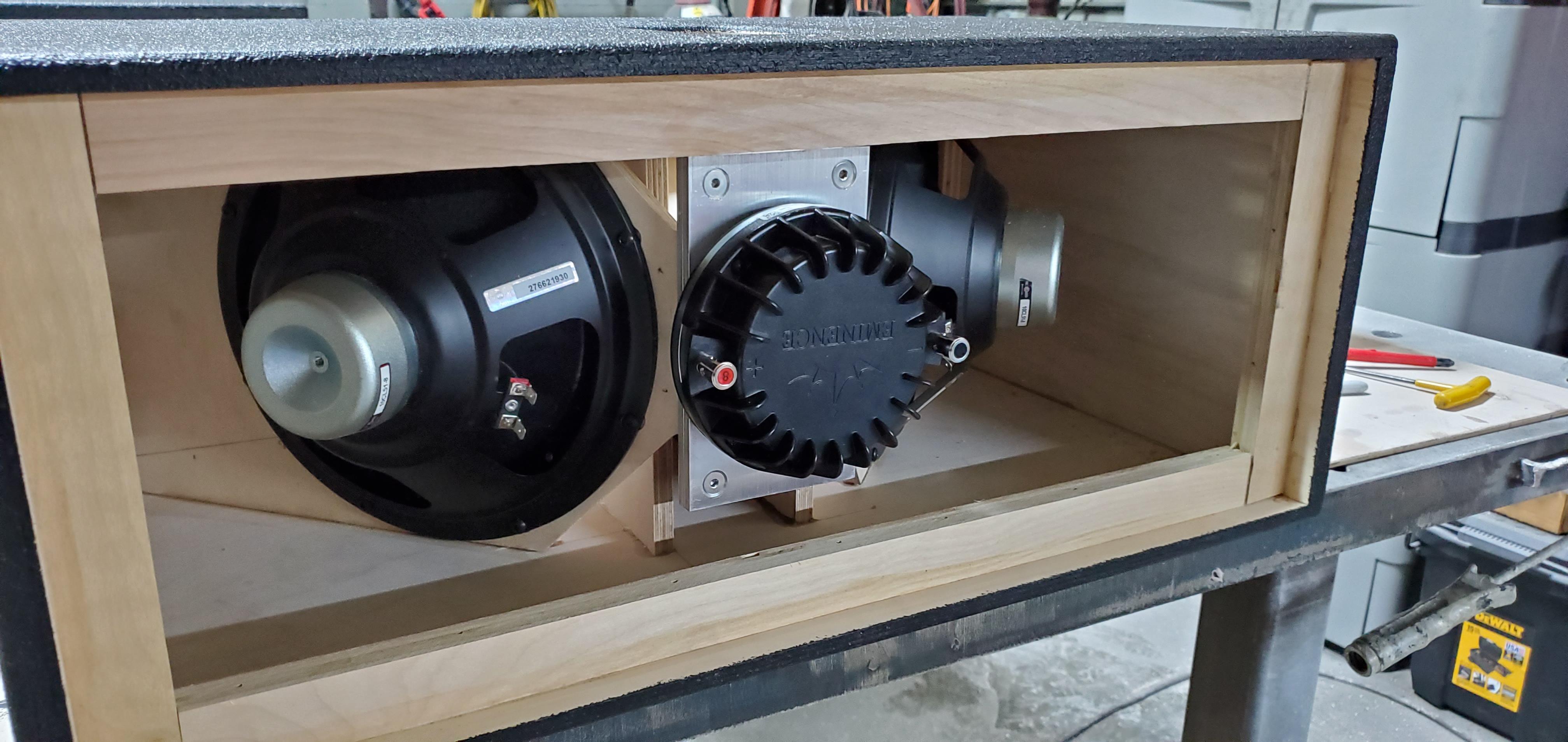

I want to extend my gratitude to Art and the community here. At long last I finally got my SynTripP's together (only took 6 months). It's been quite an adventure and I learned so much along the way. When I first discovered the SynTripP I was convinced I'd never have the skills to build it but here we are.
I only have a few hours of play time but I am already in love with the sound of these. I was initially nervous as I had never heard a multiple entry horn before and I didn't know what to expect. They surpassed all of my expectations and were worth every bit of work that went into them. I can't wait to pair these with my 4 keystones and let them sing.

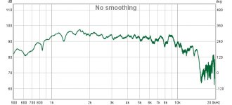

Here is a link to the initial response curve with very limited eq and drivers not yet broke in. I plan to get some hours on them before I spend too much time tinkering with any more eq. If you have any resources on taking measurements I'd love to hear about them. I'm still very new to that world.
I ended up using the N314T-8. I was going to use the N314X but decided against it strictly due to the cost. Maybe some day I'll give them a try. I do plan on building the secondary horns as well but I think I'll wait until it gets warm out for that.
Hey Art! I ended up taking a bit of material out from behind the compression driver which allowed me to add a bit more insulation to the back panel. I also added more insulation to the sides as well as broke in the mid drivers. Since making these changes the resonances I was hearing earlier on certain songs has completely dissapeared! I think it was likely that i just had insufficient insulation to tame the resonance coming off the mid drivers.

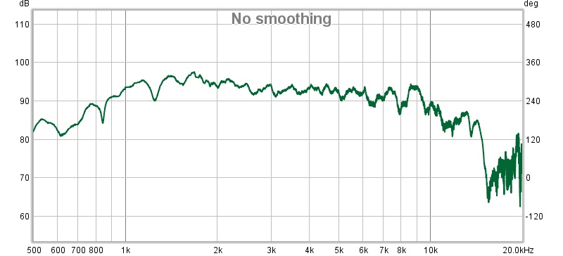

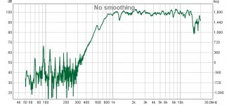

Also, the weather finally cooperated and I managed to get the Syntripp outside to a clearing to take a measurement of the n314x for you. Here is the frequency response taken 2m away with the syntripp 5 feet off the ground. My generator was only about 30 feet away and there is a river nearby so conditions were not ideal but I reckon its better than nothing. No eq applied. No smoothing. No secondary horn.
I was sending the test tone directly from my sound card to the amp bypassing the crossover in the Driverack so I started the sweep at 500hz to be safe. I am new to testing and measuring speakers and I'm always worried I'm going to break a driver...... :S I have a Hypex NC252 amp coming this week to power the compression drivers so weather permitting I'd like to get the speakers out for more testing this weekend. Ill take a low powered measurement down to 60hz then! Cheers.

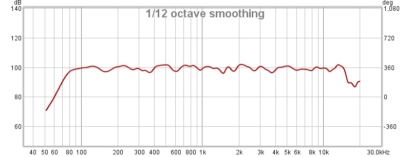

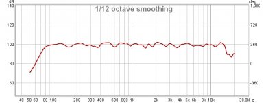

I haven't taken the time to do proper polar responses with a protractor to gauge the angles however I have been finding it much easier to dial in the EQ by taking measurements a bit off axis. Maybe 15 degrees off axis by my guess. Whenever I eq'd the speakers completely flat on axis i found them to sound a bit off when I set them both up to listen. Ive also found that they sound best having them both face straight forward or with very minimal toe-in especially with the secondary horns attached. I'm not sure if this is normal behavior for these speakers or just a result of how I built them or the drivers I used? At any rate I am extremely impressed with how they sound with very minimal EQ. It has definitely been a learning experience as this is the first time I have built/eq'd speakers. I often found the more i tried to eq the small dips and peaks in response the worse the final sound was.
As of now I've settled with +6db @ 130 hz, -7db @500hz for the mids. -2db @ 2.2khz and +5db High shelf @ 10khz on the Highs. Crossover 800hz 24/BW on the mids. 875hz 24/BW on the Highs. I tried the LR/24 at various crossover points for the highs but always ended up with a dip in the crossover region. Highs are delayed .52ms. Getting the delay right made a HUGE difference. I was originally using .4ms delay since that is what other people seemed to be using but the other day I played around with higher and lower delays and when I hit .52ms its like the speakers just snapped together. Female vocals were sounding a little bit hollow before the delay was dialed in but afterwards they sound absolutely fantastic. Here is the frequency response with the above EQ applied with secondary horn attached.
On another note I recently tested out the Hypex NC252 module on the compression drivers and am extremely impressed with the clarity, detail and low noise floor it provides. I also tested it on the mid drivers and it sounded fantastic on them as well so i was thinking of getting two more of the bigger NC502 modules to power the mid drivers. All three modules could then be installed into a single amp case to simplify my amp setup. According to their spec sheet the NC502 modules are rated for 350w x 2 into 8 ohms however they can also be bridged to provide 1200w x 1 into 8ohms in BTL. Could i then expect to get approx 800w into the mid drivers if i ran the mid drivers in series? I figure if the mid drivers average impedance is 6 ohms(3ohms in parallel) when run in the SyntripPs they would be about 12ohms in series? The Hypex modules probably wouldn't like being bridged into a 3ohm load as each side of the amp would only see 1.5ohms. The other option would be to run each mid driver separately however that would require me to get new speakon4 cables and connectors. Please let me know if my calculations are incorrect or if there is any other reason this shouldn't work. Cheers.
