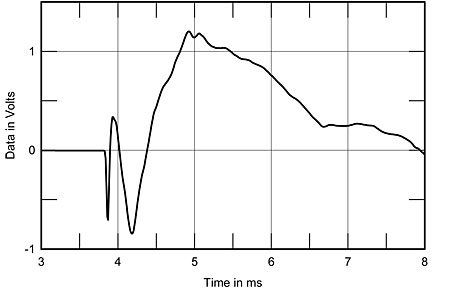

For instance, take a look at this Dunlavy speaker. Dunlavy used first order slopes on every driver in his speaker. That's the reason that the woofers, midranges and tweeters are arranged in an arc. By using the same filter slop on every woofer, the 'arc' shape keeps everything in phase.
The important thing to note, when it comes to Dunlavy, is that every driver is equidistant to the listener, and all of the filters slopes are the same. Electrically and geometrically, the delay is identical from top to bottom.
Here's the step response of a Dunlavy SC-VI? See how perfect it is? Now hold that thought...
Here's a pic of a Focal Utopia III, and it's step response. See how the step response is a mess?
The step response of the Focal is a mess because of it's high order filters. A second order low pass delays the signal by 180 degrees at the xover frequency, a third order delays things by 270 degrees, etc...
Here's a LeCleach horn. See how the midbass is *significantly * closer than the tweeter?
The trick - as described in the LeCleach paper - is that you can use the delay introduced by the lowpass filter on the midbass to compensate for the fact that the midbass is much closer to the listener than the tweeter. The filter on the midbass introduces a delay; so moving it *closer* to the listener compensates for that delay.
It's a way to achieve excellent phase response even though the drivers aren't equidistant.
Of course, you could also do this via DSP if you want, but it's kinda elegant to do it passively!
I hope that makes sense. I know it made my head hurt the first time I read the LeCleach paper.
