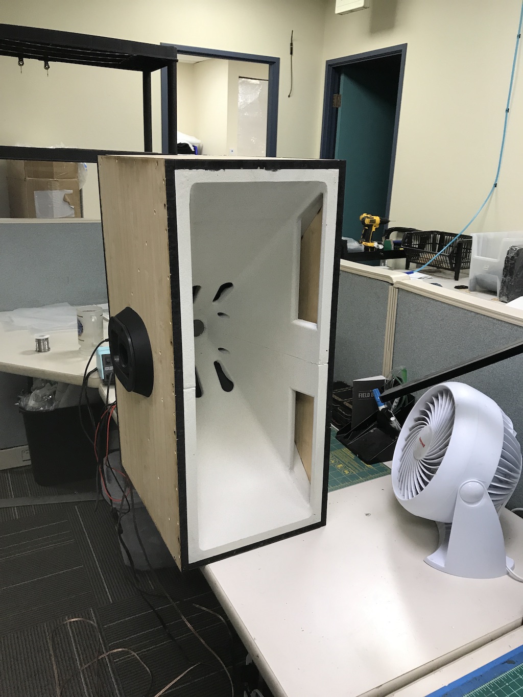

Sure, every material has different pros/cons for rigidity, internal damping, durability.
We are using a carbon loaded PLA for the horn, it's super light and very rigid. Right now in a sub-optimal MDF cabinet the printed parts are no noisier than the enclosure. The whole assembly has a primary resonance, which you expect, it's pretty high up there indicating decent rigidity, but it's not as damped as we'd like.
We don't have good distortion measurements as we've so far measured in our office (we're in an industrial park so getting real outdoor measurements requires a late-night weekend venture and we'll do that when we have the final bamboo box. Frequency response doesn't show any serious anomolies beyond results others have shown, and that was done in a small office with a mountain of reflections. And yeah, it sounds great!
When we switch to the bamboo shell we are going to treat a few of the larger, flatter surfaces on the box and the printed horn with acoustamat to deaden the enclosure.

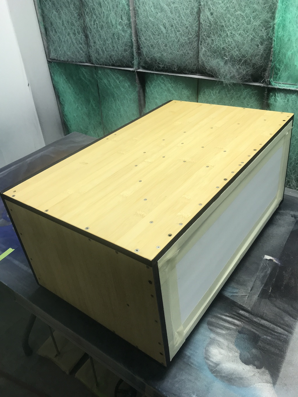

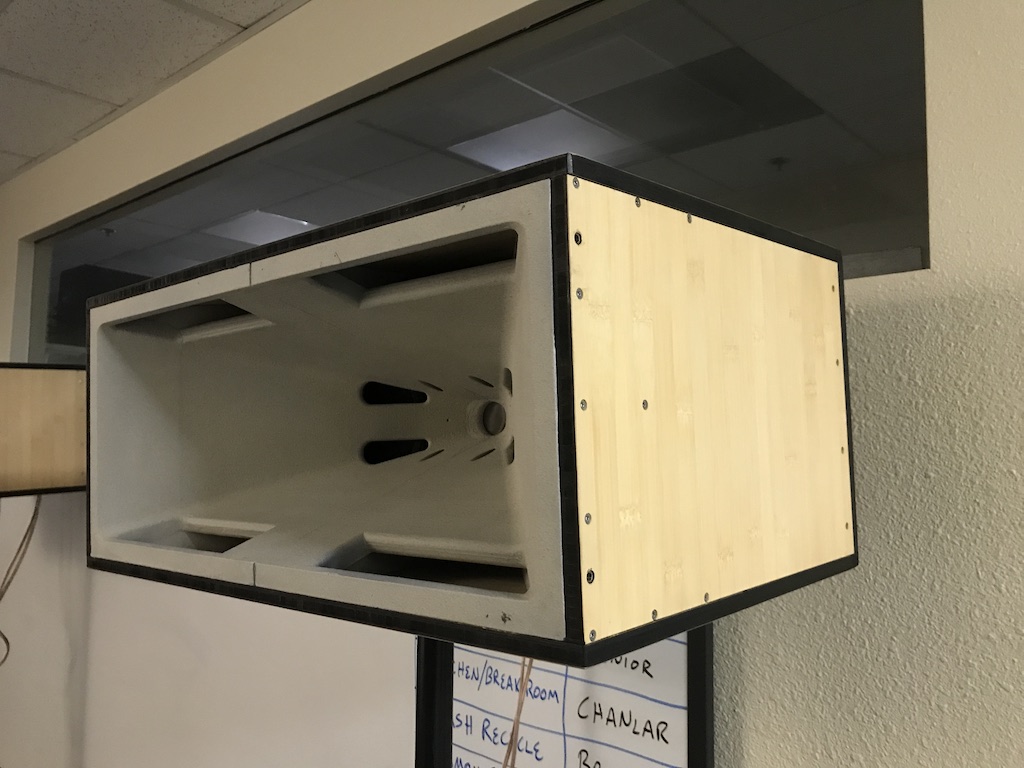

We're just about done, and sure, when we're finished we'll be happy to share STL files for print, cut sheets, and laser patterns. The project got slowed down due to a combination of parent-care and worked getting BUSY, but that's life for ya.
We designed the box to screw together so assembly is super fast, and the rear panel is easily removed to service drivers, etc.
Printing the parts takes a while, and a good large format printer. We ended up using a carbon fiber filament that was dimensionally stable when cooling to keep the part on the platform, it's not a print job for newbies.
Cutting the wood with the laser was done on a 100W CO2 with a 5" lens, anything shorter was char-o-rama. We're debating whether to sand and seal the exterior to let the wood show, or just basic sound-system-black.

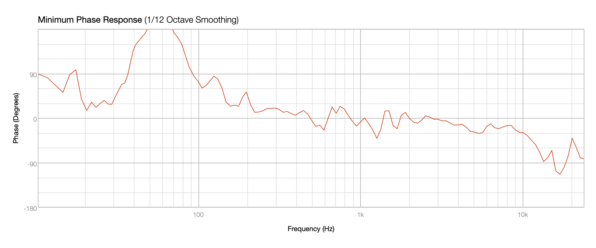

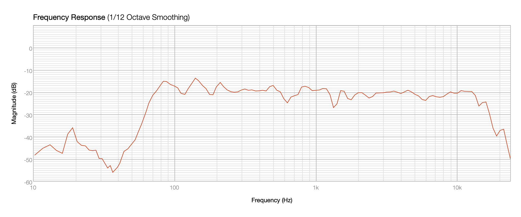

We're super happy with how these came out. The sound is very clean and coherent, the phase results show that really clearly, they're totally linear through the low mids through the middle of the highs.
EQ was not terribly complex, we're currently using a MiniDSP and it took a few hours to work it and feel it was pretty well optimized. We used a simple combination of shelves and one or two EQ points on the mids and highs and came up with the results shown below.
For curiosity we'll be testing the DIRAC impulse response optimization soon.
We loved the way the bamboo came out, and the black cuts from the laser gave it a slick looking trim, so we left the screws exposed, and ran with an oil-based wood clear coat. Bamboo is super hard, we'll see how that works out over time.
