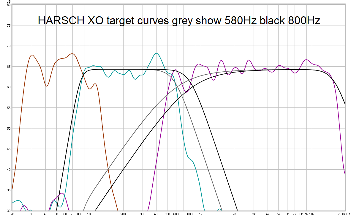

Nice work JG. That Faital Pro CD digs deep! You are almost in FAST territory so it's great for coherency.
Check to see if you can run the CD with a 2nd order high pass - the set delays to get a Harsch XO. If you do it right, the percussion will really snap. Subtle but unmistakable when done right.

XRK,Check to see if you can run the CD with a 2nd order high pass - the set delays to get a Harsch XO. If you do it right, the percussion will really snap.
A second order HP on the compression driver is possible, but will increase it's distortion and reduce output level before the diaphragm hammers on the phase plug. The 10" drivers are better suited to cover the 900 Hz region.
A 24 dB crossover (at a higher frequency than what Jenny has run her low level tests at) is preferable, and when the phase is properly aligned will sound just as "snappy" as the Harsch alignment without requiring additional delay.

.....xrk- I am eager to understand the harsch XO and get things "slapping". Sounds like an effect that is worth the time invested. Right now I have the crossover between 10/CD as follows, with a 50 microsecond delay on the CD:
Don't know compression driver data and if it is capable but here overlay example with target slopes Bessel 2nd order at 580 or 800Hz. Surprised there is so many 8th order slopes the two below 100Hz ad quite some lag down there, wasn't weltersys running 4th order slopes.

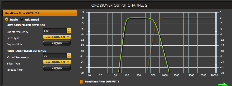

Brytt,Don't know compression driver data and if it is capable but here overlay example with target slopes Bessel 2nd order at 580 or 800Hz. Surprised there is so many 8th order slopes the two below 100Hz ad quite some lag down there, wasn't weltersys running 4th order slopes.
Yes, the slopes used for the SynTripP are 4th order, described in post #9 and 13. I have since changed to a BSS Blu 100 crossover which allows for more filters, but the crossover parameters are still pretty close to the originals as described.
