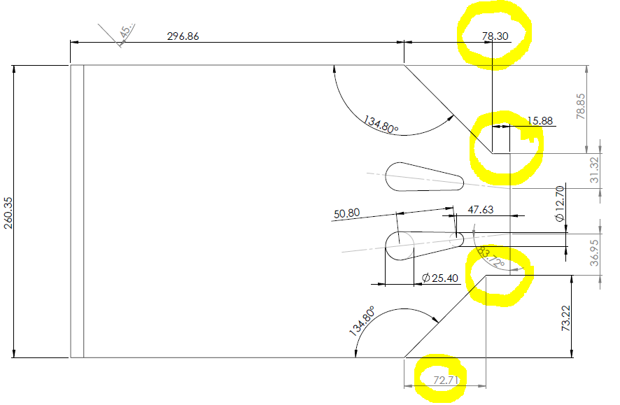

When looking at the pdf posted, is there a reason the drawing isn't symmetrical?
Yes sorry! I fixed that in a later version.
Will send it through.
I have also been working on a rounded angle and length version. (to a degree and mm)
I do want to redo the model to use precise 45 degree and 20 degrees on the horn. I expect the change will be less than 1 percent different to the spec, but much easier to construct.
It makes it easier to think about when setting machines up, and easier to find bits if it were to be CNC routed (bar the compound angles on the sides)
The Sketchup and Solidworks plans are available too if anyone want to review and tweak them.
Not submitted to Art yet as they are a bit ugly still, and I didnt want crappy versions out in the world.
