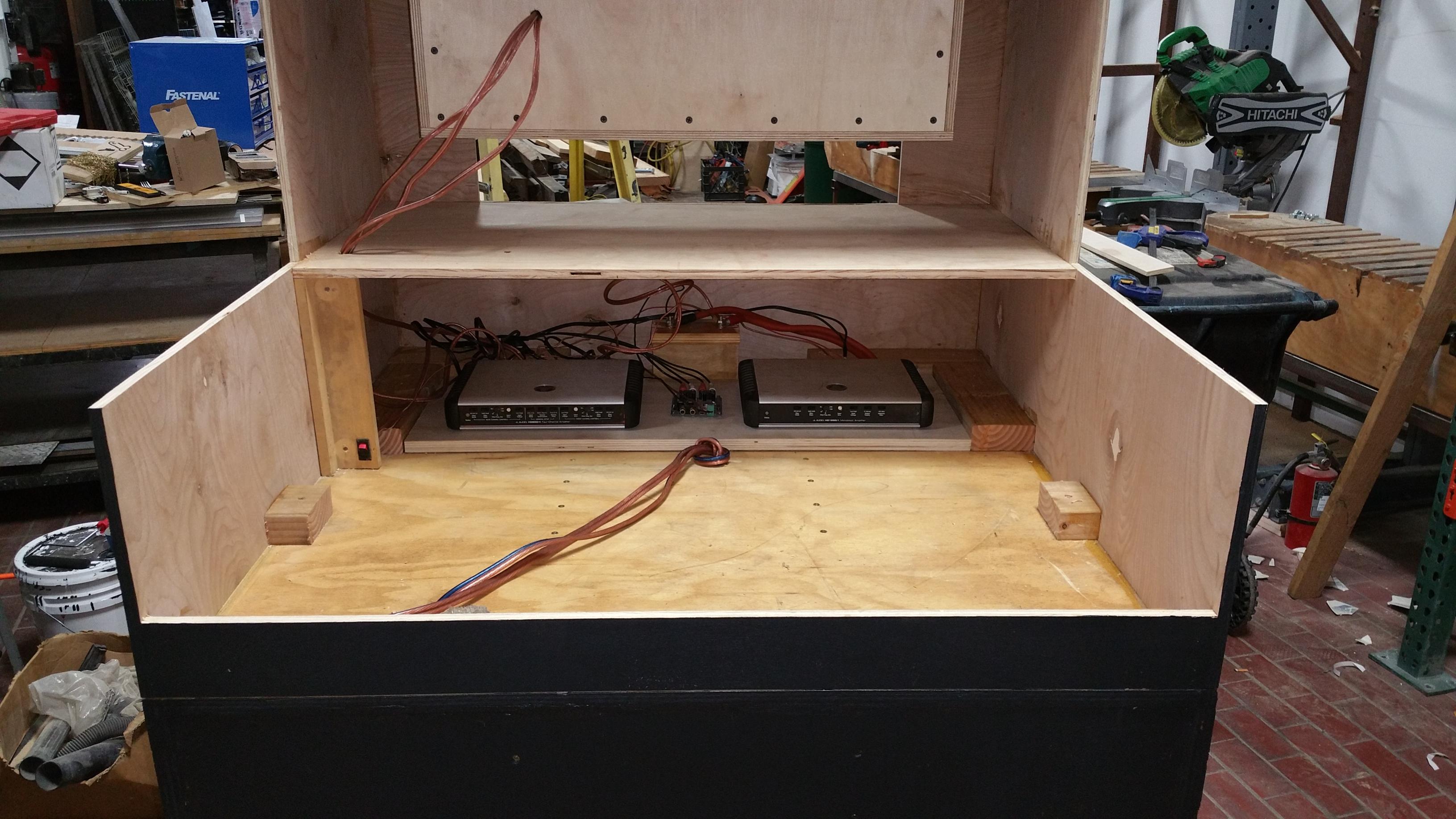

I forget what gauge it is, 2 maybe?
the wiring wasn't done when i took that photo, but yes there is more of that orange stuff going down to the battery.

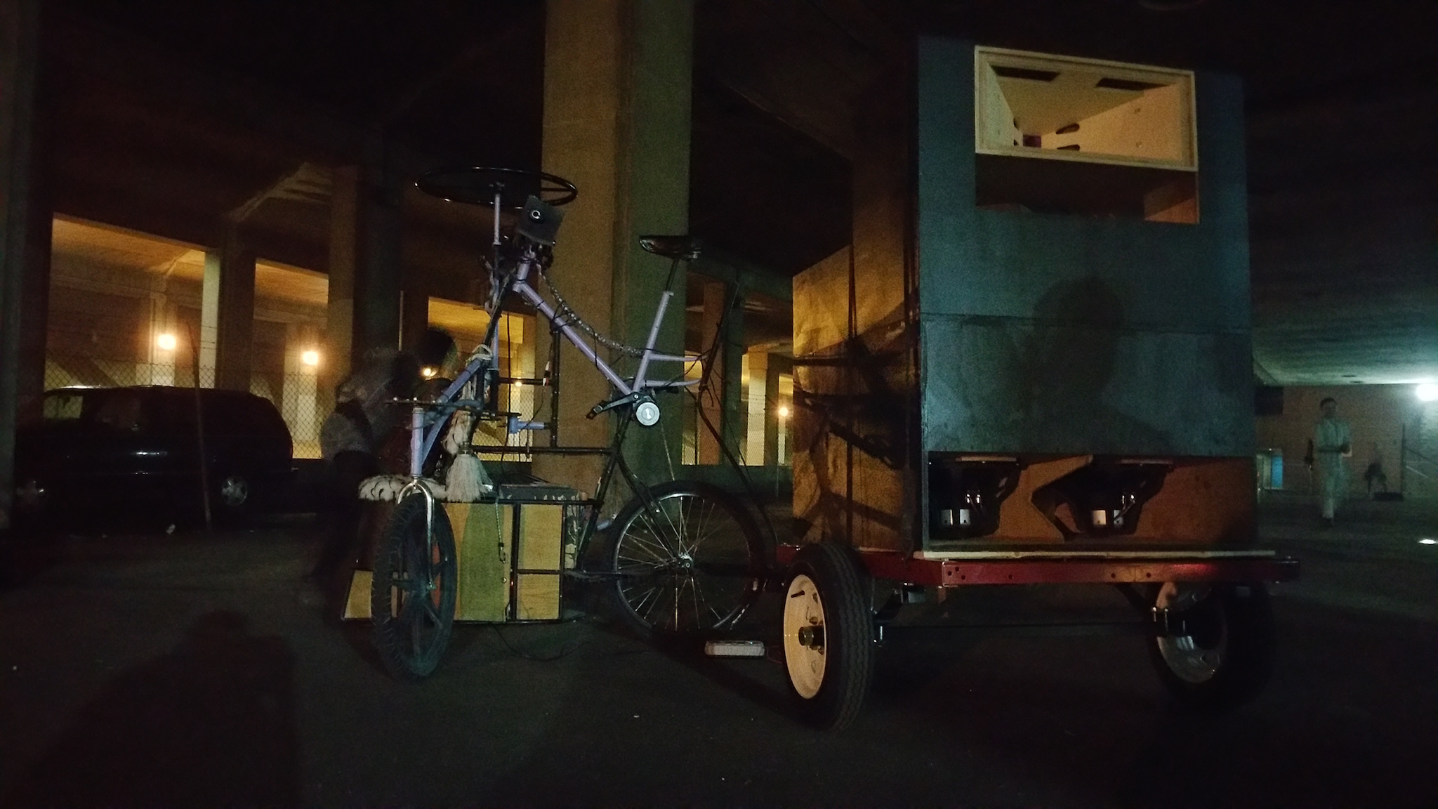

There is a generator in the lower compartment of the bike that charges both the bike which has electric assist (36v) and trailer (12v) with separate chargers. The bike also has its own sound system, with two FE126EN's in low tuned vented boxes powered by a tripath amp. They sound great on their own, but will be excellent as DJ monitors
The bike was originally designed as a desert-crawler, but it has turned out to be road-worthy as well.
