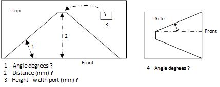

I want to try these cab, but can not find right angles and distance in attached drawing. Is there anyone who can help me?
I want to try these cab, but can not find right angles and distance in attached drawing. Is there anyone who can help me?]
Nor,
If you want to try to convert the SynTripP to the Bwaslo spreadsheet angles, you are on your own.
Post #61 has the completed "as built" parts lists including angles and assembly instructions. Refer to the OP for post numbers for other information regarding build details and response measurements.

Hi All.
Art is reviewing the current drawings, after which I will update them, and pass them back.
They need some better annotations.
That said JennyGirl and I have built the syntripps using the 3D models with success.
Jenny's 3D printed volume plugs are highly recommended.
Fin,
I have not received any current drawings, and when/if they arrive, it will be a while before I have a chance to review them, as several other new projects are presently occupying my time, as well as dealing with a landlord who has wasted over 70 hours of my time since end of June.
