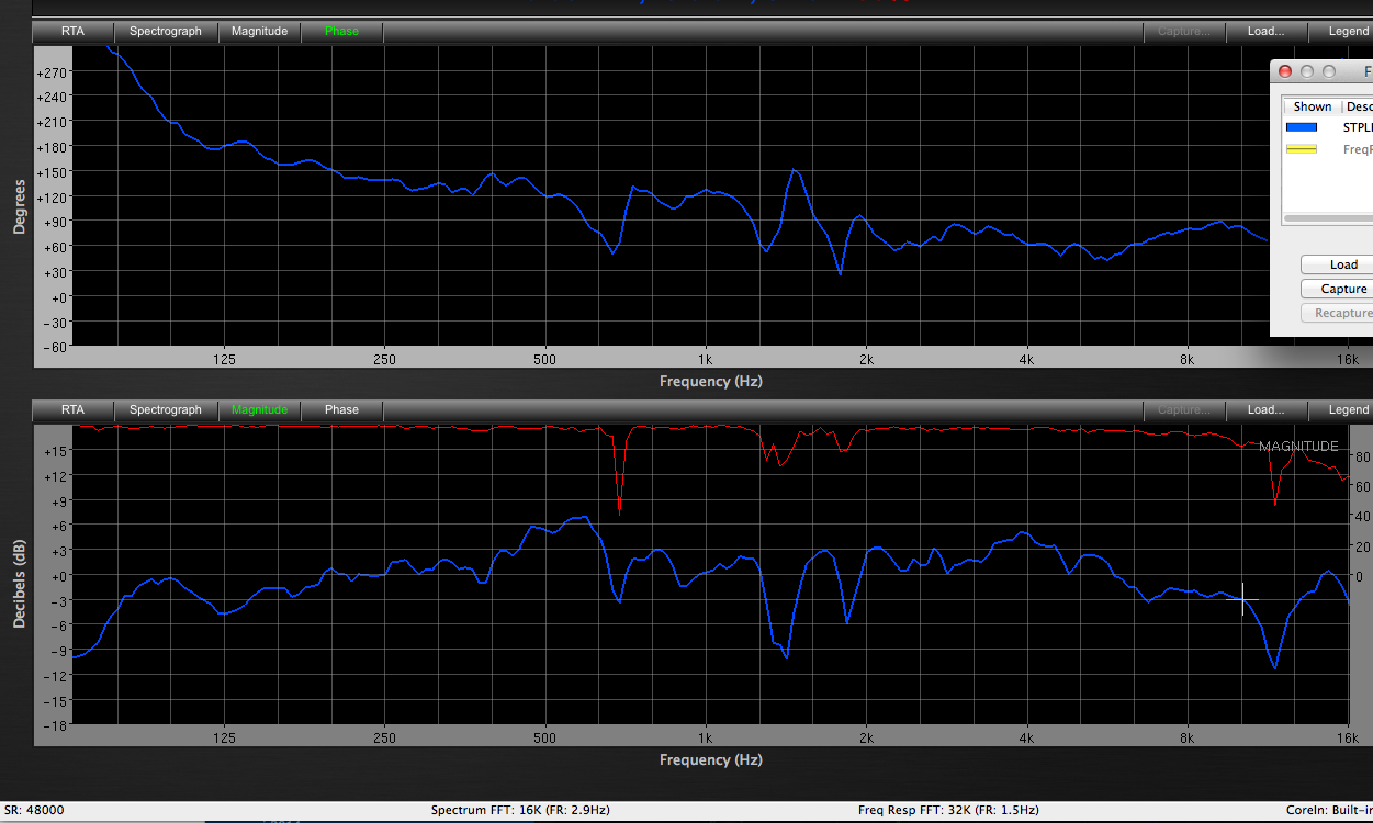

It is always of interest to read what impressions are taken and given, and what the actual proven facts are 😉 .
You probably missed the screenshot of the SynTripP combined response, no filters whatsoever, the 10" drivers placed as close as possible to the HF compression driver, with near flat phase over the entire pass-band, so I'll post it again:
