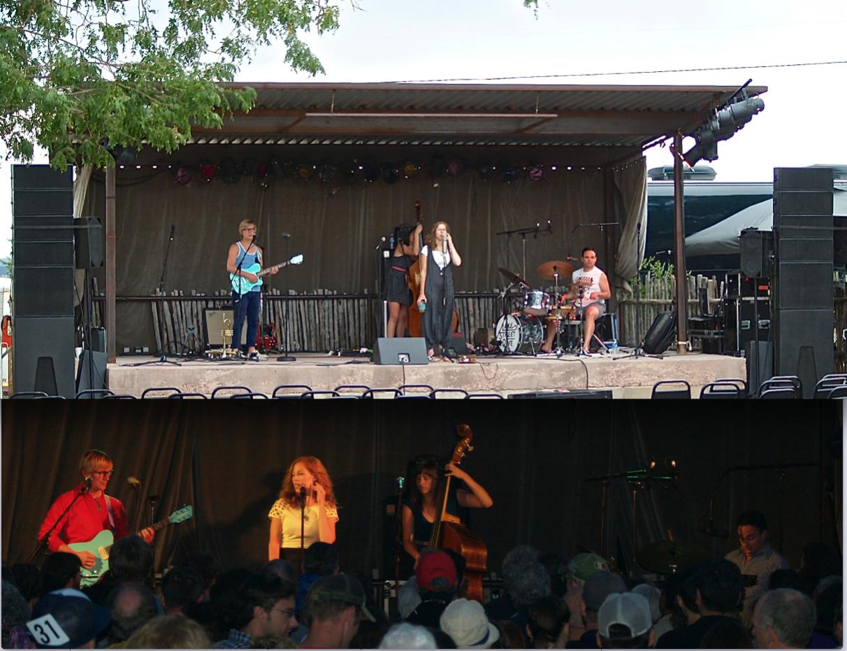

If you agreed with all my opinions, you would bore me to death :eek: .
L.S.D. and their FOH and MME engineers were a gas to provide sound for.
Having spent many nights drinking in the Minneapolis "Lake Street Dives" the youngsters named their band after, they, and the band seemed quite real to me!
