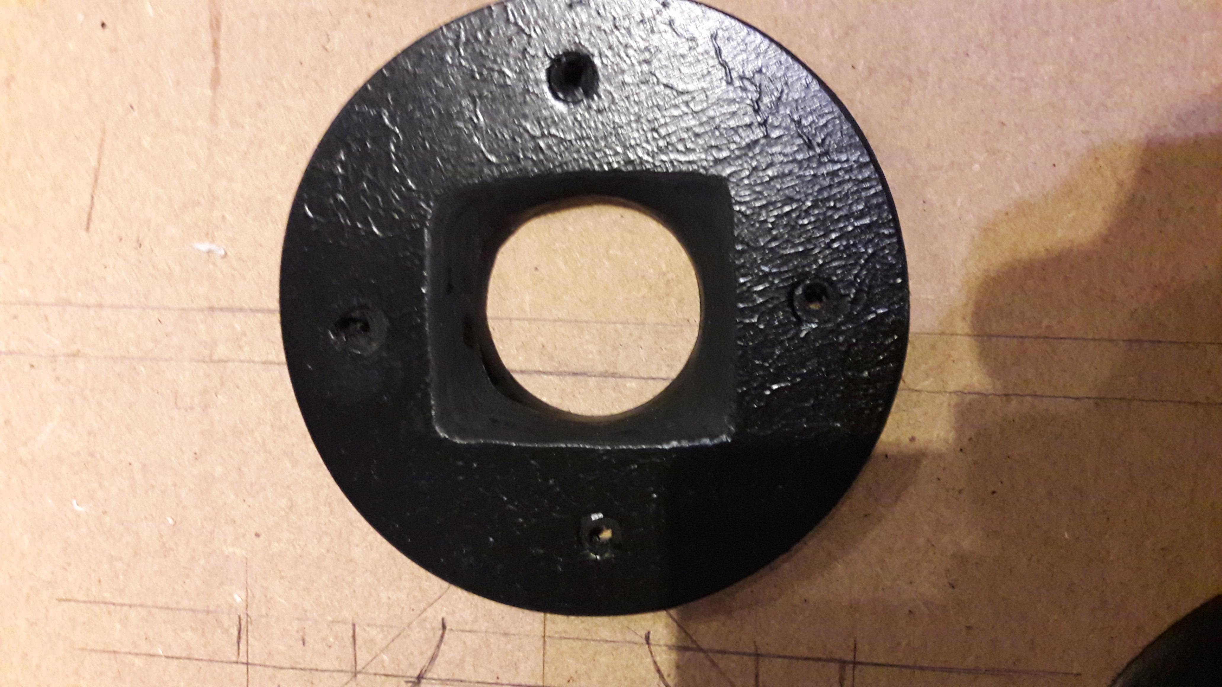

Jsk,No, I used the attached profile as a template, laminated two circles of 18mm ply as a blank. Then used my drill stand in the same way as Art to act as a make shift lathe.
Glad you were able to follow the directions and make the throat correctly.
What material is your throat made from?
Art
Jsk,Hi Art,
Made the throat using 6mm ali and 6mm ply laminated together. Cut into rough circle with a jigsaw then tidyed up on the drill press. Core drilled the centre hole to match the compression driver, and flared it out to the rectangular throat dimension.
Other than a bit of ambiguity as to "ali" which is probably aluminum and "ply" which could be any type of plywood, sounds like you "followed the blueprints" ;^).
I prefer 6061-T6 aluminum alloy and 11 ply 5/8 inch or 13 ply 3/4 inch thick plywood cut to dimension for "mission critical" parts such as horn throats, or rigging parts.

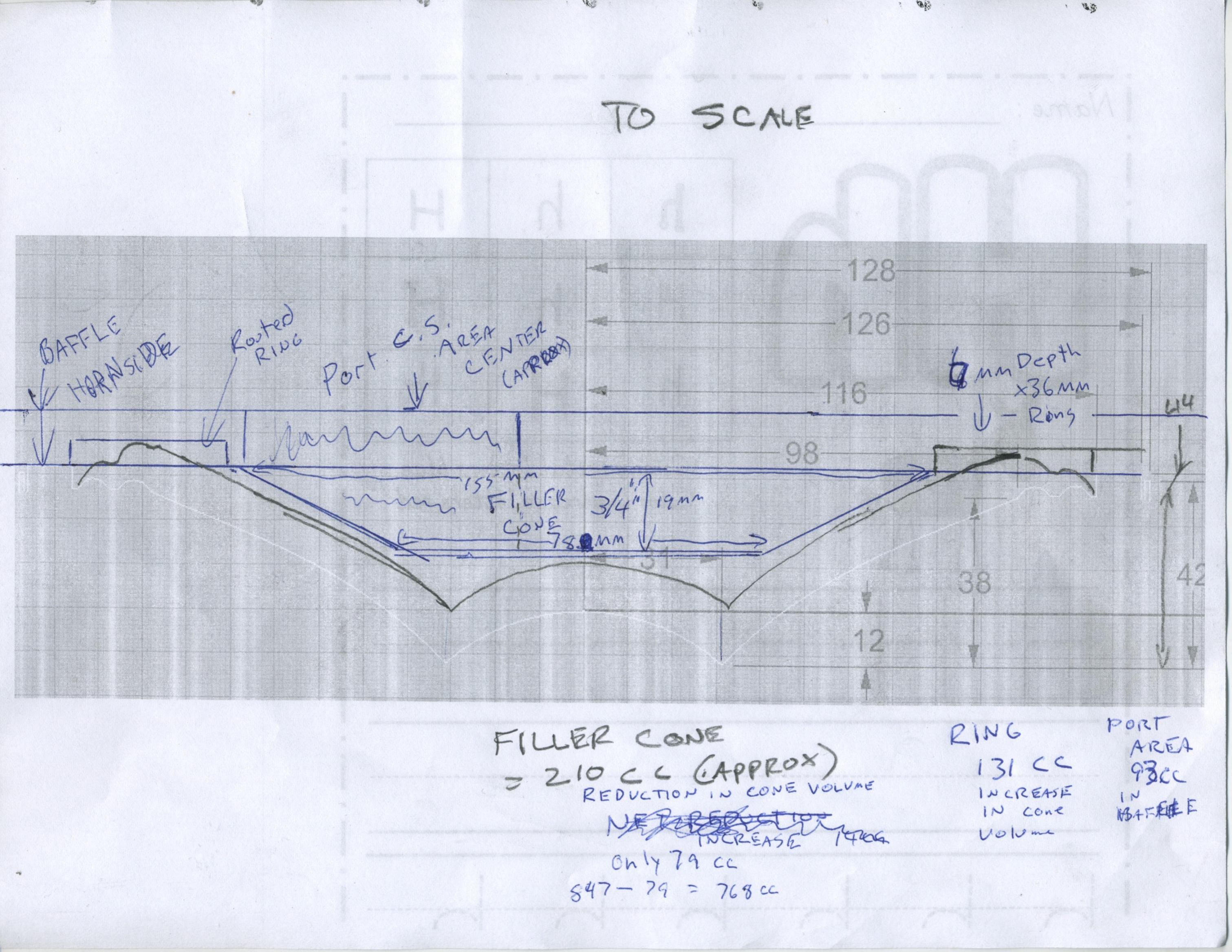

That looks very nice JSK. Is this bases on the cads from JennyGirl?
FYI JennyGirl and I mucked aroud with the cad model and she got her 3D printed volume plugs up to about 260cc's.
Jenny used a CD that was a big higher rolloff spec'd but got the mids to crossover a tad higher due to the larger volume plugs. Plus it was super easy for her to print them out.

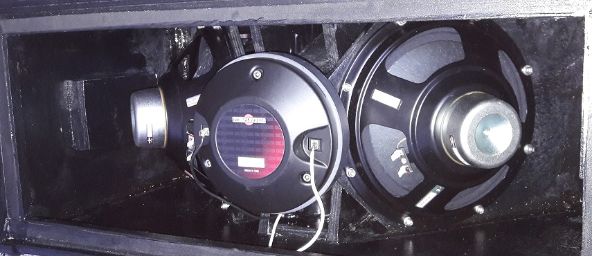

Thanks for the info. I am nearing completion of my pair of syntrips. Only changes made were box out handles and a fixed pole mount, as I have the pole angle adaptors already.
My existing comp driver was a 2" diameter throat so some slight adjustment on the adaptor. All working out well though. I will also be fitting a butyl rubber rain guard sleeve on back panel to protect the neutric speaker connections.
Currently applying paint, starting the flares /grille frame. Pics to follow later.
Pics of build so far
Beautiful work!
