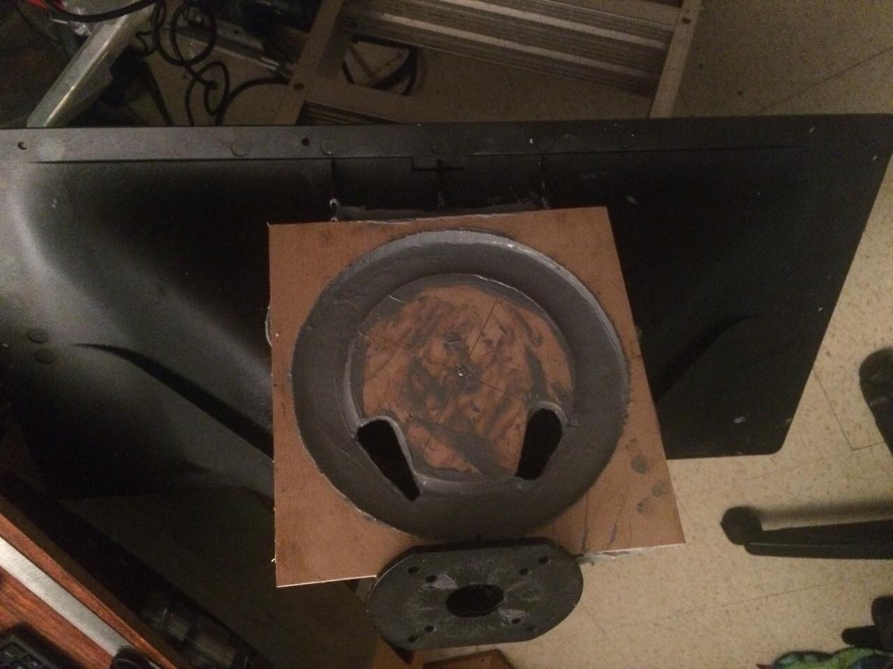

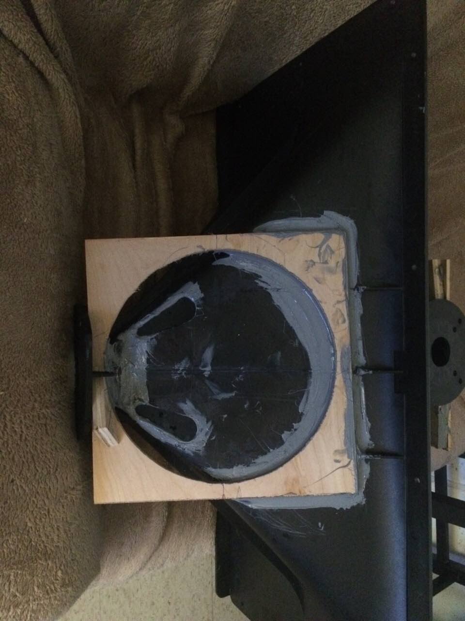

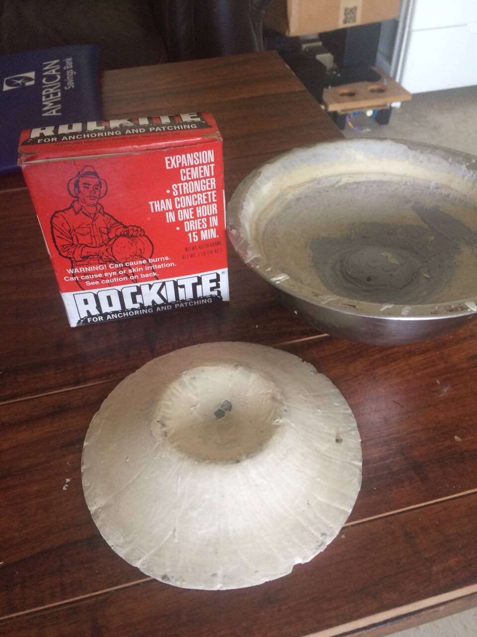

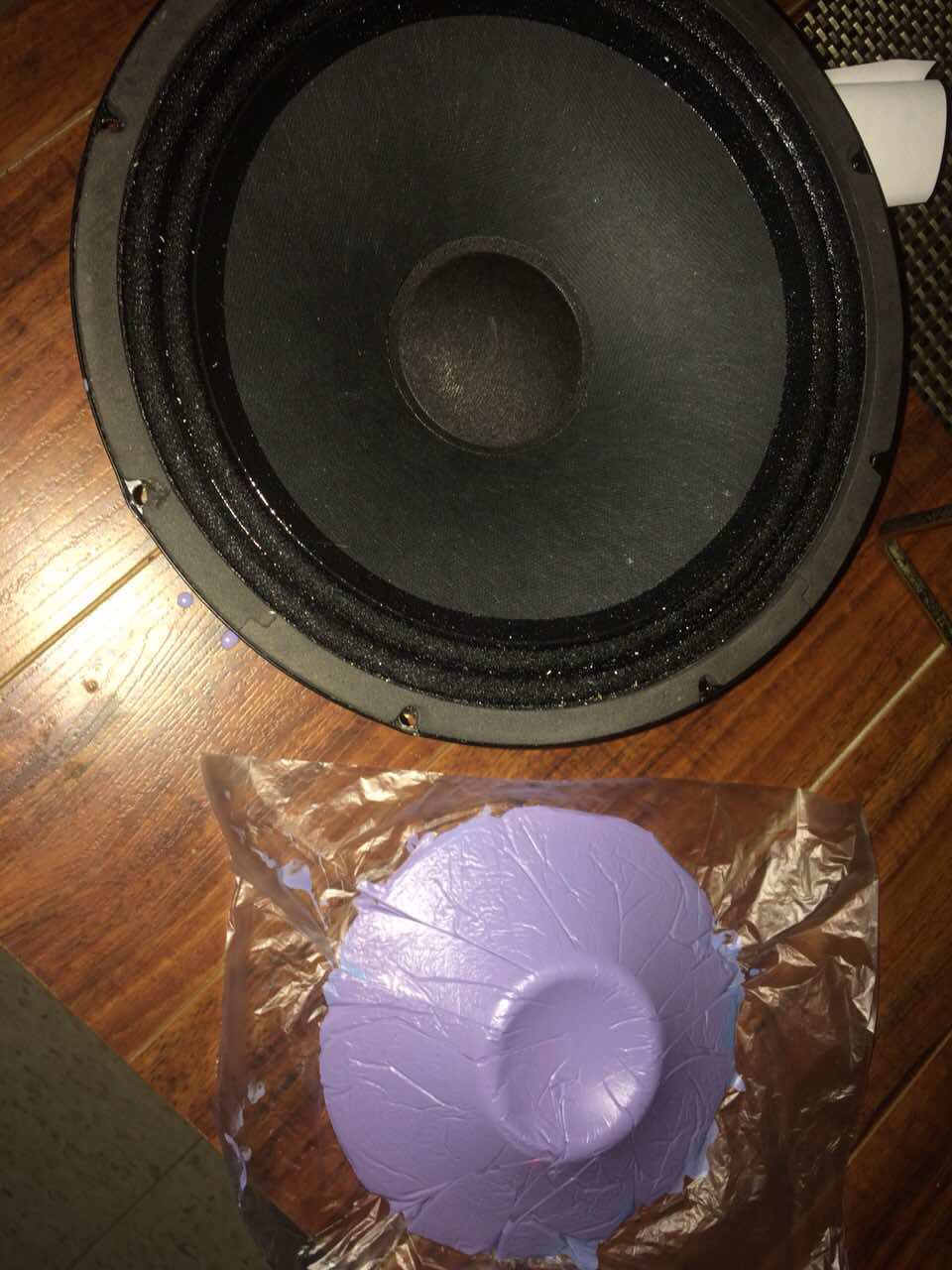

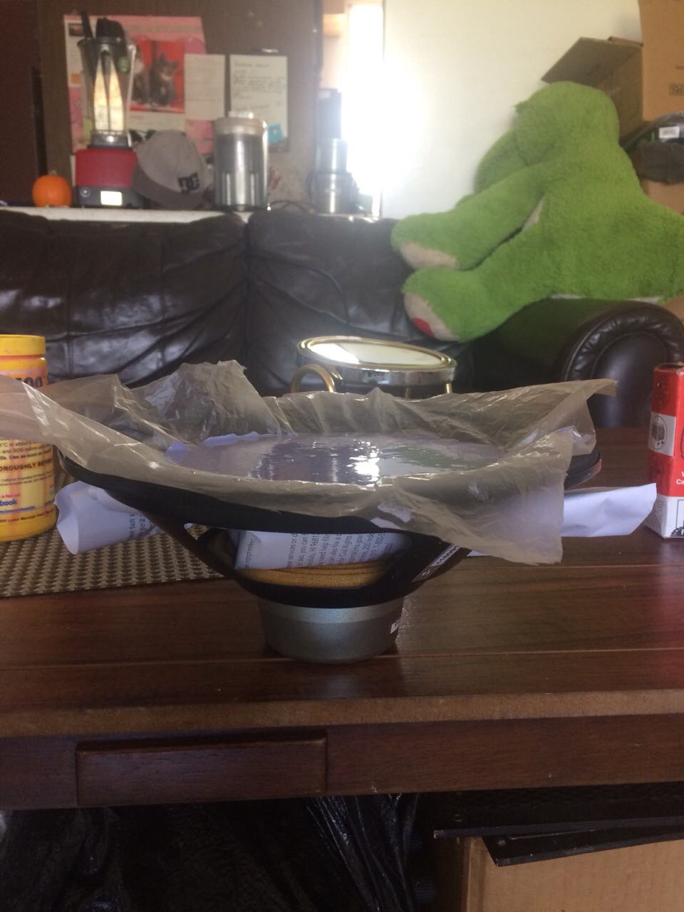

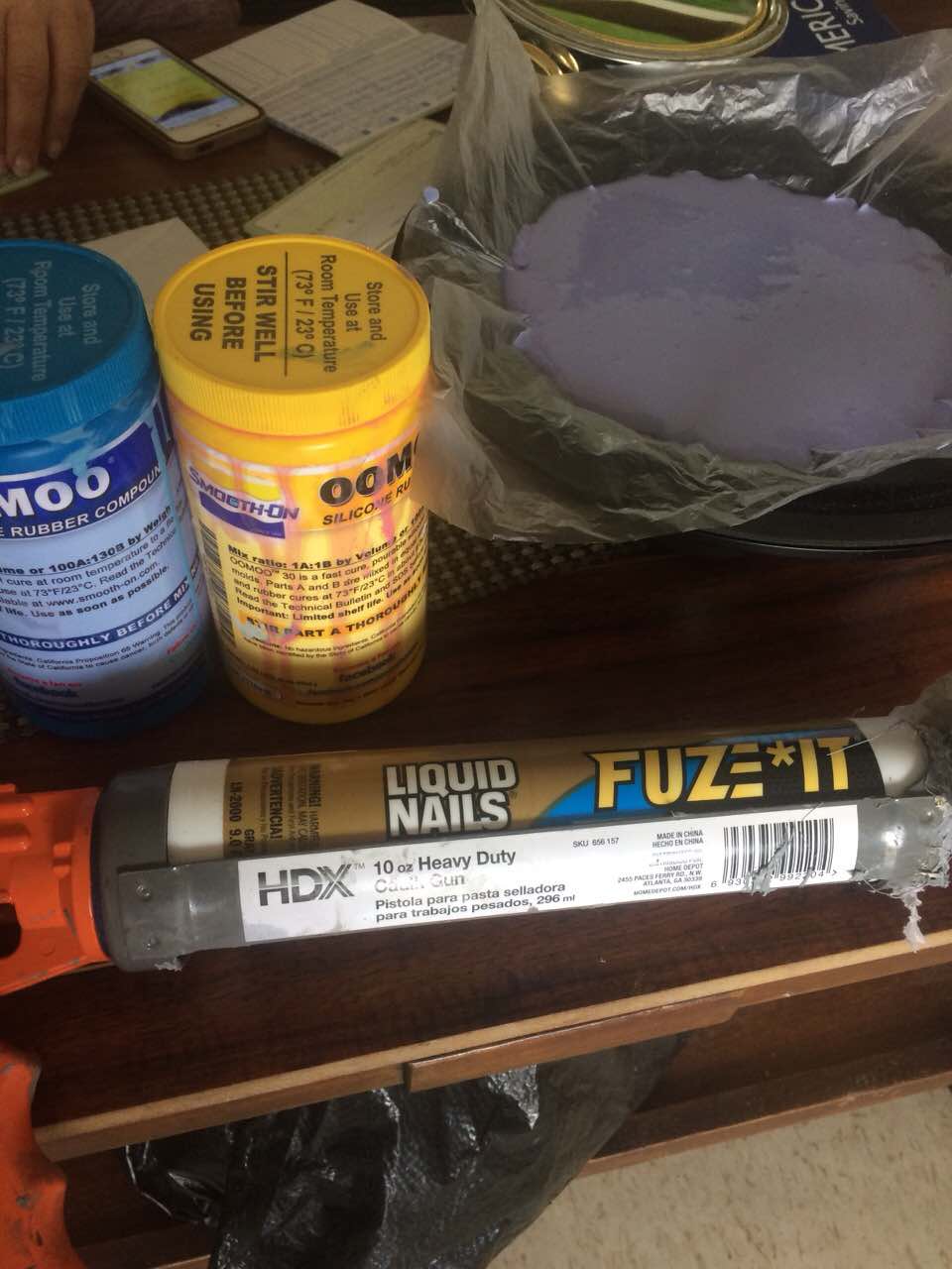

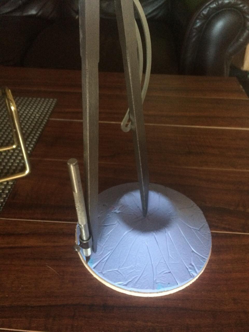

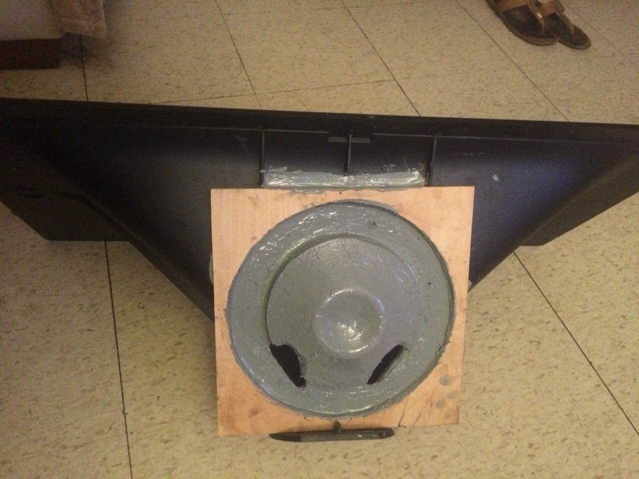

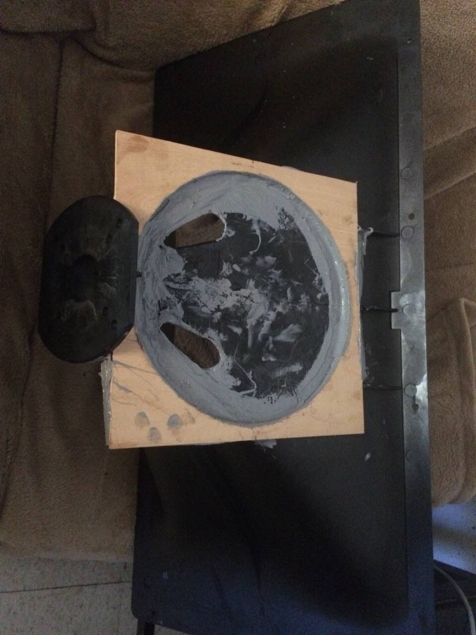

Thanks USRFobiwan, but it's not🙂.
It's really messy to work with and needs finishing work.
I tried several materials for mold including gypsym, bondo, cement and liquid rubber 😡
Cement, bondo and gypsum are cracked too easy.
So I place under the cone of the woofer "innovative support system" and use cone as the mold🙂
