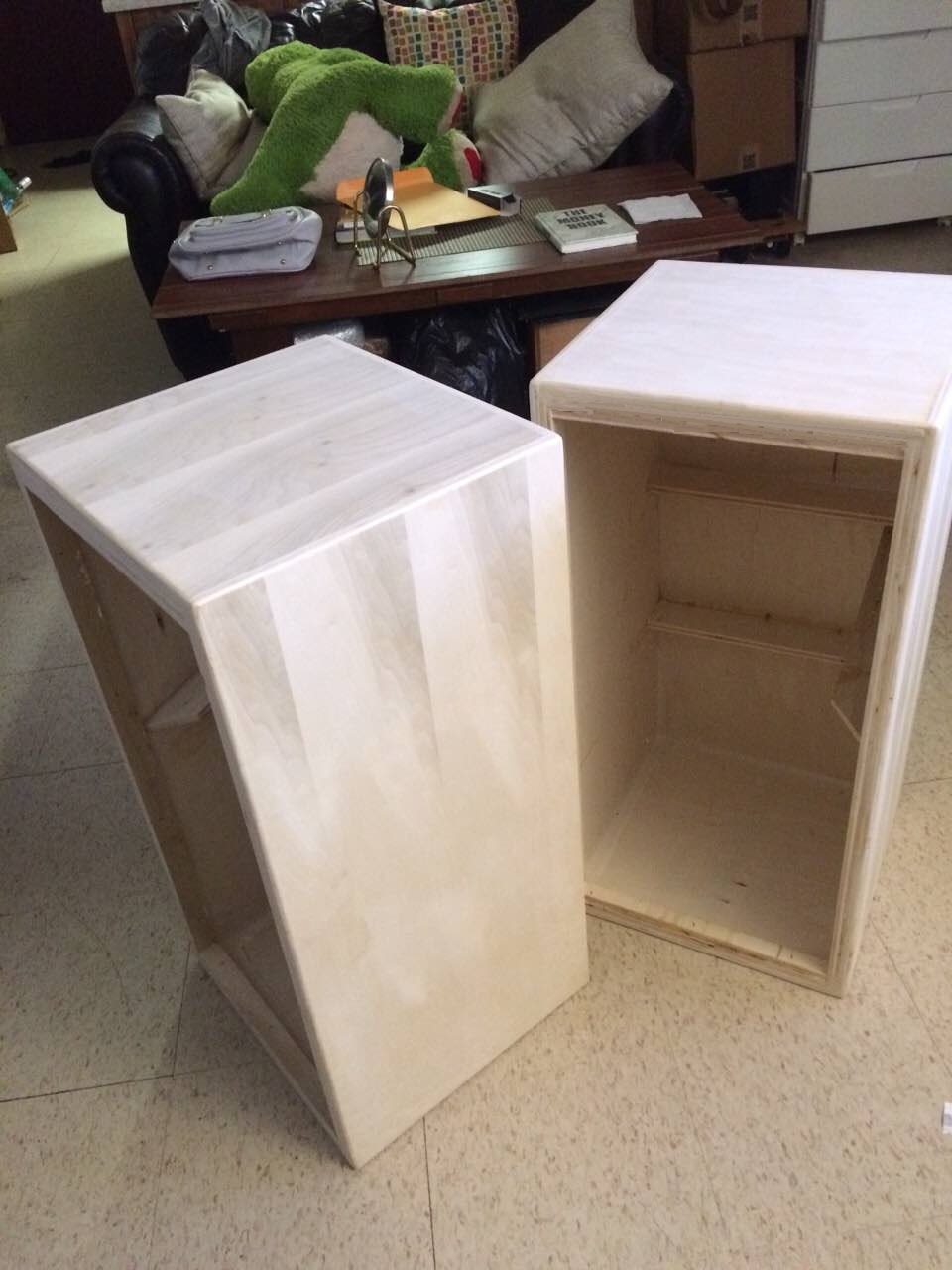

Hi Folks
I am looking at building this, but with a slight mod. The subs I have are a little narrower than the full 676mm of the original SynTripP and I would like to be able to stack to tops over the subs. To do this I would need to decrease the width down to 610mm.
Would increasing the height and depth so that the same volume existed in the rear chambers offset any negative effects of a reduced width?
I recognise this will change performance, but might be fun to try 🙂 Where would you suggest making the adjustments?
You might struggle to get the mids in if you make it narrower. Its already tight.
