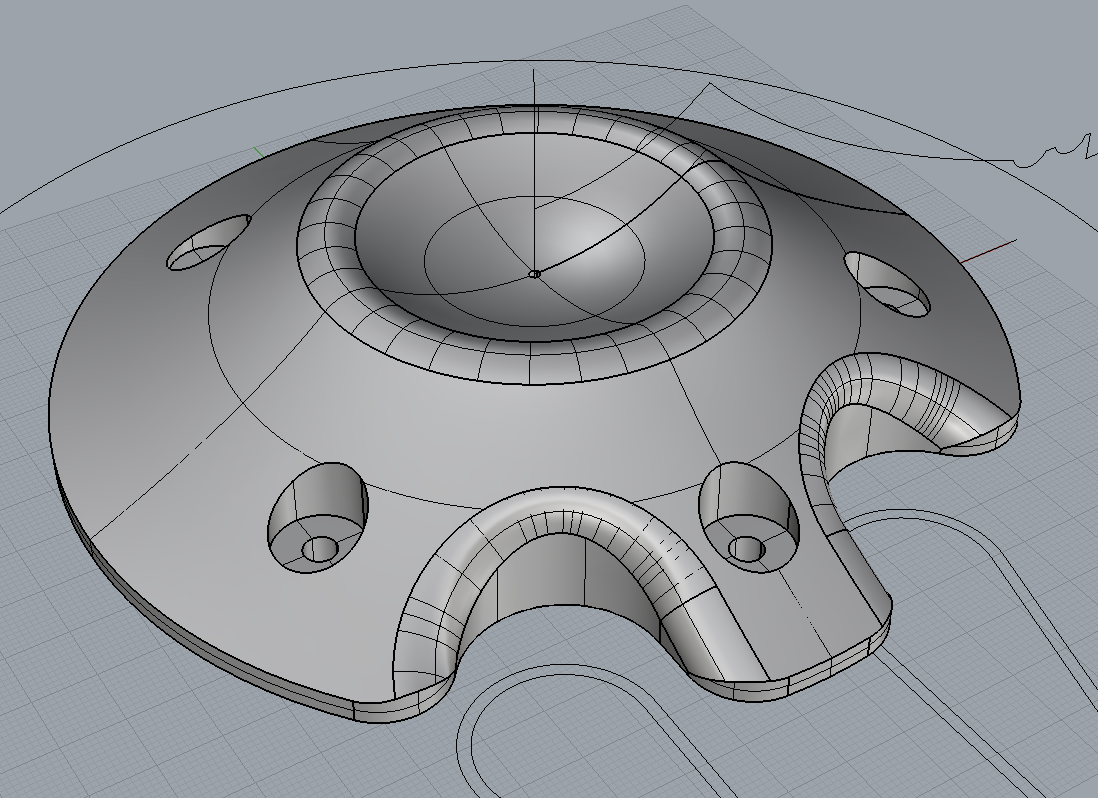

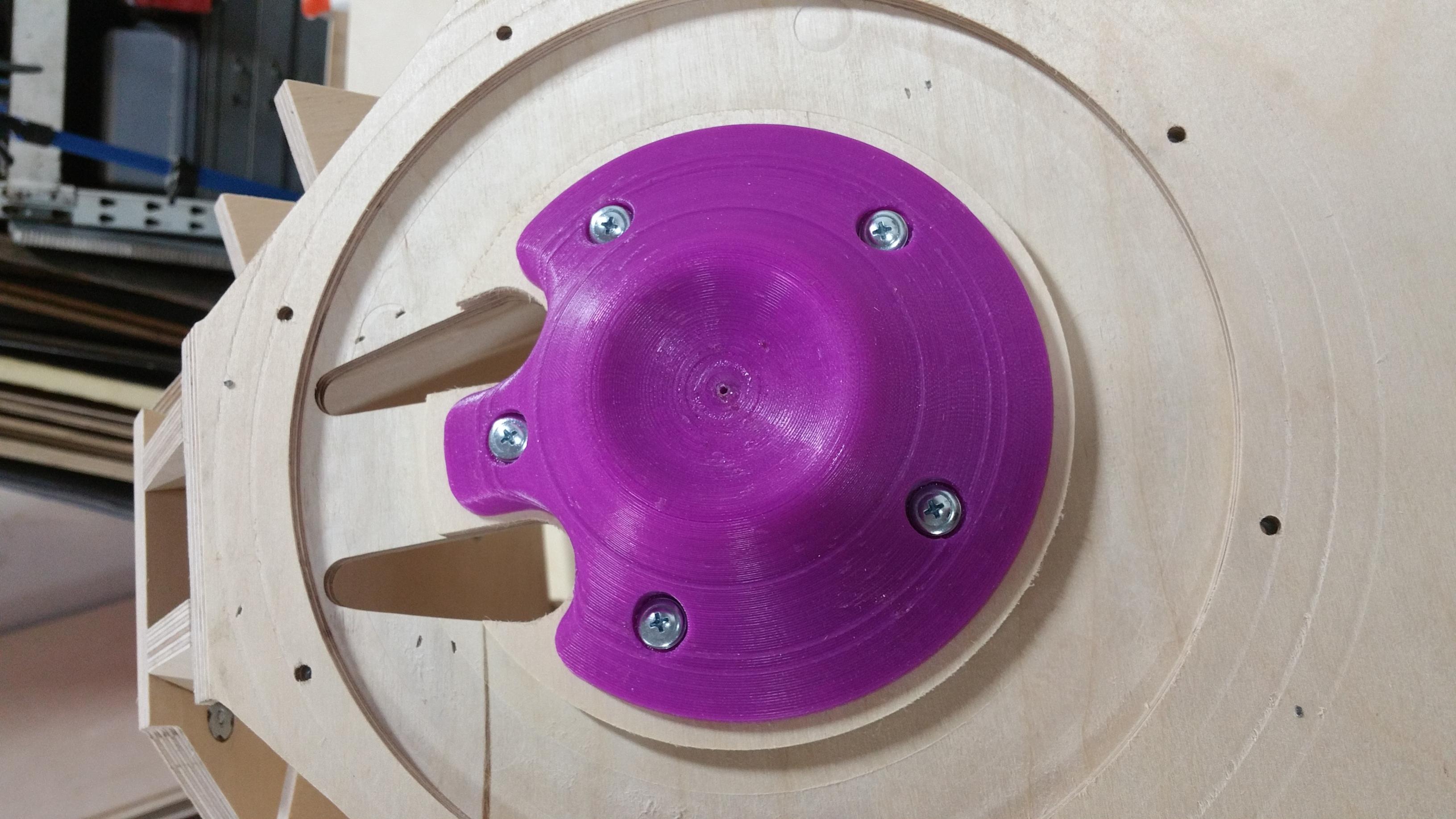

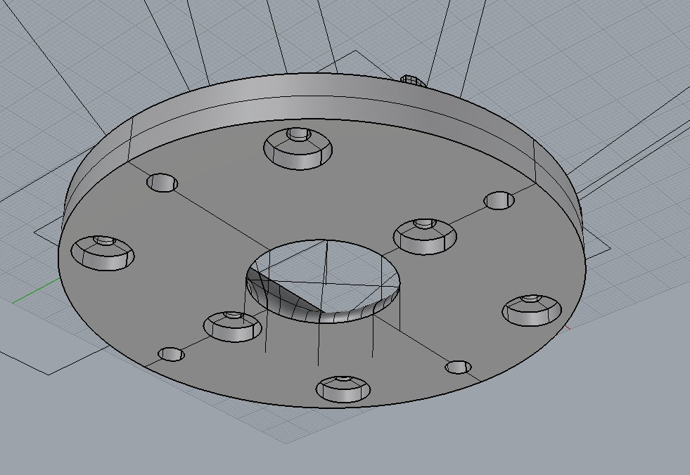

I am printing a part that is 265cc and 12mm distance to xnull
Going to screw it in with some lath screws I had laying around so it can be removed (might try different ones to see what difference varying shapes / volumes have).

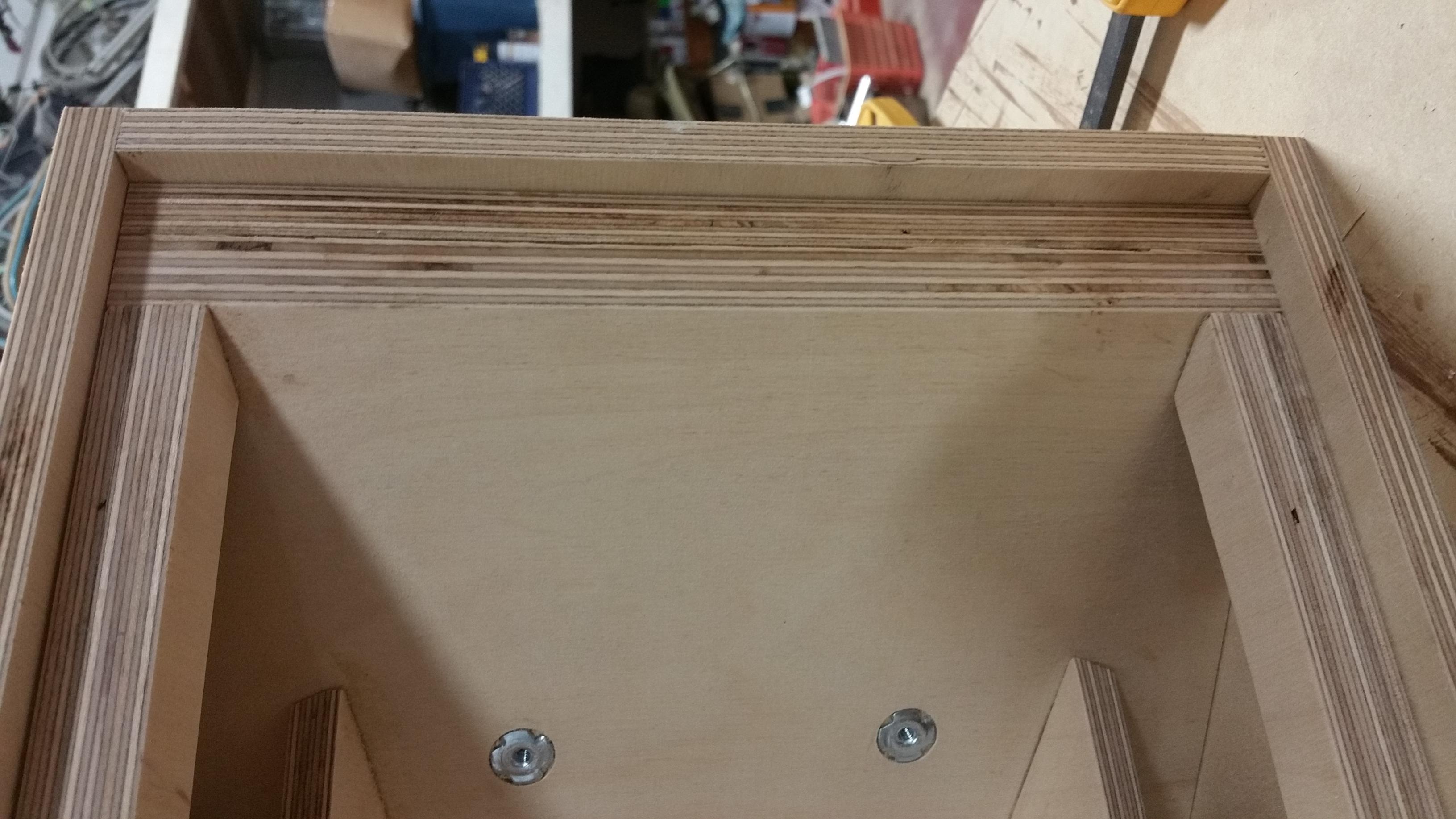

There could be a potential to eventually chew up the wood where the screws bite in. My furniture maker friend suggested to me to be gentle with he screws to avoid this. Of course nuts would help avoid that.
I did like your idea of having one central bolt and a tnut.
Some fun foam as a gasket may work well underneath to prevent vibration during testing.
I used a single drywall Spax screw in the middle to clamp it down with a thin sheet of 1mm thick packaging foam sheet as a gasket to keep it from rattling or moving. Alternatively, 3 little dabs of hot melt glue with screw will keep it from rattling as well and is removable with a tug.

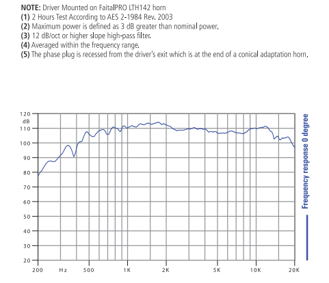

Thanks xrk! Interesting. For now the plan is to work with what I have, a HF144 CD. I am going to make the throat adapter removable, so a different adapter could easily be made to fit something else. I am totally down to try it.
Manufacturer's response curve for the HF144 below
EDIT: just looked at the specs of the Scanspeak 10F/8424, looks to be nice and tiny depth-wise. Would be an easy fit dimensionally. Heckuva lot cheaper than a 3" diaphragm CD.

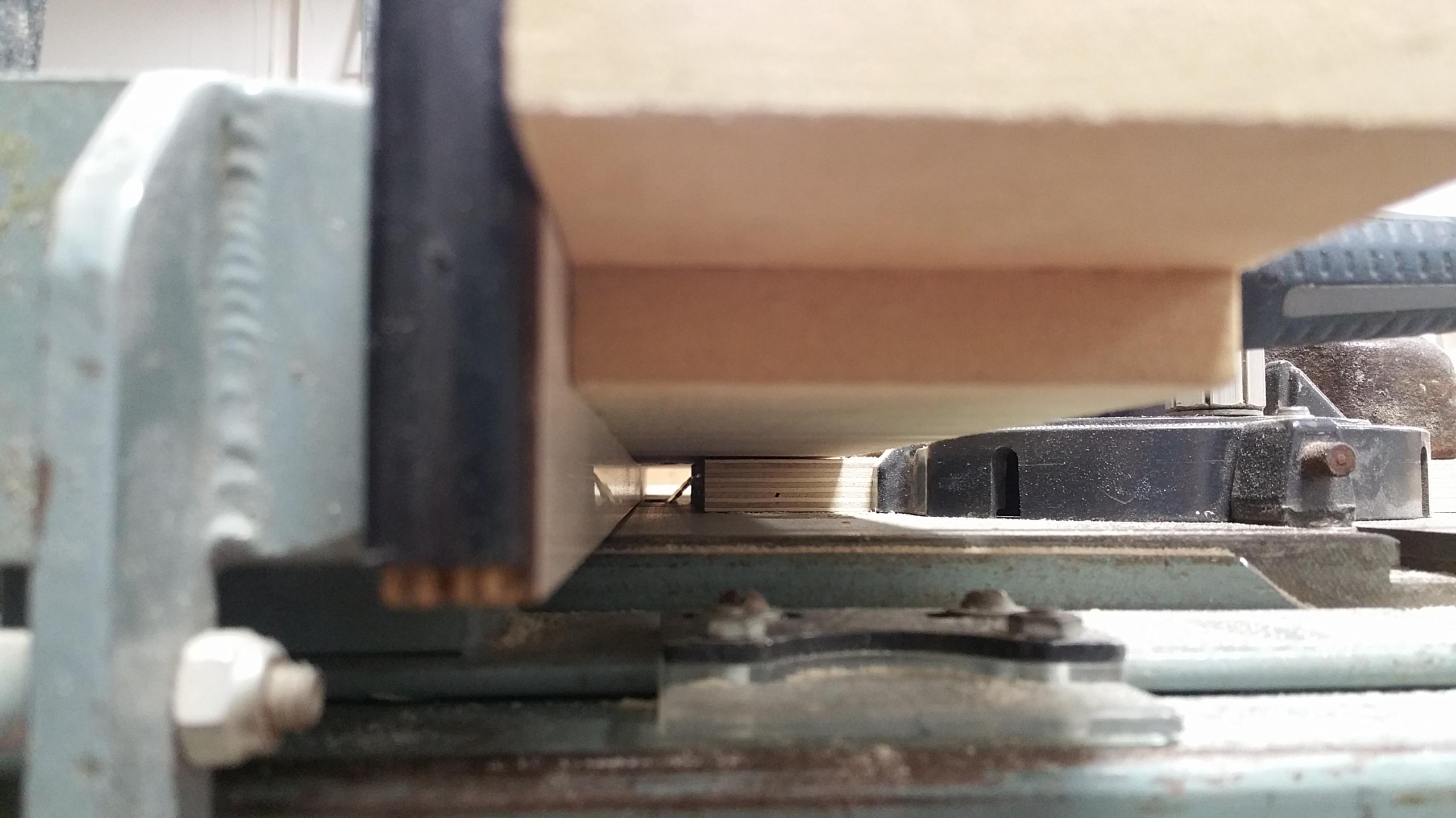

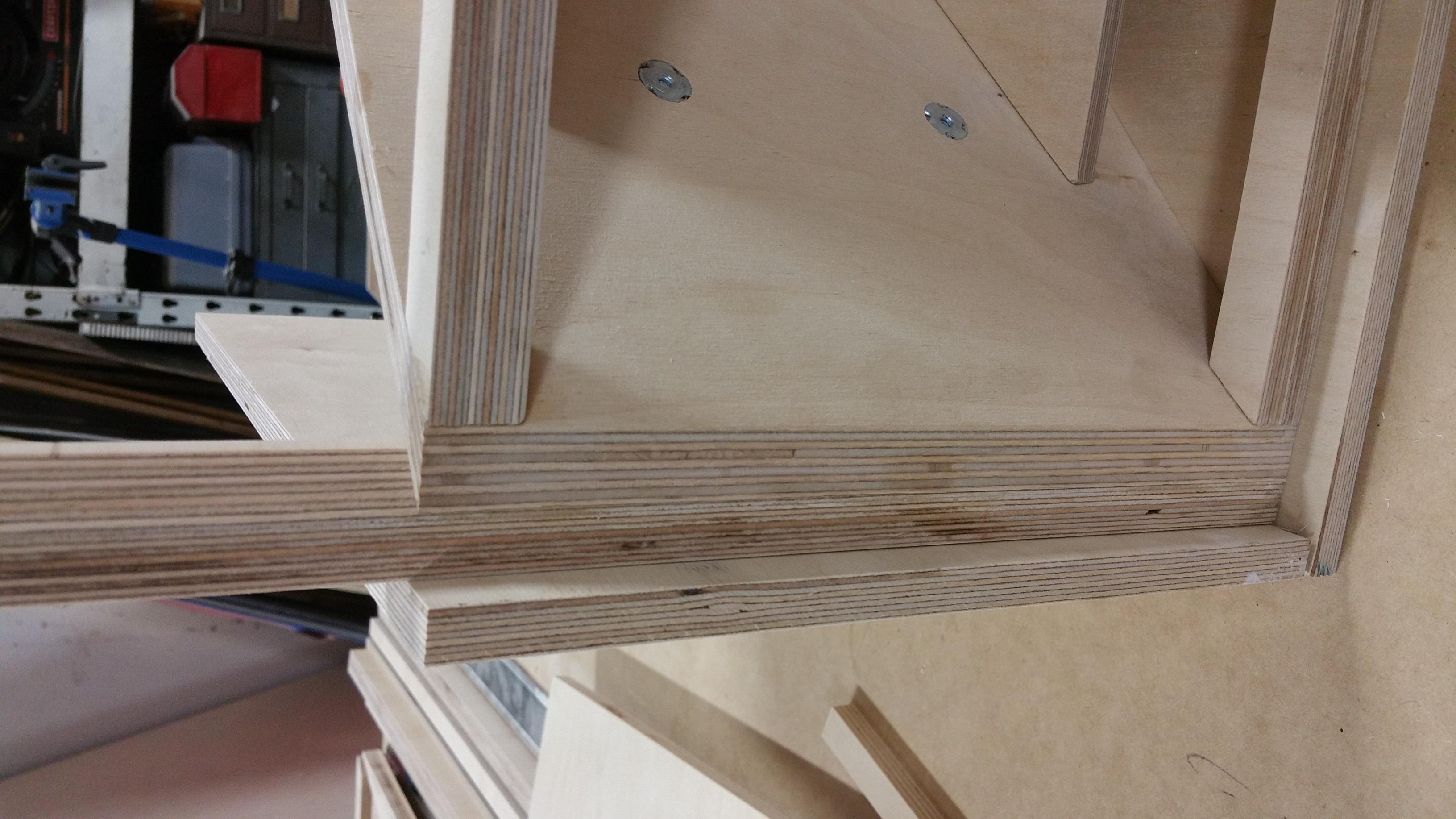

Posting some progress
Phase plug is mounted (not sealed/glued yet)

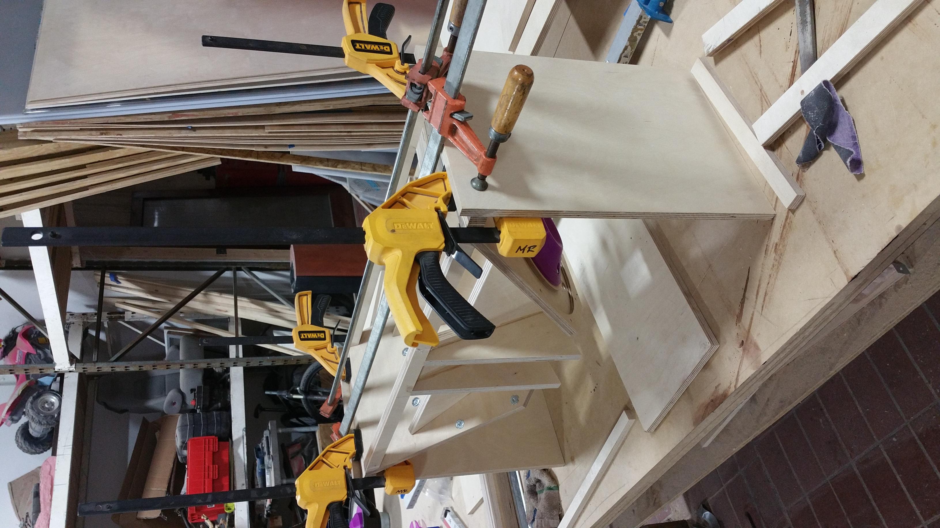

Cut the side cleats and glued them

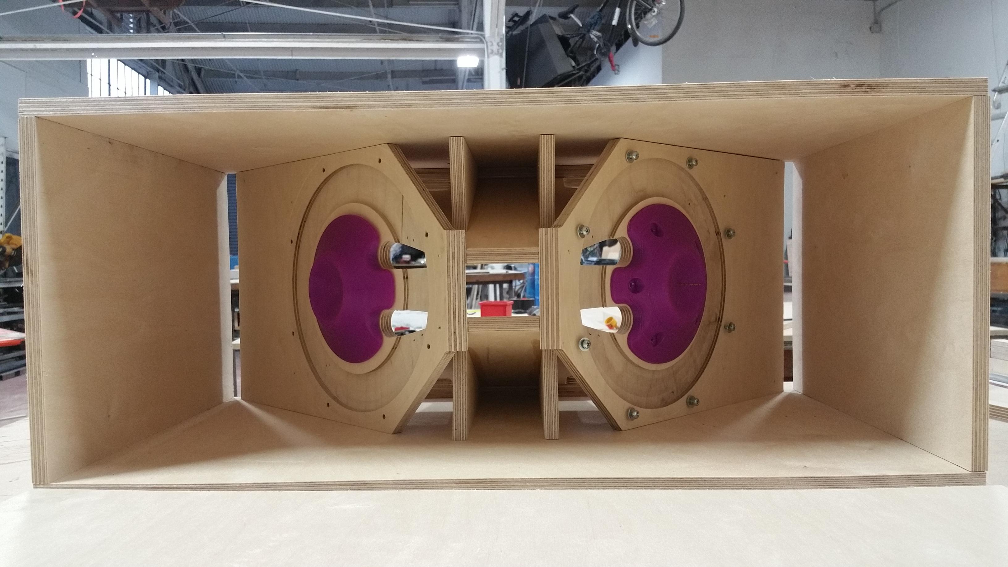

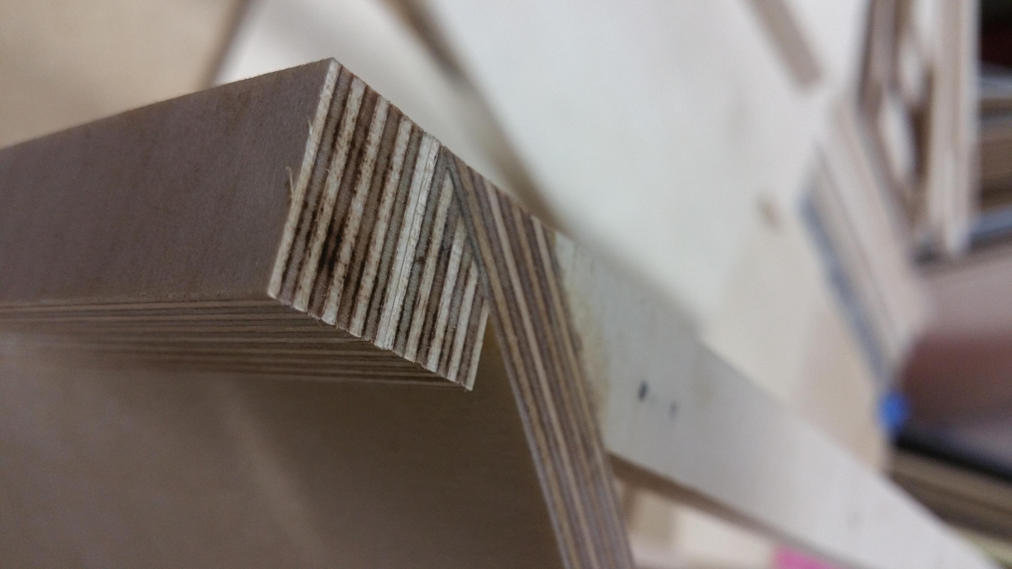

Installed the sides first (horn was just ever so slightly out of true, this will let me use the sides to true it up when the rest of the box is put together)

That is a nice driver - wish I had one. It's actually designed for the LTH142 waveguide that I used for the bookshelf point source horn, which is now running the SB65WBAC25-4.
The 10F won't be able to generate pro level SPL's of course but is a great choice for HiFi or HT use. What it does make though will sound very clean relative to a compression driver.
Good idea to make throat adapters and easy to try at later time. You may just like what you hear.

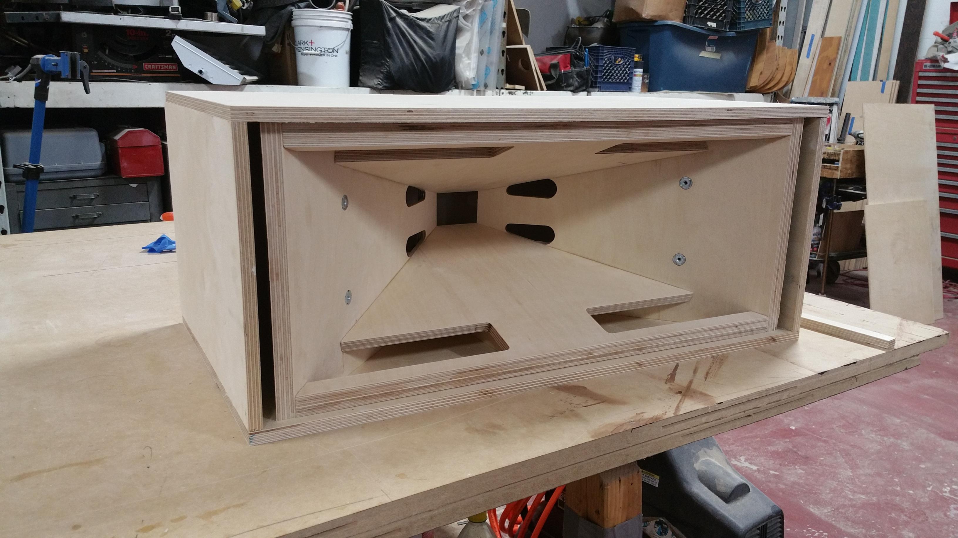

The light at the end of the tunnel is still a ways away, but it is discernible. The box went together perfectly, and everything is square

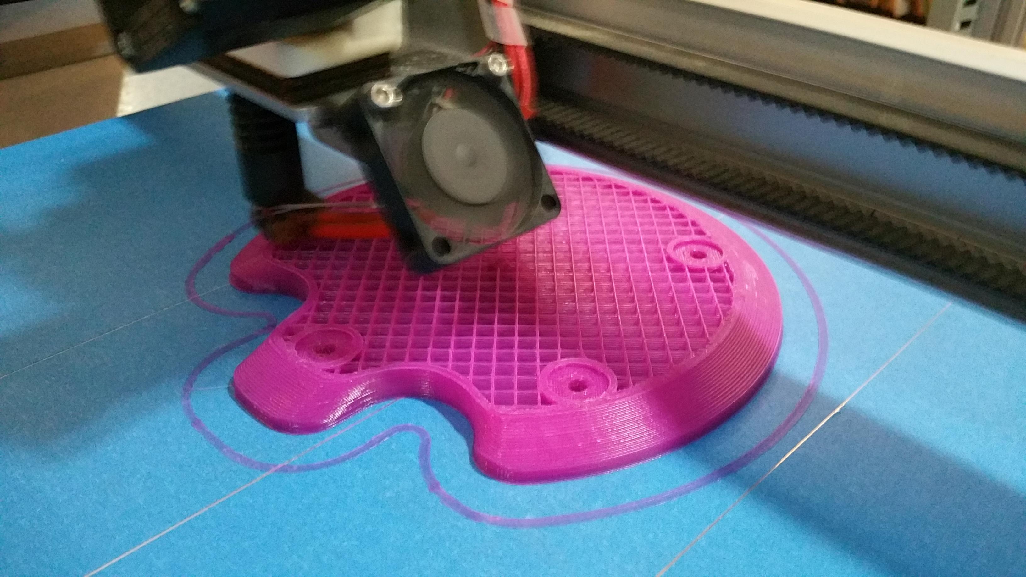

Printing the second phase plug, then onto the throat adapter
Cannot wait for first sound. My roommates are stoked, too!

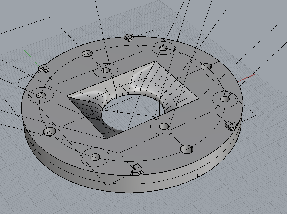

JG,
Nice model of adapter. You might consider making it longer so that the expansion from 1.4in dia round to rectangle can be more gradual. I am thinking about 3x - 4x longer. My experience with a throat adapter on the xBush point source horn is that a gradual expansion made all the difference and reduced the cancellation dips corresponding to ten throat dia.
