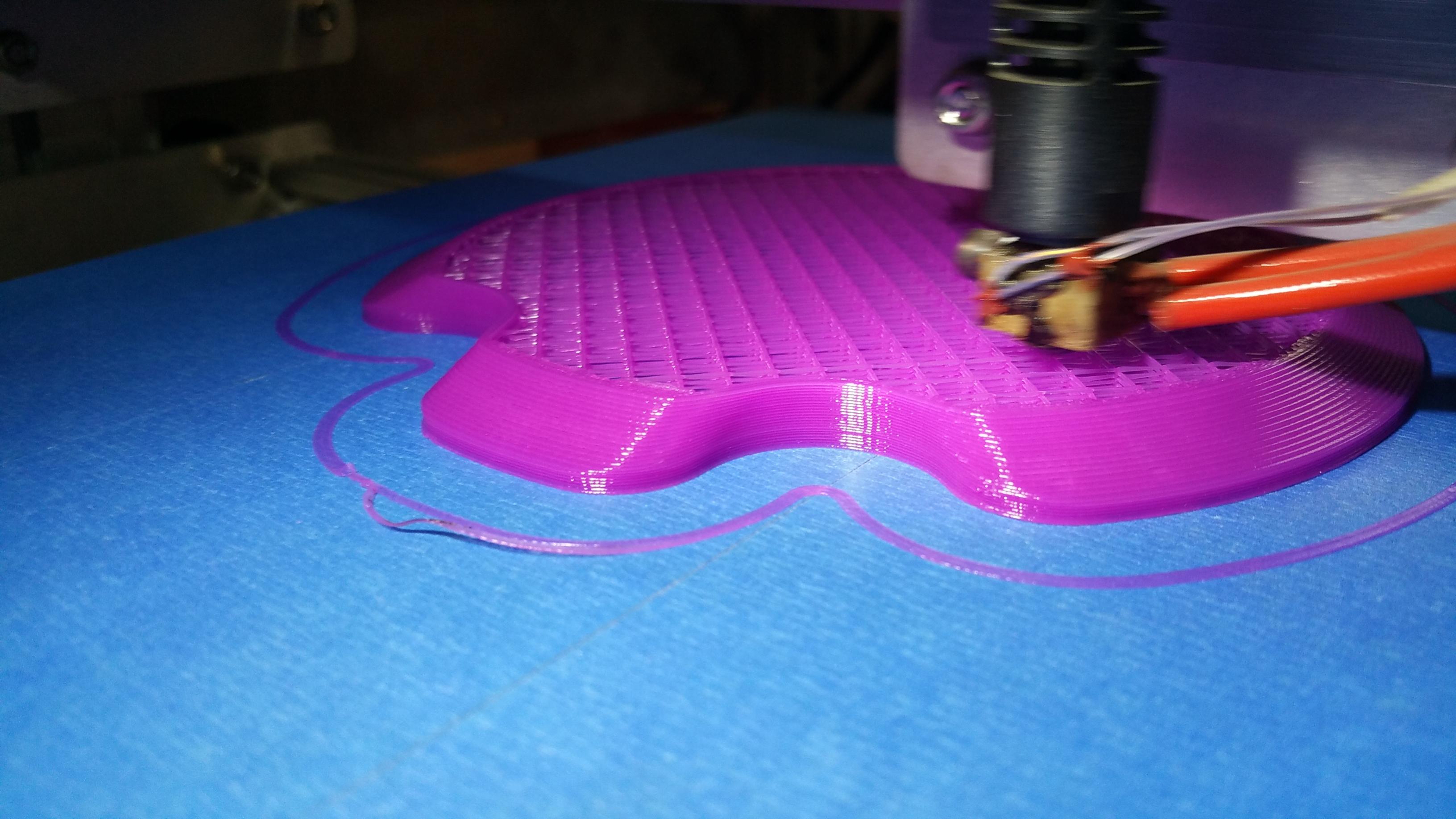

Noted! I have been printing with no base layer (starting from the bottom with just infill).
Just had the thought that I might fill the infill altogether with something cheaper (and faster) than printing it. That way if there are any microscopic gaps/cracks there is just no chance of interior air leakage into the part.
Some kind of closed cell foam or something... Might even be able to use it to bond the part to the wood....

Gorilla glue is neat for this type of application, you can give a light mist of water on the parts that will make it expand and harden.

PL Premium from caulk gun is much cheaper than Gorilla and will fill and seal all those pores. Glue a plastic sheet on it with the PL works too then a screw can be used to hold in place so removable.
Thanks for the suggestions on glues! After some research the gorilla glue piqued my interest.

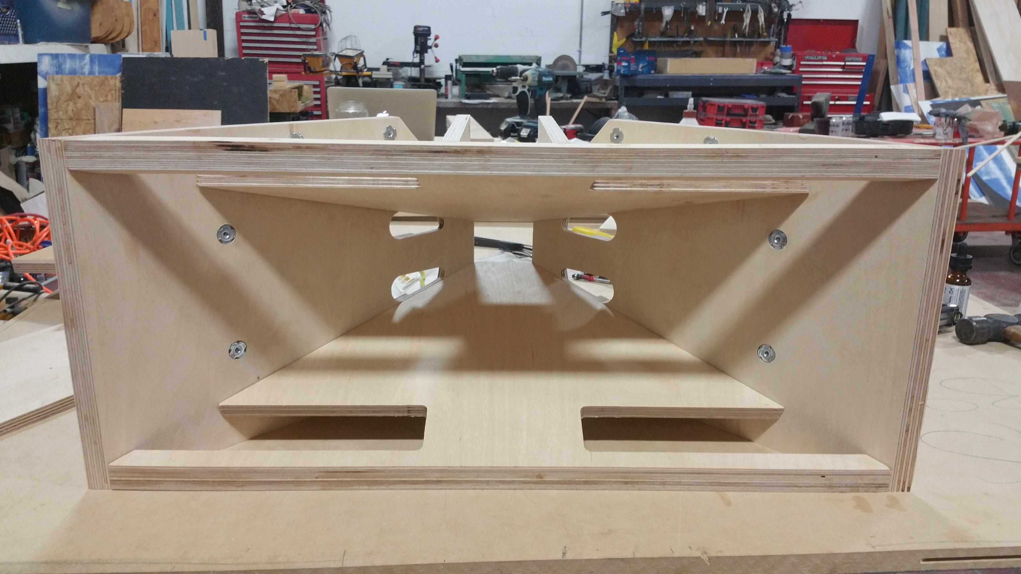

Mark- do you mean bondo? I think I'll have to get some anyway to finish the horn. I believe Art calls for a fillet of bondo on the inside of the horn.
I'm printing another version of the part with less infill. Time to complete (start to finish) is about an hour at this point

Gorilla tape is great, Gorilla glue is a terrible mess, and has poor shelf life once opened. I have thrown out three times as much as used, though it does do a good job of expanding into pores (and blowing glue joints apart if not properly clamped or fastened) and is strong.
Bondo works well for filling holes, but tends to crack out of corners on road cabinets. Bondo glass has decent structural strength, but will not take a radius very smoothly.
For the fillet inside the horn I use a caulk gun with paintable silicon caulk. The caulk remains semi-flexible (won't crack out) and is easy to smooth out after application with a "popsicle stick" or spoon.
Art

Paintable (make sure it is paintable) silicon caulk would work for that too, though the T-nuts would be no more visible than the speaker holes through grill cloth.

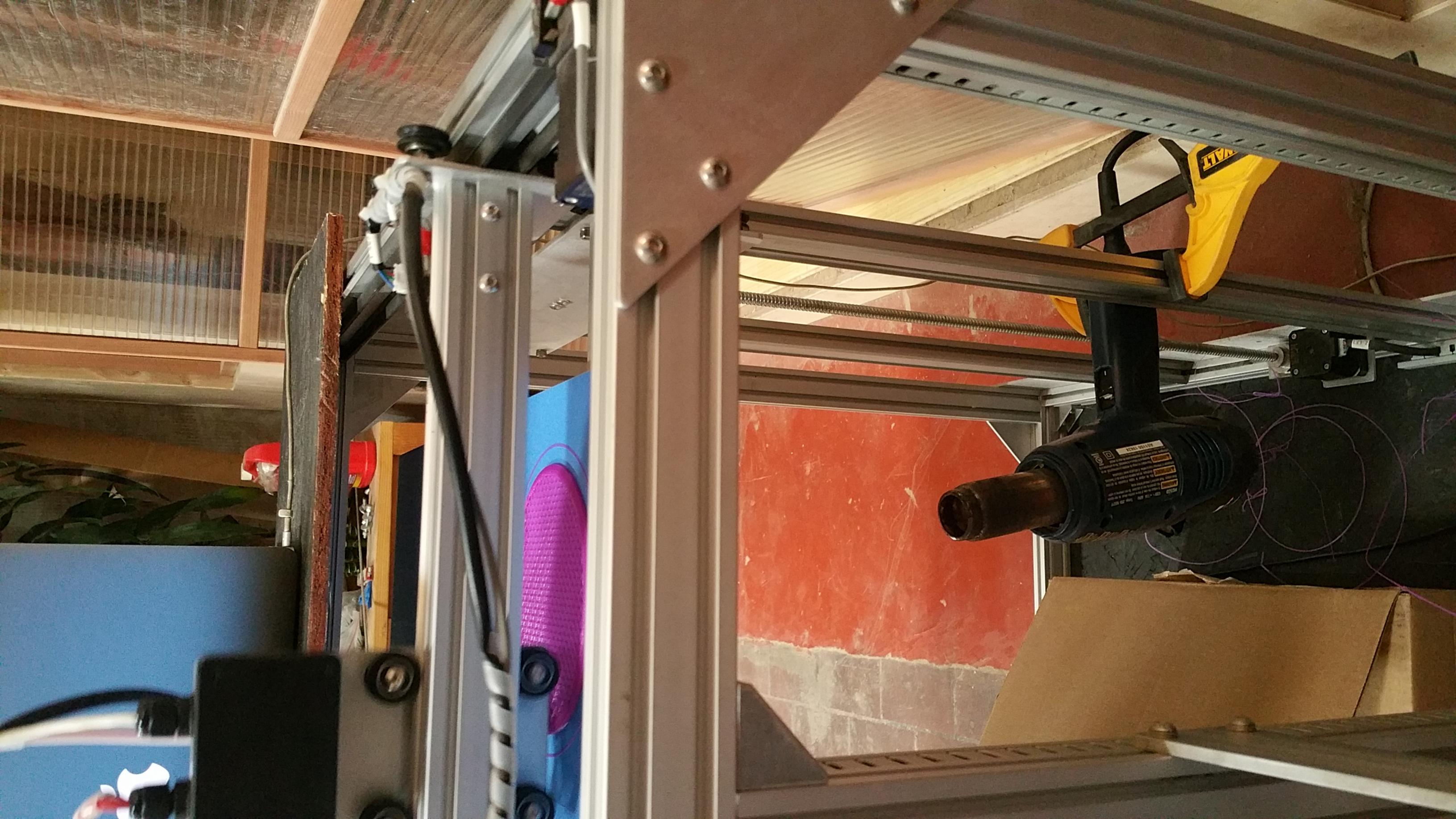

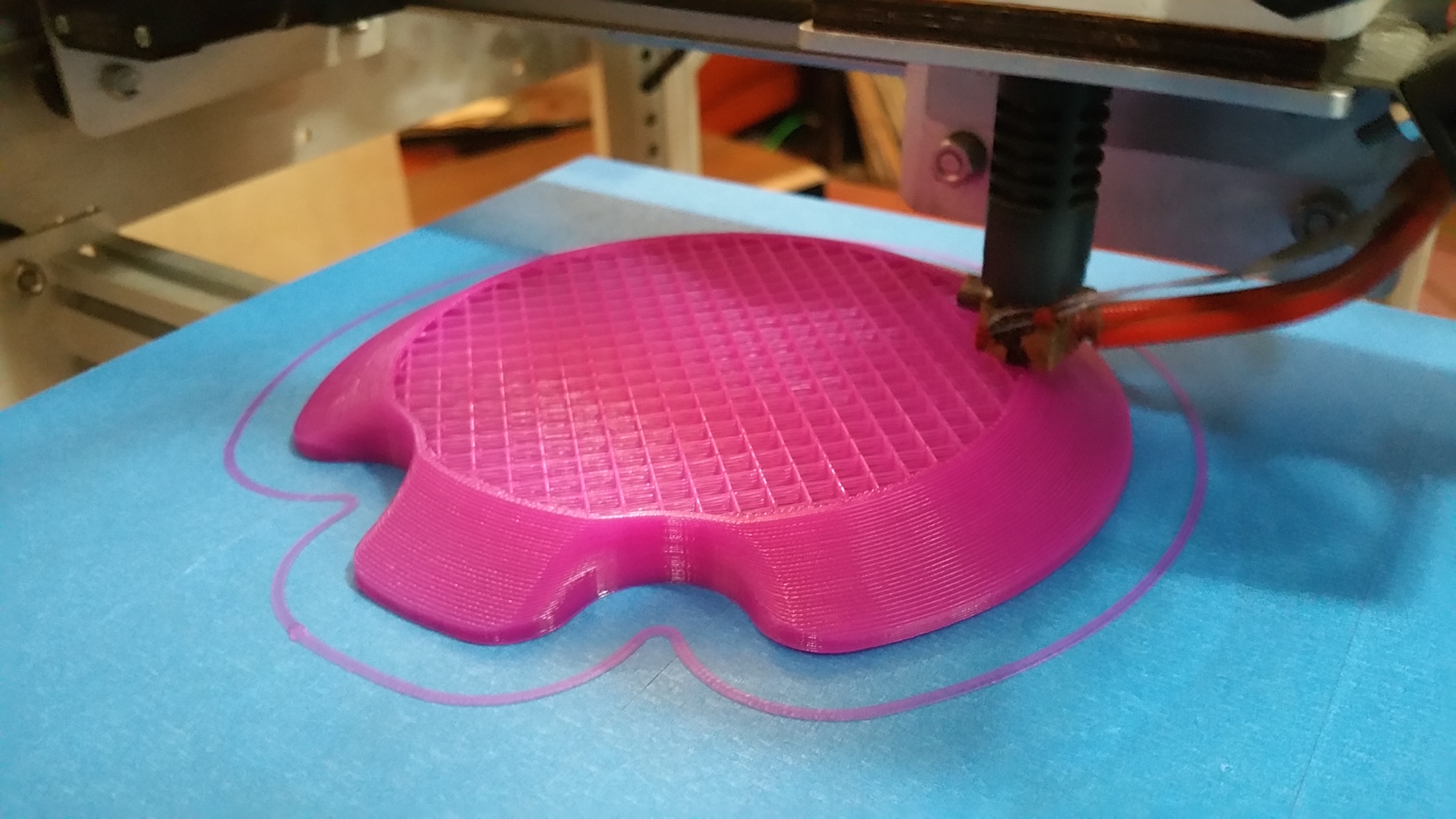

Heated build platform is doing the trick... 0% warping

Caulk is not very sandable, get it right while it is wet.
Without grills, insects and rodents may take up residence in the "hidey holes" the ports provide. I hate it when that happens...
Without the grill frame there will be an ugly discontinuity (both visual and sonic) between the first and second part of the horn.

Glad you dialed in the heated platform. Once I figured out all the tricks in the settings it made a huge improvement to the max size I could print. Are you printing on glass surface? The best surface treatment is 50:50 PVA:water mix brushed onto 55C heated bed. Then heat bed all the way to regular temp after it dries. PLA sticks to it very well and you are assured a good foundation for remainder of print.
I like the pink PLA.

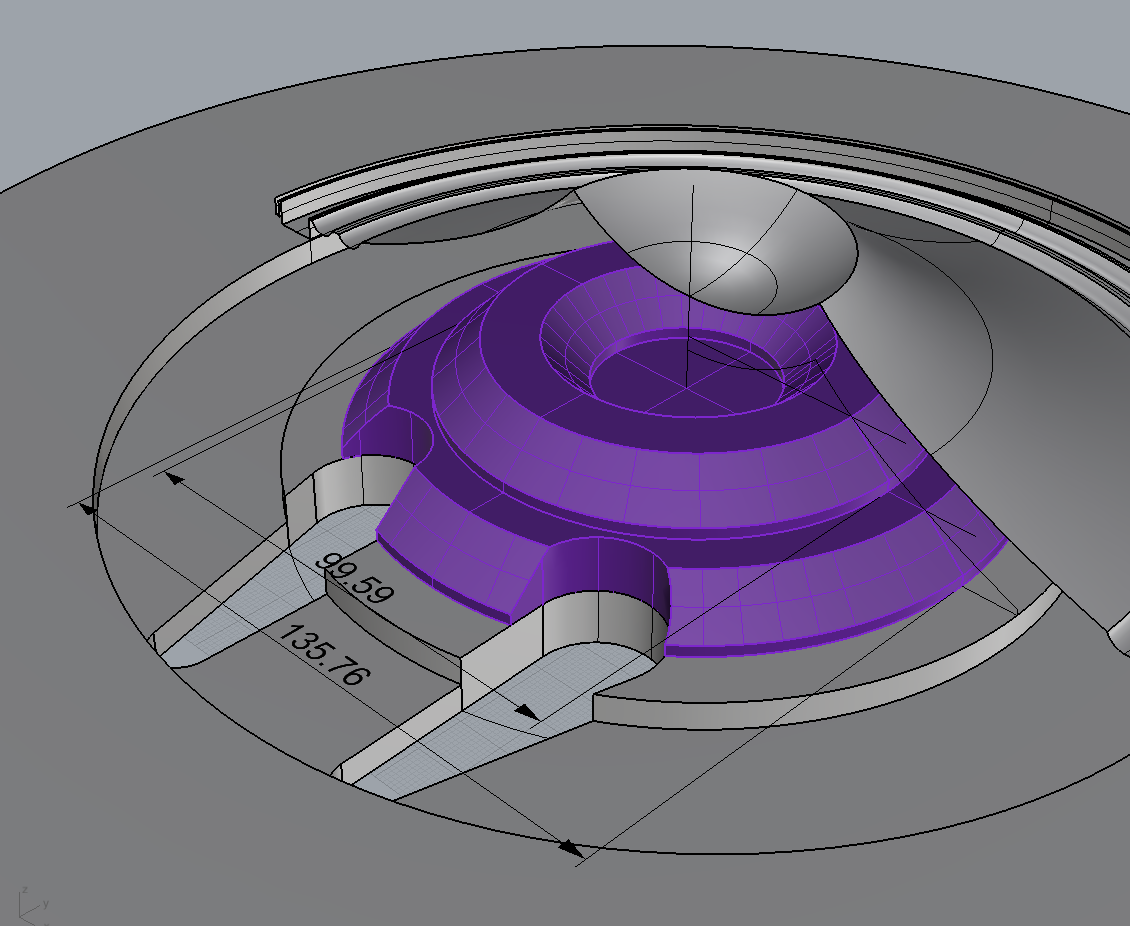

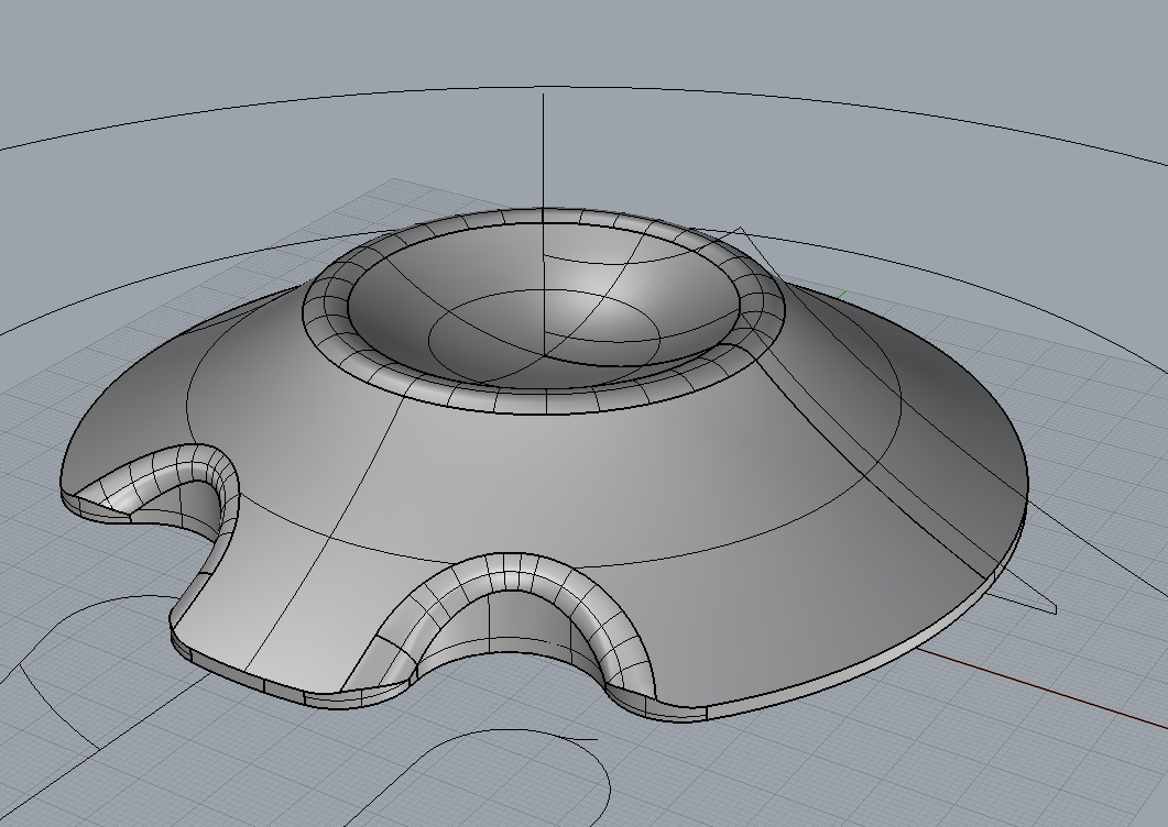

Here is another direction for the phase plug using the same 12mm (1/2") material that can be done with a trim router bit, 3/8" 45 degree chamfer, and 1.5" circle punch (using a paddle bit, hole saw, or forstner bit)
That comes out to 210cc
Is it true to say that the larger the volume plug is the higher the rolloff of the mid will be?
That's true but the effect will be minimal given the differences in volume we are talking about. Not having to provide 12mm Xdamage will help a lot. Reducing it to 7mm or whatever Xmax plus 1mm would be good if you haven't observed much movement. That reduces the volume a lot as it is Sd x stroke = volume
