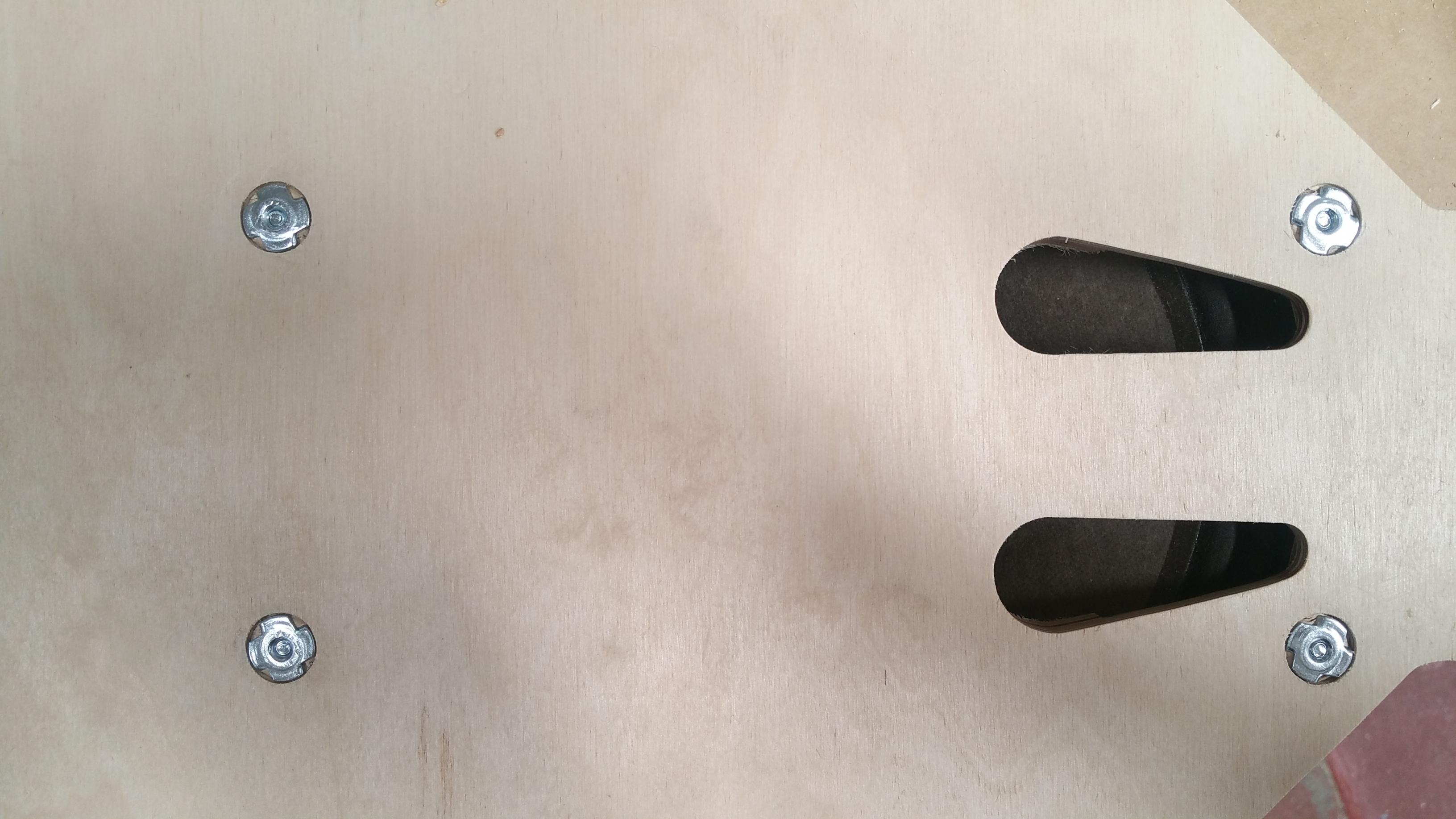

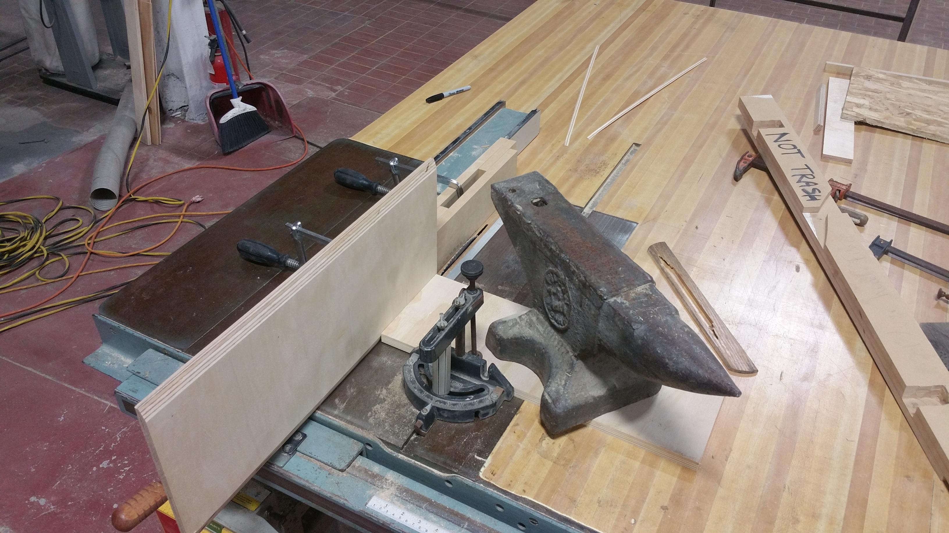

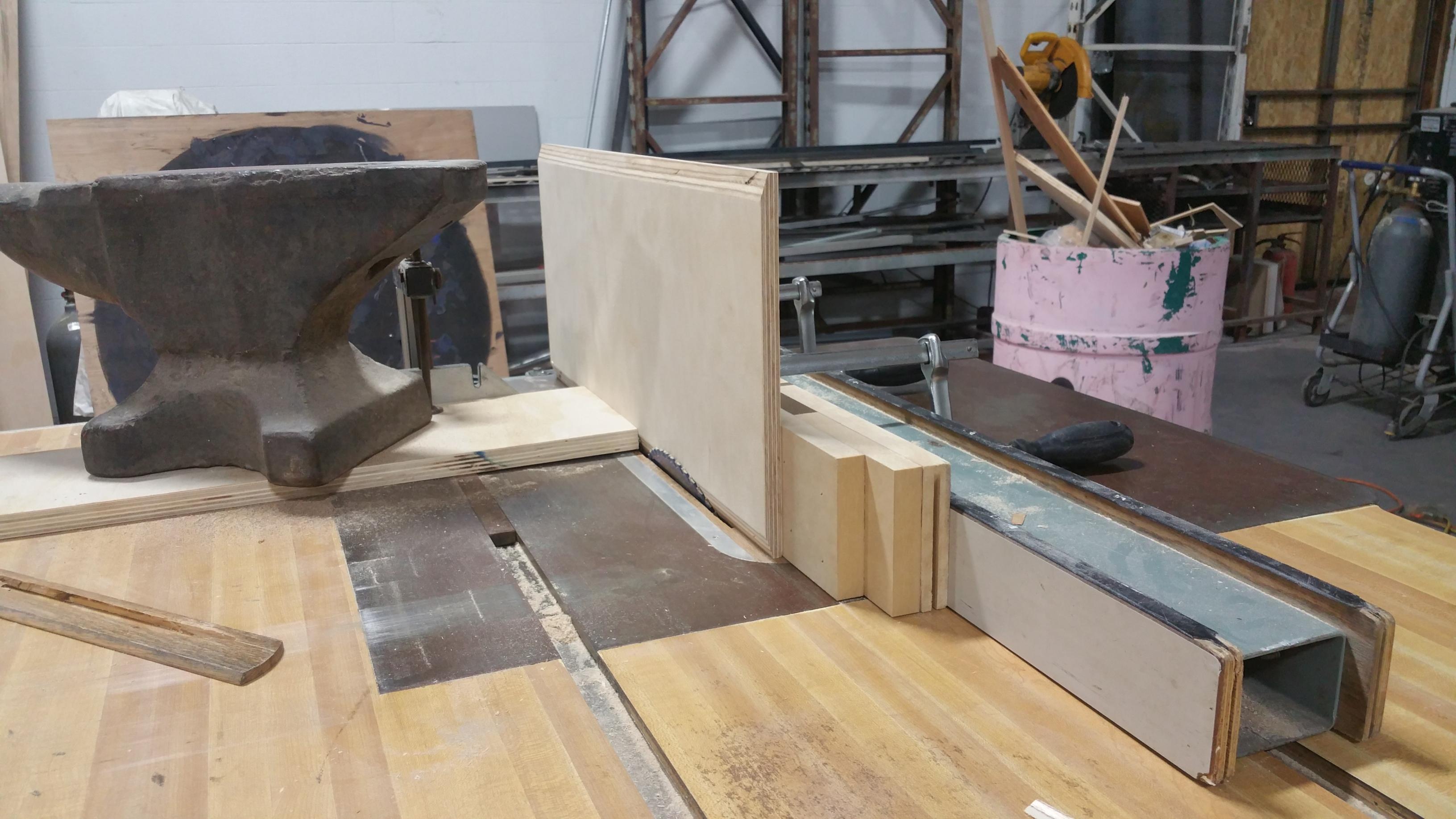

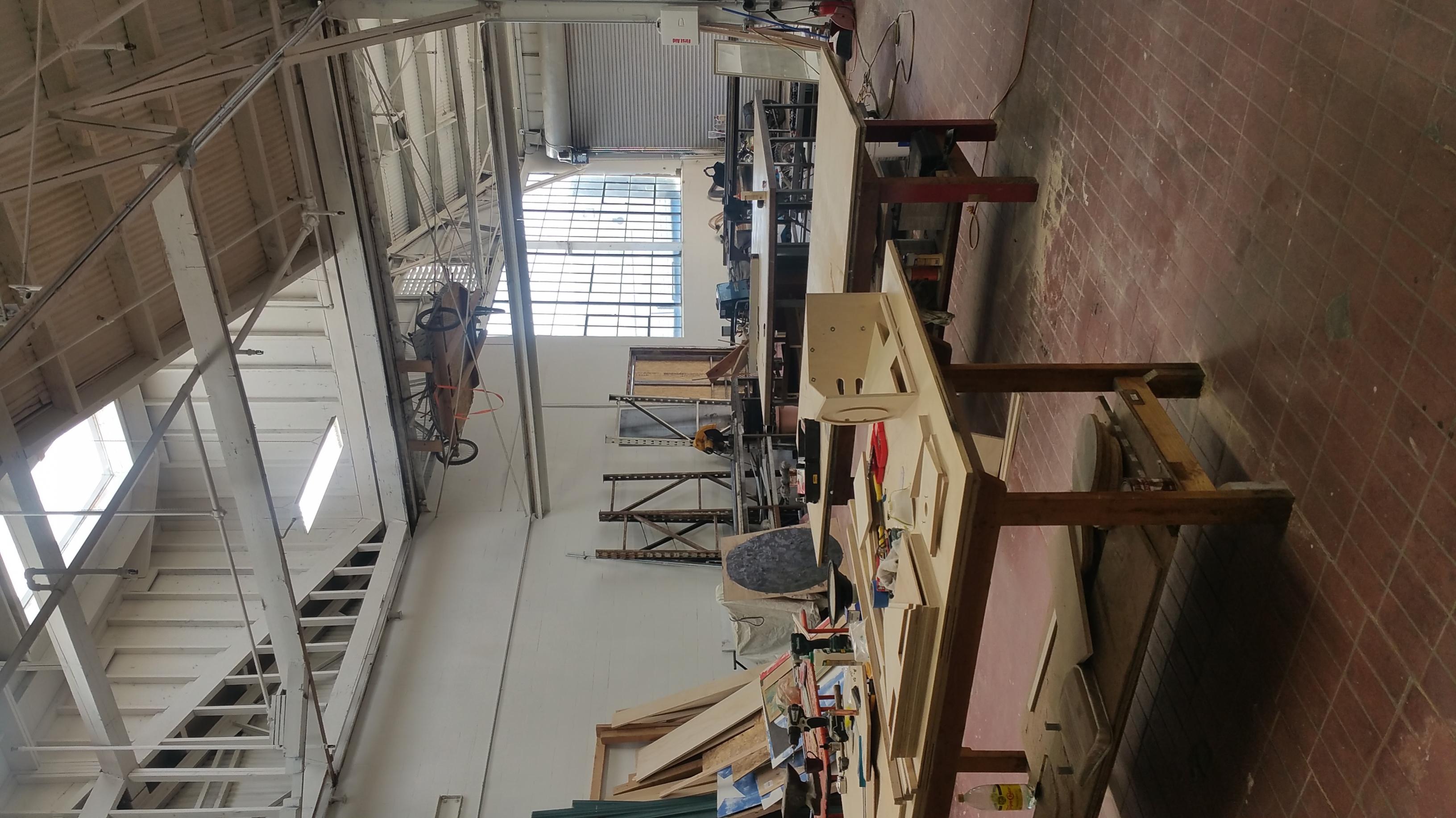

I am hoping that the photos are helping to tell a visual story for the processes used. The overhead fence on the table saw is my new best friend for this project- allowing me to (for the first time ever) cut miters with confidence and accuracy that was, before, quite a mystery. Building more horns will be a snap. I am definitely building another once this first one goes together and tests well. Thankfully found my Dayton mic yesterday, I'll definitely be taking measurements when this is done.

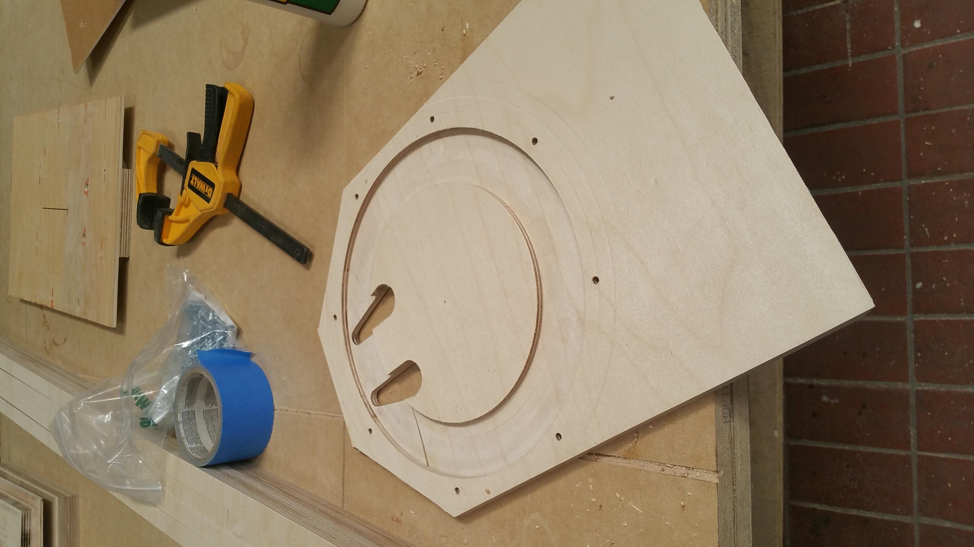

It would be very easy to route new jigs off of my mine and mail them. I hope to be 3d printing the throat adapter and potentially cone plug, which could also be thrown in the package. I would want approval from Art before sending stuff like that in the mail
At the rate things are going in my shop, we might have a CNC sooner than later but don't wanna jinx it. I wouldn't need a huge one, maybe even a desktop CNC could suffice. I'd really love to CNC the throat adapter and plug out of wood vs making it out of extruded plastic. Much nicer finish

The overhead fence we have is made out of scrap MDF. It's basically just a flat & straight piece that gets clamped to the normal fence. Its sole purpose is to provide an offset to the existing fence by 2-3" to the left, and is raised to the height of the material being cut. It's held on to the regular fence by a couple of slide clamps. Takes about 3min to get set up and adjusted properly. It is shown in the first photo in Post 292
If I do end up sending a jig to someone, happy to throw together a quick set of instructions on how to make the overhead fence. It's easy breezy!

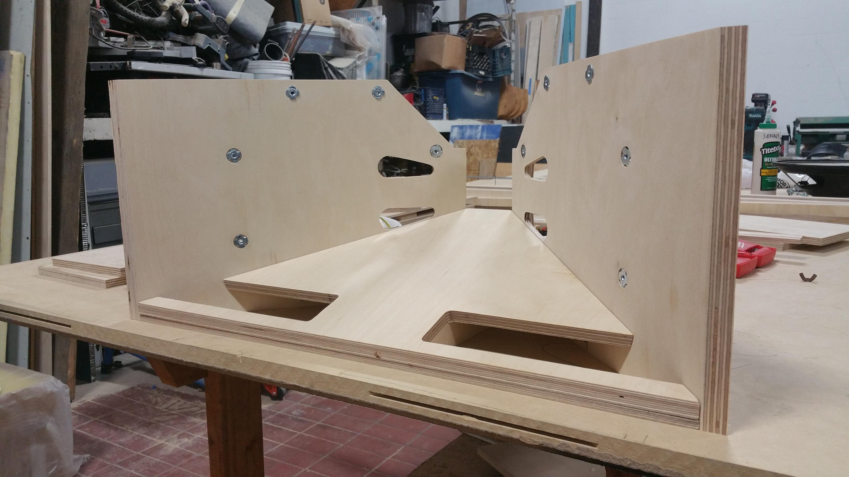

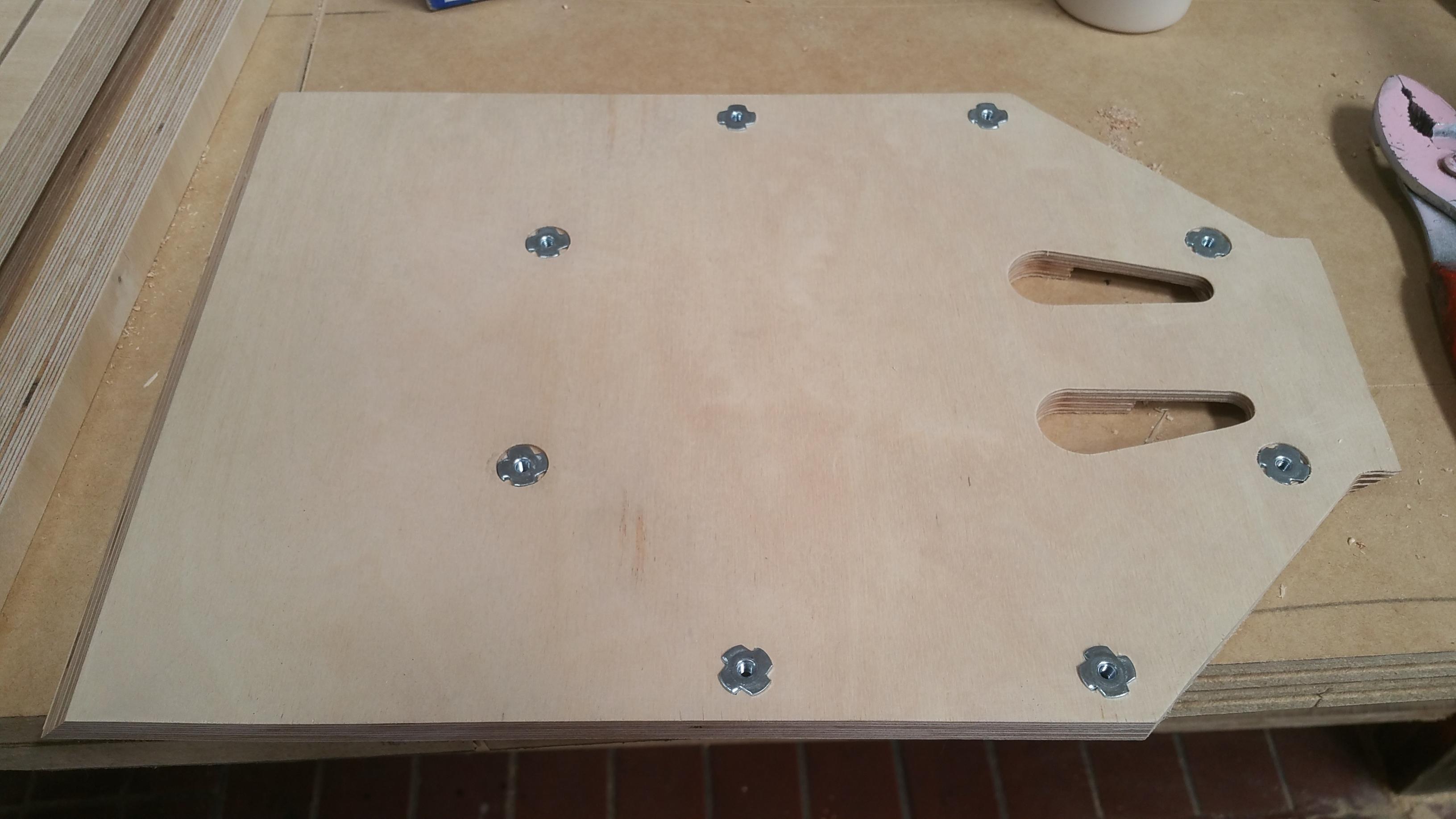

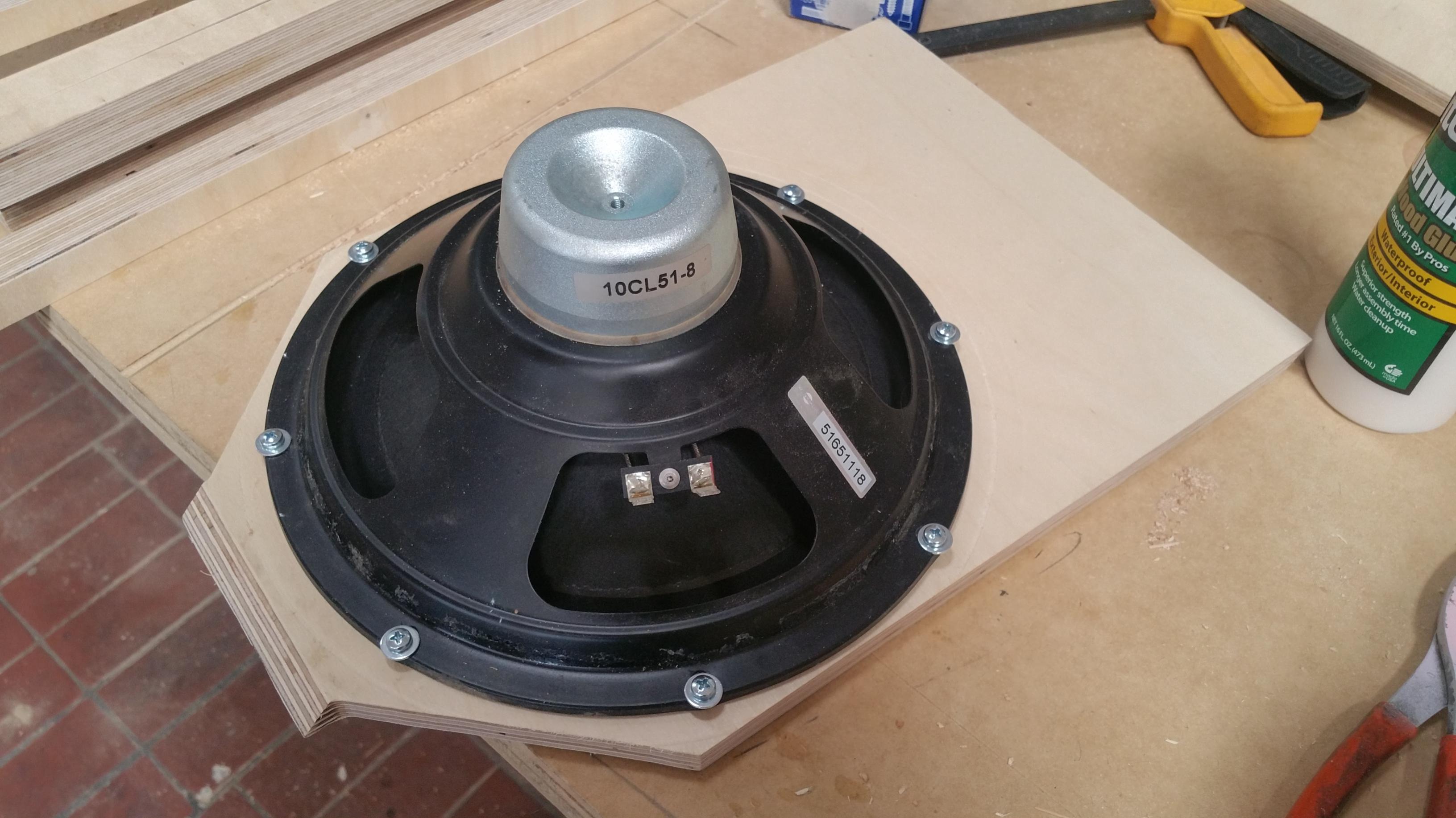

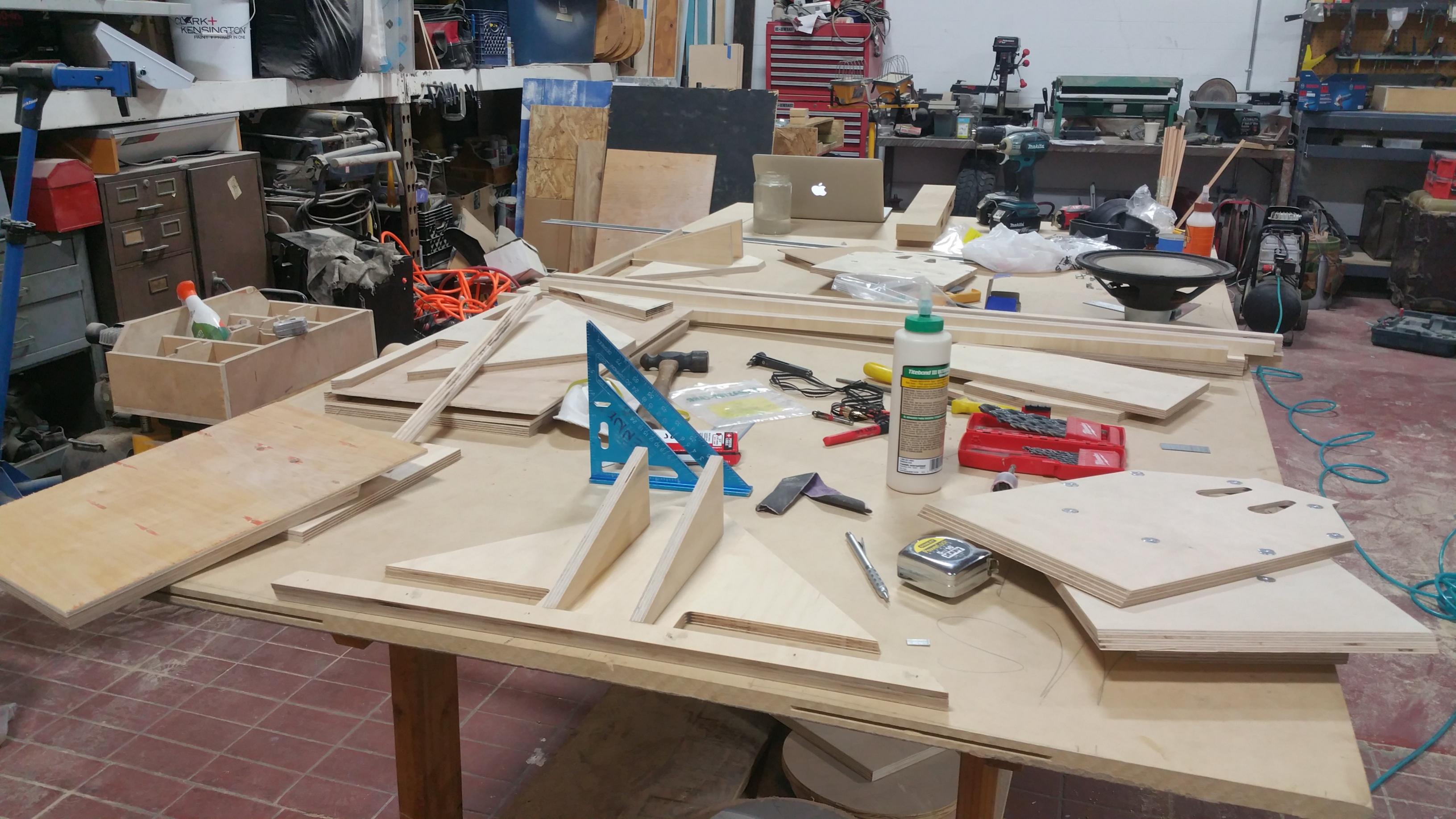

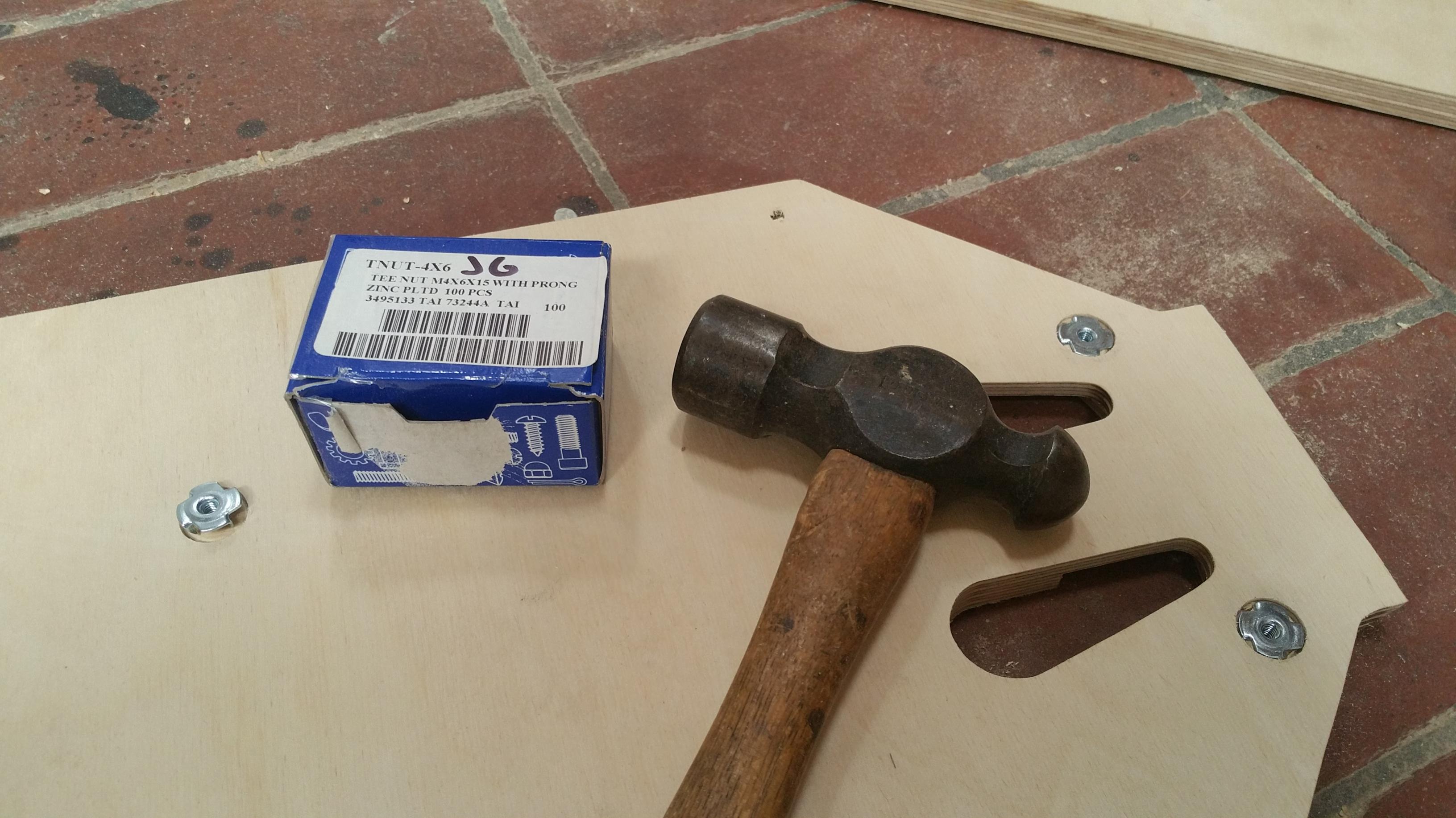

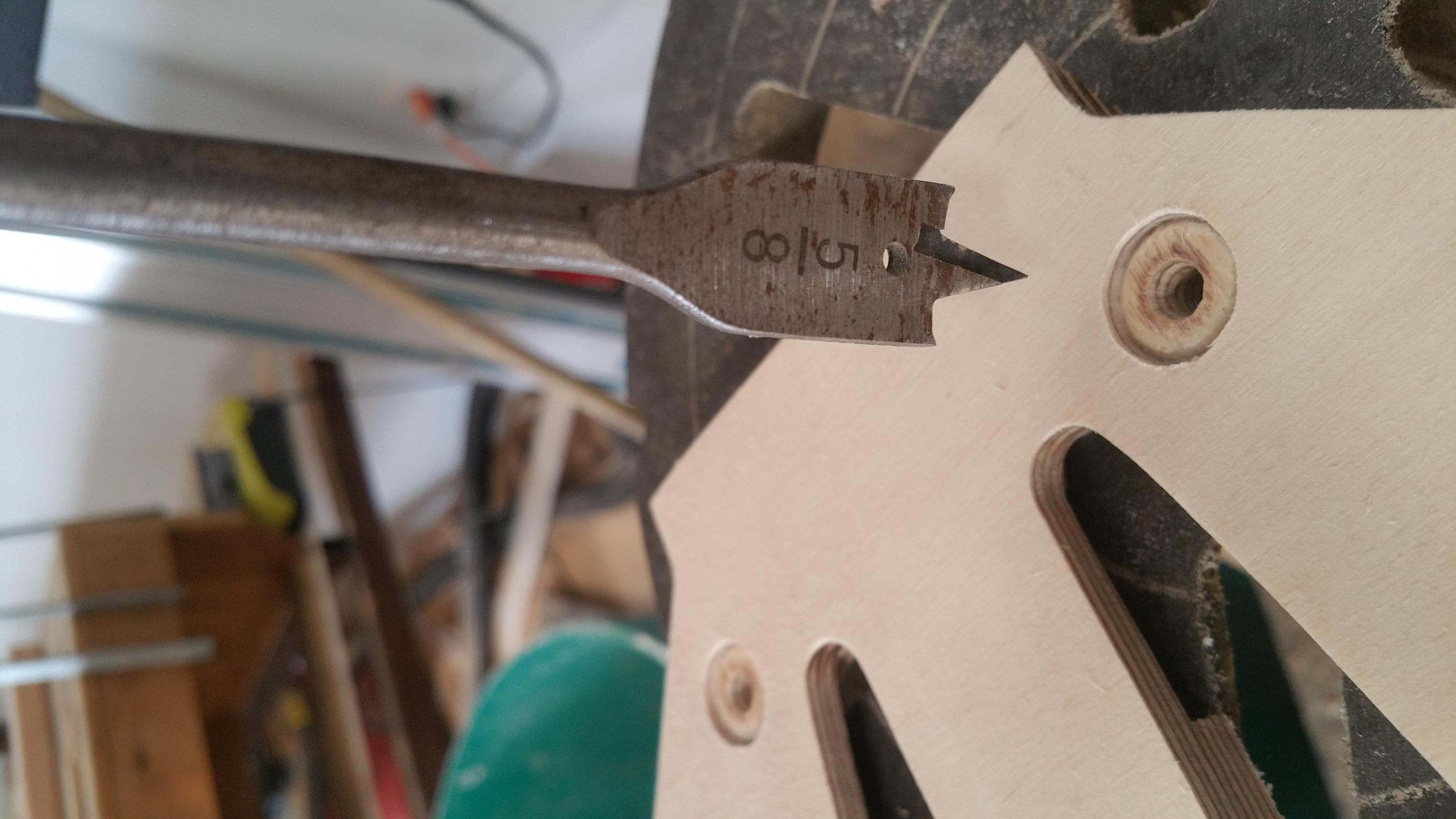

Progress update 1
Sorry that some of the photos are not coming in rotated properly, dunno what's up with that!

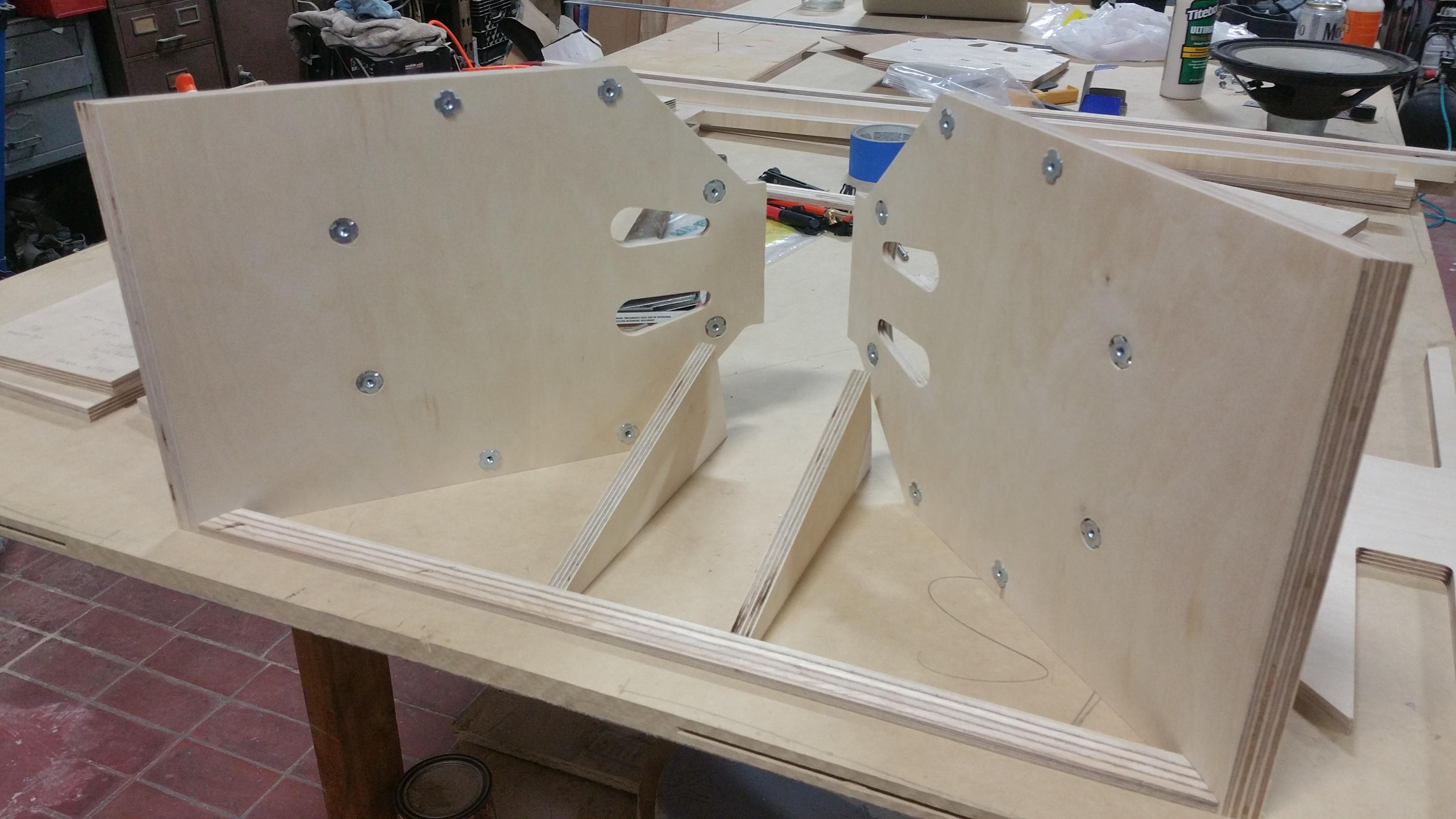

Cutting top & bottom cleats... Check out my sweet table saw contraption 😛 Luckily, I didn't die!

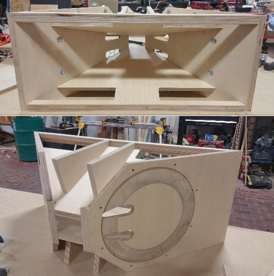

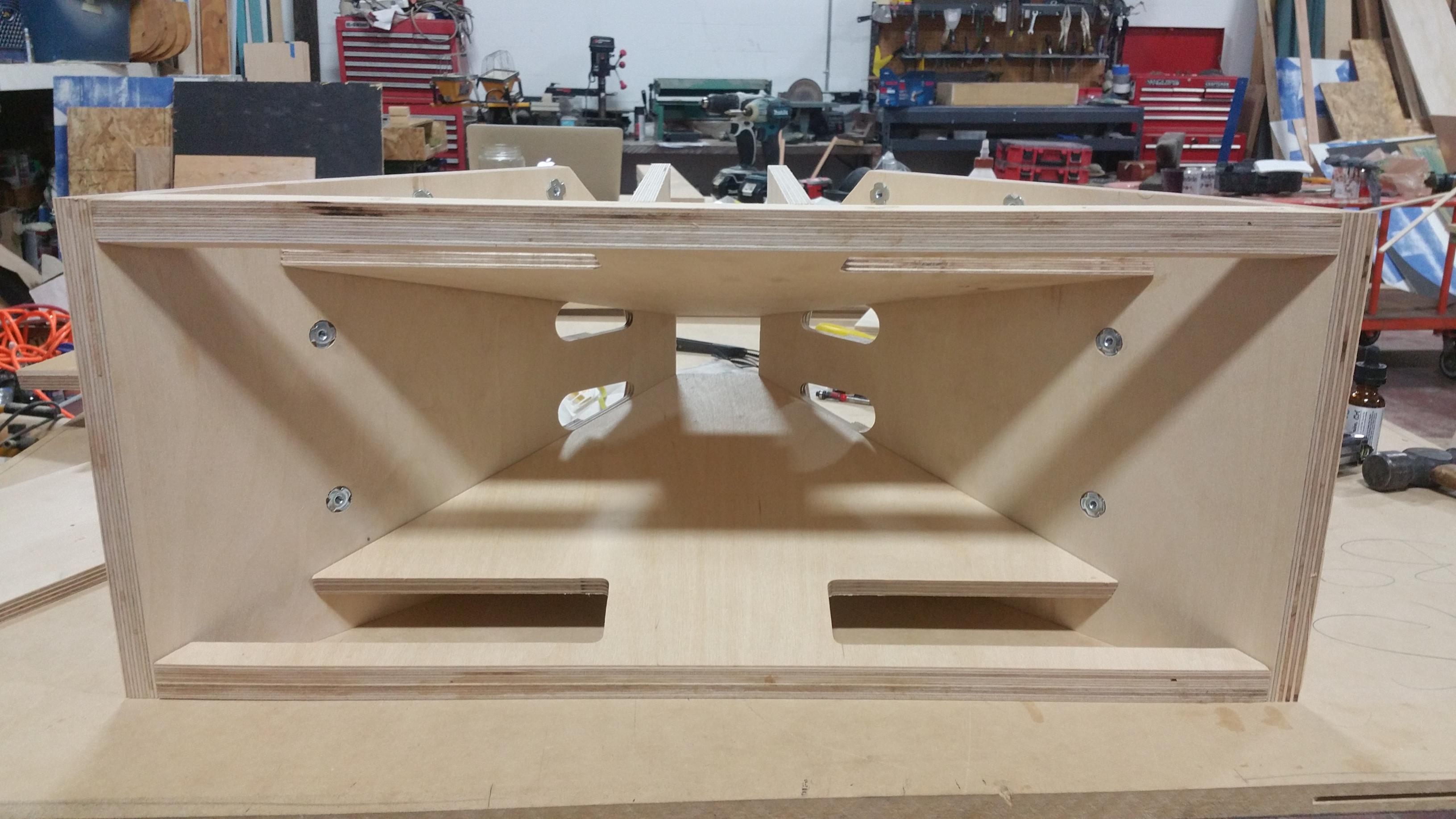

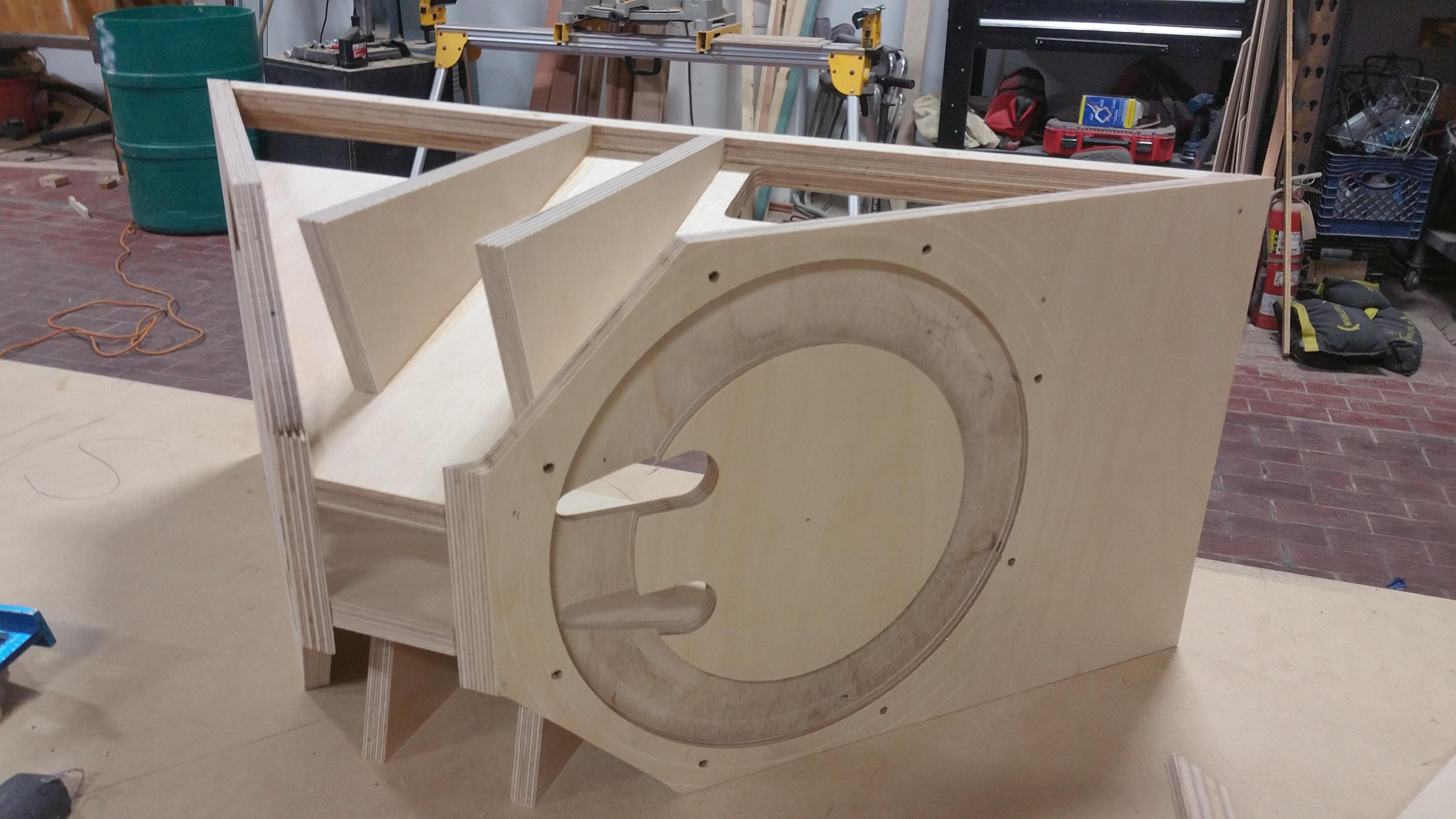

And then assembling the horn

Well done JennyGirl.
I have heard Fin's and was blown away by the size, output and sound quality. Hope you are too.
Have fun.
Have fun.

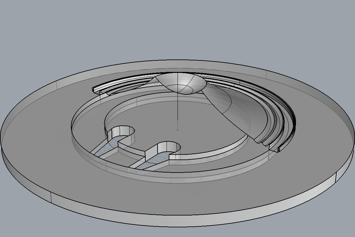

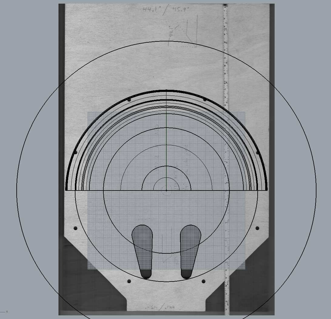

xrk- I will try to give the 3D printer a go. If it doesn't work, I'll probably stick to the table saw cutdown with finish sanding on a drill press like Art did.
To get the 3D print matching the bass injection ports, my plan is to scan the jig on a scanner (with a ruler placed underneath to get scale set correctly). That should let me perfectly match the profile of the injection ports and also provide the small registration hole present for routing the driver relief channel.
I obviously don't want to print a fully solid part (#1 it would take forever and #2 it would most definitely warp terribly). So I am considering using a 10 or 20 percent fill on the inside to help with both. I do have some ABS, but I have way more PLA. Do you think PLA will suffice? I don't foresee the horn getting hot enough that it would deform. PLA just prints a lot easier on the current setup (no heated print bed and not enclosed). As far as the 10 - 20 percent fill, do you think it would be a good idea to seal the part with something?
