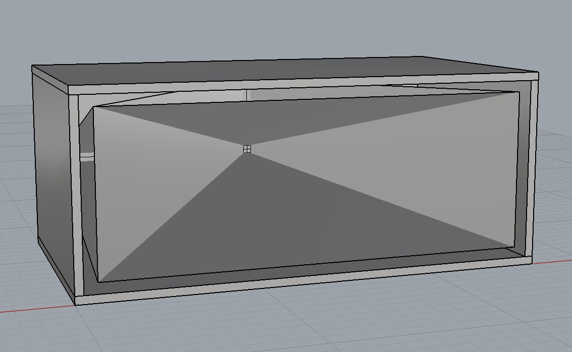

Fin's model is matching up close enough, and got some further clarification on dimensions from Fin.
Proceeding with build!

Nearly finsished updating the drawings. Feedback welcome!

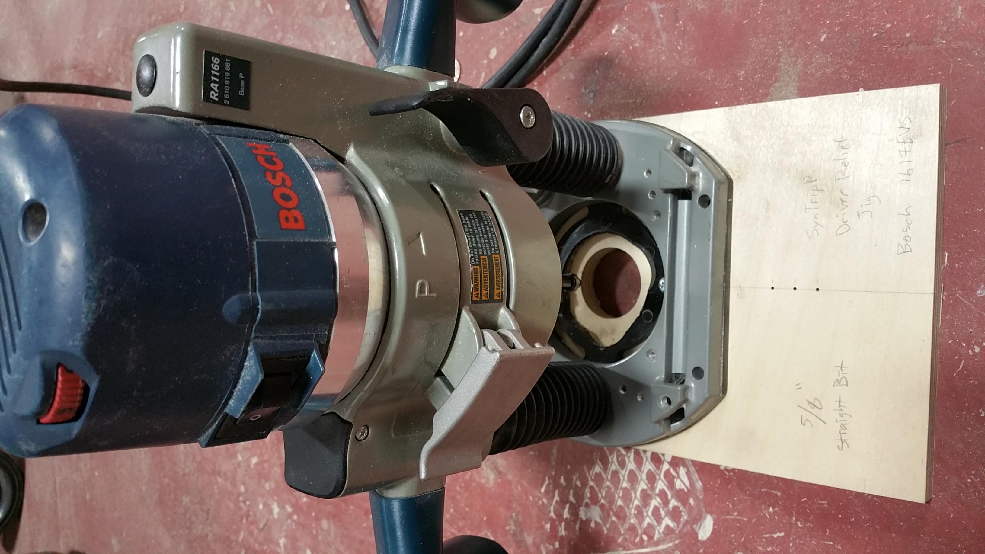

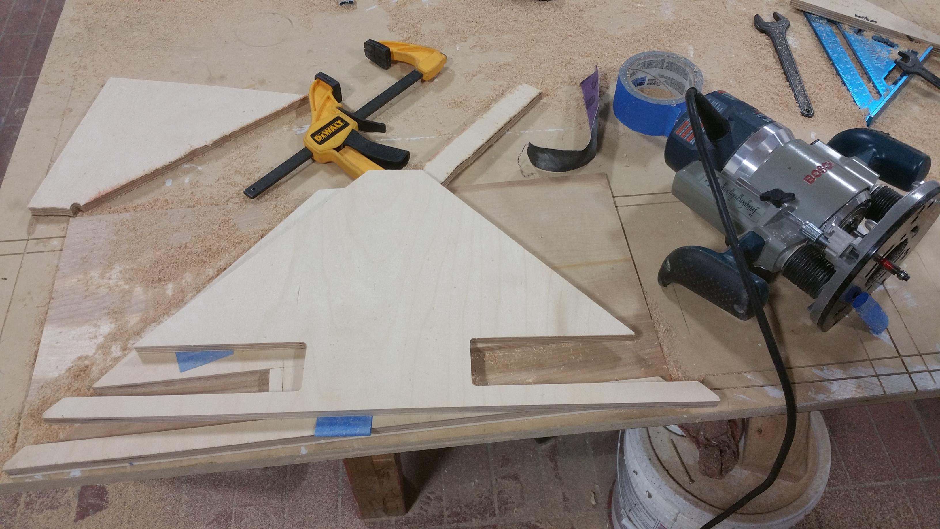

I decided to make router jigs for the inner horn pieces (the jigs include the longest miter dimension, so I can trim the miter off using the overhead fence on the table saw tomorrow).
I am using Fin's sketchup model mainly, and his plans as a guide/doublecheck.
I have the inner horn pieces cut, going to do the miters tomorrow and see how it fits before cutting more for the second horn

No CNC here yet (I hope someday soon). Using table saw, track saw, band saw, drill press, jig saw, files, and router. Improvised some good tricks with the router that really made the difference, I think. Man I love that thing!!

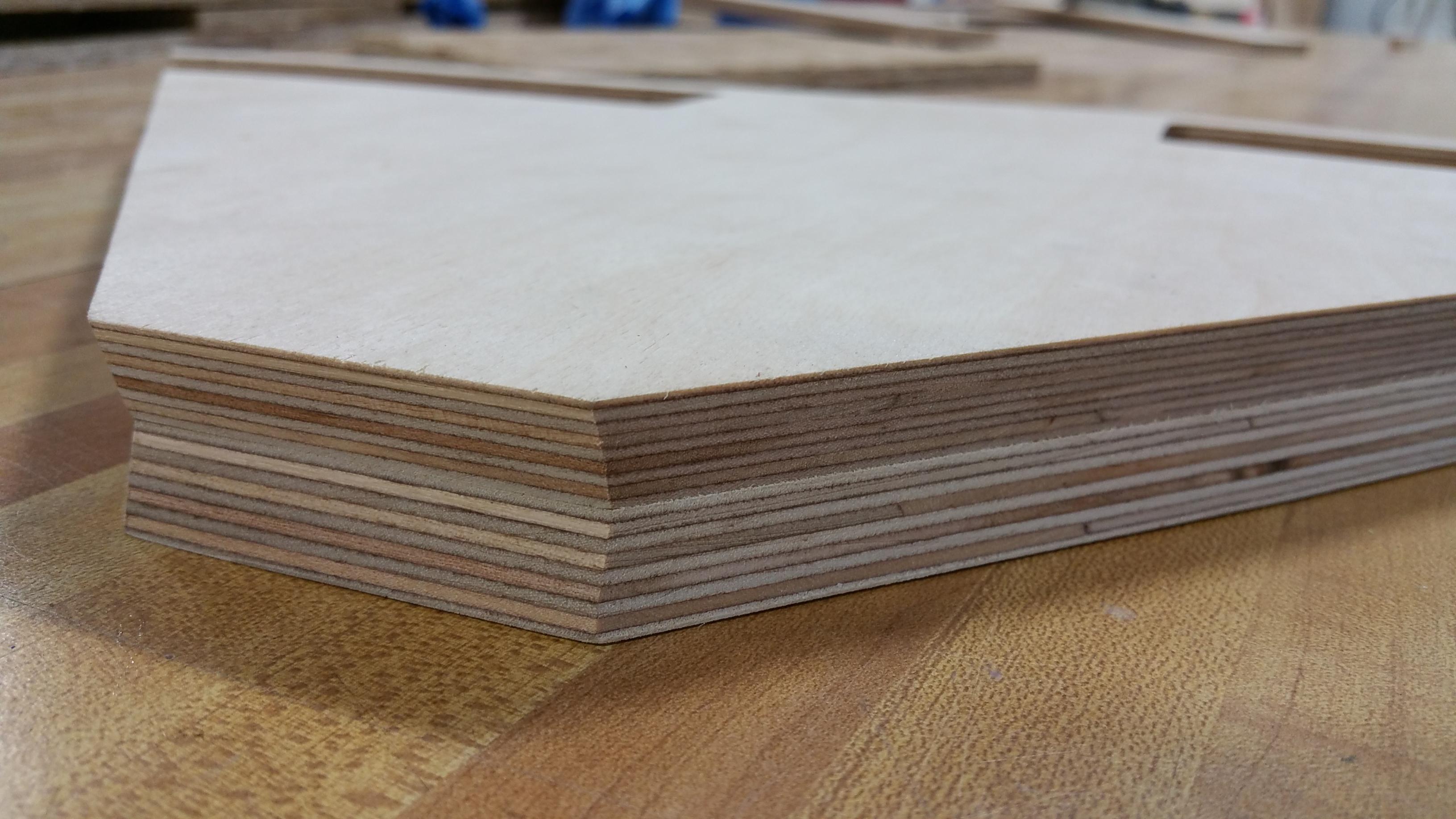

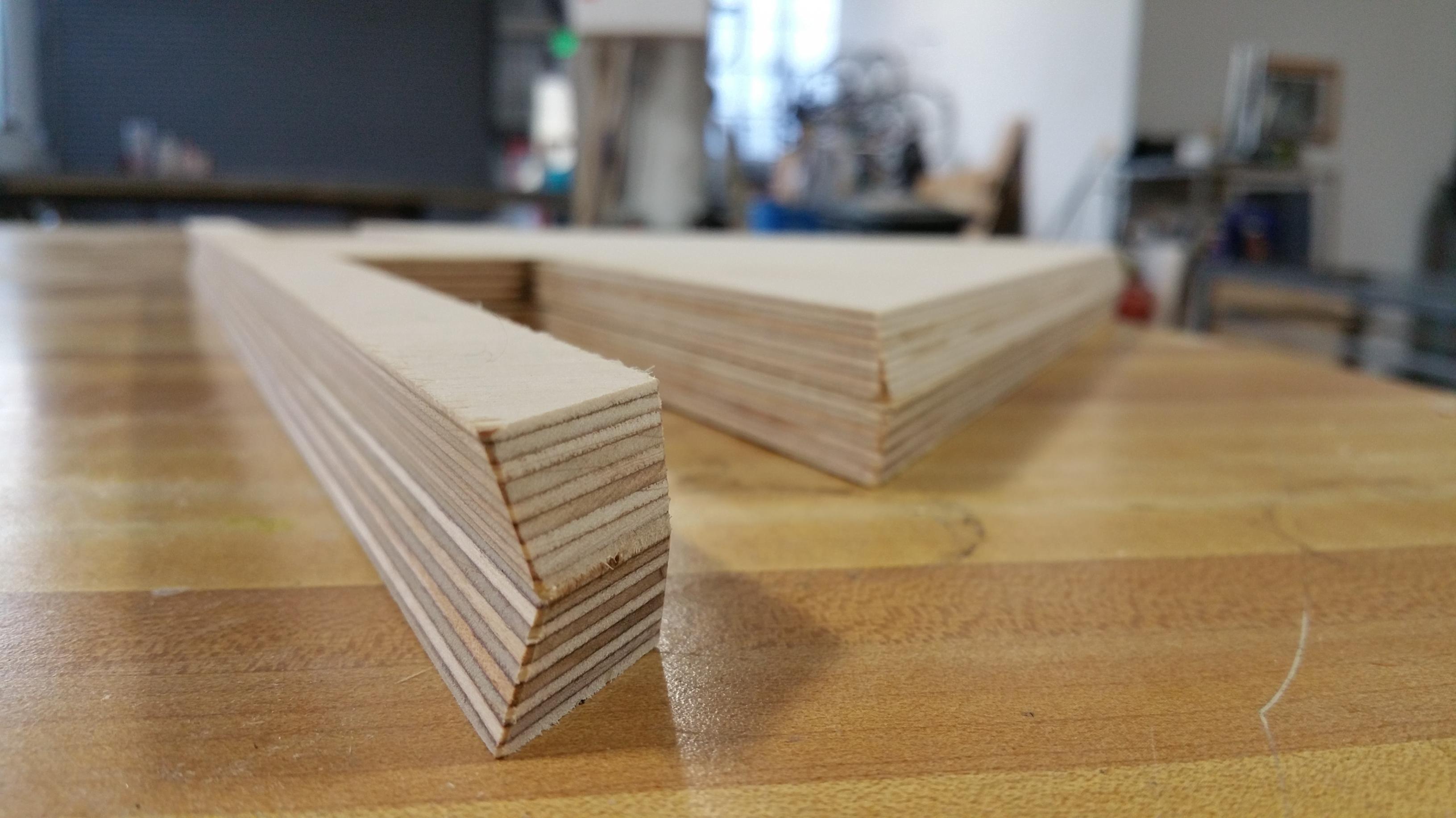

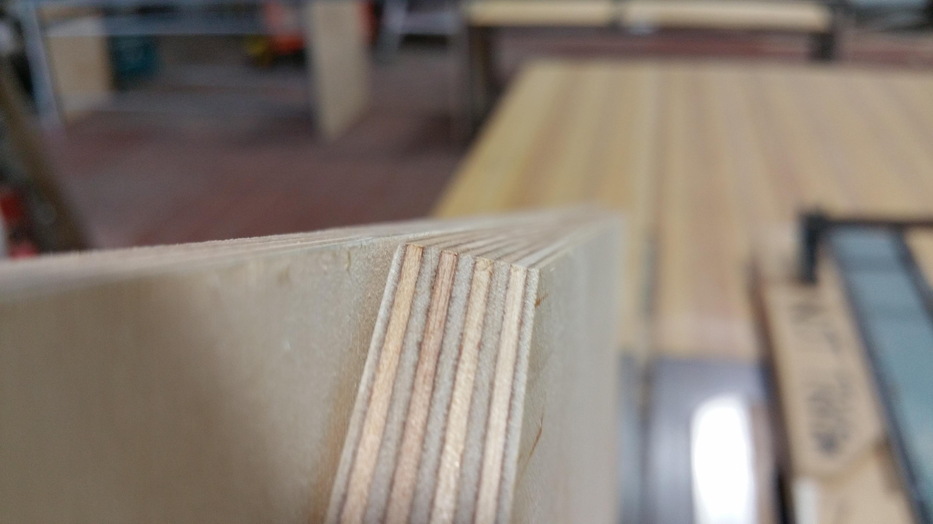

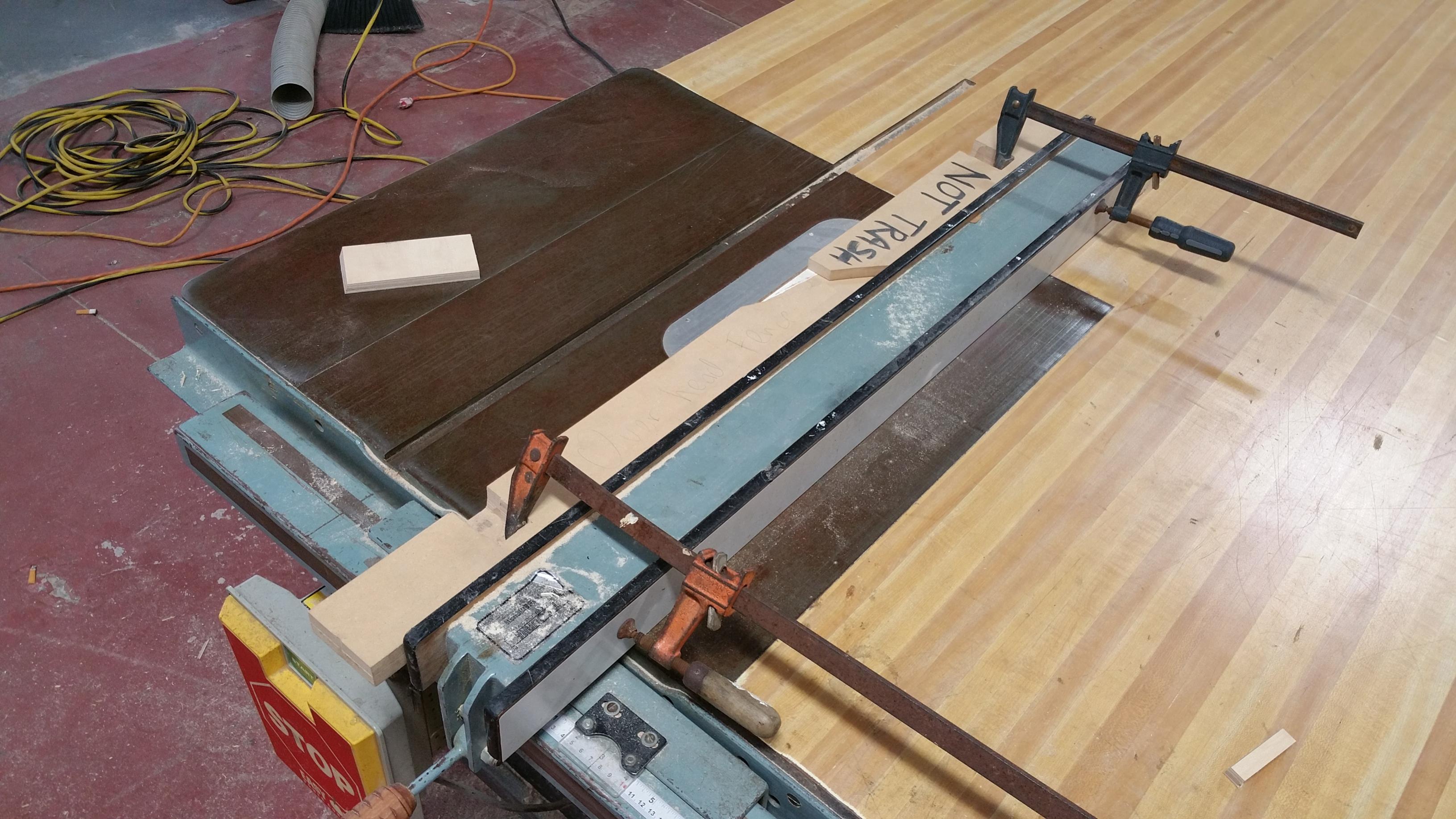

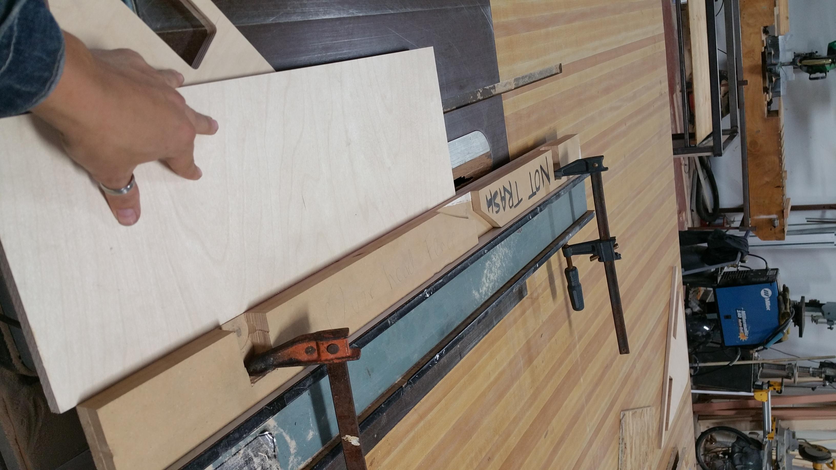

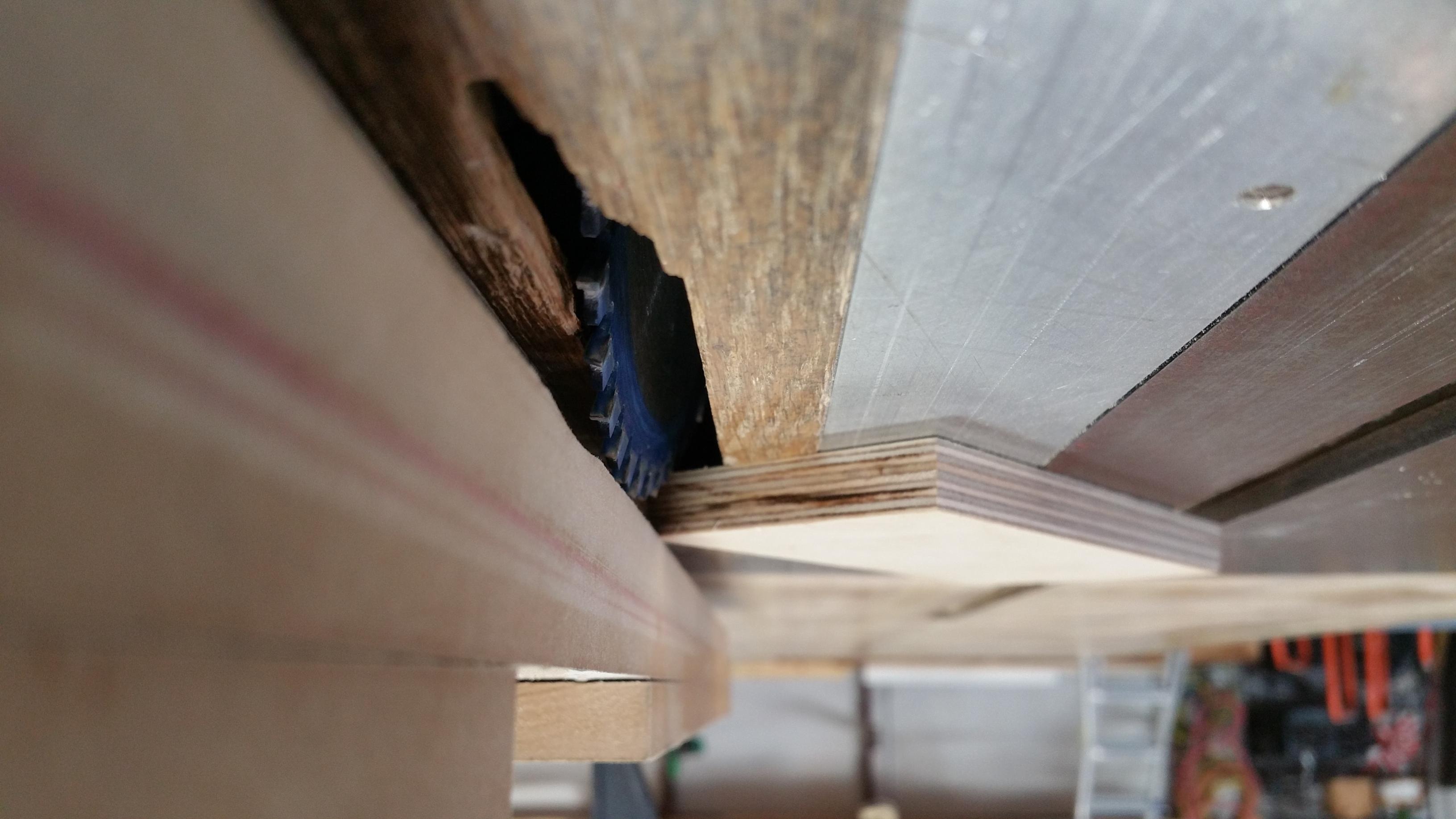

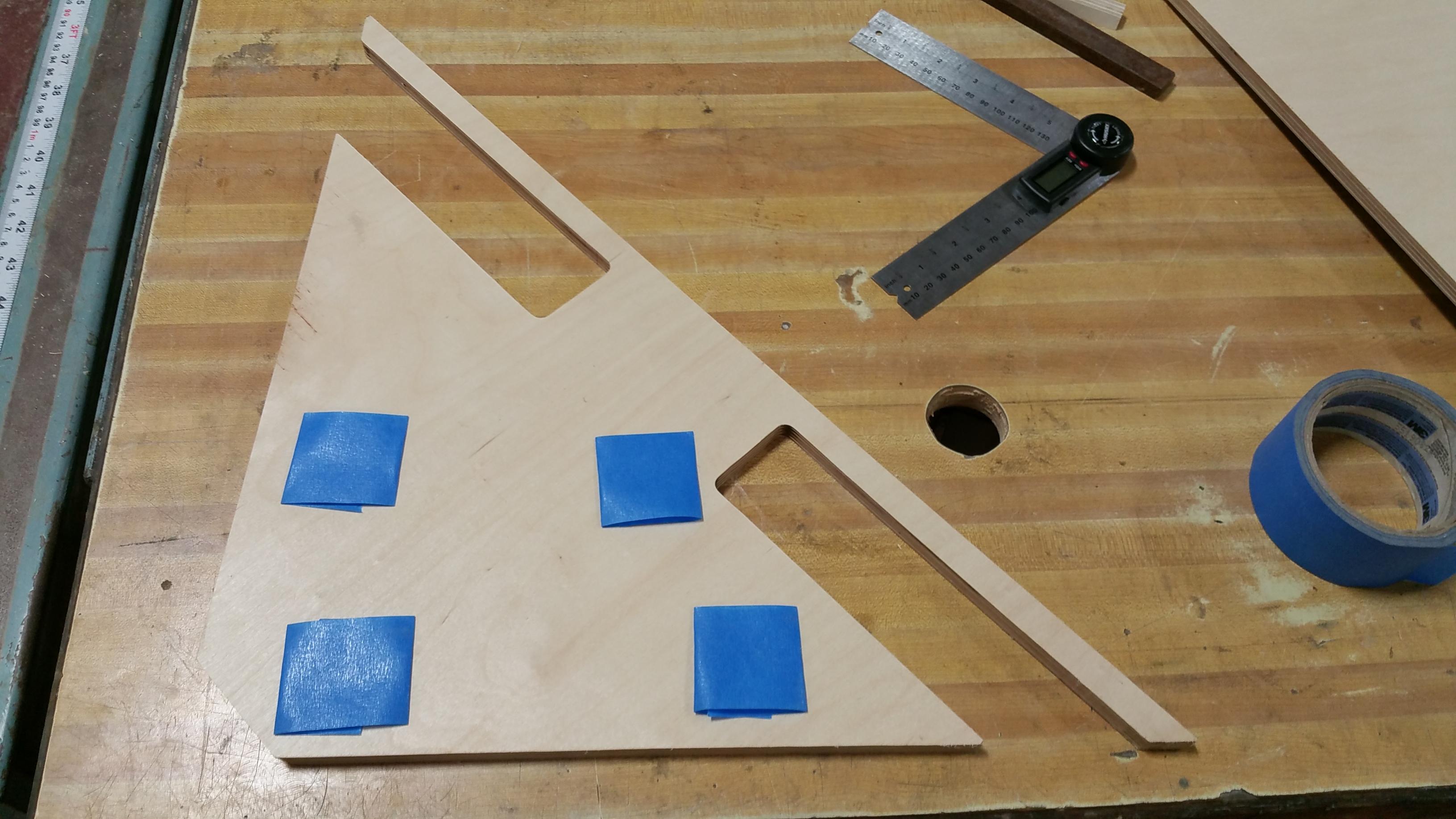

Miters are coming out great!
Overhead fence on the table saw is killing it!
Took some photos to show it

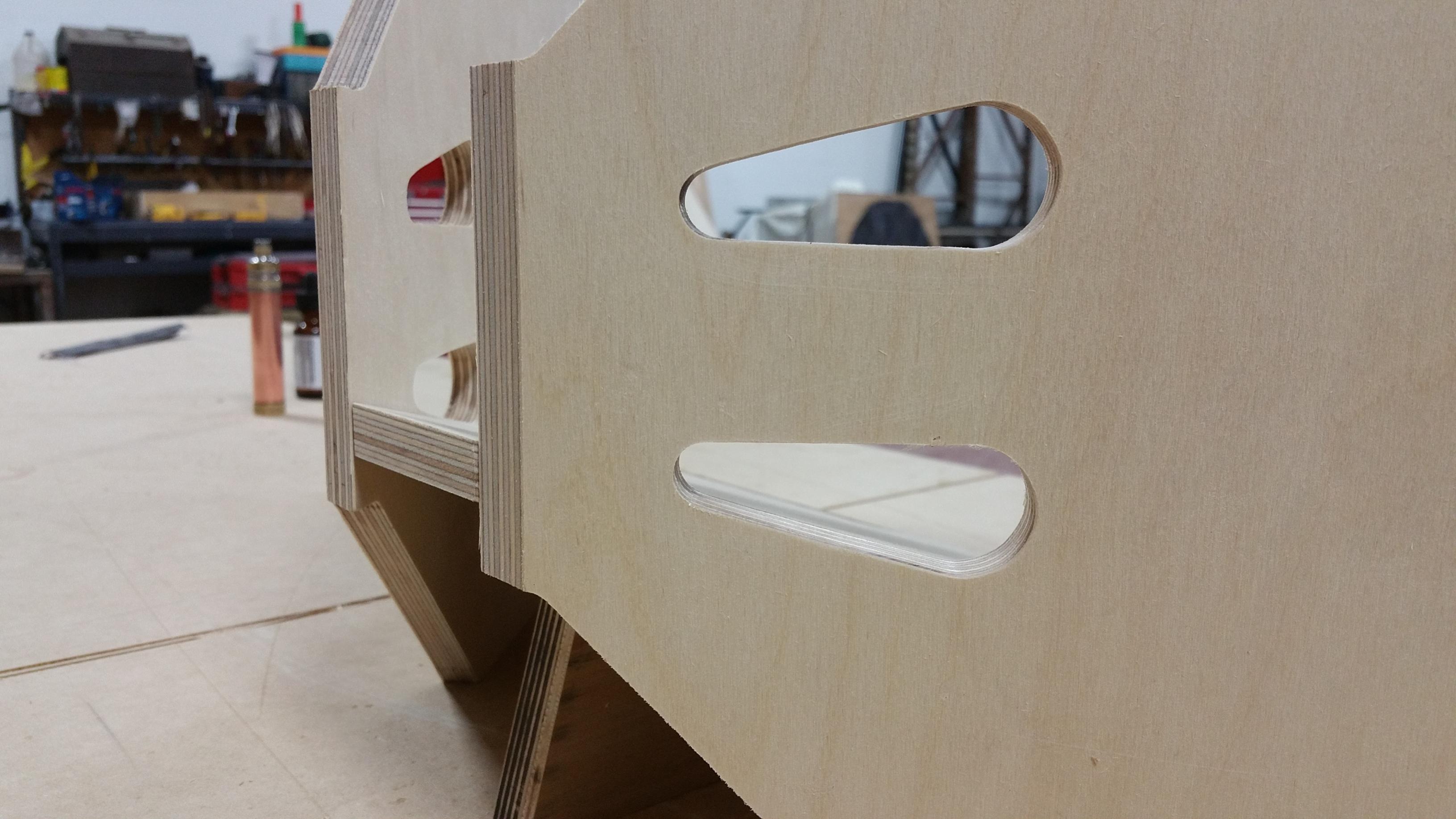

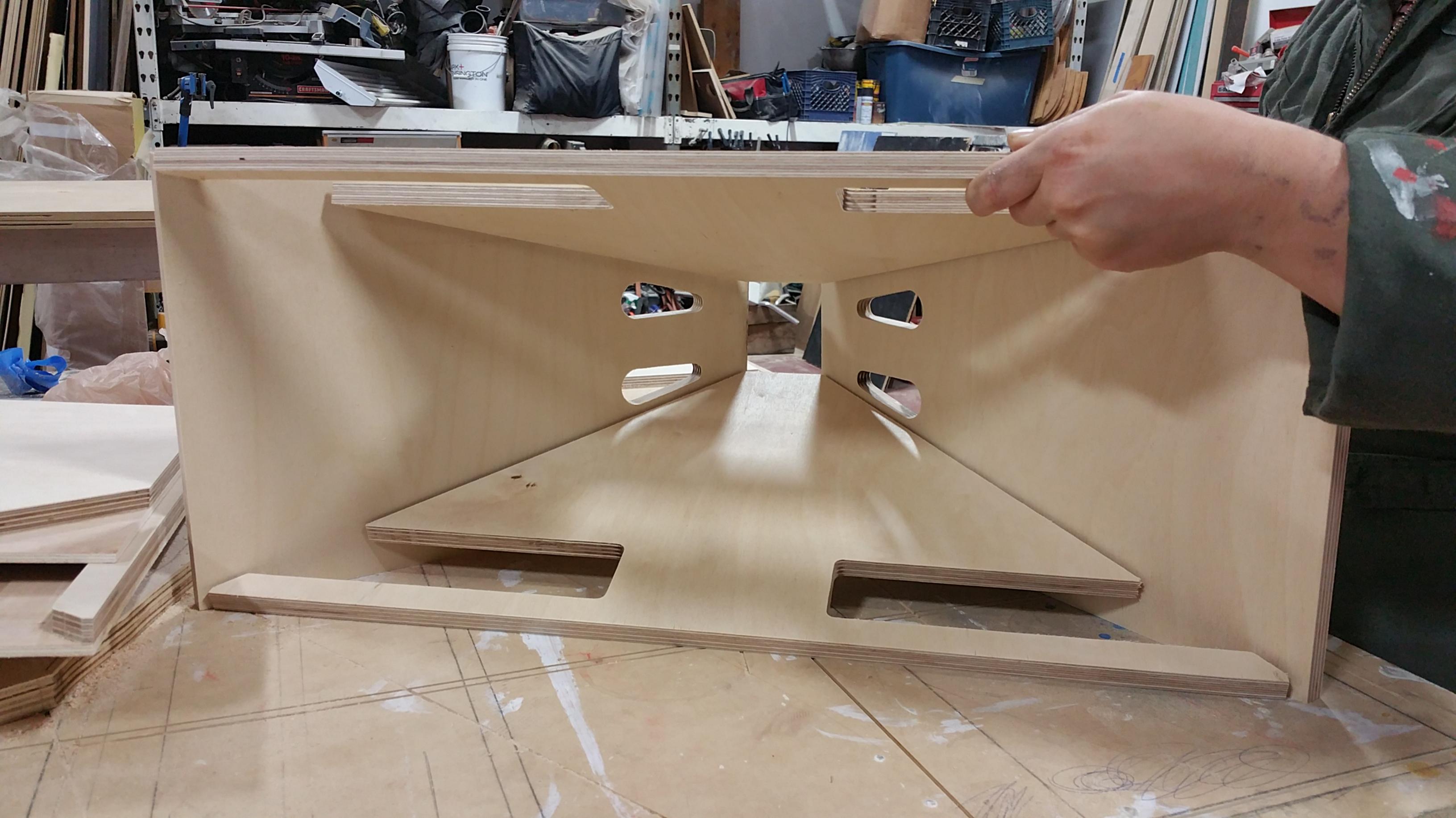

Miters are done, dry fit is flush

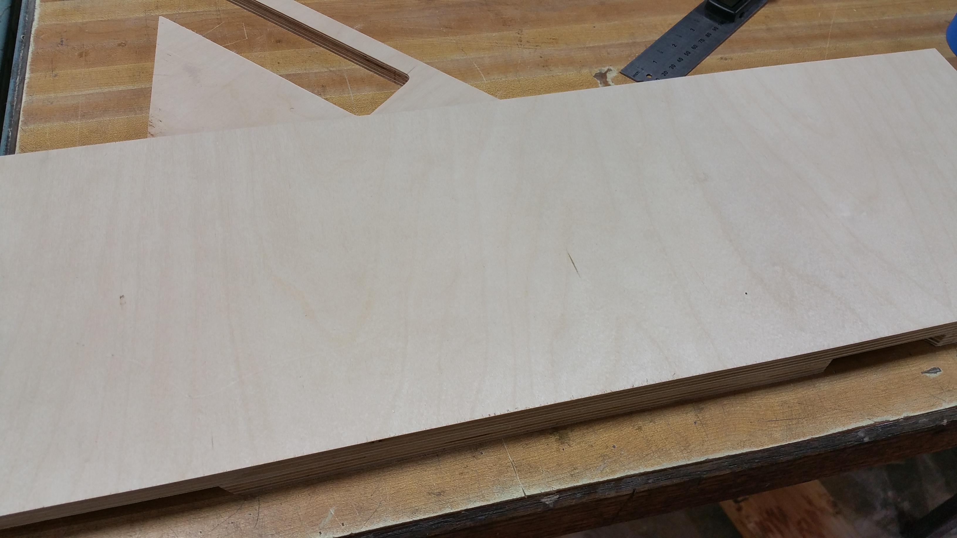

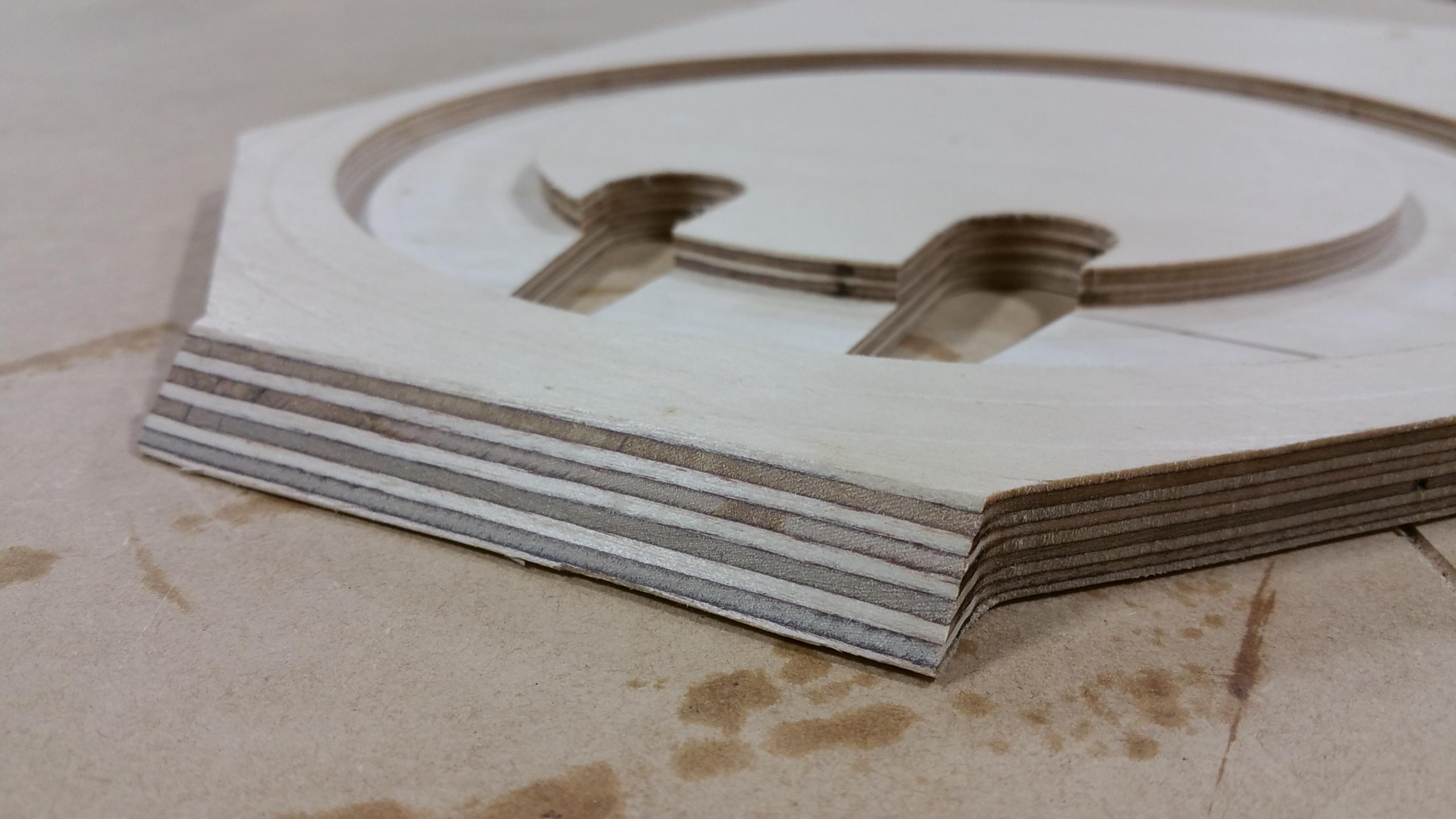

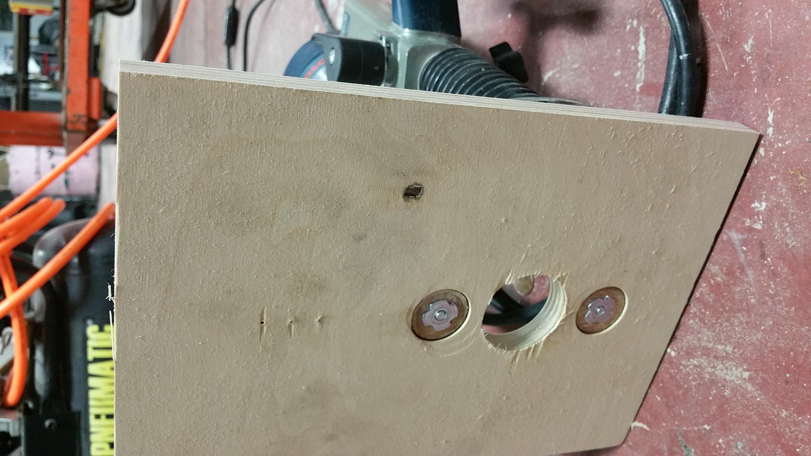

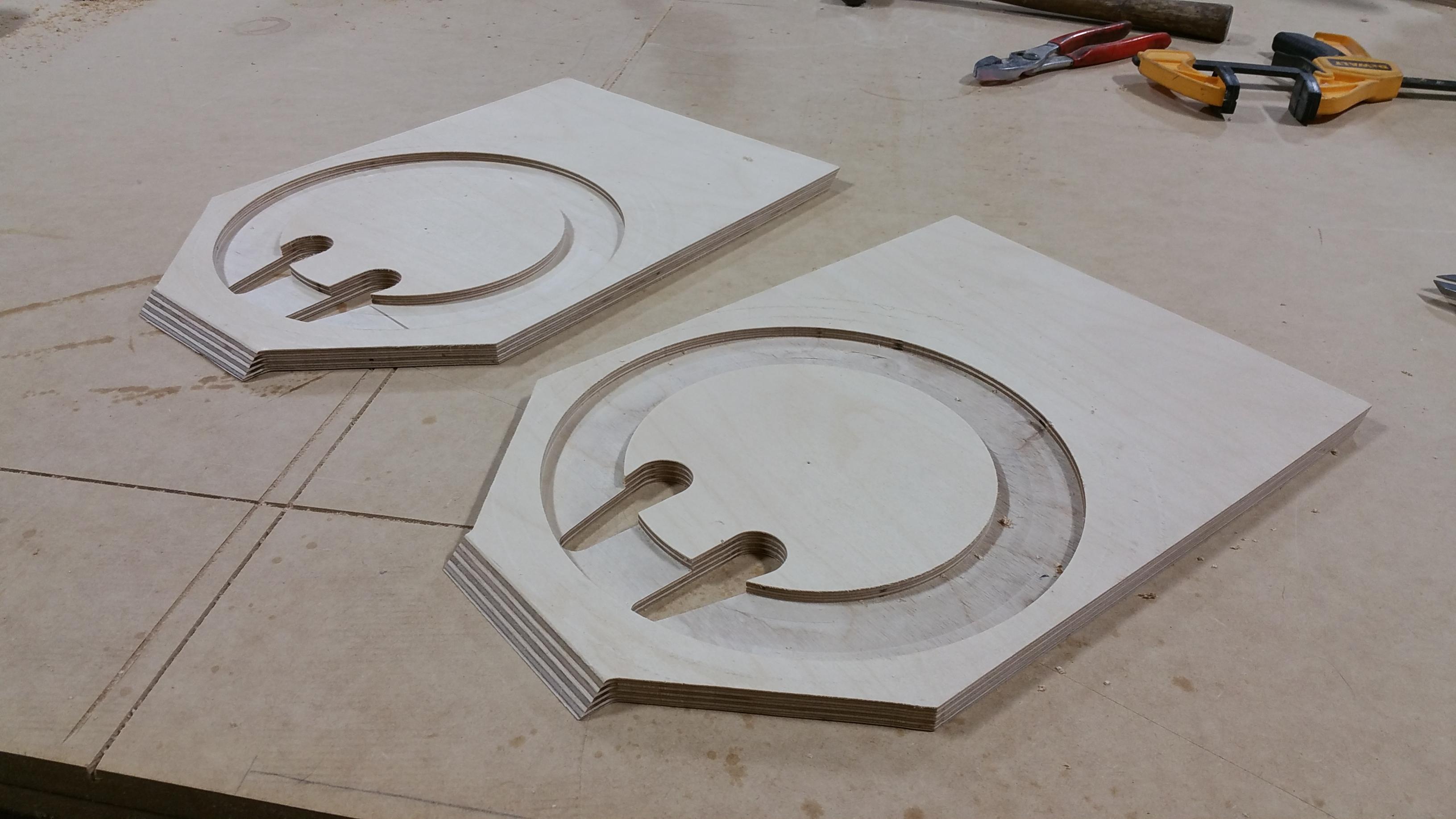

Made a router jig for driver relief channels and routed the sides
CHEERS to Fin who has been a HUGE help! Could not have gone this well so far without him. THANK YOU Fin!!

Those are some of the finest compound mitered joints I have seen.
